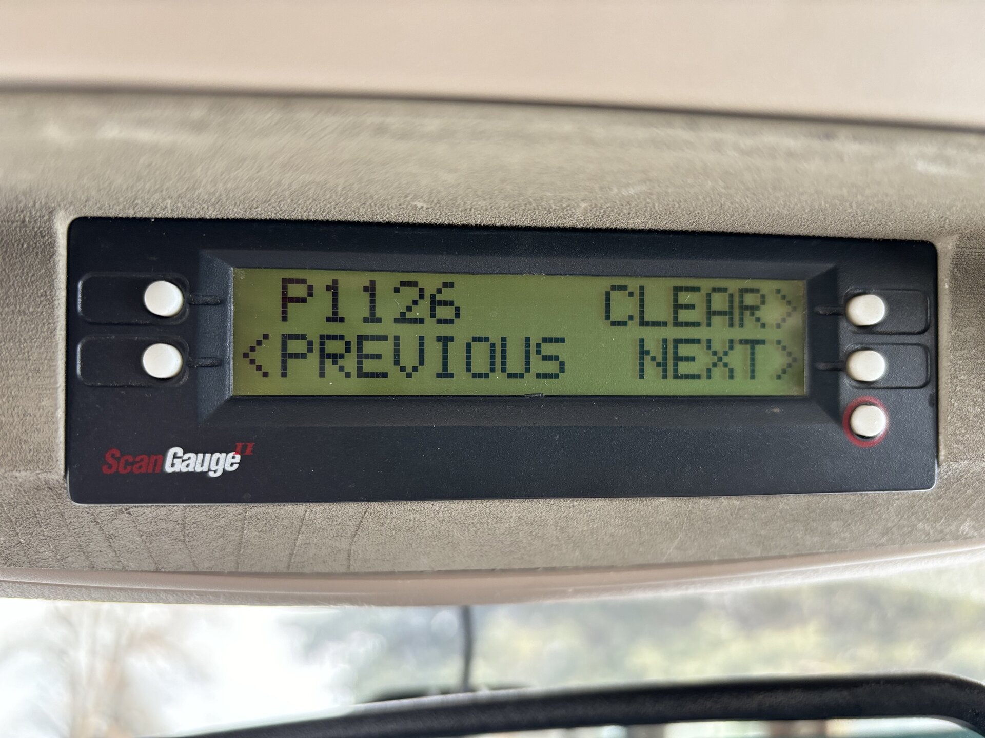

Cleared the PO1126 and waiting to see if the dialetric grease works.
