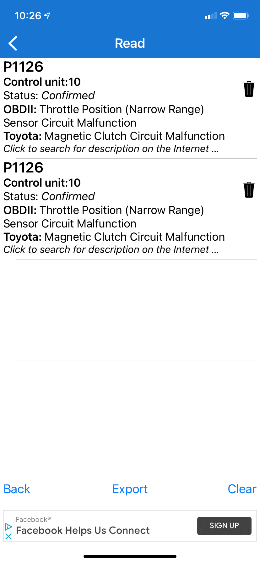

I’m getting a P1126 code so I though to replace the throttle position sensor first since that’s the least expensive option.
This is what my reader says..... thoughts?

I am having this same issue. Were you able to resolve this code? I have heard cleaning the throttle body could resolve this issue. I haven’t gotten around to it since this isn’t my DD.
Not really. I took it to a trusted mechanic and he fiddled with it and said the TPS needed replacing. He cleared the code but it hasn’t come back on yet. So I’ve been riding around like it is but no code yet. However, I did buy a new TB with sensors from Toyota. One day I’ll get around to having it installed. I think that’s the best route instead of chasing down the issue. Here’s another tread on it...

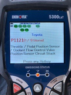

1999 TLC Digging this up, threw the intermittent P0121. Opted to replace the entire throttle body and now truck is throwing continuous P0121 with crap throttle response. Any ideas?
I have been trying to solve this issue for years at this point. Luckily my original TB assembly continues to operate consistently enough that it only throws a fit once the vehicle is VERY cold (neg or single digits).
First time it happened, I went into limp mode on the highway. I hopped on here, disconnected battery, made it to work fine. A few weeks later happened again.
Read up on here, bought the full TB from Stevenson Toyota West, brought it to an Indy shop to replace it .. no luck. New TB in their eyes was "defective," I told them to order the part. The new part they ordered, had the same issue and the shop couldn't explain it.
Put the old one in and went about life for about a year until the next really cold morning. Same code, P1121 is back! Went to a different shop, we started with my self ordered part - said its defective, asked if they could order their own throttle body -- which I declined and said I am going to go to the stealership next, because I have no idea what to do next.
Have an appointment in a few weeks at Stevenson Toyota West .. where I am bound to have the same experience.
