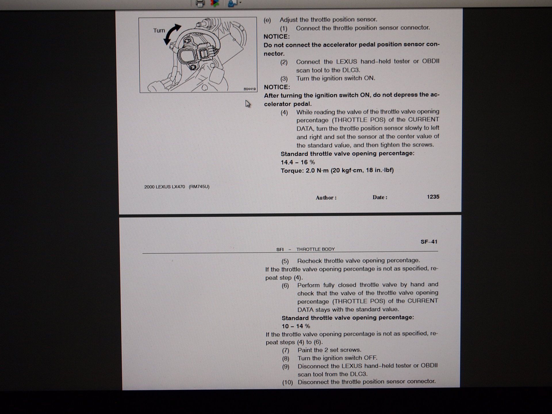

That pic did not come out right... was at 20% and now at 15%. There are some instructions in the fsm to take readings with apps disconnected. .. did not seem to matter either way. Still waiting for CEL to clear and cleaned out the throttle body while I was in there. Chemtool makes some good stuff with nice long nozzle to reach up into the opening. Beamed from my Galaxy 4 using IH8MUD to your computer screen

I had code P0120 come up in March one time. I cleared it. Then in the last week, it returned about 5 times. I replaced the TPS with a Toyota Throttle Position Sensor bought from the dealer. Probably overpaid. It was $110. Once calibrated, the code is gone and having driven 200 miles or so.
A $25 wifi hotspot ELM 327 OBDII reader from Amazon and free version of DashCommand for iPhone / iPad allowed me to measure the throttle % to calibrate the sensor. I found it more successful to calibrate the zero position than idle. Zero position requires removing the intake to throttle body snorkel and pushing the throttle plate 100% closed. I set the TPS @ 12%, which is mid-way point between 10% and 14% called out in the FSM. I think normal ignition on position is supposed to be 16%. When I set that way, I still received an out-of-range code. Weird, but problem easily solved using the other calibration method.

@DWSD, I know this thread is very long ago but I am having the same problem with my tps, bought a new one, set it at 16% pushing throttle plate 100% closed and still did not work.
Can you please tell me the other calibration method you used in setting the tps correctly, I can't move my car anywhere pls.

Could doing the TPS calibration wrong (with the APPS connected) cause a P1128 code and failure to start? It was reading 14.9 when I set it but it goes to 17.6 when I try to start it and doesn't go back. I adjusted it again (with APPS connected), it is now rotated to the max and still reading 14.9 before trying to start and 17.6 after.

This morning I was messing around with my Torque app and with the engine off if I floored it it would get to 80.2% open. I think closed was 16%. I also unplugged and re-plugged the APPS connector.
