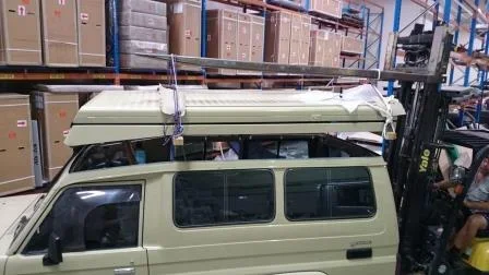

Bed platform is 15 mm thick , and is mad of honeycomb aluminum panel .
It is very stiff and holds 2 adult persons without bending at all.
Also very light , easy to lift and pull down due to the hydraulic Pistons.
It has been upholstered with a knitted fabric in order to have some touch comfort and reduce and condensation area.plain aluminum would have been too metal look and light reflecting and not nice to touch .
