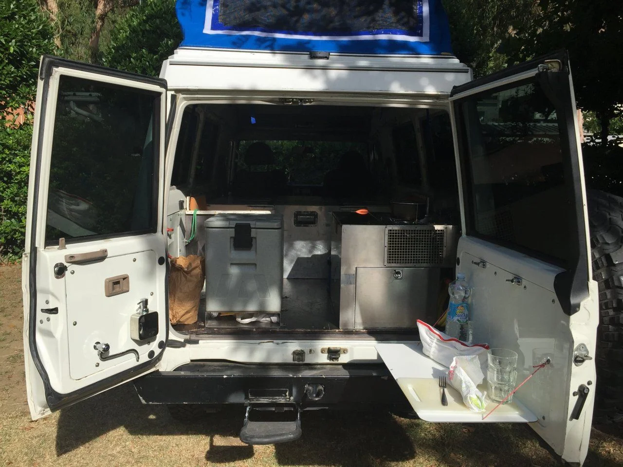

I have put the cooking plate on top, of a kitchen box next to the back door.
The pipe for Diesel is comming out from the rear tank.
Eletricity is comming from the main battery , long way.

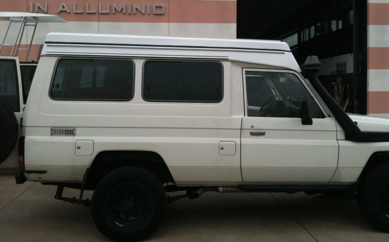

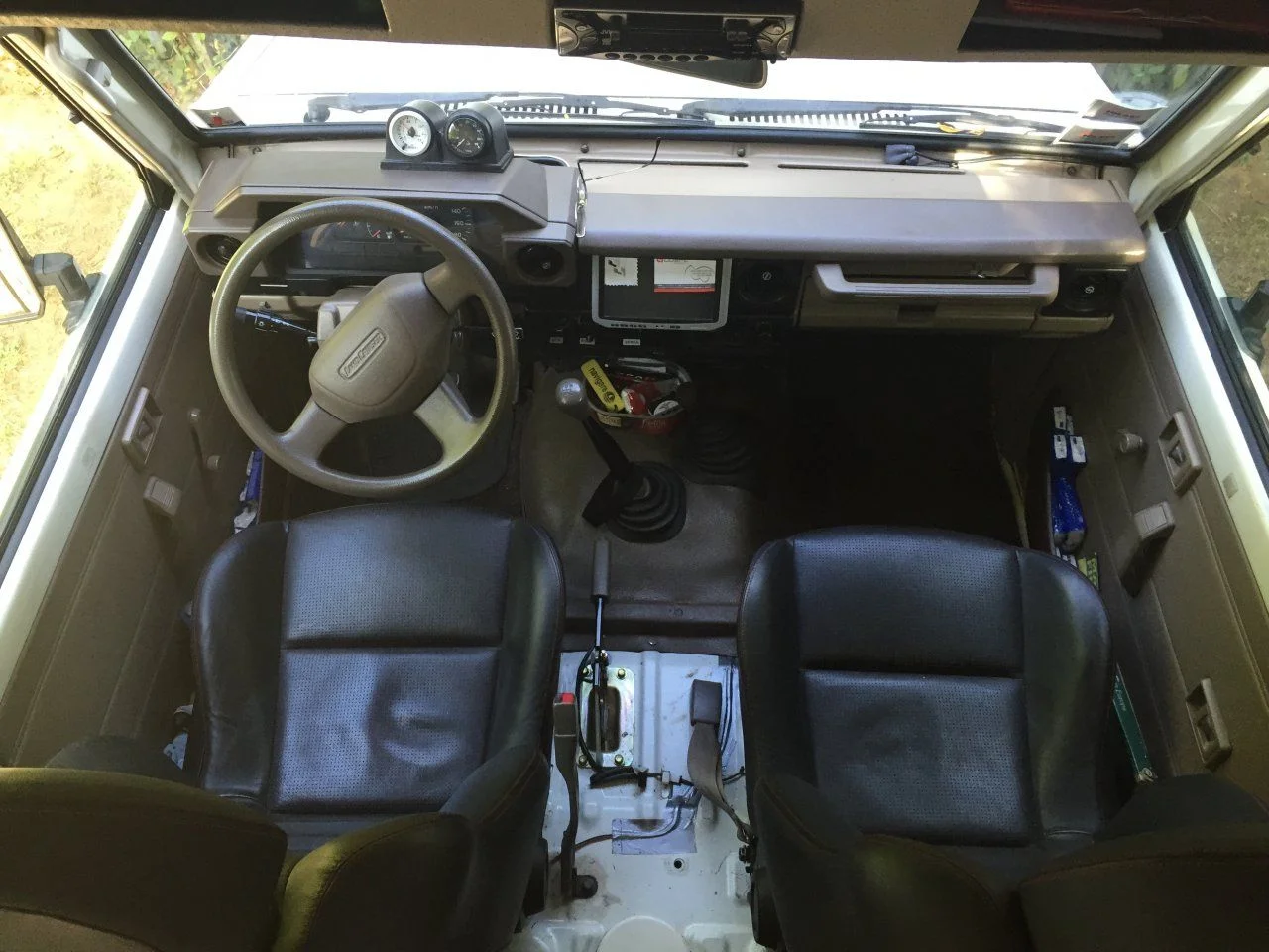

at last I am driving my Toyota !
here it is
the interior is not finished yet , I hope this week .

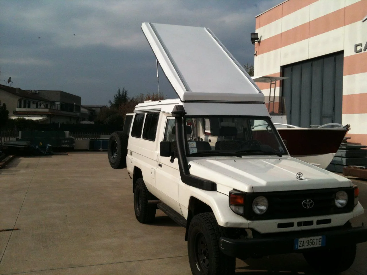

the out side is done , with all rails for side veranda , back veranda , and roof rack.
in these days it's raining like hell , it's the best test to see if it is water tight.

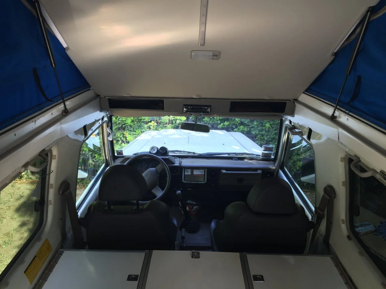

the inside head room is eaven more then original .

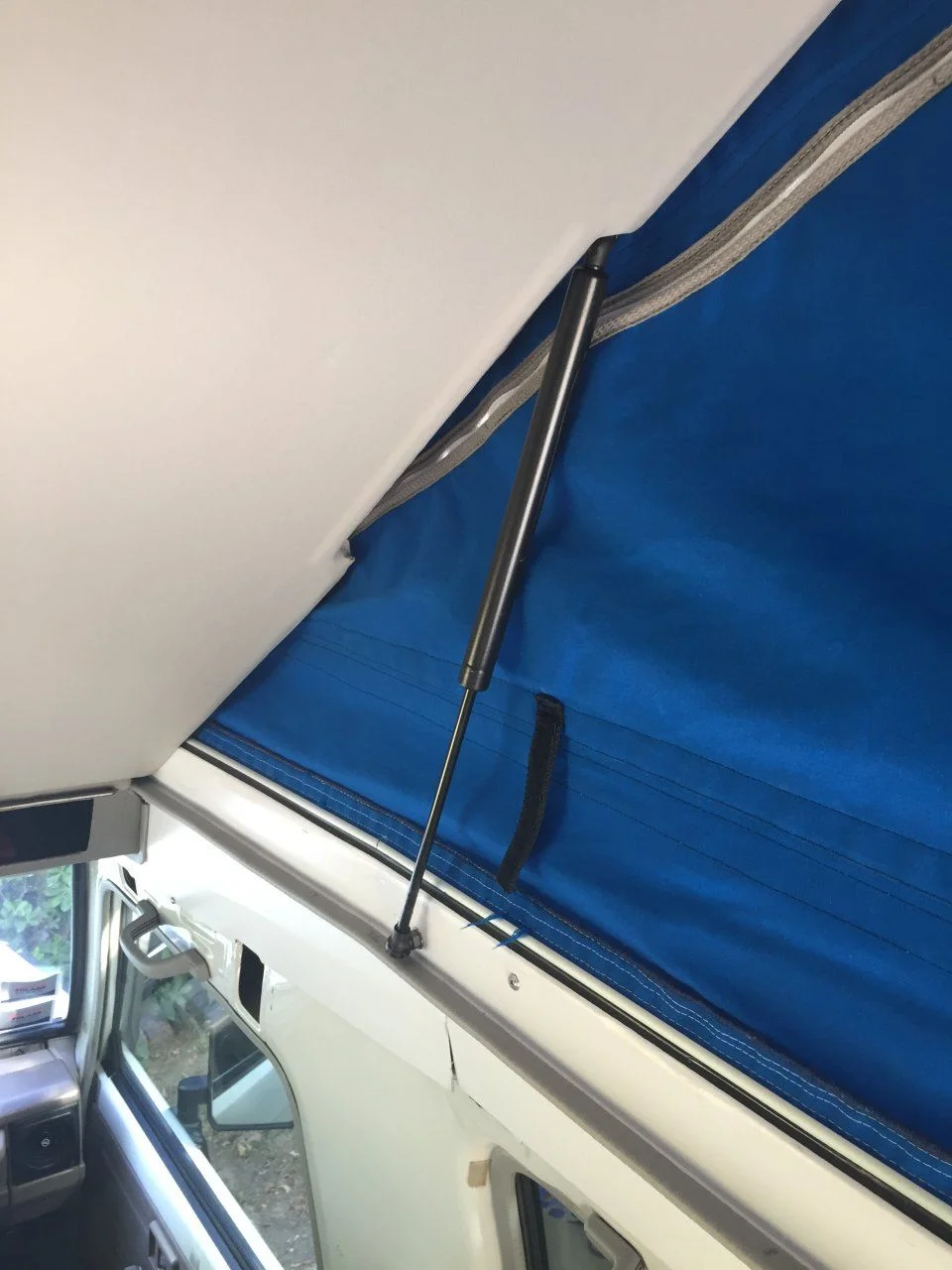

the bed panel is working very nicely , as well as the roof hydraulic pumps.
no strange noises , I still have to pull some electric wire , then I will add some foam to damp even more any roof noise reflection .

I am doing the interior , side panels , roof panel , wiring for different lights ecc.
small jobs with a LOT of work.

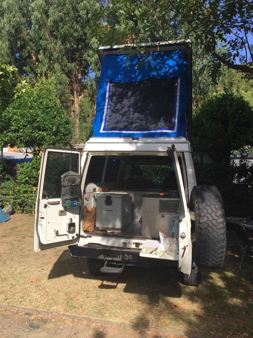

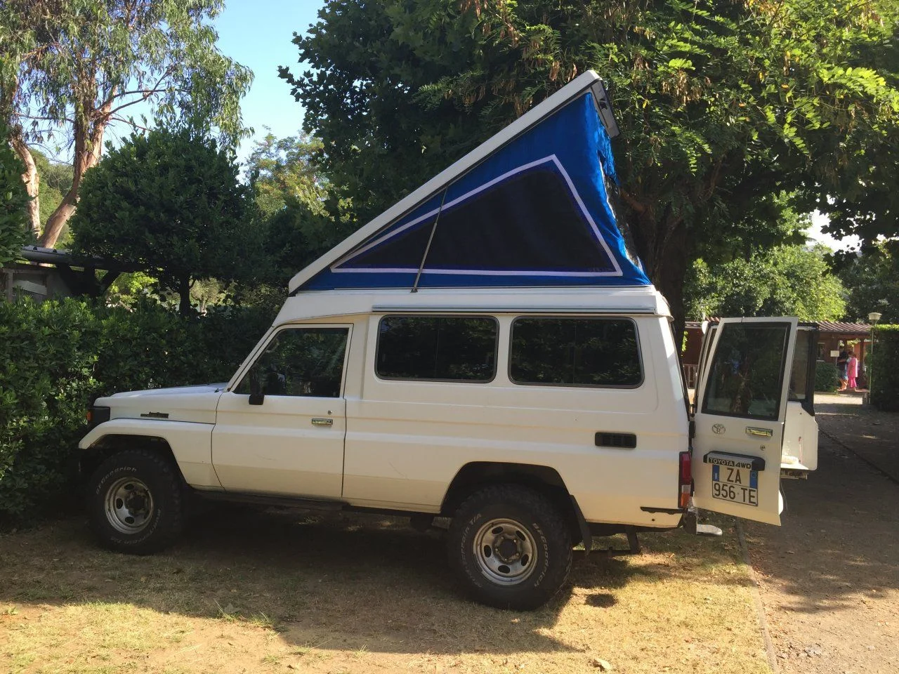

Hi Guys , sorry for the long absence , but due to Work and endless finishing details, I Was able to enjoy Only recently
My new popup roof.
Some more pictures Will follow shortly.
@ Globetrotogragher , I haven't aswered to You earlier because I didn't had any pratical experience on the popup roof.
Non after testing ,I can say that the torsion box before is slightly more stiff.
With the popup, I see Only an littel difference.
Still very acceptable in off road .
All the body is very silent also on toule ondule, and no deformation has been noticed.
A major helping factor are the bed rails, that help keep in shape the body.
When closed the roof presses the matreass , which is pressing the bed platform on the bed rails.
The tollerance between bed platform and rails is Just 3 mm each side.
Photos Will follow to,illustrate.
