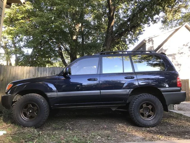

Well, finally got my TD springs/strut/TB and SPC uca’s installed. Still need to get it aligned before I take it out and about. Rears are sitting a little high. I went with 41/45 and medium (gold) springs. Not sure I have much more play left with my torsion bars. So we’ll see how this settles.
Did you go with the 3"?
How much is measured droop in the front with BOTH wheels off the ground? Also, try measuring it with the swaybar links unhooked in the front. Check the bar is not hitting anything and getting stuck when you jack it up. I don't think the rear looks high... it does not look like you have enough height in the front, actually.
Also , you should have all the adjustment in the world with the new TBs if they were indexed right when they were installed. Easy way with new bars - ignore the painted index marks. Remove the front brackets after undoing the adjuster. Remove the bar. Zip tie the adjuster to the frame, all the way high. Insert the bar, re-do the bracket bolts. That will give you the maximum TB adjustment available.
^This. I have the TD tb’s as well, and while they’re a little tricky to properly install especially if you aren’t very familiar with how tb’s function with the rest of the suspension system, they’re not impossible to do on your own. Regardless, you should have a large range of adjustability if they were installed correctly. Based on what you said it sounds like they were not and you might want to reindex them following @gatormark91 advice and the torsion bar thread in the FAQ before getting an alignment.
Thanks guys. I’ll take a look. I’ve installed all sorts of suspensions on different cars but this my first go with TB. I did briefly go over that TB 101 thread in the FAQ. When I installed the TB I aligned the painted markings from TD with the torsion arm. The rear I offset 5 splines to the anchor arm according to several instructions. I did install new sway bar end links too.
I’m a total noob to this torsion bar stuff so I’ll look into the indexing.
I agree as well, i went with the predetermined marks on the bar (the other was wiped off) and the truck was almost on the bump stops. I reindexed them last night and i'm even not halfway through the threads and it's where i want it to be height wise.
i didn't count threads or anything, just zip tie the adjuster, and slide the front mount on whatever teeth are lined up to make bolting the front mount possible. then you need to crank each side to where you can get the right and left side height even with each other. a jack with high lift is really handy here. jack it up from the middle support, stick your arm and turn the adjusters then take it for a spin. I had to do it three times. I think every 3 turns is an inch give or take.
