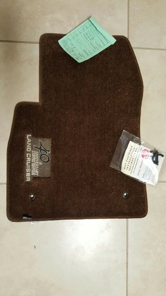

Better IMO as Llyods makes the best floor mats out there based on my research.

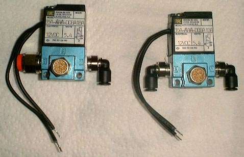

-I asked the crew at Slee about the ARB lockers and the OEM knob retrofit they did. They mentioned that I will not have the option to lock just the front locker. I can lock the rear only and then I can lock the rear plus the front. They mentioned locking the front only isnt likely to be needed. Anyway, they also said if for some random reason I needed to I could always disconnect the airline from the rear locker and then switch the knob to FF+RR and I would have just the front lockers locked. Once again they stated I should really never need to do so.

If you need to disconnect the air line(s) you can also use a MAC valve (from George's site):
ARB airlocker

I really would not worry about the lockers. I am with Slee. There is very very very few times that you might need your front locker but not your rear in an 80 series, especially an 80 as pretty as yours. Let's face it we are not driving competition buggies there is no need for front digs, etc. But there are many occasions you might want to leave your rear locked and unlock your front locker for tight turns etc. I think your setup is very nice and the OEM'ness of it is much better than big red switches.
