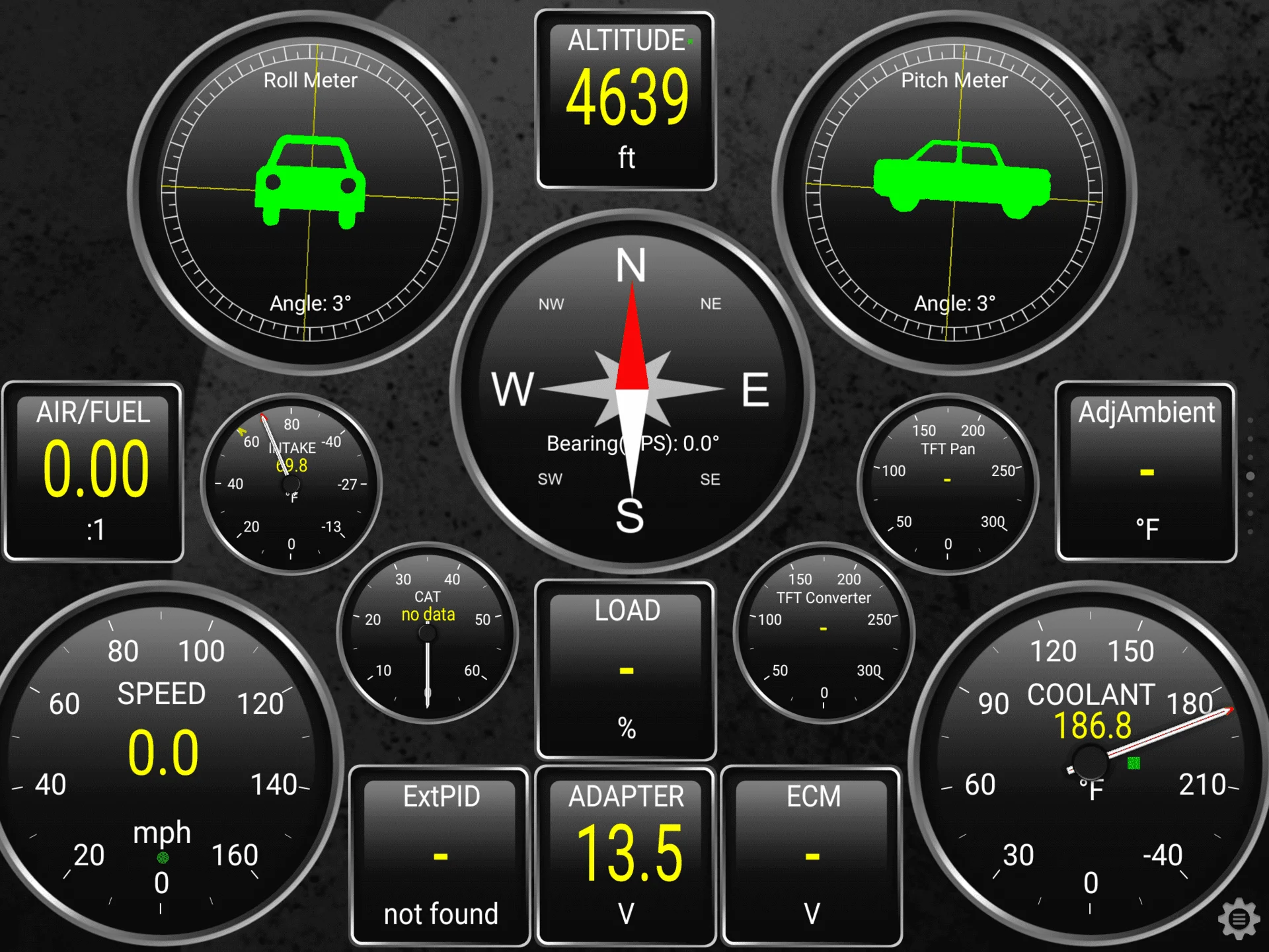

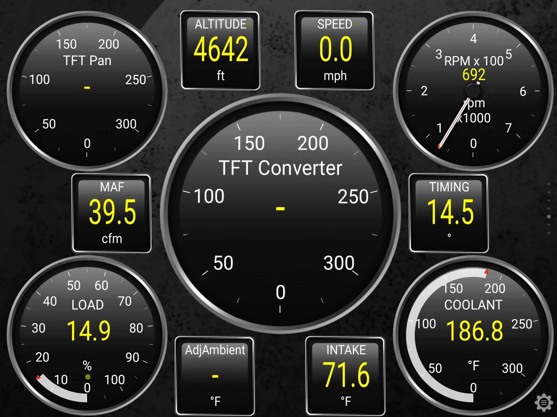

Below are the screenshots of Torque Pro using Lifestyle's CSV file.

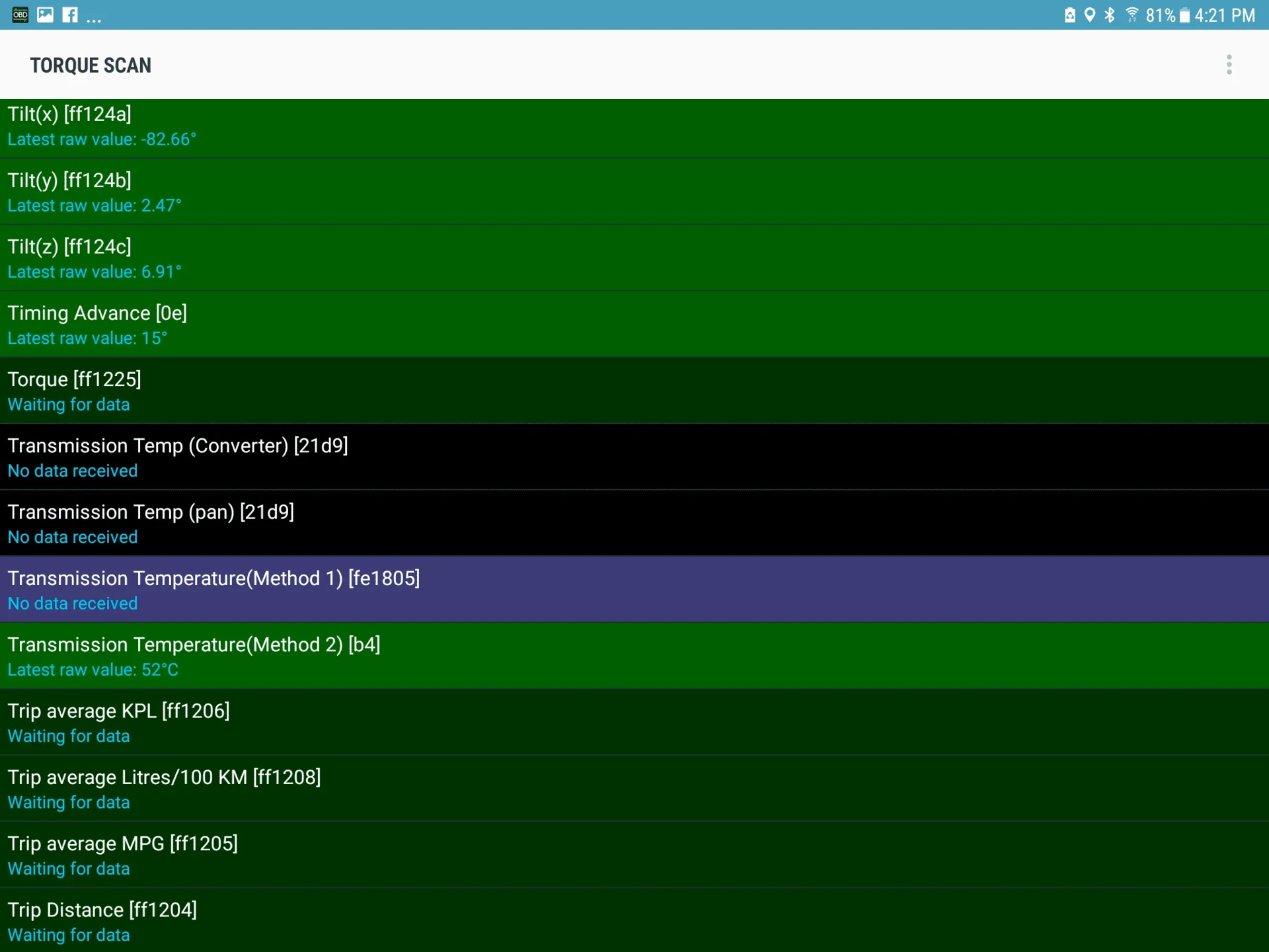

Here are the Torque Scan results which shows transmission temps - so I'll go back and try the defaults that were in Lifestyle's CSV.
Just pointing this out since it shows Method 2 works while Method 1 does not.
Don't know what that means yet though.

Here are the Torque Scan results which shows transmission temps showing - so I'll go back and try the defaults that were in Lifestyle's CSV.

Looking at the Torque Scan results suggests that at least one TT is available.
So I'll play w/ the formulas and PIDs to see if I can find the right one.

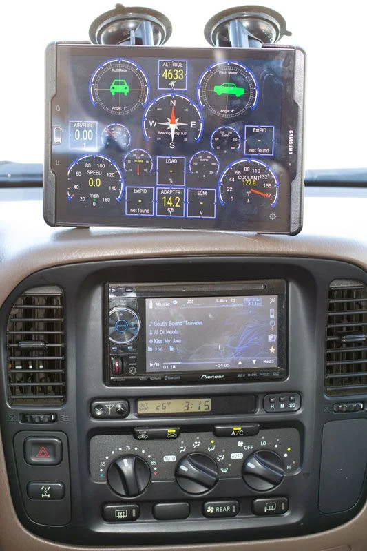

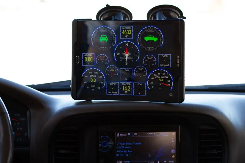

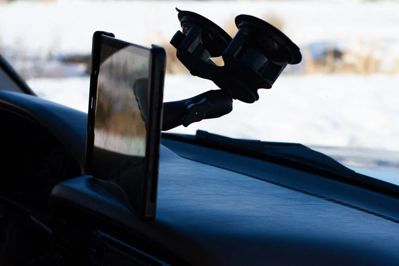

I modified it earlier this year to use one of @BenCC's mounts - the Make 6 V.6 change holder mount.
I still have the windshield mount but decided I like the tablet a little closer and down in the dash so it gets some A/C on it.
Having the tablet on the dash in the summer it got real hot. HTH.
