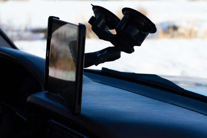

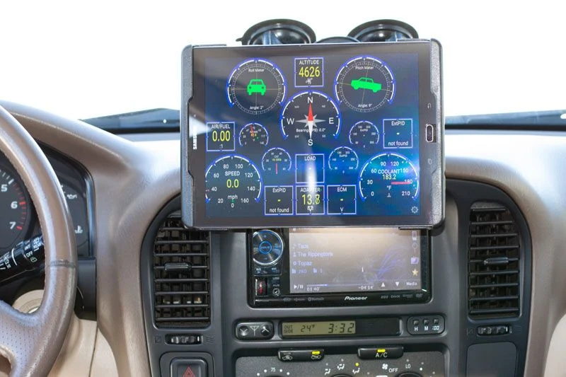

Thank you exactly what I was looking for. Can you take and post a pic of your setup?
Are the double ball mounts for tilting and spinning the tablet?
Yes, exactly. The arm sits on or just above the front lip of the dash.
So it's mostly out of the sun to reduce glare and can be adjusted depending on what viewing angle you want.
Since I'm setting it up today to go on a trip this weekend I'll take some photos and post here later.

Here are a few photos - the first set are with just one arm attached and with the tablet resting on top of the dash.
The second set of photos show it with two arms attached and the tablet located on the front lip of the top of the dash.
