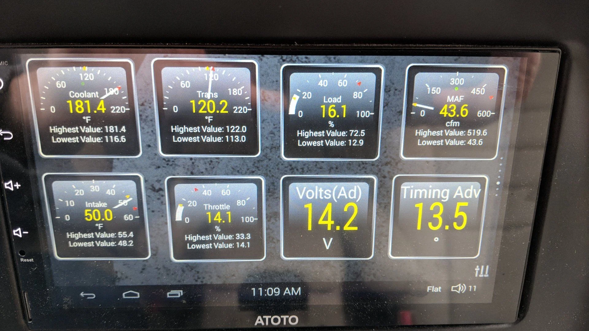

In addition to the above, I also watch the MAF sensor values.
The MAF sensor gave me stalling and misfiring issues when I first bought my cruiser, so I keep an eye on it for erroneous readings.

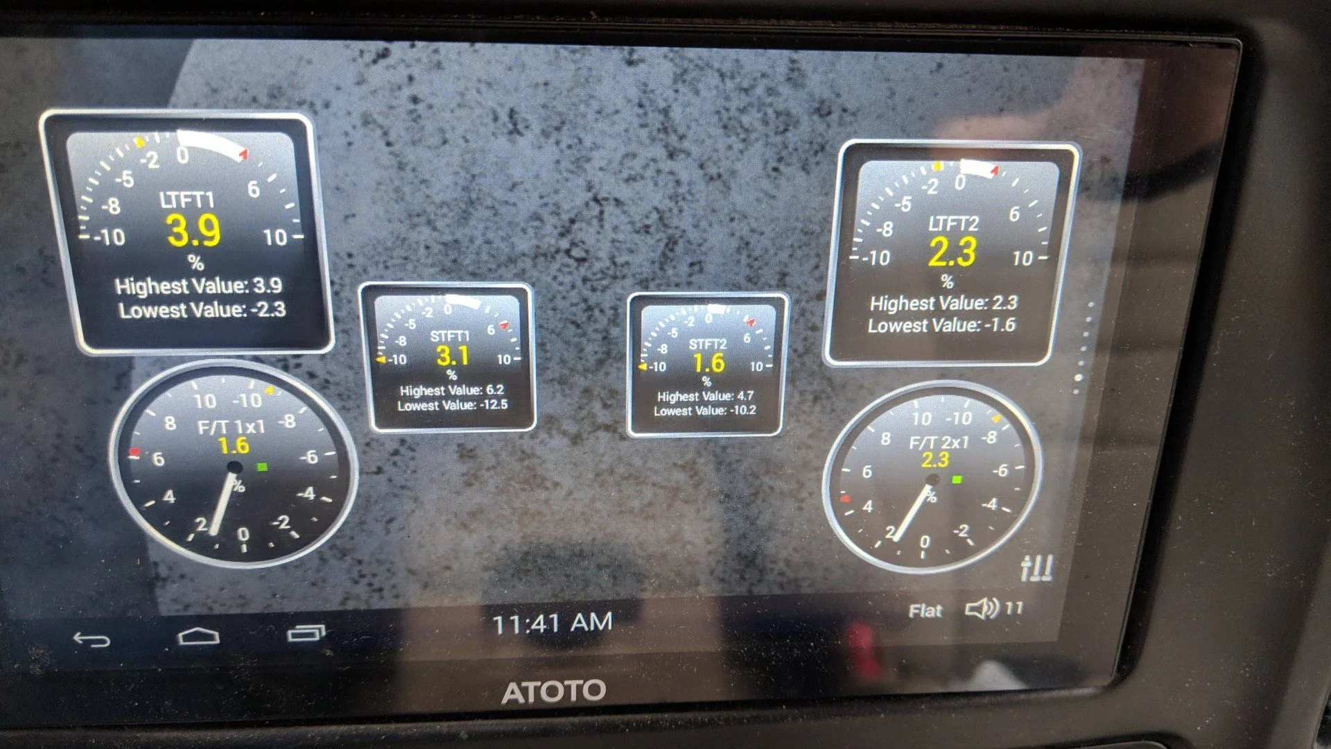

I run Torque at least once a day. Ran it to lunch today, hence the low coolant temperature. I also monitor the fuel trims. Transmission temperature worked right out of the 'box' for my 99 :confused:
Which voltage and intake temperature option are you using?
Why all the fuel trim monitoring?
Voltage @ the OBD port. I do not recall another intake temperature option, but it has been a couple of years.
Short Term, Long Term and plain fuel trim, for both engine banks. I like to watch fuel trims because you can pinpoint lazy O2 sensors, which bank a failing coil is on and if the injectors are having issues. This isn't a screen I regularly monitor.

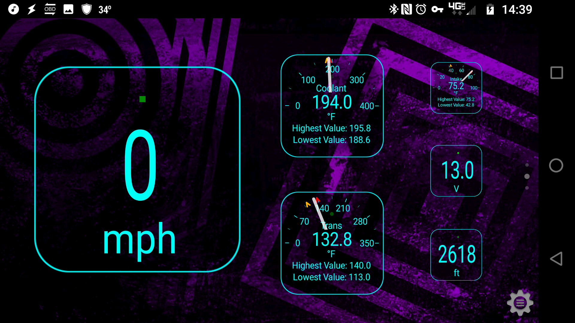

Pretty happy with this setup for the main page
The speed gauge is GPS speed (speedo is 10% slow due to bigger tires)
