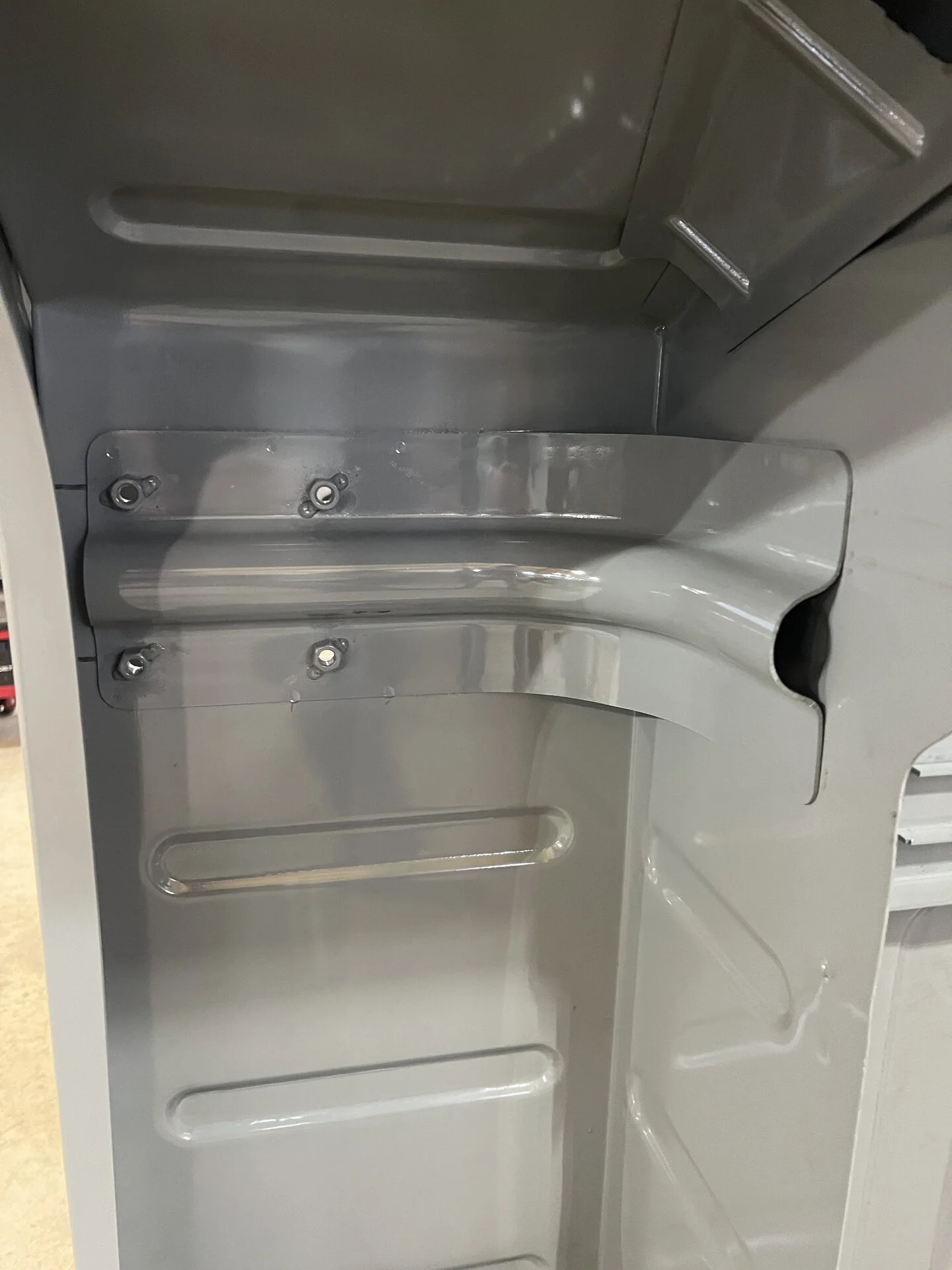

I would buy their parts and assemble myself after seeing this. The various pieces seem ok but the attention to detail of assembly is , well, not very good at all. Look at the pic Conde circled, WTF, sending that out and wiping sealer over the seams they probably didnt even spot weld is crappy and they tack weld the other panels where there should be full welds along the edges, like where tub /cowl/dash mate.
I appreciate the company bringing the availability to the market and the pieces look good, sell the parts and let others assemble, IMO.
Nothing against Topnault at all, great to see new vendors in the space, they make panels/parts well, they seem to have trouble with quality control when assembling pieces together. IMO due to minor changes over years it is very, very , very hard to offer a prebuilt tub that will be right fo rthe application.
I’m assuming the sealer was to hide some less than stellar welds. It’s all coming off, cleaned up, and prepped correctly for paint. Another 8 man hours would have done wonders for a better finished product. I would prefer no sealer at all since it’s clearly not “paint ready”.
I would consider anything on there to be shipping protection and nothing more.
You're going at it correctly, strip it and do it right.

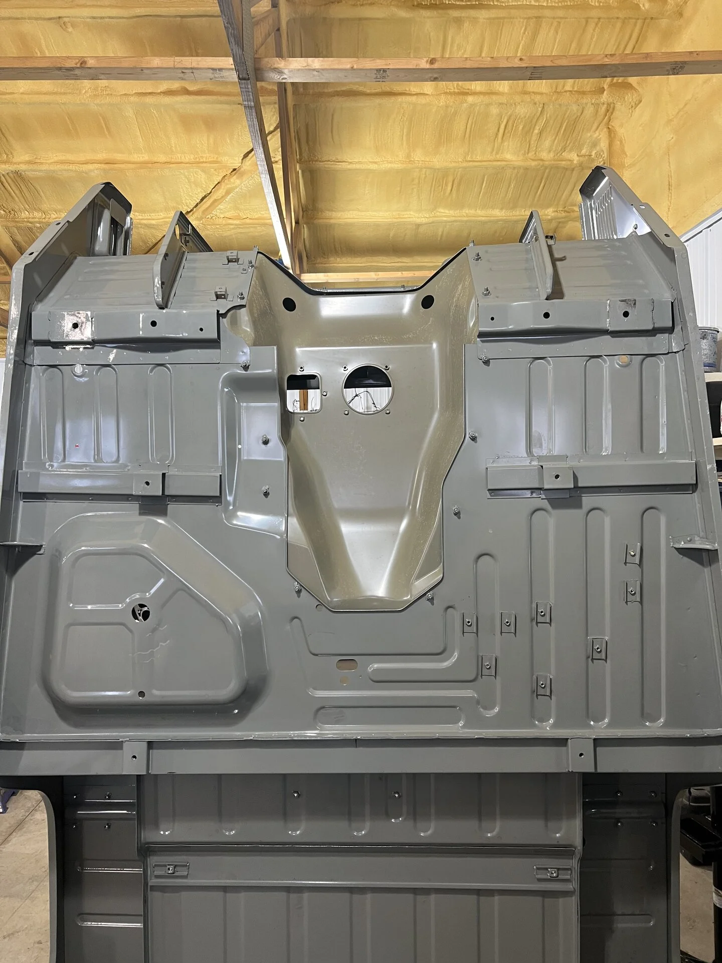

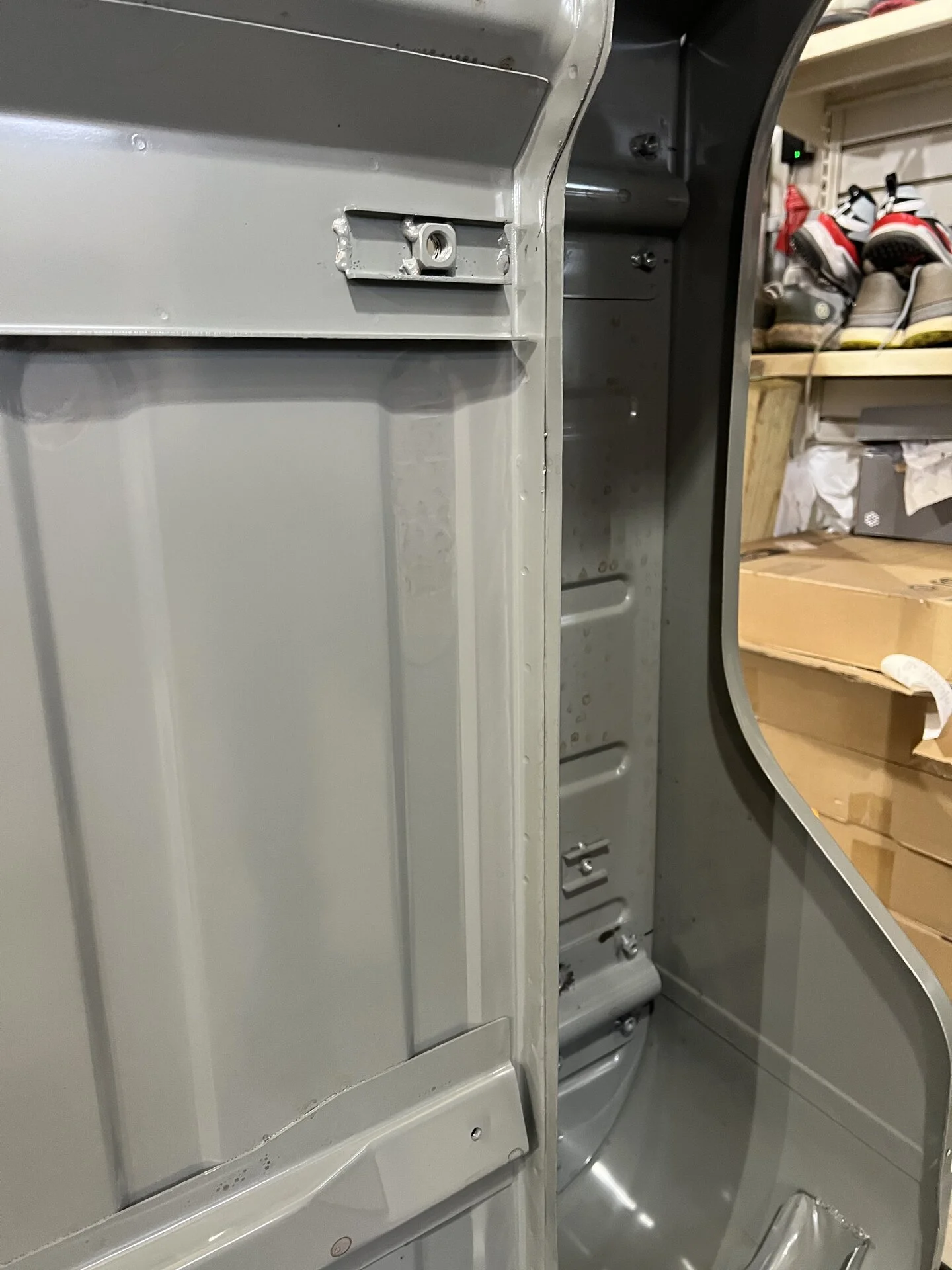

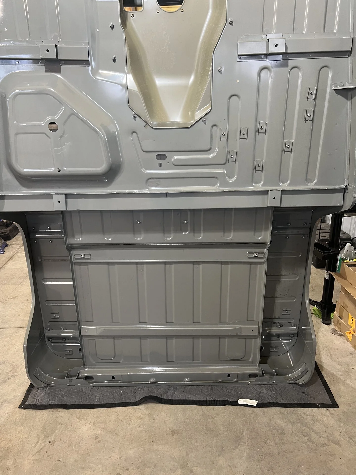

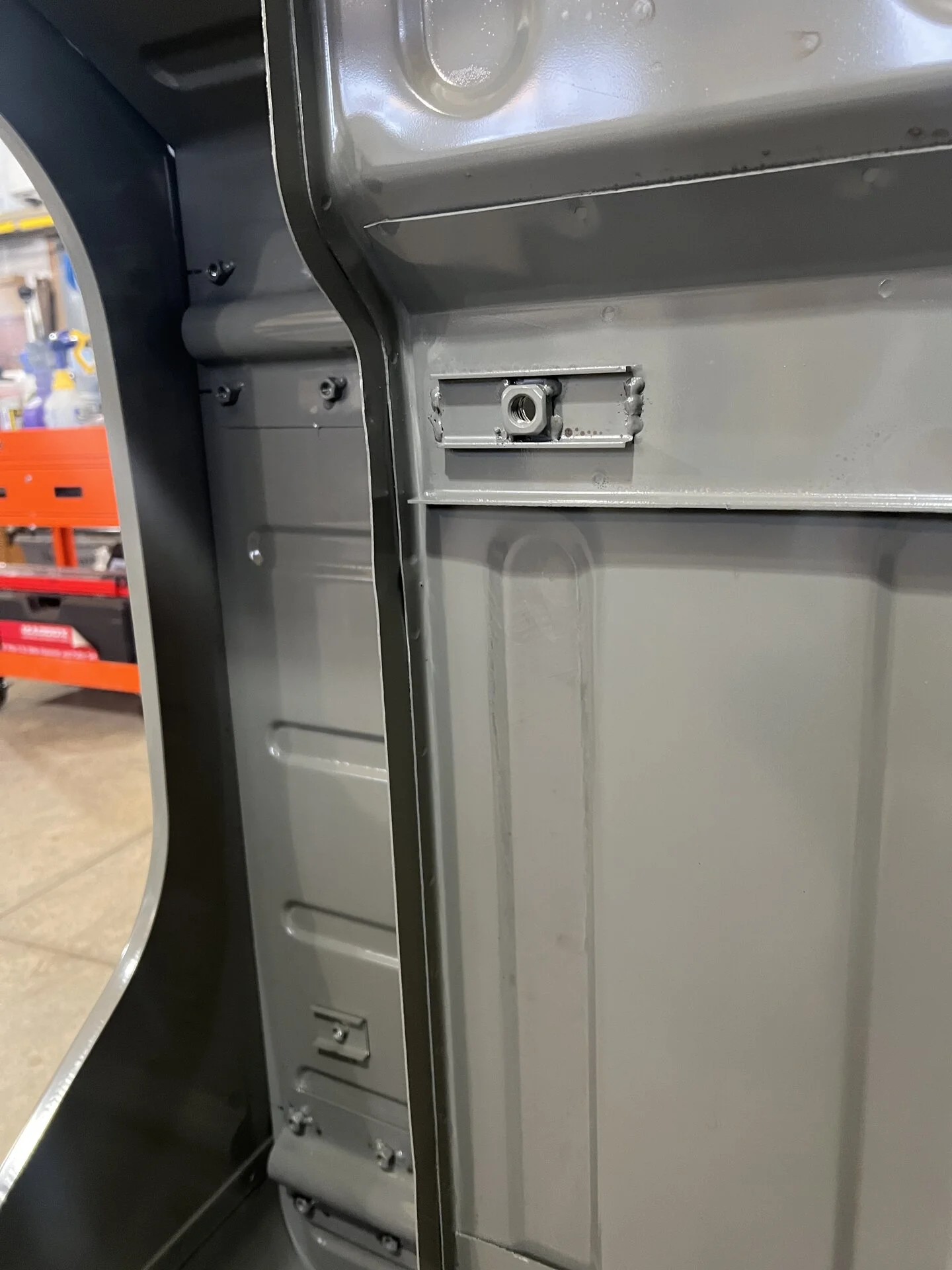

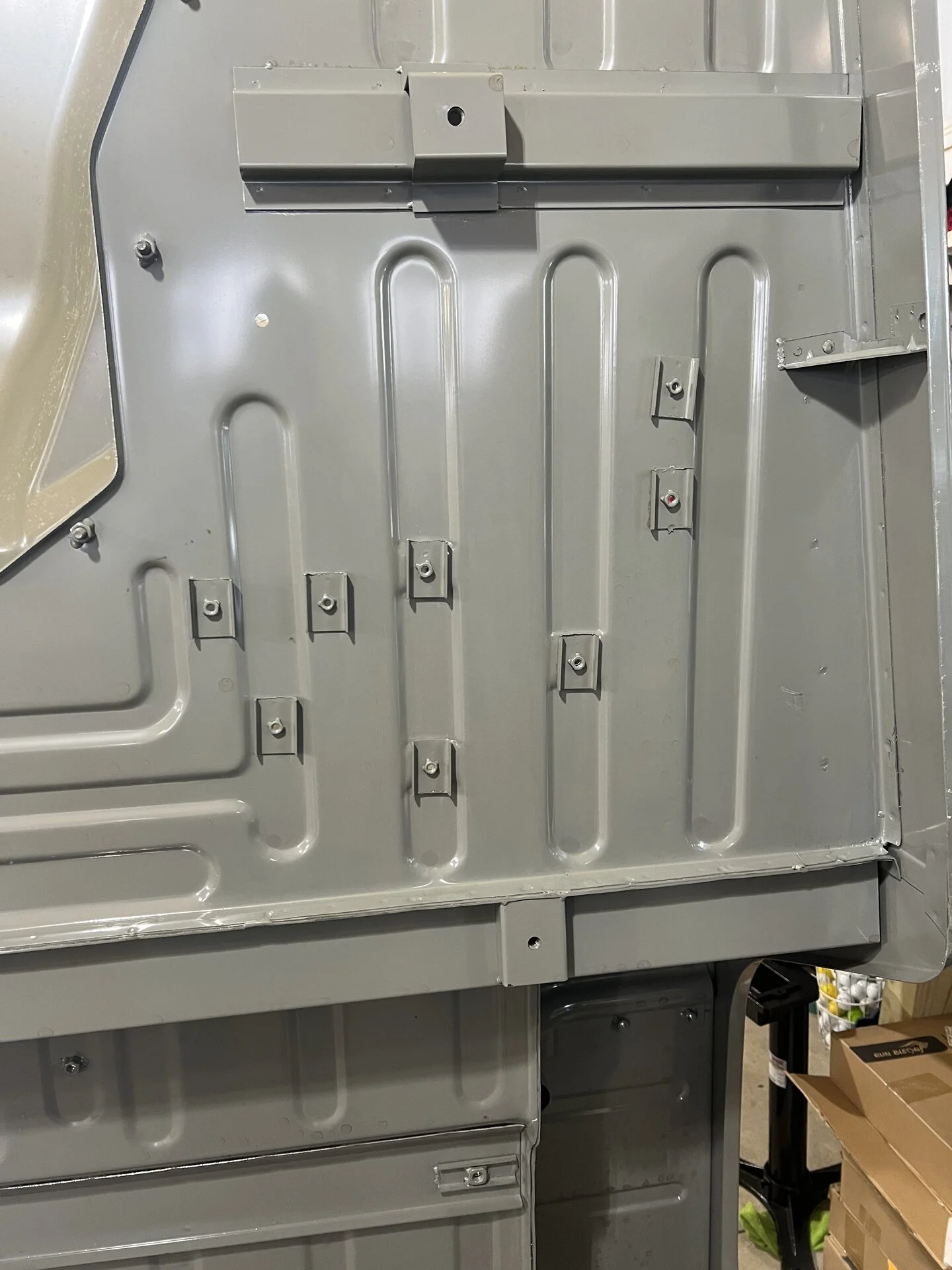

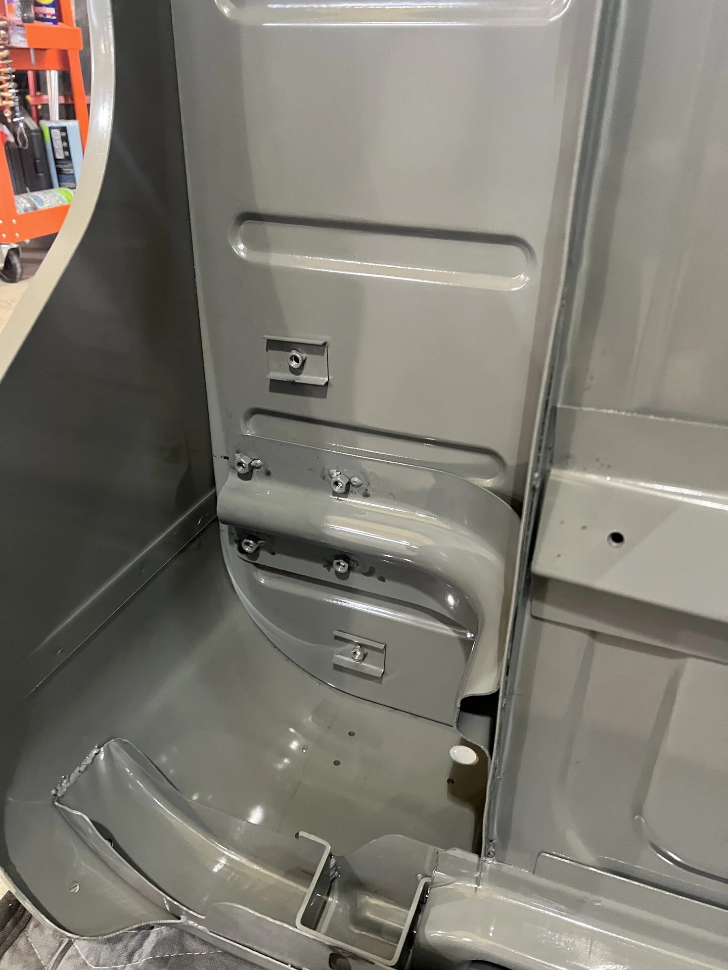

I took some pictures of the bottom to show the captured nuts and support.

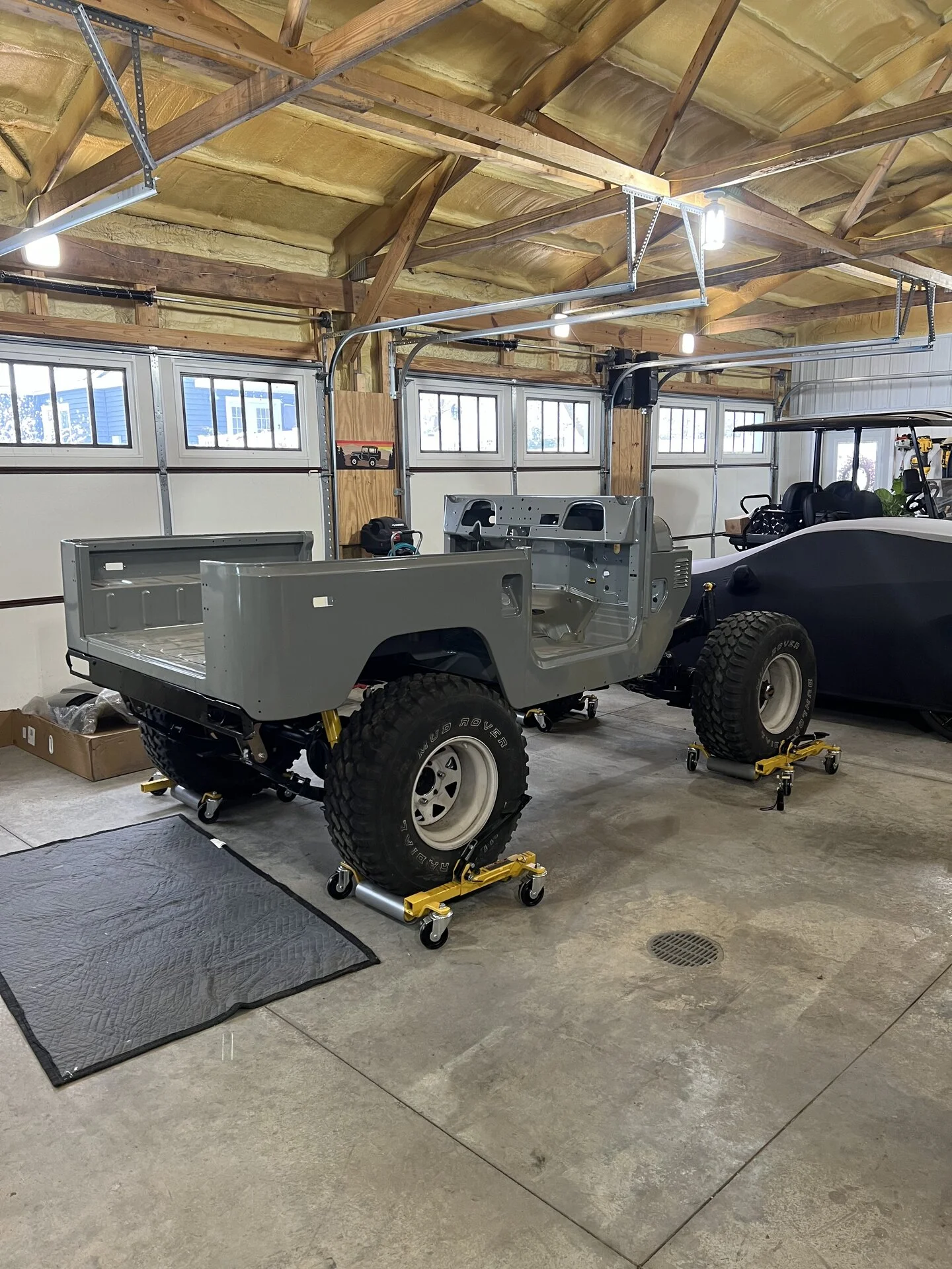

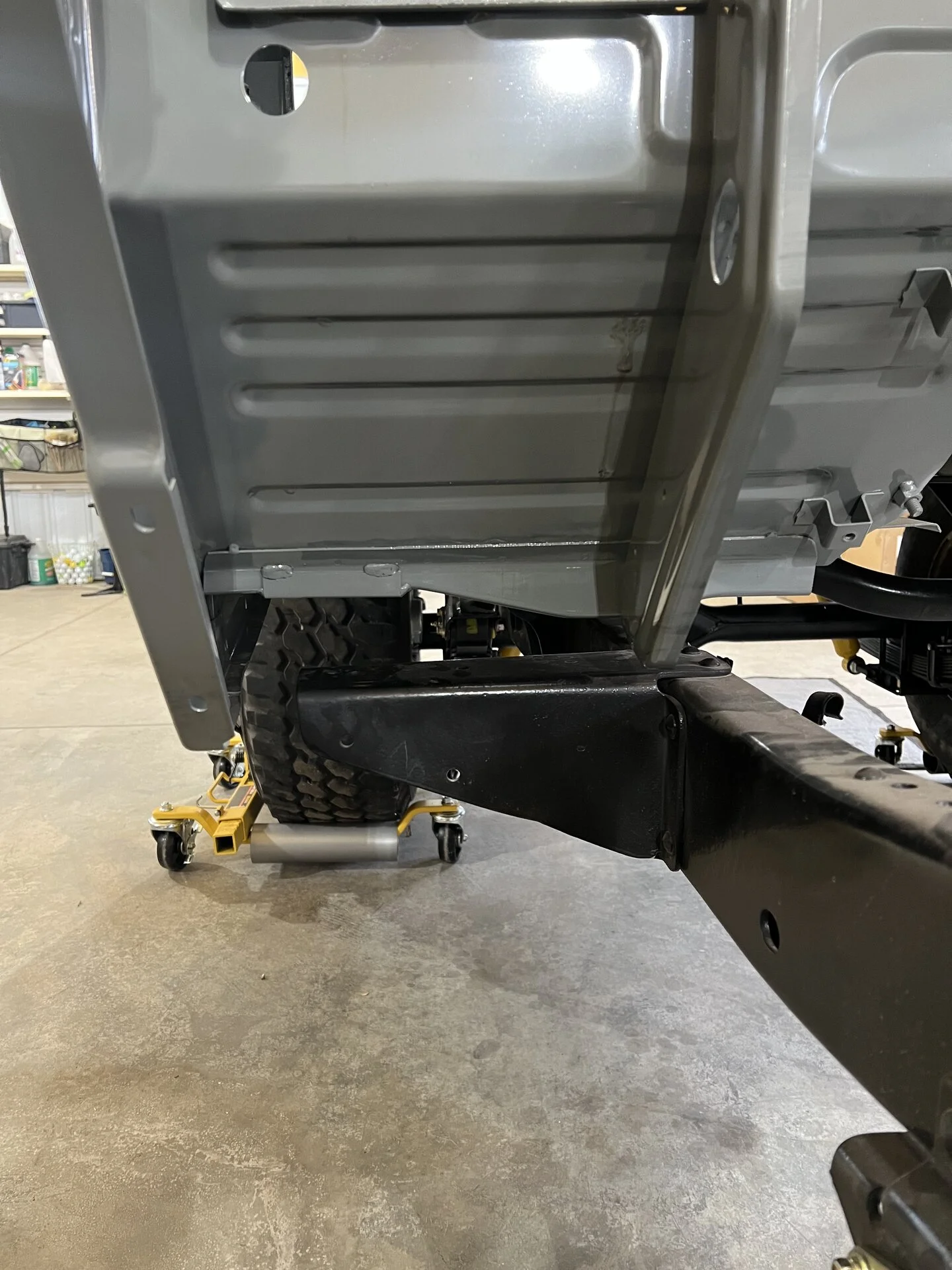

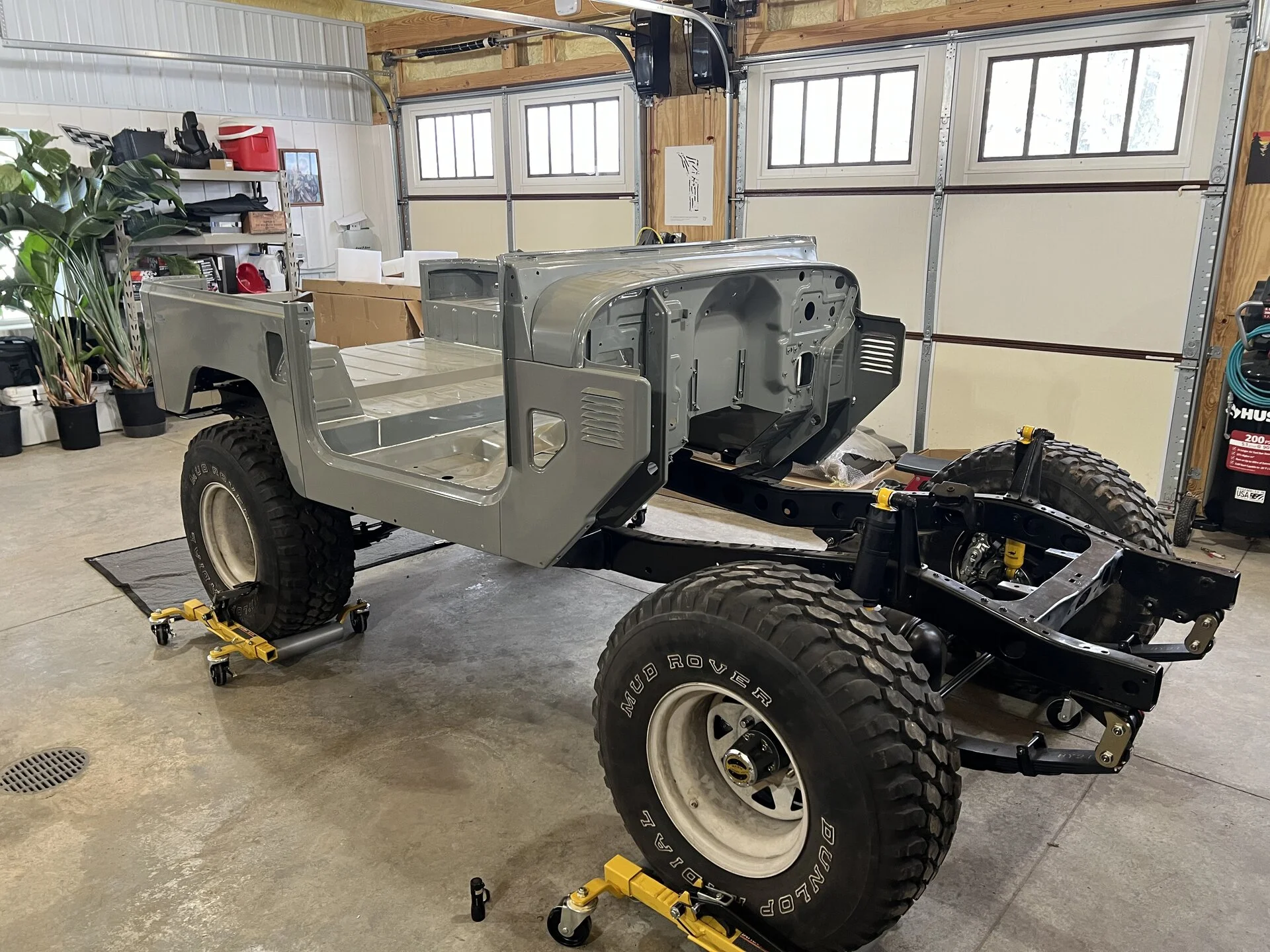

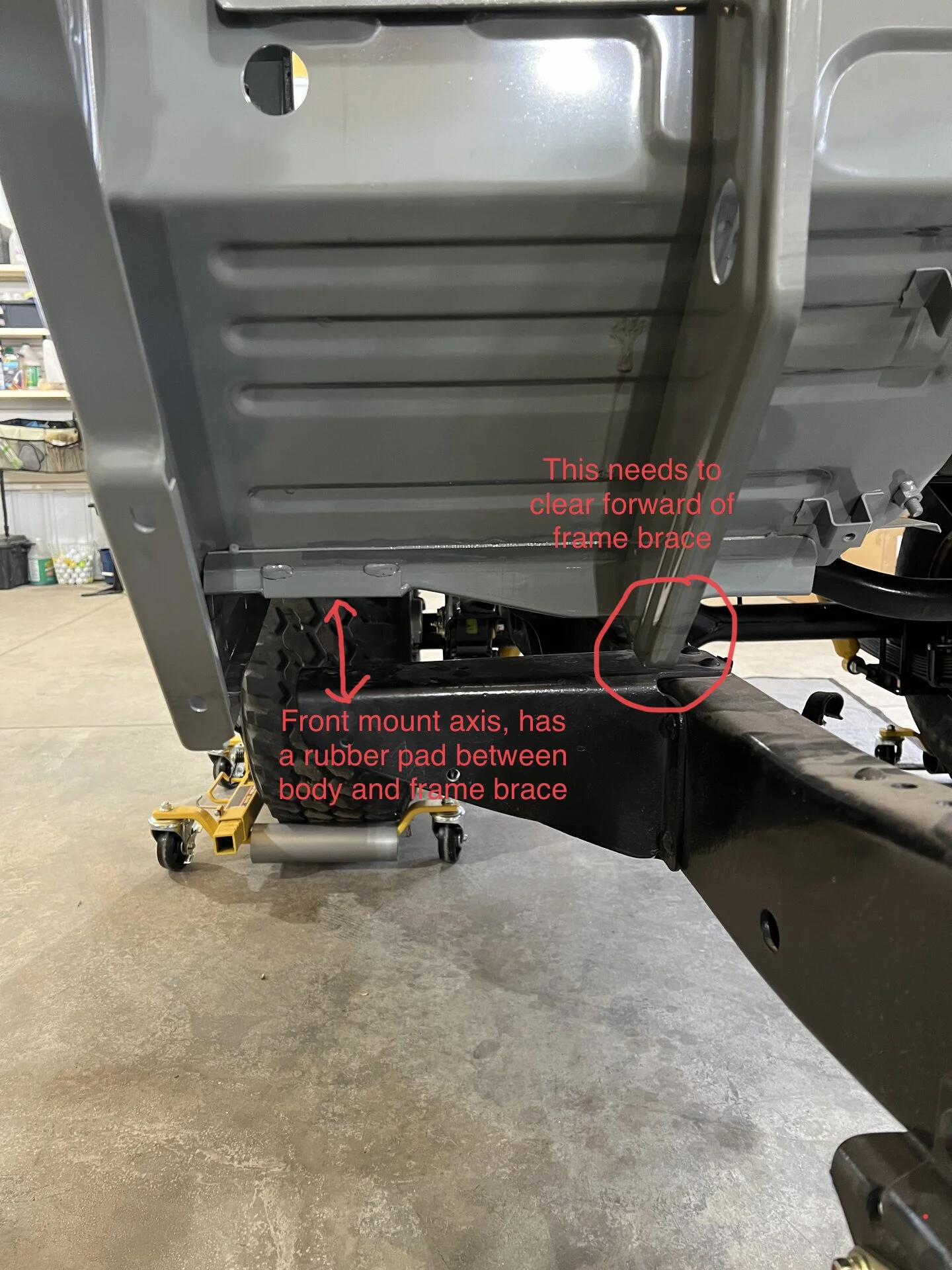

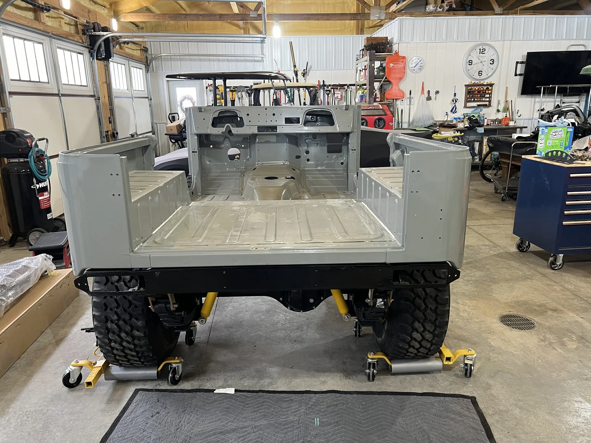

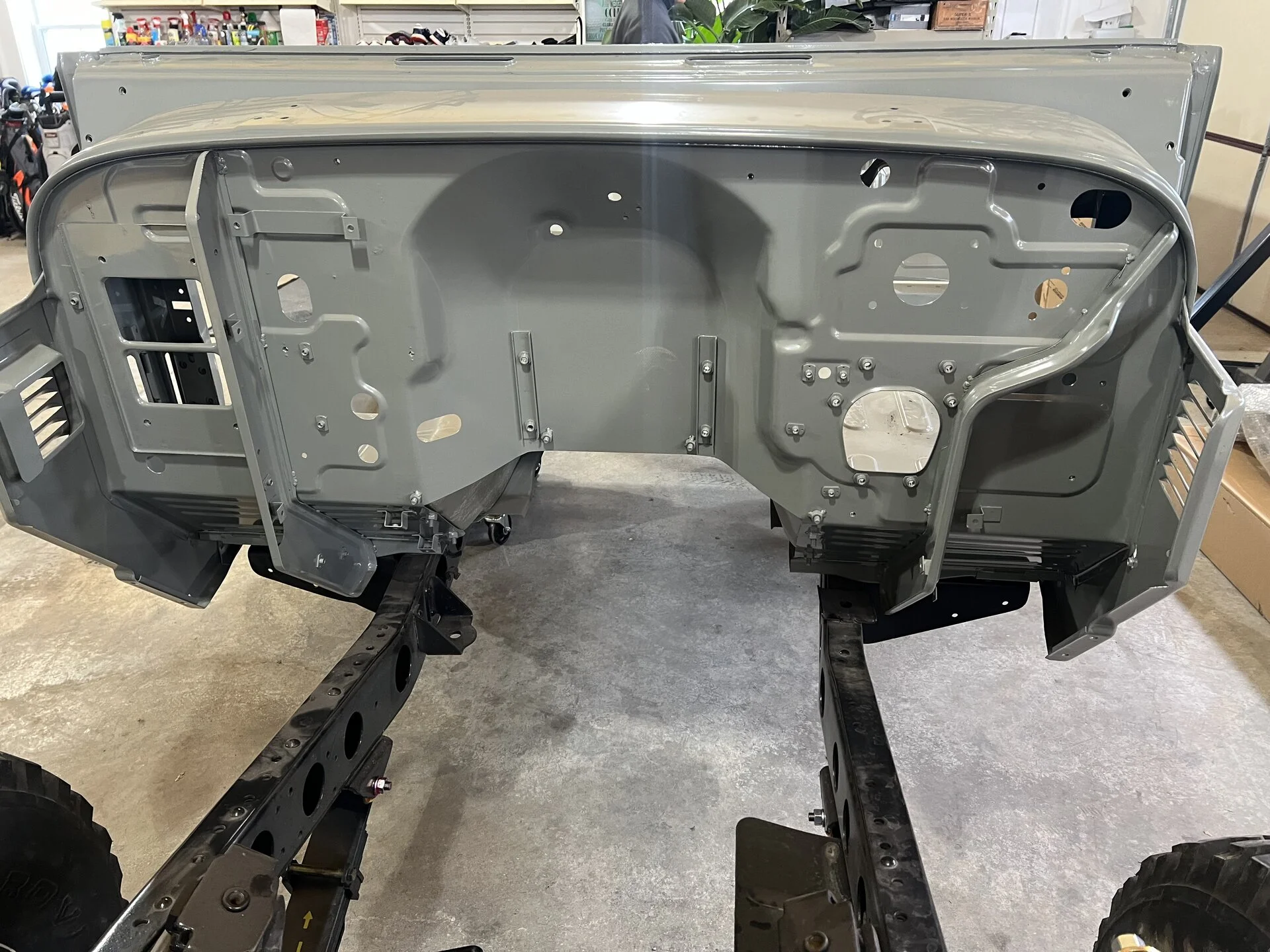

Say the tub on the frame this morning. As warned by the guys that we’re trying to work with Topnault, the body mounts aren’t even close. I was able to line up and bolt down the 2 by the rear tail lights. You can see in the picture that it’s 3-4” high on the front mount and no bracket there to bolt to. Luckily, I have the original tub to use for reference to make and modify brackets as needed. As of now, it’s teetering on the mounting point right in front of rear fender well as the high point.
That is special... I would go back and add more tacks to the nuts holding the cage in, those look like they would spin quick.
I appreciate that they are trying to work with you on this. You would think they would have one of each series there to compare and test fit on? I hope in the end this turns out to be a great alternative for those who want to keep an all steel body.
i thought 78s still have four body across the rear sill?
what's with the capture nut on the brace under the middle bed/bed transition? those should just be holes....the body mount bolt goes in from the inside of the cabin.
That brace is backwards, if it was the other way & then the support piece was added where it is the lowest it would match.
What brace?

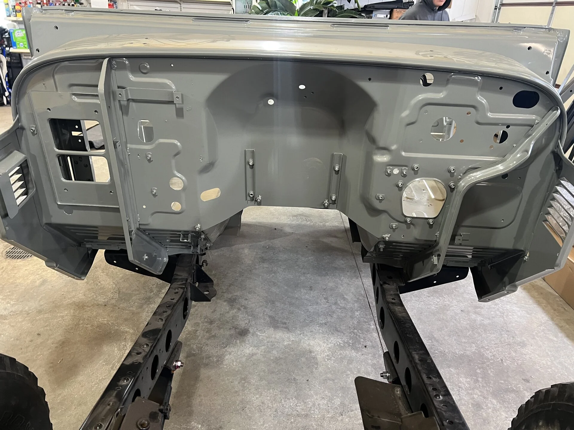

@brian @peesalot that’s the way mine are as shown (more or less). Looks like an overall length issue body mount-to-body mount. The firewall brace should sit just in front of the body mount/frame step support, looks like it’s resting on it.
@Papa Rich what happens if you set the tub in place with front body mounts sitting on (there will be a gap for the rubber body mount pad) the body mount support? Where do the aft body mounts fall wrt to their frame mount locations.
