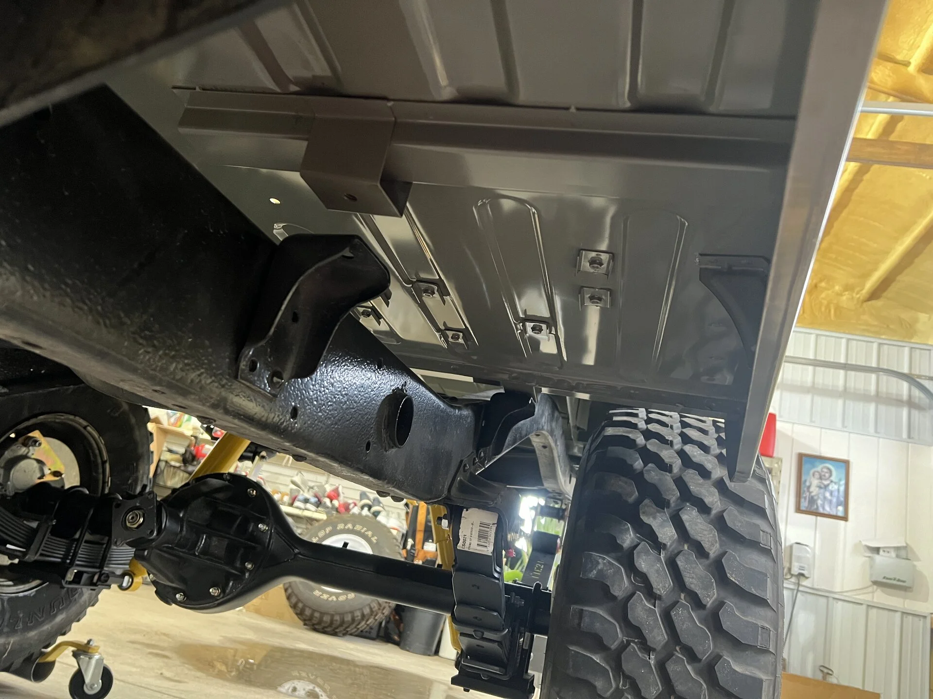

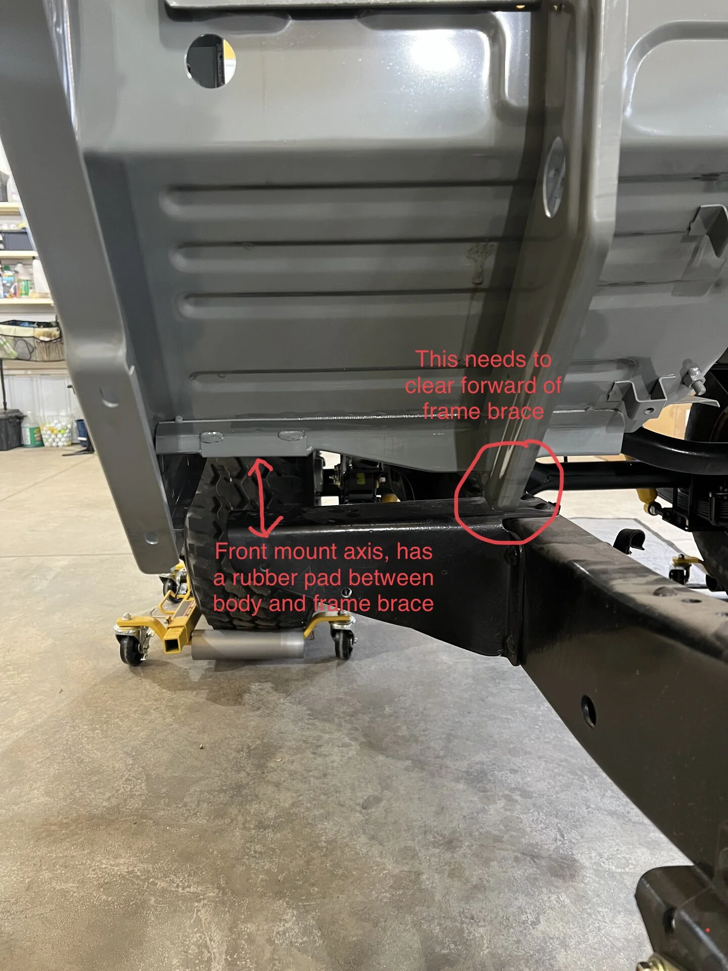

@brian @peesalot that’s the way mine are as shown (more or less). Looks like an overall length issue body mount-to-body mount. The firewall brace should sit just in front of the body mount/frame step support, looks like it’s resting on it.
@Papa Rich what happens if you set the tub in place with front body mounts sitting on (there will be a gap for the rubber body mount pad) the body mount support? Where do the aft body mounts fall wrt to their frame mount locations.

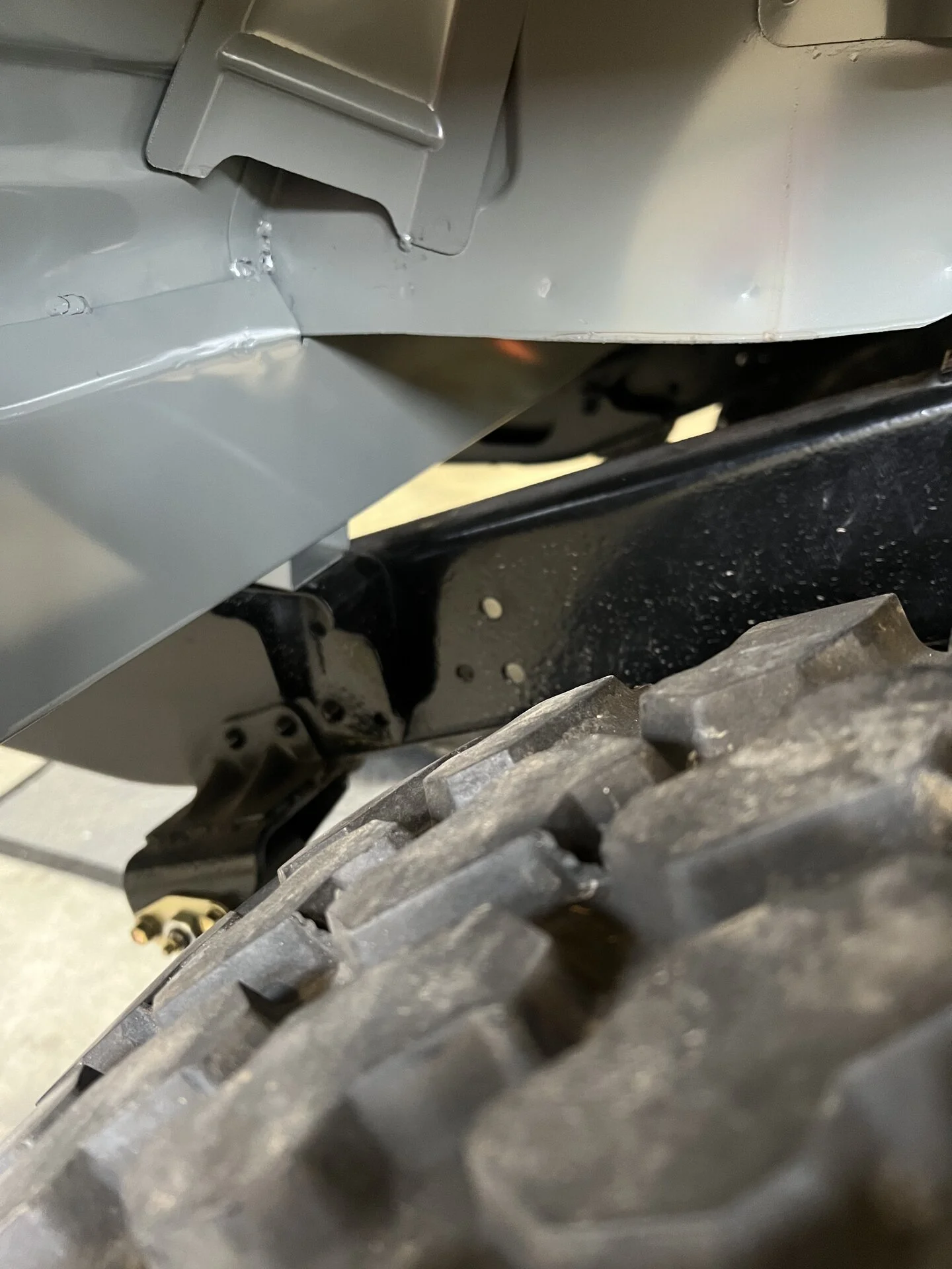

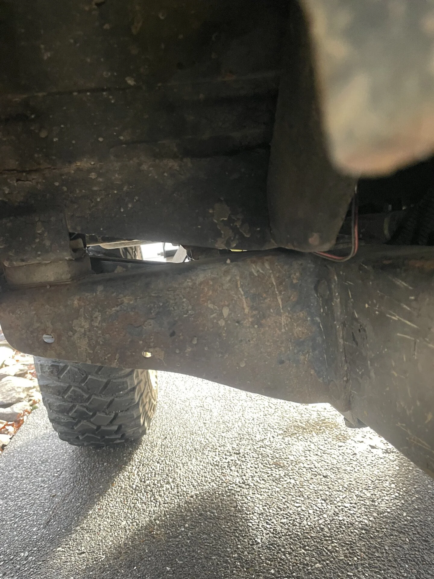

In this picture, 2 out of the 4 rear mounts across the bumper/rear frame rail are installed and bolted with the rubber body mount in place. I believe there needs to be a metal “stand off” bracket welded to the tub where your arrows are drawn. The one that is there is flat against the bottom of the tub. Where you drew the ⭕️ I don’t believe it will hit. I just closed up the garage for the day. I’ll check it out in the morning. I did mount a new fender and it’s not even close to mating to the tub, so what you are saying about it needing to move forward may be correct.

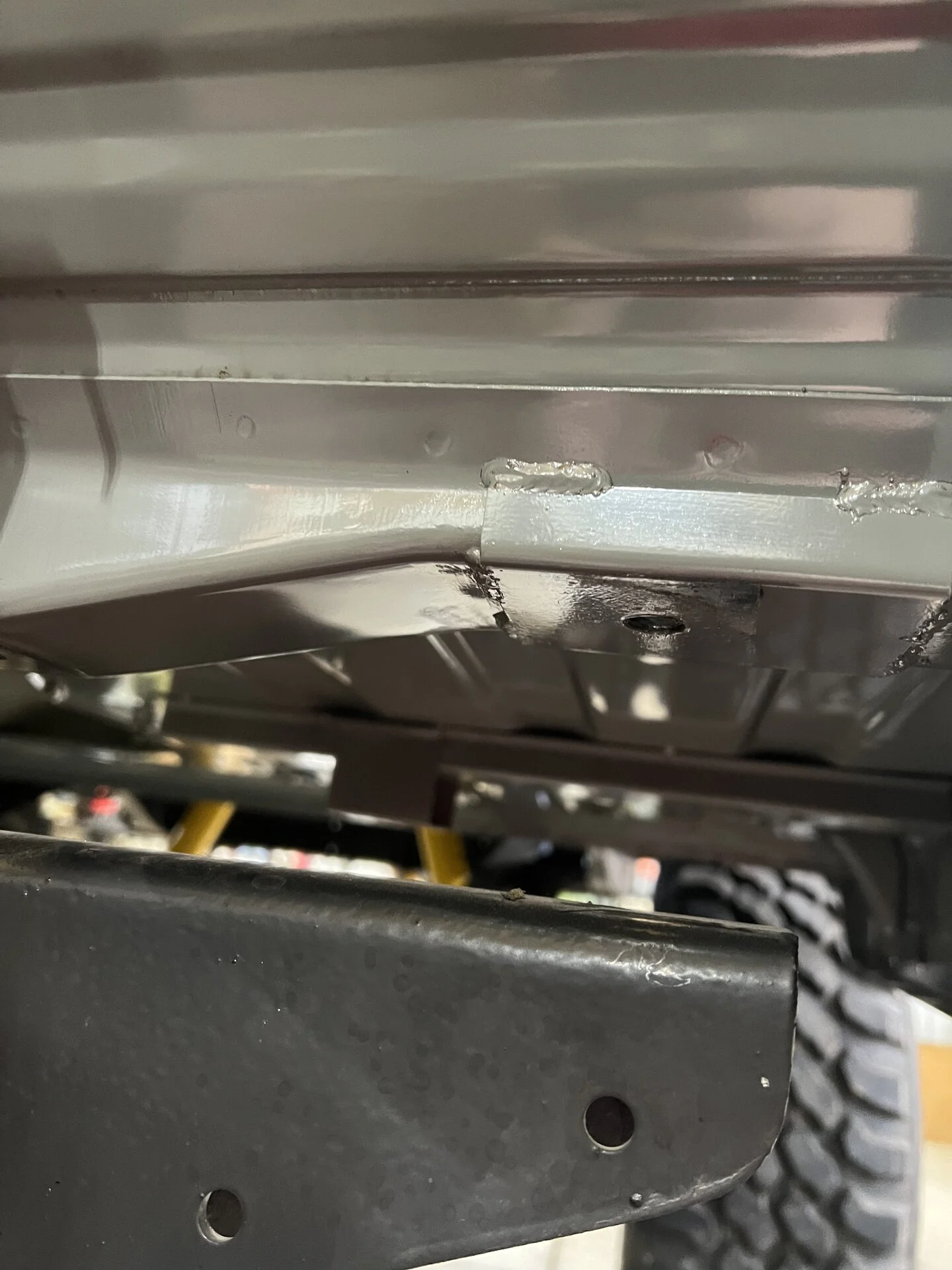

OK, just went out and looked, brace is correct and front of brace should sit almost flush with front of frame support lowest spot within 3/8 ' ish off frame, the piece they welded on above mount should have been dropped down with a 1" ish gap & mine has a 5/8" ish pad/body mount so that will have to drop down, the sides of the bracket that drops off the brace on mine are longer , on the ones in your pic it does not look like the side will be long enough to let you drop it down the factory amount. trying to load pic?
That would be great. What year is yours? Anyone that has pictures of the body mounting positions is greatly appreciated!
70' and I just noticed the overall hiegth of the bracket compared to mine is less,, meaning it does not drop down as far to start with. Cut that standoff thats not a stand off off and build one to fit. I can measure the distance from bottom of pass floor to bottom of standoff so you can get an idea of the right tub hiegth at those mounts.

That piece of angle or what ever it is that they have tacked on needs to go in the garbage . There is no way to add the top part of the body bushing with it like it is . Cut that piece off and make a piece . I am going to say that the QC from TP is about what i would figure for Grade A Crap .
I would buy their parts and assemble myself after seeing this. The various pieces seem ok but the attention to detail of assembly is , well, not very good at all. Look at the pic Conde circled, WTF, sending that out and wiping sealer over the seams they probably didnt even spot weld is crappy and they tack weld the other panels where there should be full welds along the edges, like where tub /cowl/dash mate.

The rear crossmember looks more like 79+ and the front mounts looks like it was flipped as others have said.

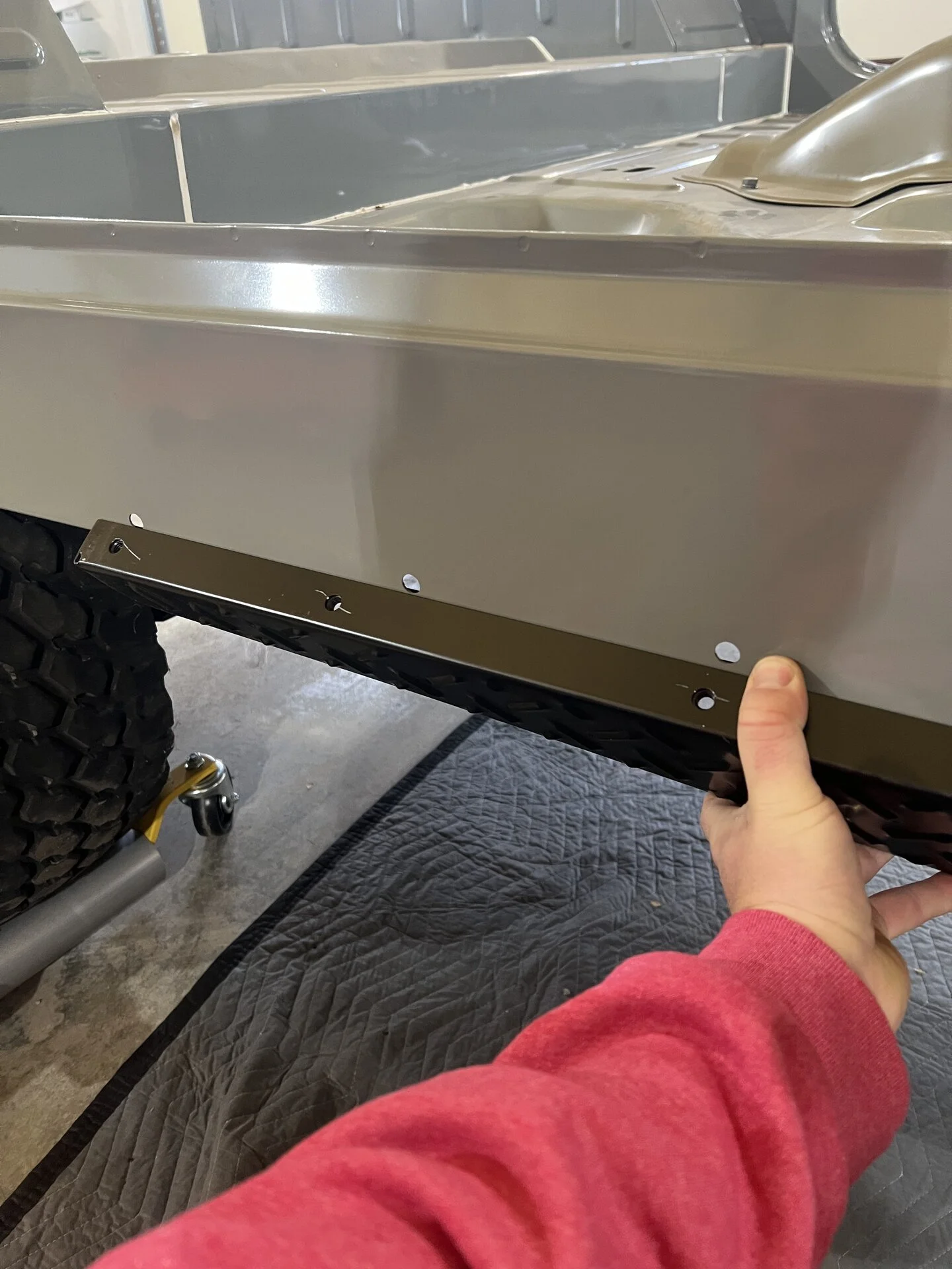

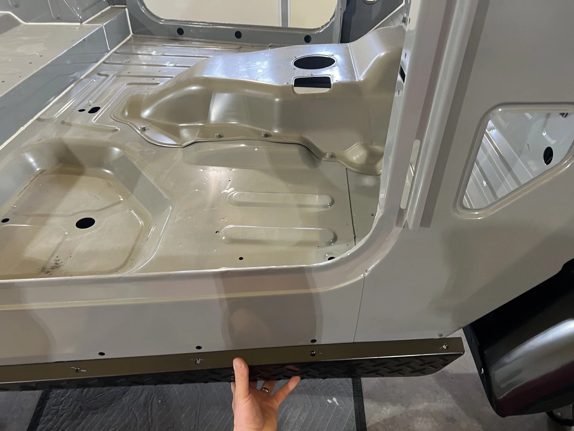

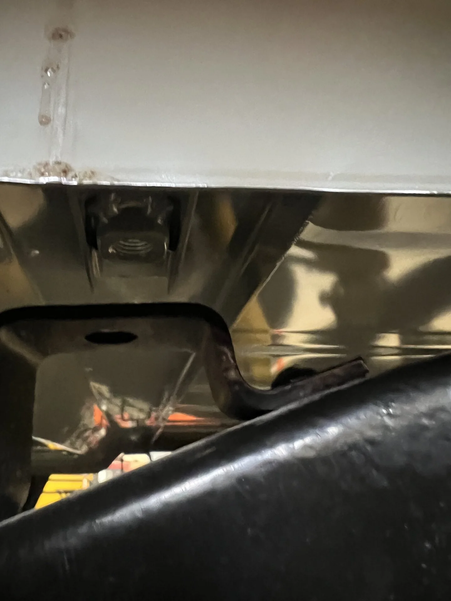

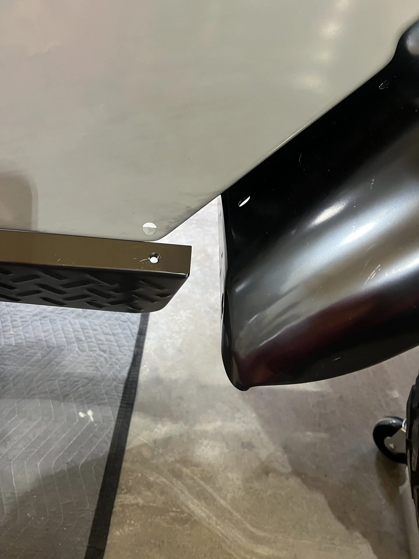

Here are some pictures of the body mount locations. I also held up an oem step to show how off the pre drilled holes are. If this is simple thing is off , how many other things will I run into? So disappointed in the fab and body work it’s going to require. I’m wondering if they have ever even set one of these on a frame. The pictures look great and the whole body kits are shown bolted together but never on a frame. The mounting hole for the body through the rear floor has a welded nut…why??
I feel your pain - I got a CCOT 3/4 tub that had similar (but different) weirdness around assembly. It's annoying and frustrating (especially for the price), but eventually solvable. A rust-free 40 is worth it in the end too...mine was pretty far gone as well. Massaging the tub is work in itself, but it'll be some work to make sure the front clip also fits - any quirks in the body mounts compound up front. (I had to eventually cry uncle and my bib hinge is shimmed upward about 1/2")
It'd definitely unfortunate, as it seems like the panels themselves are stamped well, it's just missing the boat on assembly. Ironically, it'd probably be easier to "flatpack" the pieces and leave it to the buyer to assemble, too.
