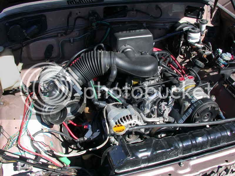

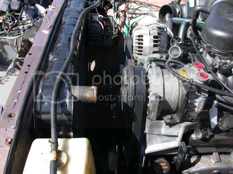

some pics finally.... :D
took Dynosoar's advice and moved the tranny over about 7/8" nice and straight now!!!!:bounce: :bounce: :bounce: :bounce: :bounce:

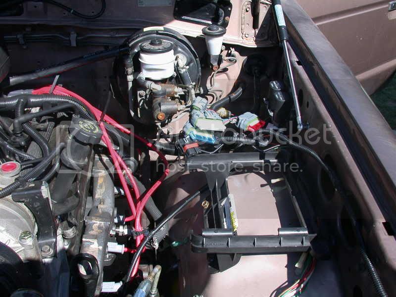

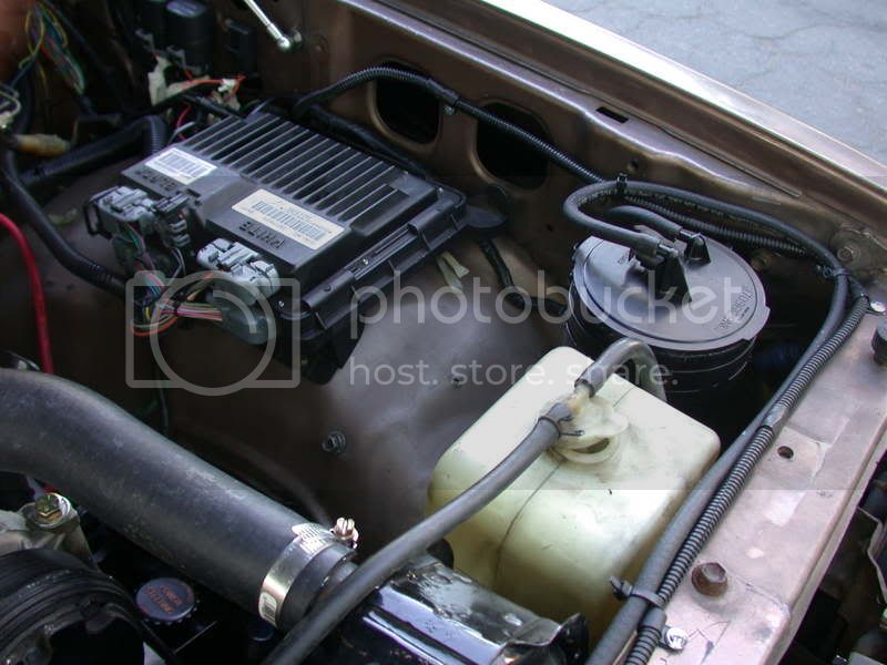

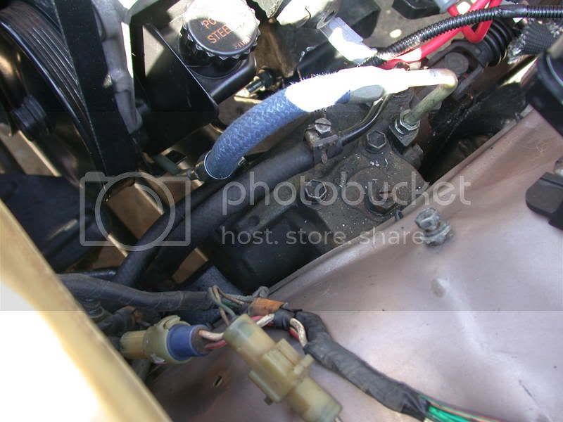

pics in no real order are of the new P/S hose I had made from my local parts guys, the installed gauge cluster, the factory ECM mount installed on the DS fenderwell, the new alignment of the motor in relation to the radiator, and the overall look of the vortec in the bay.

Looking AWESOME Philos1!
I know that youre getting excited!

thanks guys!!!!

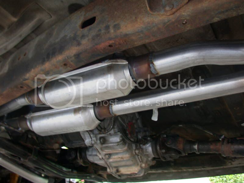

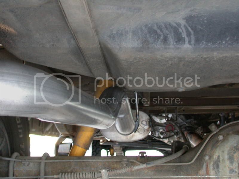

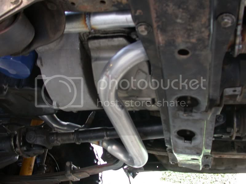

some pics...
first up is the exhaust, nice and snug. (so well installed, I can hang my whole body weight from it!) 2" from the down pipes into 2 1/4" cats (two of them), then 2 1/4" into a used magnaflow, then 3" single out. whole deal was around $500 with my cats. pricey, but VERY good quality install.

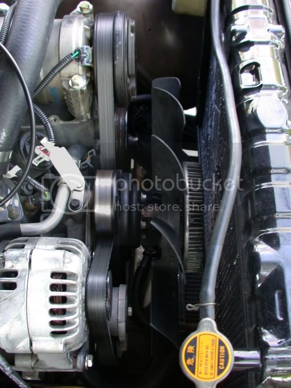

next is the stock fan that I trimmed with the cut-off wheel. no shaking, and it clears the bottom radiator hose, clutch sits nice and close to the radiator- I'll get to a shroud over the next few weeks or so (waiting to see if I need it or not).

charcoal canister and ECM mounting.
