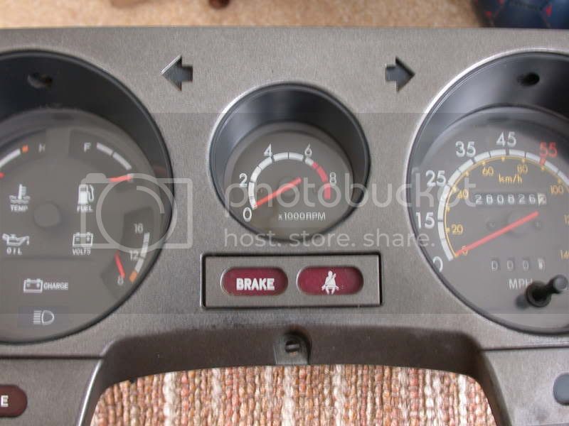

I also dropped my gauge cluster off at N.H. speedometer to change over my tach (expensive, but all new circuits, and the tach will now read up to 8K :D...)they called today, and it's already done, so I'll get pics tomorrow...

had such a s***ty morning with N.H. speedo, that I didn't work on the swap... I did get some last parts picked up today- throttle cable, P/S hose, had my AC condensor cleaned/tested.
the tach looks great, but the service/attention I was given will make me NEVER EVER go back. I've purchased many times from them, but this time was the last time. sucks, cause they do really good work.:mad: :mad: :mad: :mad:
anyways, here's a pic of the new tach, enjoy.
