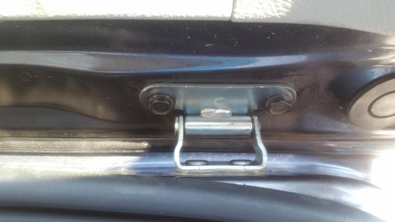

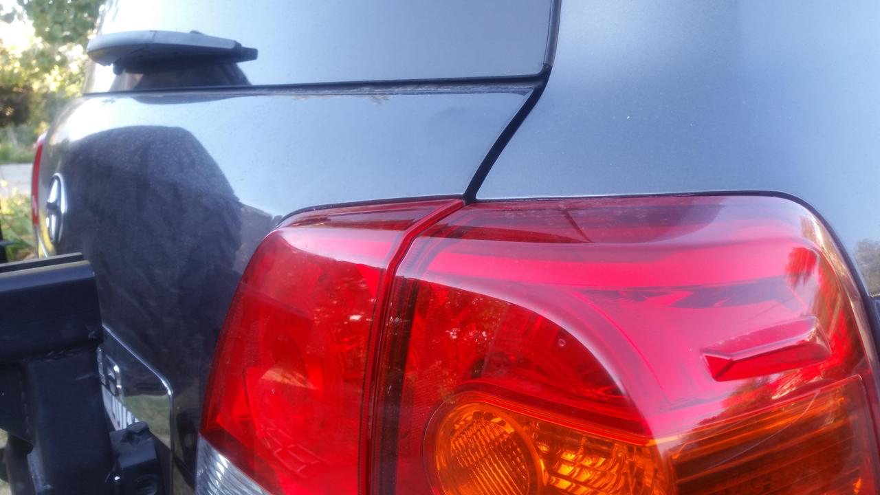

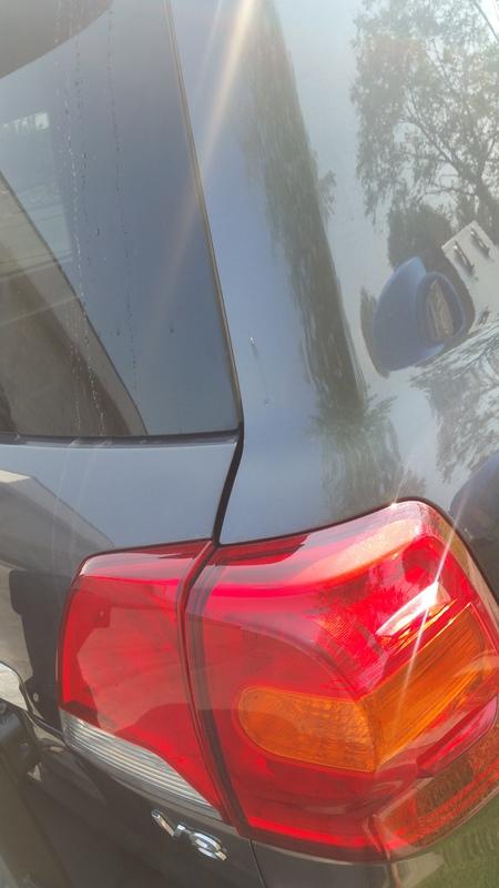

I installed a new hinge on my hatch. Tweaked hatch fixed! It's still a tiny bit off but a hell of a lot better. Plus, it only cost $30. I wonder what I'll do with this $715 check I was given to fix it... FREE FRIDGE!
Before:
After:
Looks to be zinc plated (like shed hinges) so it shouldn't rust. I'll keep an eye on it though and blast it with paint if it starts to get corrosion.
Hey Tony... About being a little misaligned still... I literally watched the guy at my dealership as he "fixed" mine that was a little off some time back. He adjusted my latch on the tail gate first...but then he noticed the upper hatch that was slightly askew...and he literally just grabbed both corners with it open fully above his head, and gave it several fairly aggressive "bends" (like pushing one corner one way and pulling the opposite corner the other way. He did this several times until it was straight, and voila! No more "askew-ness!"
When I asked him how common that was, he told me they have to do that probably 3 or 4 times a day to various cars, vans, etc. Might give it a go. It didn't require ridiculous force or anything...just enough to give it a good tweaking.
I tried a little bit of that but seeing the frame around the rear window flex gave me the willies. Busting that rear window wouldn't be cheap. Plus, it's pretty much spot on as it is. Only maybe a millimeter or two off.

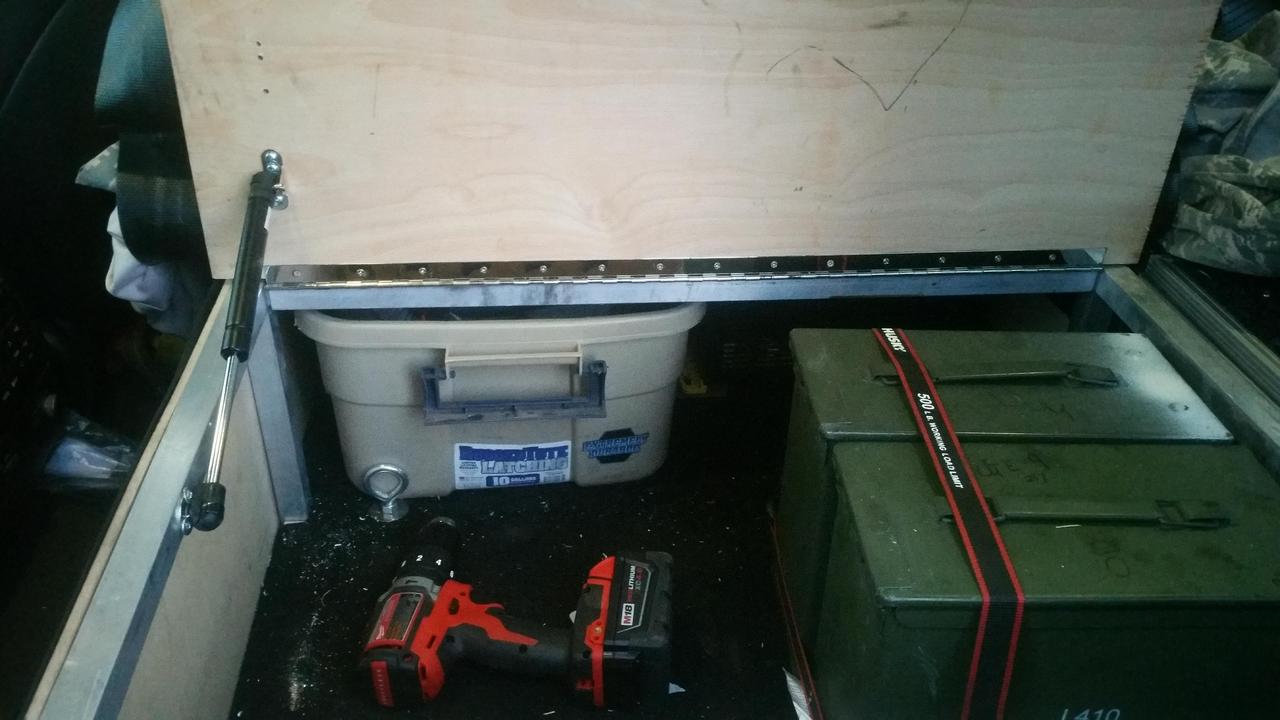

Put in a gas strut, a latch for my 2nd row drawers and found a decent carpet mat at Lowes to top it with (still need to trim and glue it down). Soooo much better than having wood slam on your head and/or hands while you're digging in the storage bin.
Here's the mat for anyone with the stones to remove their second row.
Shop Mohawk Home Rectangular Door Mat (Actual: 48-in x 36-in) at Lowes.com
(those are old uniforms with incorrect rank incase anyone is eye-creeping)
:) Nice use of the ammo boxes. .50 I reckon
Those specific cans are for M206. :) M206 is the flare used in F16s, C130s, ect... But the can itself is pretty common in small arms like .50 and 5.56 too. I have a few of the larger 20MM cans I might try and use if I can find a spot for them. The amount of 20MM and M206/5.56 cans we go through is wild. At least it was until the F-35s came, which are utterly useless and can't fly s***.

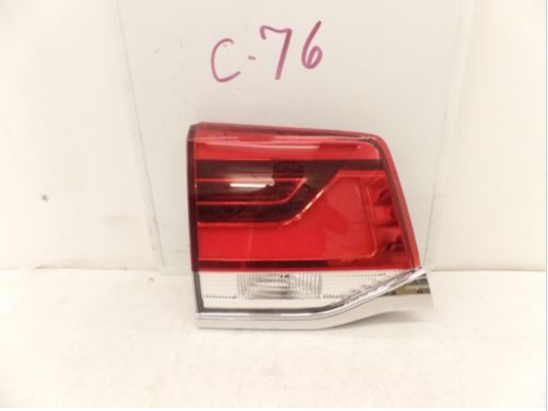

Ordered this to see if it's possible to make these it fit without looking wonky. I know I'll need the center name plate too but this is the only part I'm iffy about if it'll fit or not. Plus, it was only $45 and I can return it if need be.
Doesn't even remotely fit. The 08-15 hatch lights are significantly smaller. You'd need a 16+ hatch to make it work. No idea about the body/fender mounted portion.
