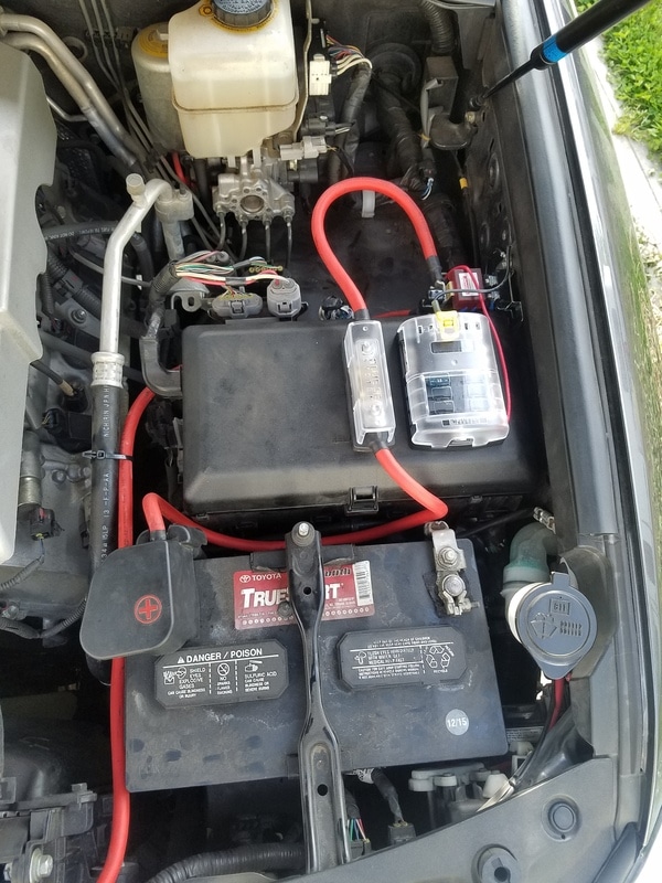

Tony,
any concerns about running the positive battery cable across the front in an event of a front end collision, or will the ANL fuses mitigate that situation and any unintended effects?

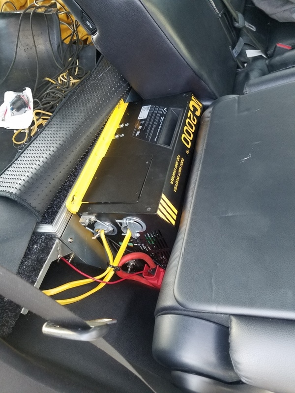

Turns out I had the wrong socket to pull the CVs off so I did electrical work instead. It's 99% complete. I still need to wire in the battery link switch (jumps one battery to the other manually) and the little voltage gauge. I'll get some wire mounting P-clips to neaten everything up later. I'll probably change the 16AWG into the blue sea units to something more robust like 10ish, but 16AWG is rated at 22 amps so I'll be ok for now since I have nothing hooked up yet. The inverter needs a mounting plate. It's wedged in there pretty good and isn't going anywhere but I'm going to mount it to the rear of the drawers. The plug below the standard outlet is the AC inlet. When you plug in shore/camp power it'll charge the batteries and power anything that the inverter was powering. Pretty cool stuff. The outlets are a little cockeyed since I was missing some tools but you gotta piss with the cock you got.
Mind the mess.
Red light with the engine running means success!
Edit: Just ordered some 10AWG marine Red and Black for the Blue Sea units, the 16 will bother me too much.
Also, I have one more ANL fuse block that'll go next to the other one that'll fuse the aux battery. I just forgot to wire it in.:banana:
Tony,
The ANL fuses will pop before any nonsense occurs, that's why I installed them.
It's safer than anyone running a winch that's permanently wired and not fused (most installs).
I understand, but I dont see ANLs on the pass side battery positive connections. That lead coming across the front would still be live/energized if the ANL on the driver's side pops. The ANL should always be placed as close as possible to the positive terminal.
Same applies for the power lead to your inverter.
I see what your saying now.
Yes, it's on the long list.
