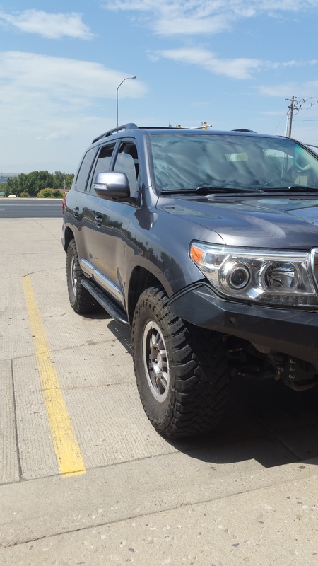

Spent about 7 hours giving it a detail job (compound and wax) after the hell I put it through in the past two weeks. It cleans up nicely.
