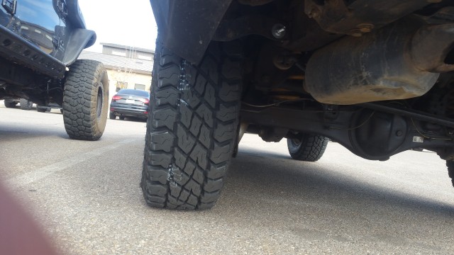

the toyos were heavy rubber - more than the trail grapplers but not by much. The coopers have a different carcass profile, not as squared off. the difference is the coopers swell out a bit more so I caution you to watch your front driver side contacting the KDSS and tie rod bolt. That's how I wasted a tire prematurely. bet you feel like a turbo just got bolted on. congrats

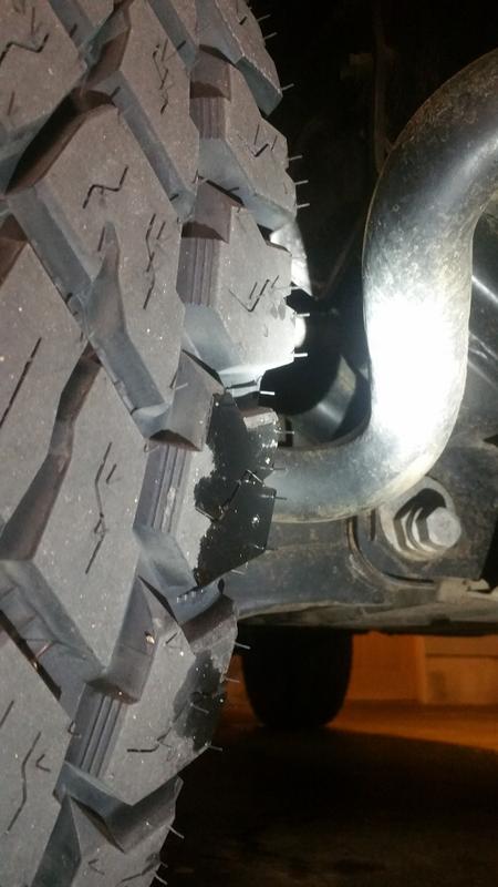

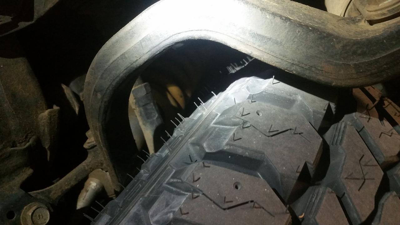

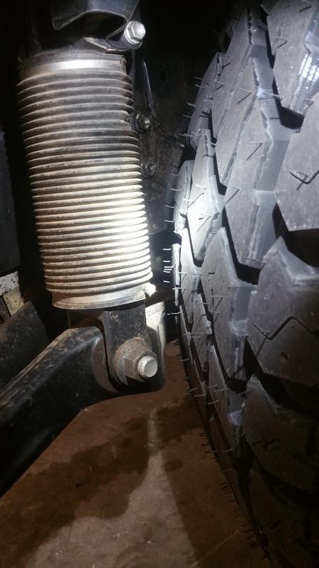

Here are a few pics at full lock (brake fluid on the tire). Let me know if you want a specific angle.

Umm, you weren't kidding about it being close. But I do love a tight fit. If you got time, please see if you could make it work without the relocation.
Umm, you weren't kidding about it being close. But I do love a tight fit. If you got time, please see if you could make it work without the relocation. My front tires are moved back a bit more, I feel that specific alignments will make, or break if this tire size will work.
