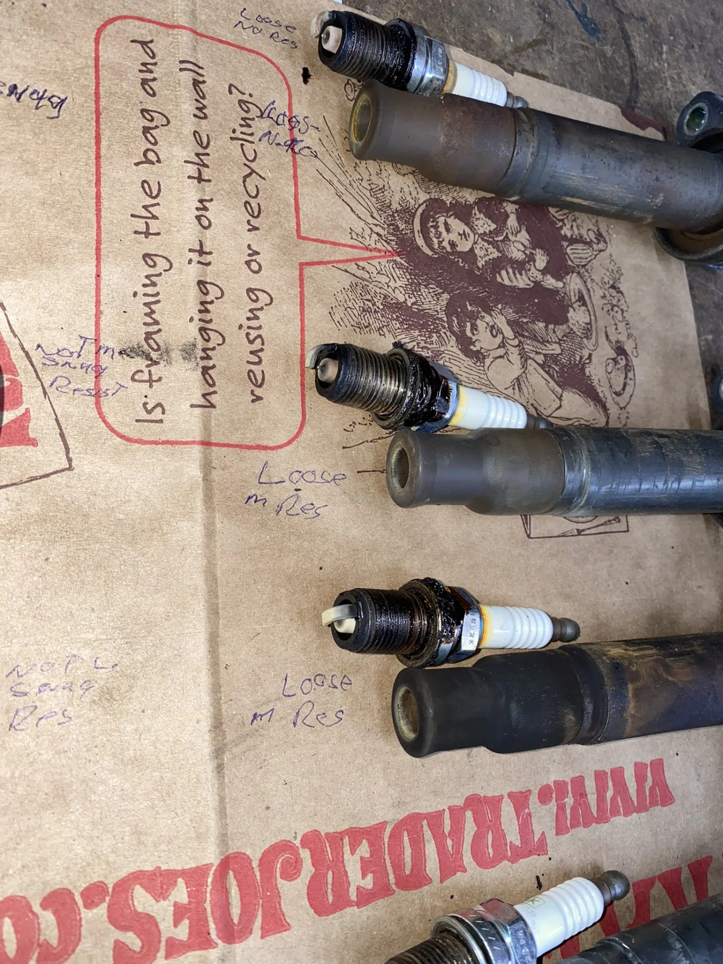

I R&R a set of plugs, from an 03 w/315K miles on it yesterday. Since I could hear cold start tick, I was anxious to get is done. Which "tick" was either plug(s) walking-out (likely) or exhaust leak (not likely on 03-up).
I found 3 loose, 5 others with degrees of only snug. Bk 2 plugs 2, 4. & 6 loose, with 4 & 6 loosest and blowing gunk passed the threads. Actual all plugs were allowing some gases pass the threads, with #1 the least.
#'s 4 & 6 cylinders are the ones I find the loosest most times. Likely this is due to the air pipe/box covering head cover, holding in more heat.

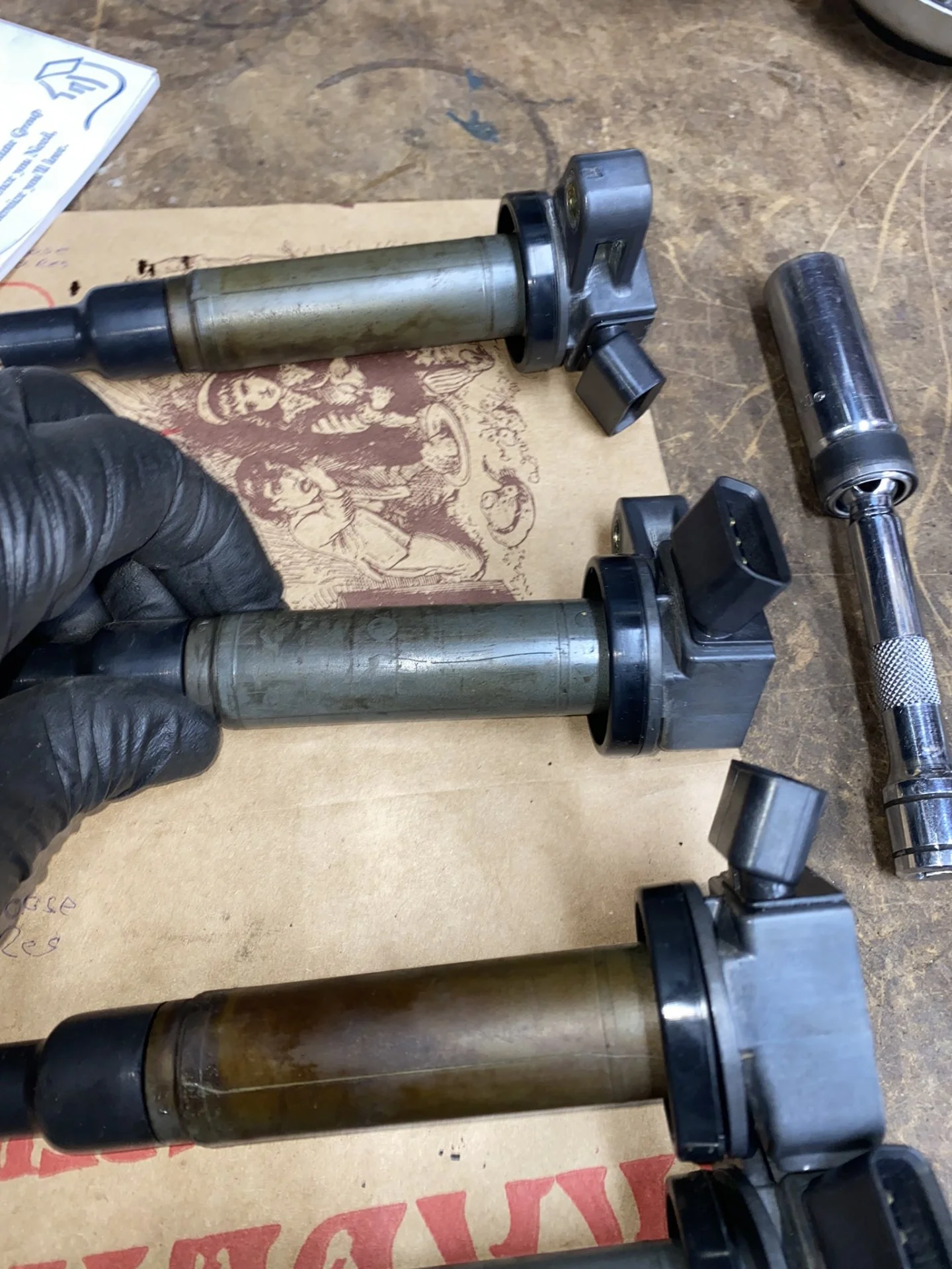

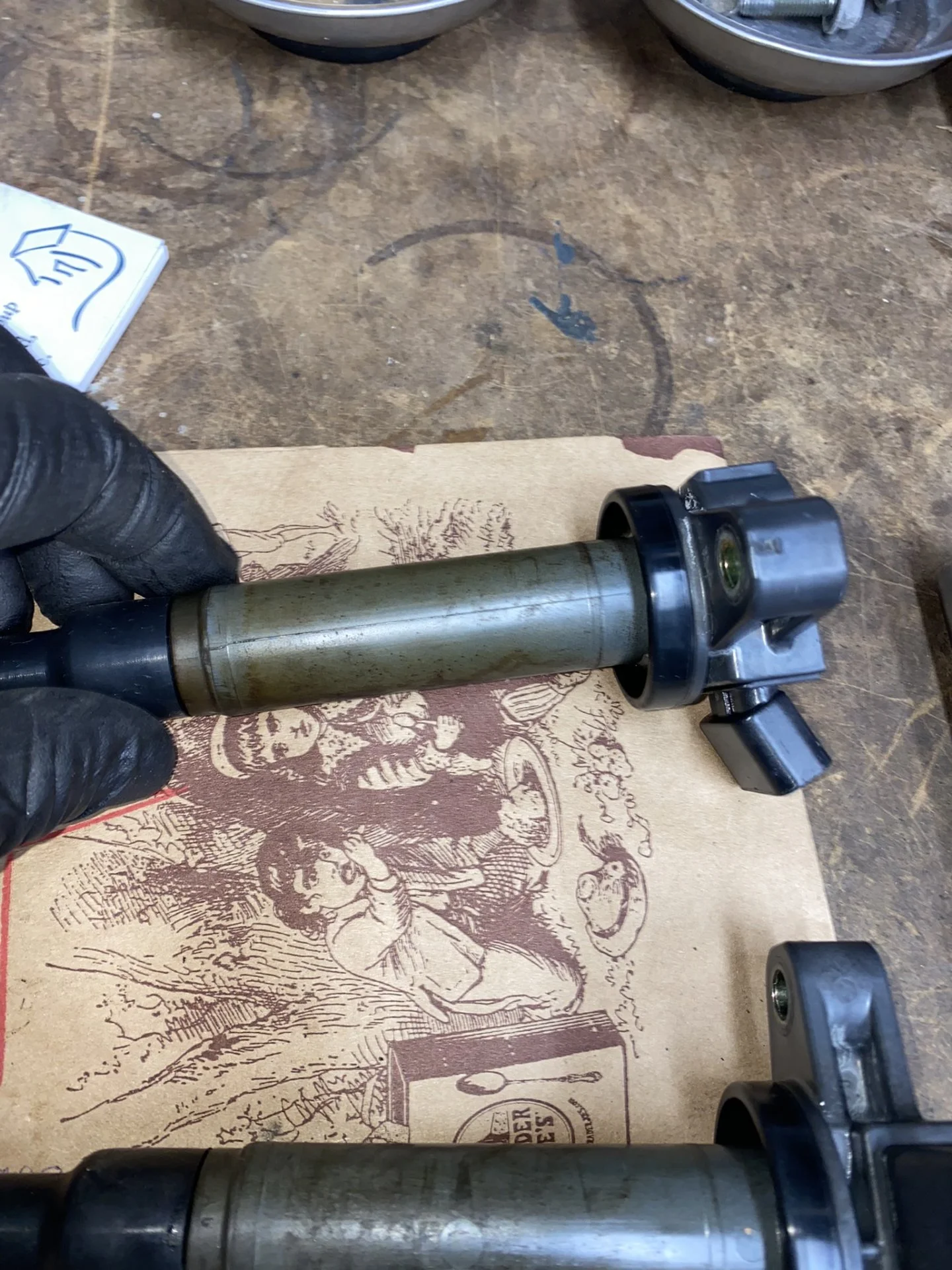

#6 coil badly cooked from combustion gases. This is a sign #6 was no longer snugging up when at operating temp. It at this point, condition become critical. It would have been much longer until plug blow of, and damaged head. BK 2 coils also had the most visible heat damage, from heat expansion (swelling). They swelling causes case of coil to crack/split open. Excessive heat reduce life of coils, and leading cause of coil failure.
Gap on plugs were <1.2mm (limit 1.2mm). OLD NGK BKR6EGP
