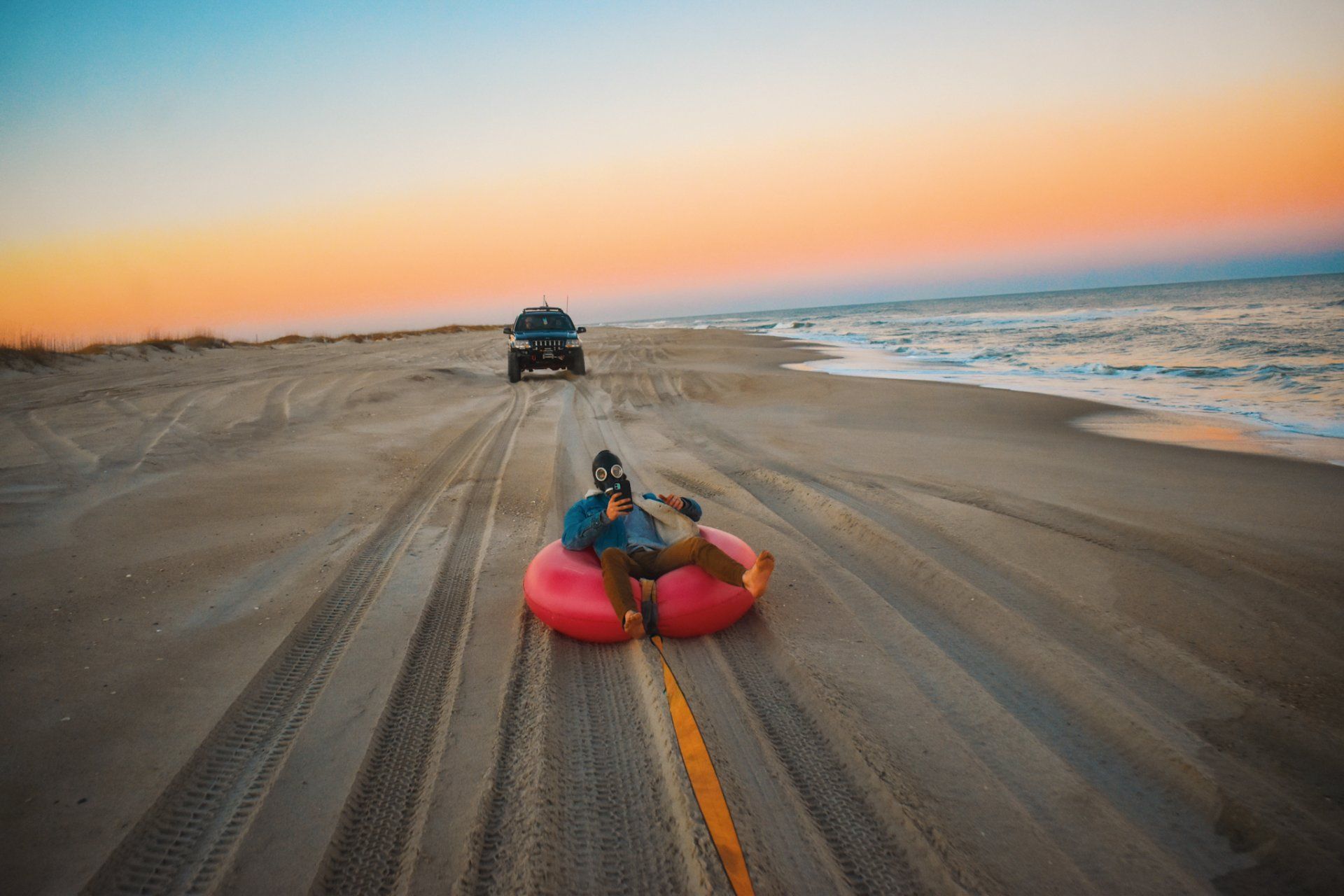

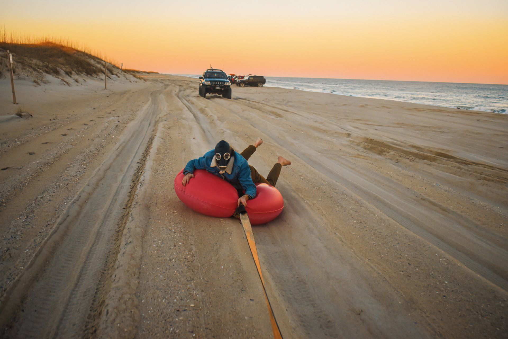

Well the water is too cold to go tubing, but it had been so nice out recently that my friends and I figured we would just go sand tubing instead haha. Here’s a short video since the photos don’t do it justice (gasmask is to prevent the sand being flung up from blinding us)
I think I'm more amazed you got the 3B going that fast on the sand!
Seriously though, that is exactly the same stuff my younger self and friends still used to do.
Oh trust me I was too, the EGT’s were as high as I’ve ever been able to get them at 900f for a bit of time, totally worth it though. I’m so glad we have the opportunity to do this though, very lucky.
