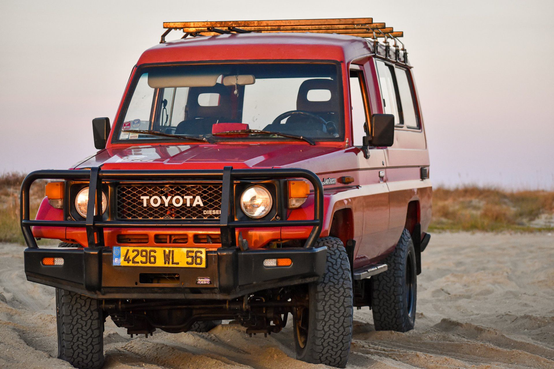

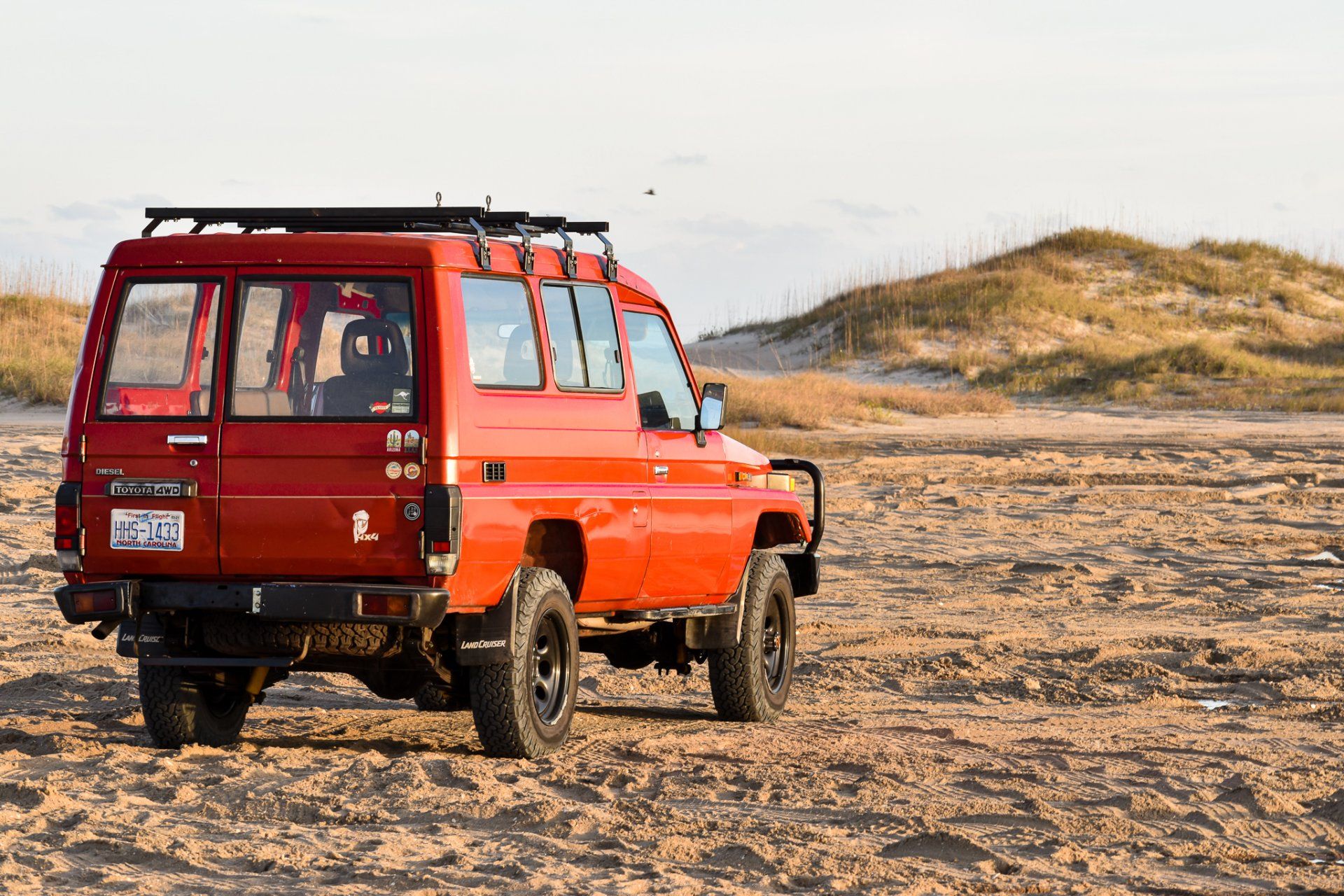

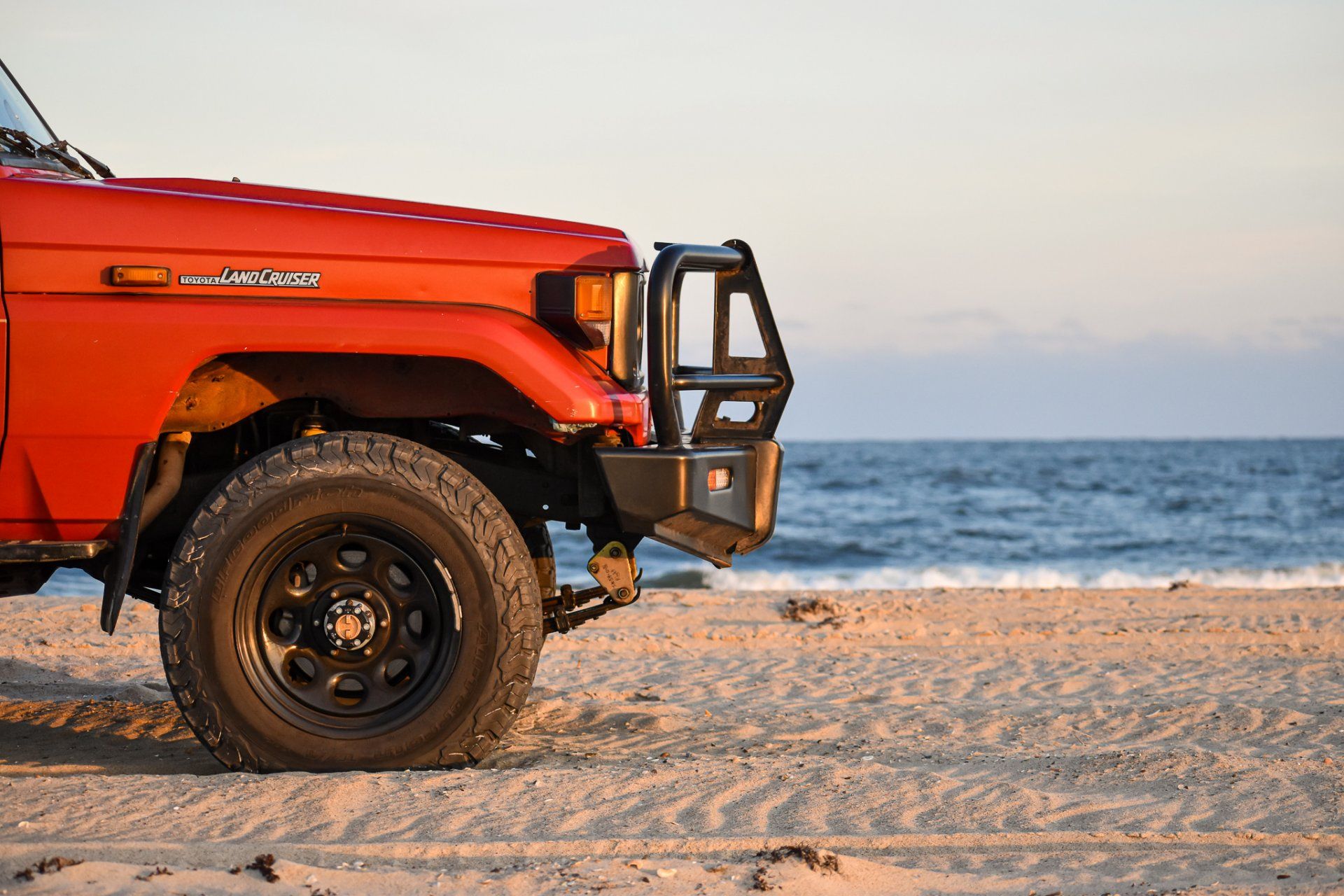

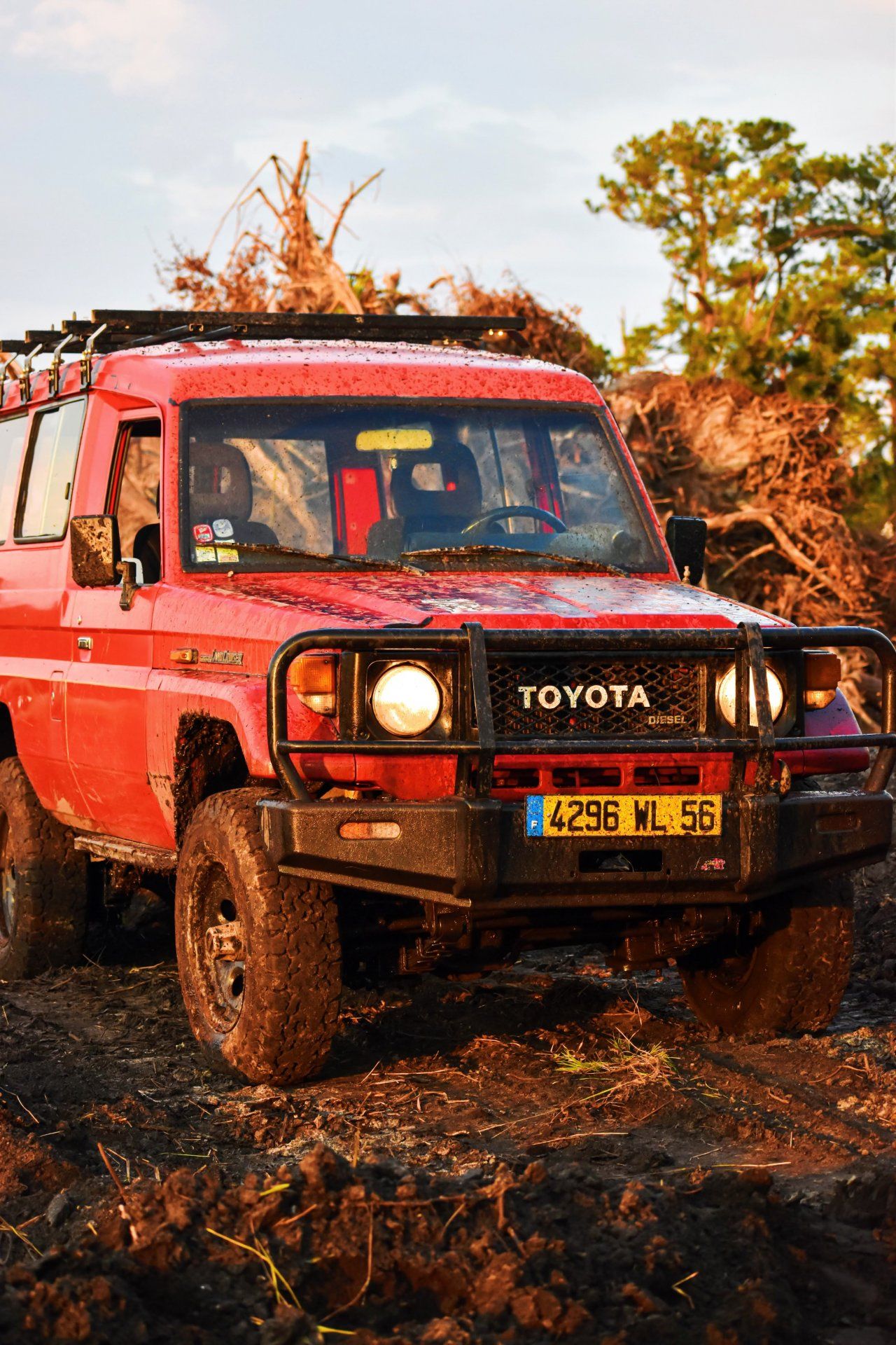

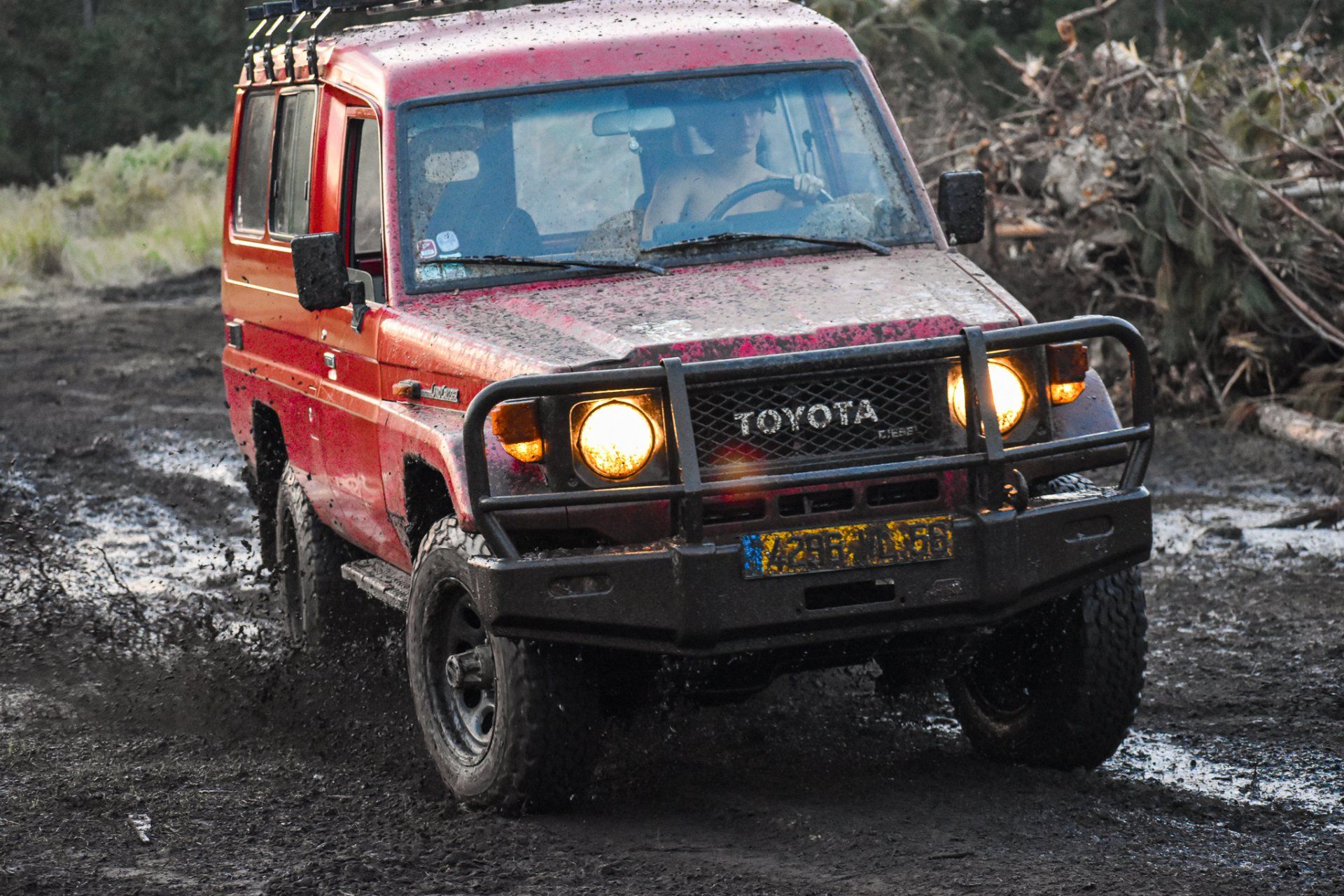

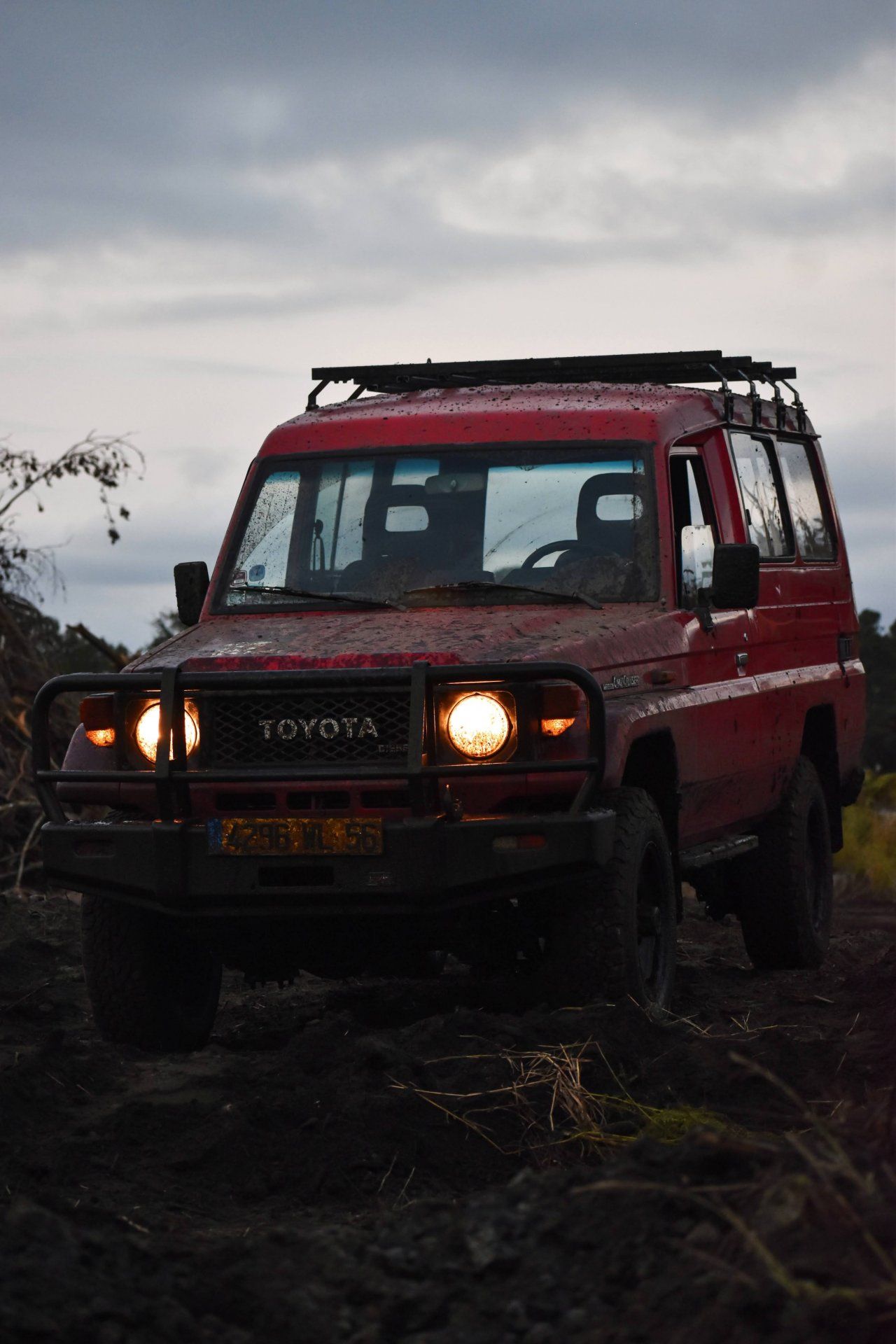

I'm back with some more shots of the Red Rocket out on the beach and in the mud! All is well so far... There is some popping in my suspension whenever I steer which in fact may be the TRE's like @Onur said a couple of posts up. Everything else has been replaced by us in the front suspension besides them soooooo who knows, yet the work done to it less than a year ago by the PO said "replaced tie rods" whatever I'm just glad it's driving.
Nice action shot there at the end! Lovely truck.
