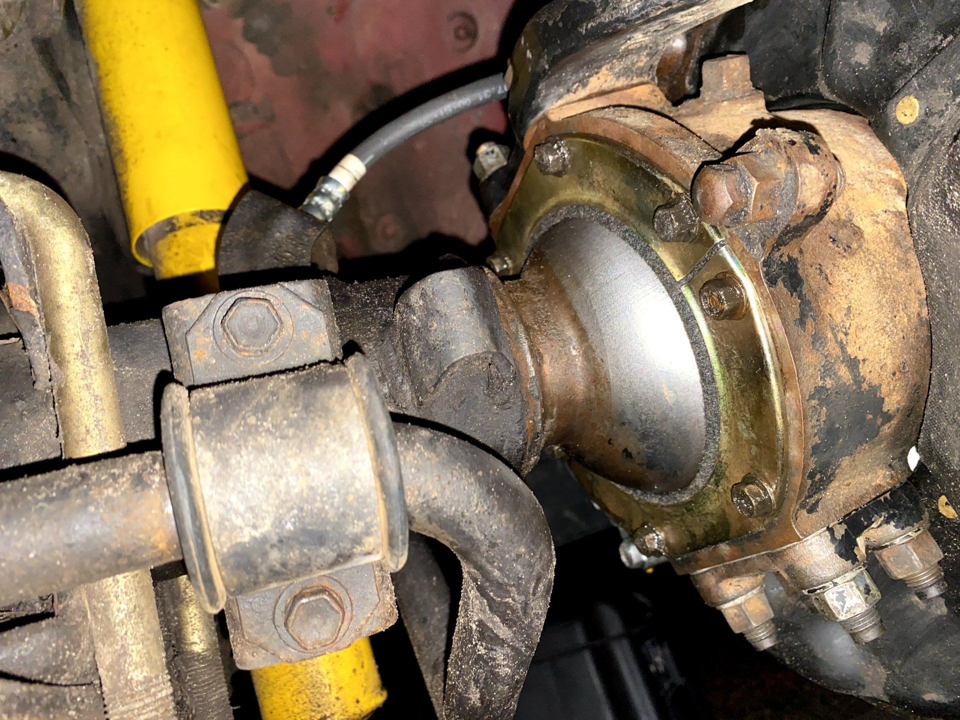

Those tie rod ends are 555, aftermarket from Japan. Good quality parts. They don't look especially tired, although something is messed up with that boot/zerk in the first photo.

Well, I re-torqued the U-bolts and the problem still persisted. Low and behold I see this
Now like I always say, I'm certainly no expert... but I believe my tie rod ends have seen much better days. The snap, crackle, and popping doesn't sound all that healthy, as well with that massive downwards clunk halfway through the turn. I'll give Cruiser Outfitters a call tomorrow :confused:
I fitted some Christmas lights to the roof rack and I love the way they look, especially the interior. Might actually keep the interior ones after Christmas due to the Red Rocket not having any interior lighting. Now I just wait and see if any cops will pull me over haha.
Yep, just replace them all, it's like $125ish for all new 555 joints, not hard at all to do either. Rent or buy a puller and get after it.

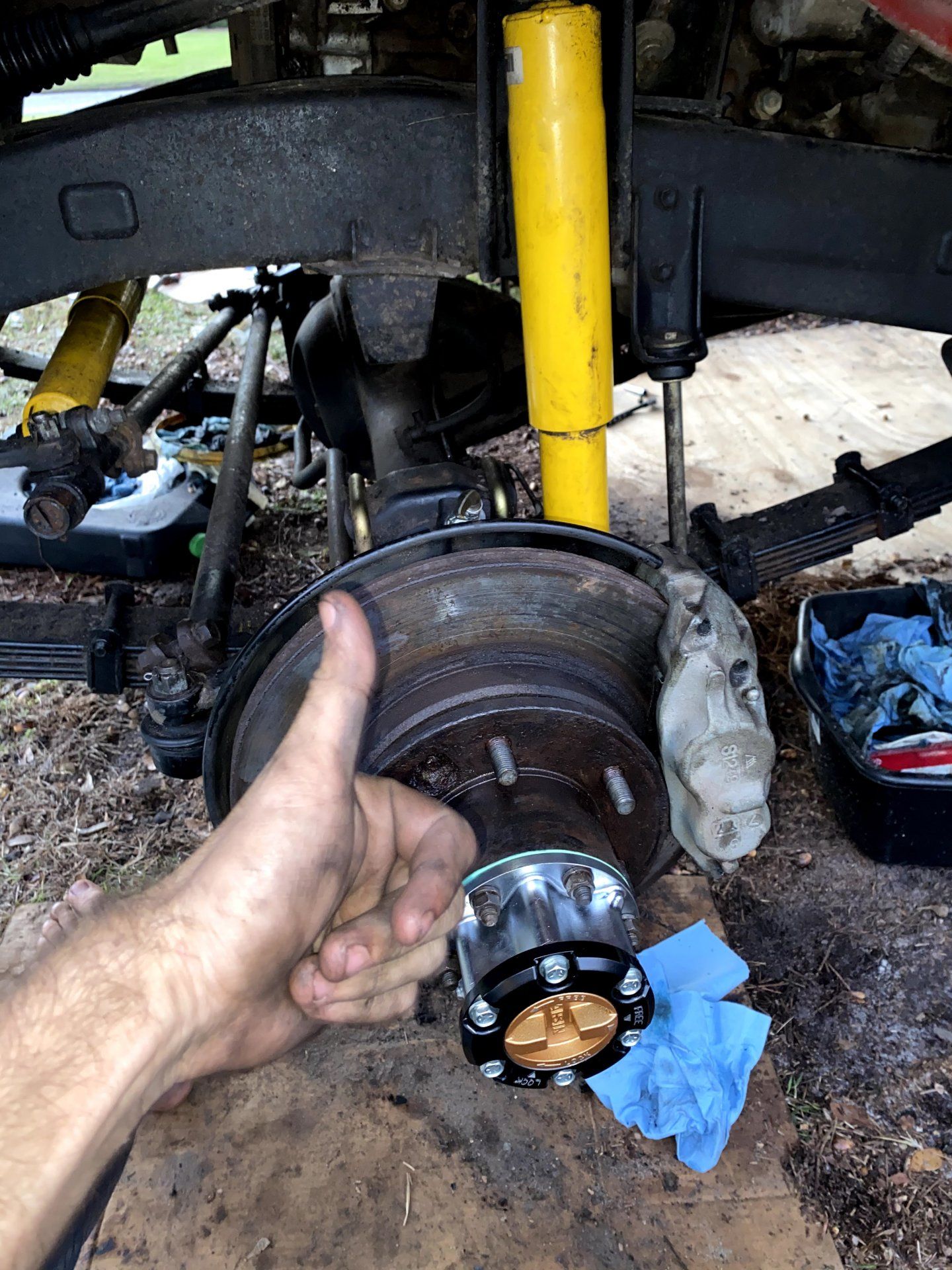

Well, I've finished the knuckle rebuild, yet I still feel like the wheels are gonna come flying off just cause I did it in my dirt driveway vs a professional shop. Eventually, that feeling will fade... I hope. It poured rain for 2 days which caused a 2-day delay or else I would have been SPOT ON in my Friday estimate, yet I finished on Sunday instead. I do feel pretty proud though, and my confidence to tackle bigger jobs on my own has risen since my dad would only come and help hold something for me or other small things, popping in and out to check-in. Went ahead and put some OEM locking hubs on, however, I think I'm having problems engaging into 4wd, FOR NOW I'm just happy I cant drive, and I'll try to figure out whats up with that later... I also had the alternator go out right before I started the knuckle rebuild so my dad ordered an aftermarket one off of Partsouq so we got that replaced, and in the meantime, I'll figure out how to rebuild the OEM alternator. As long as anything else doesn't fail then I should be back to taking some pretty sick pictures!

After a lot of hard work on my dad's Prado, such as rebuilding the knuckles, putting in manual locking hubs, replacing the radiator, and a lot of bushings being replaced, it's finally road worthy! So naturally, we took it out to the beach with the troopy to see just how well it would do, it was killer. If the troopy with a turbo moves anything like how his Prado does, I'll be more than happy. Also, my tie rod ends came in the mail tonight, but it'll be raining a lot so I won't be able to get them in for a while.

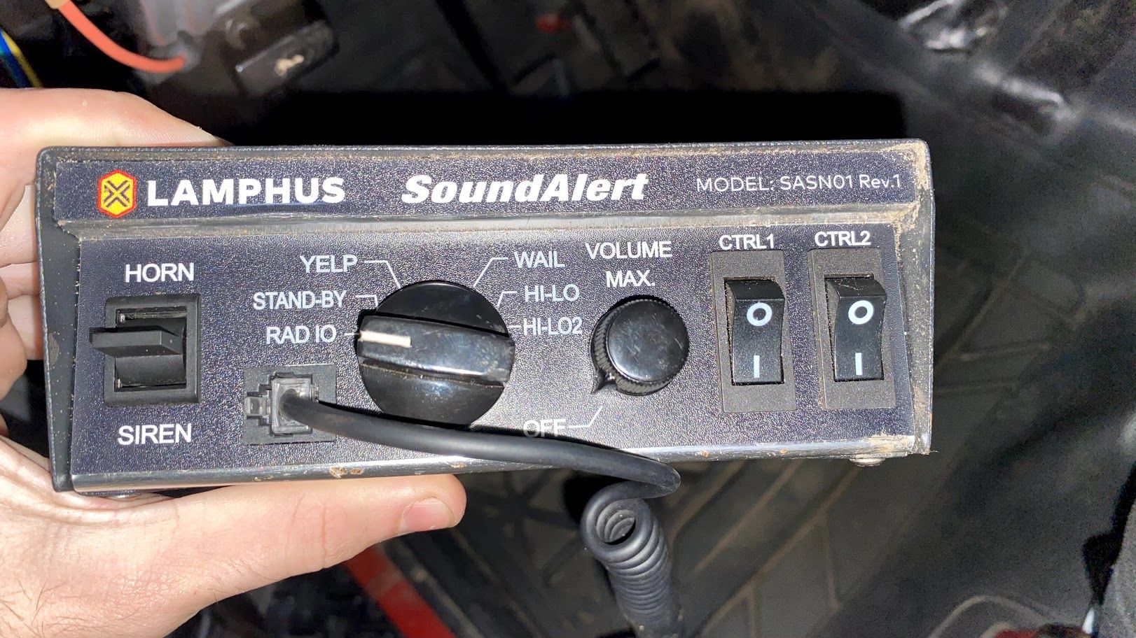

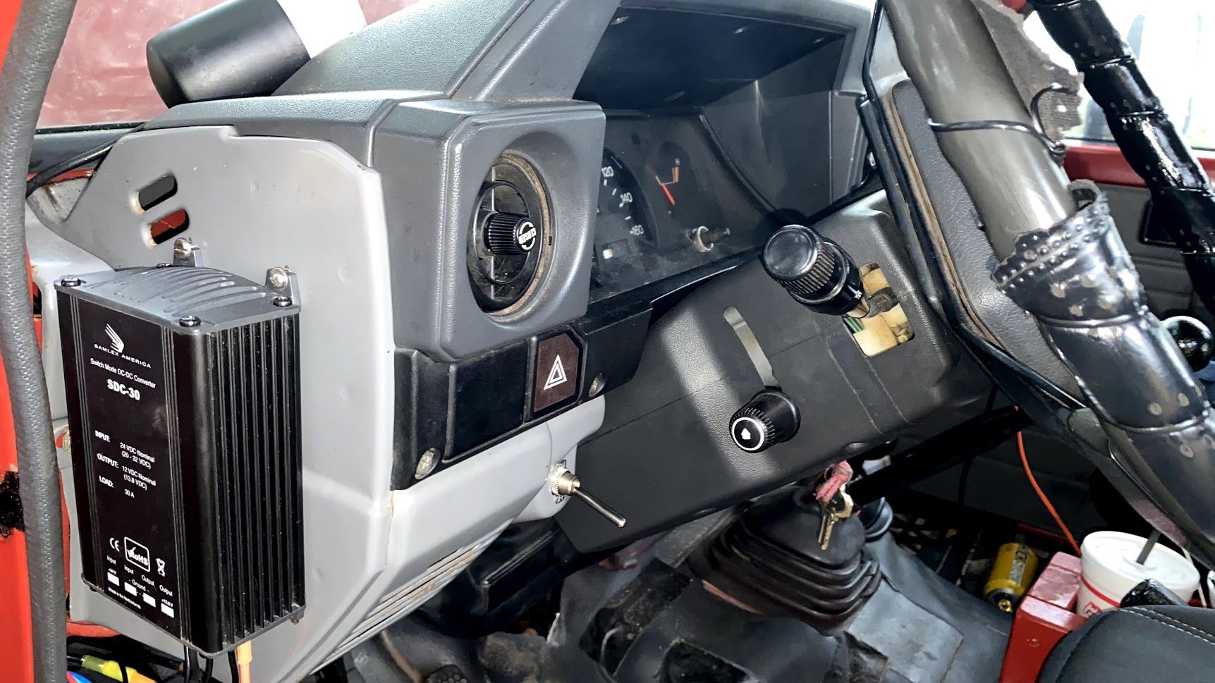

Speaking of... my father got me a 24v-12v power converter for Christmas as well. I've wanted one for a while to just be able to run any 12v accessories off of like you said. My friend gave me a PA a couple of months ago that I haven't been able to use because like you said, it'll mess with the batteries. And this PA is LOUD, very loud... don't worry I'll use it for good, like insulting squatted truck drivers in traffic. I also took some of the fog lights off of my dad's Prado's bullbar that he took off because he hates chrome, does anyone know if the Bosch foglights are OEM? because there is a factory switch inside to operate them that looks very OEM. Anyways here are some pics of the install and the Troopy with some non-working foglights currently
Hi

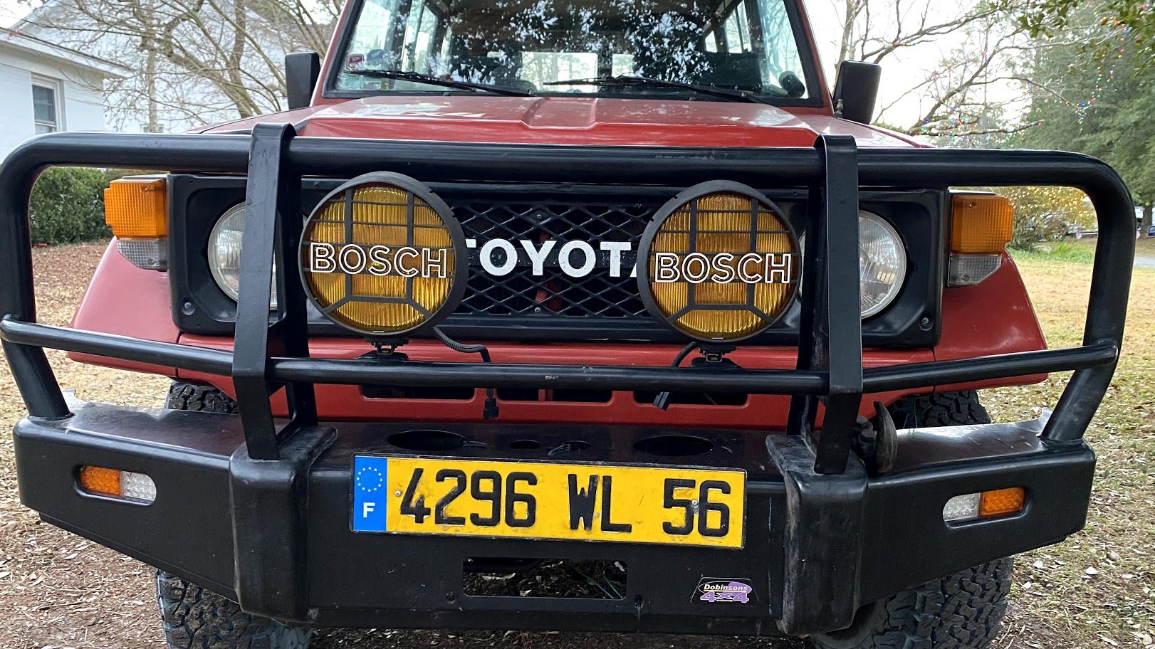

Bosch fog lights are not OEM . The switch looks OEM . I know several European spec BJ45 , with 24 volts that have a similar switch . They were used to power the factory installed trailer harness when you hook a trailer . I believe that some older North American cruisers such a switch also . In my humble opinion , a 24v-12v converter is not a good decision . It will cause a charge imbalance to both your batteries in a relatively short amount of time , and you will have to buy both of them . Not cheap . To power the converter in a way that causes the least amount of trouble , you must hook it to the auxiliary power supply box - a small black box near the air filter . The way there should be not much trouble to the batteries , but you will be a tad limited about how much power you can take from there . European diesel 6# series also had a place were you could hook a volt converter , just below the clutch master cylinder , but only with enough power to hook a small radio with no amplifier . Factory 24-12 volt converters were so expensive that diesel series 6# with factory radio are extremely rare . Don't know if the BJ75 had that power point also . BJ45s hadn't . Best of luck to you and the BJ75 ! Cheers !
