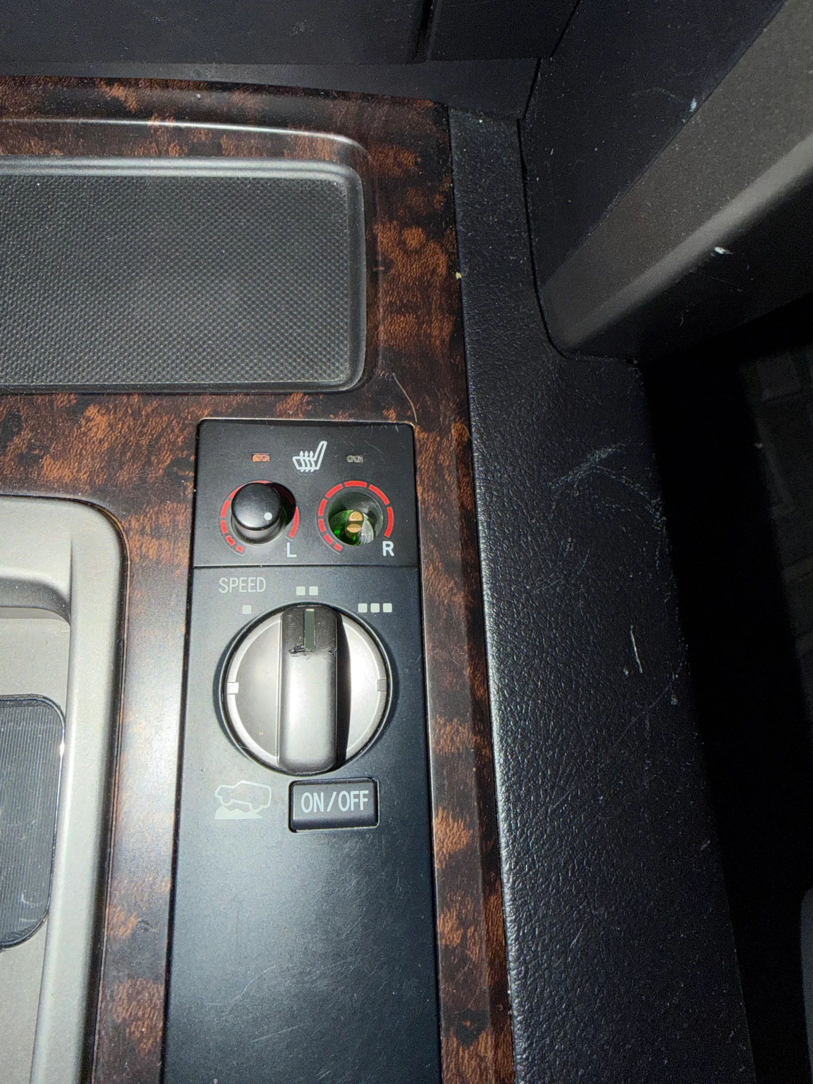

Can you order just the heater knob that fell off? I can’t seem to find it. 2009 LC. Also assume the door/spot buttons should light up similar to the garage button lights? What bulb goes there?
Unfortunately the seat heater knobs are not available seperately. There is a thread here on Mud with details but you can find a rather inexpensive (and admittedly low quality) aftermarket seat heater switch. Skip using the switch but the knobs click right on. I had to do this on my 2008. 8 years later, the knobs are still working well.
EDIT: here is the post, in it you’ll find the eBay link for a $40 switch.
At $20/knob it’s far from cheap but US retail on the OEM 84751-60190 is $320. I’d buy the OEM if I needed the switch but for the knobs, I’m down to compromise :D

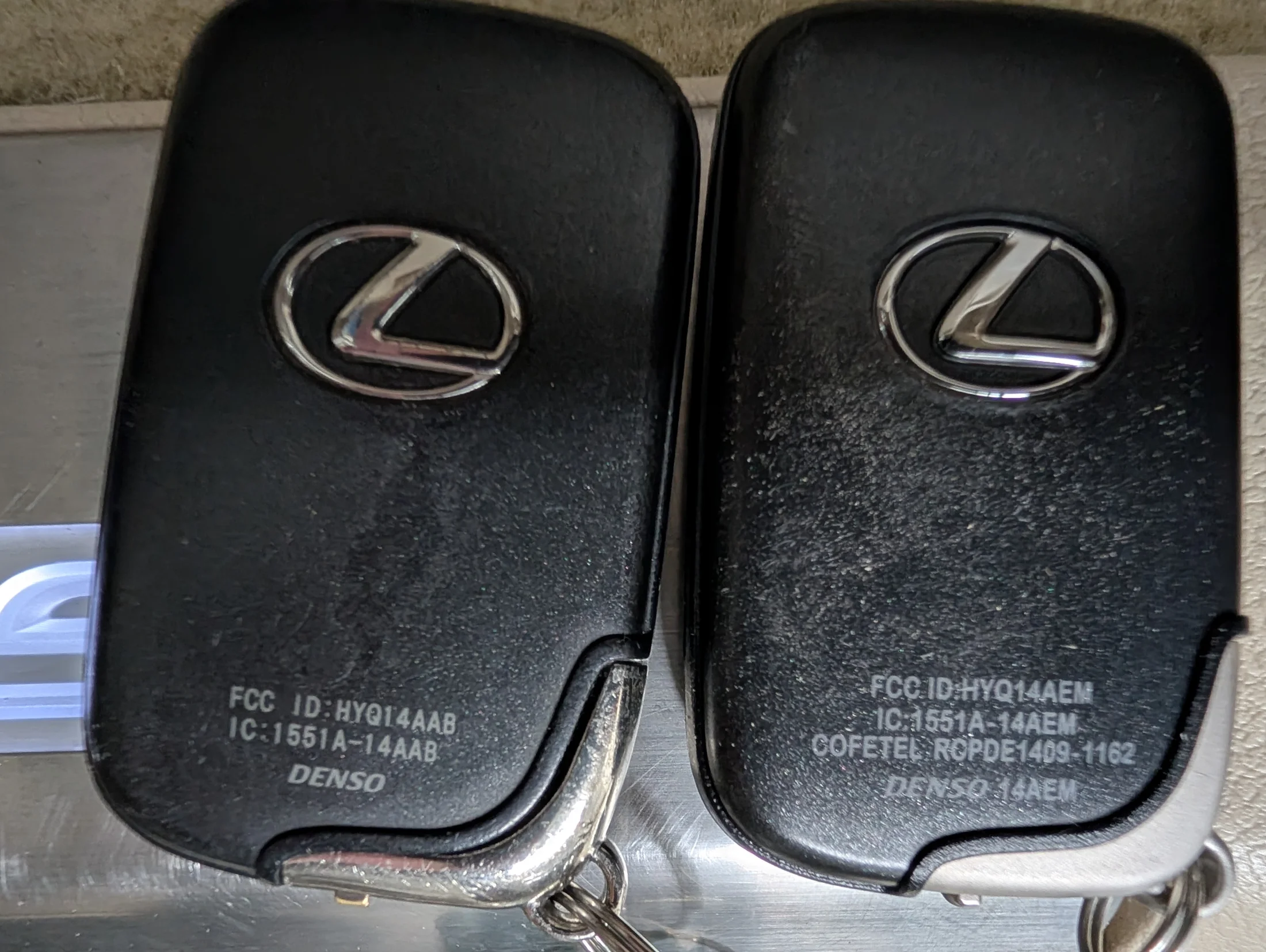

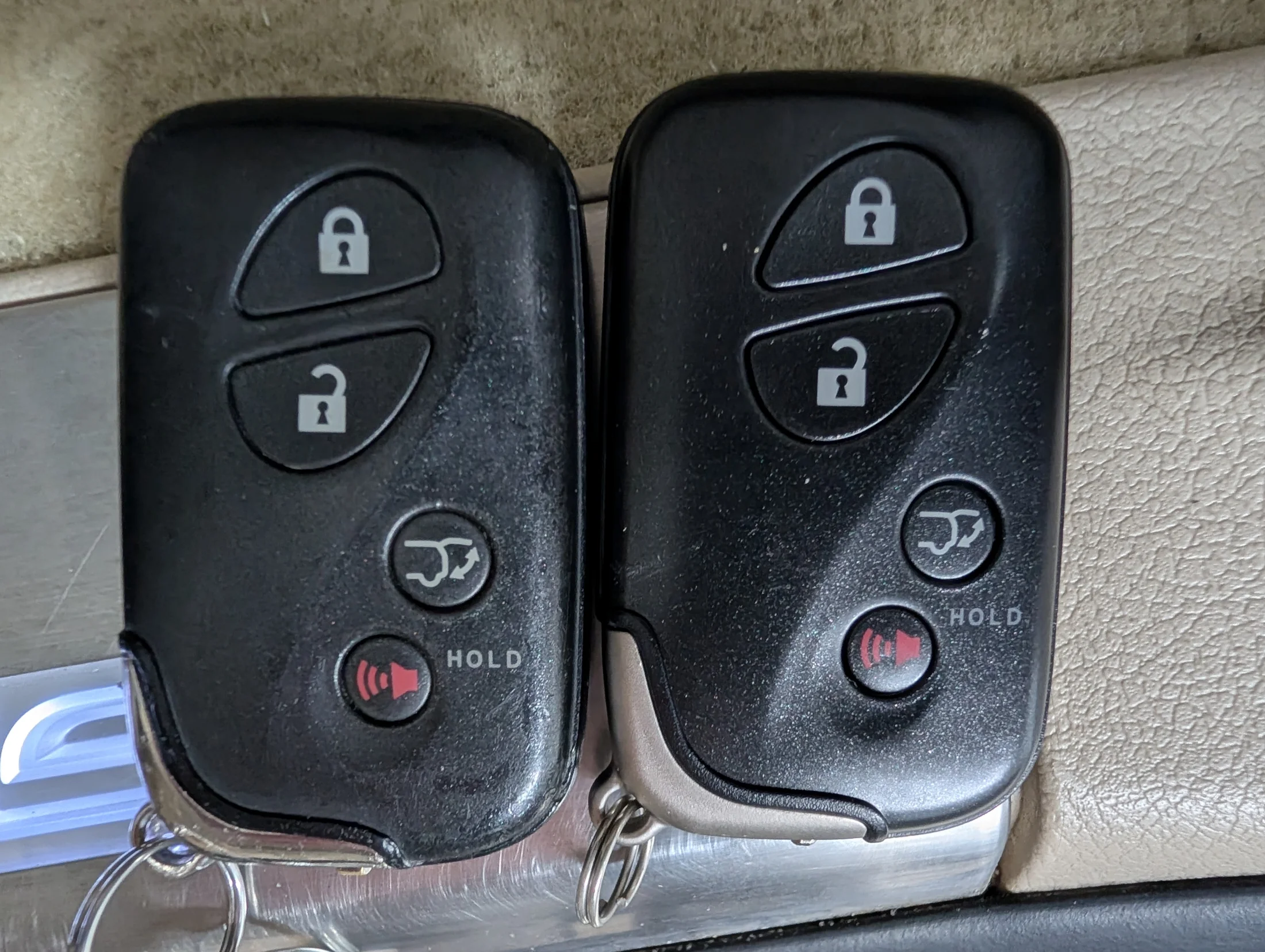

Circling back on this. PNs 89904-60A00 and 69515-50260 were correct for my 2013 LX570. Details here:
old key on left, new key on right
old key on left, new key on right. Note different FCC ID.
HYQ14AAB vs HYQ14AEM
I bought the FOB / transmitter (89904-60A00) at my local Toyota dealer (yes they sold a Lexus part) for ~$125 (15% off sale). I bought the metal key (69515-50260) at my local Lexus dealer and had it cut using my VIN for ~$63 (included both key and having it cut). So under $200 all in.
