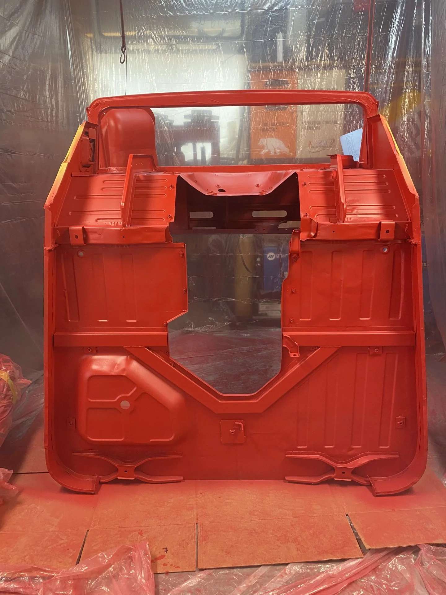

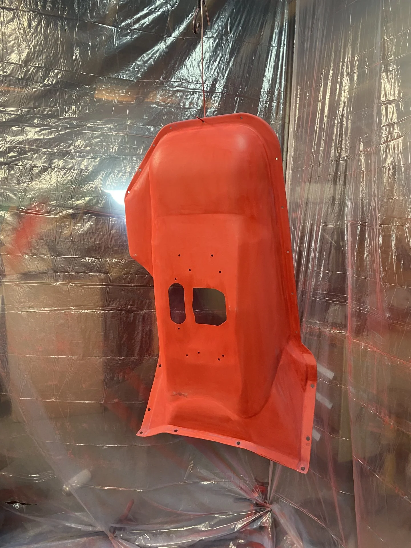

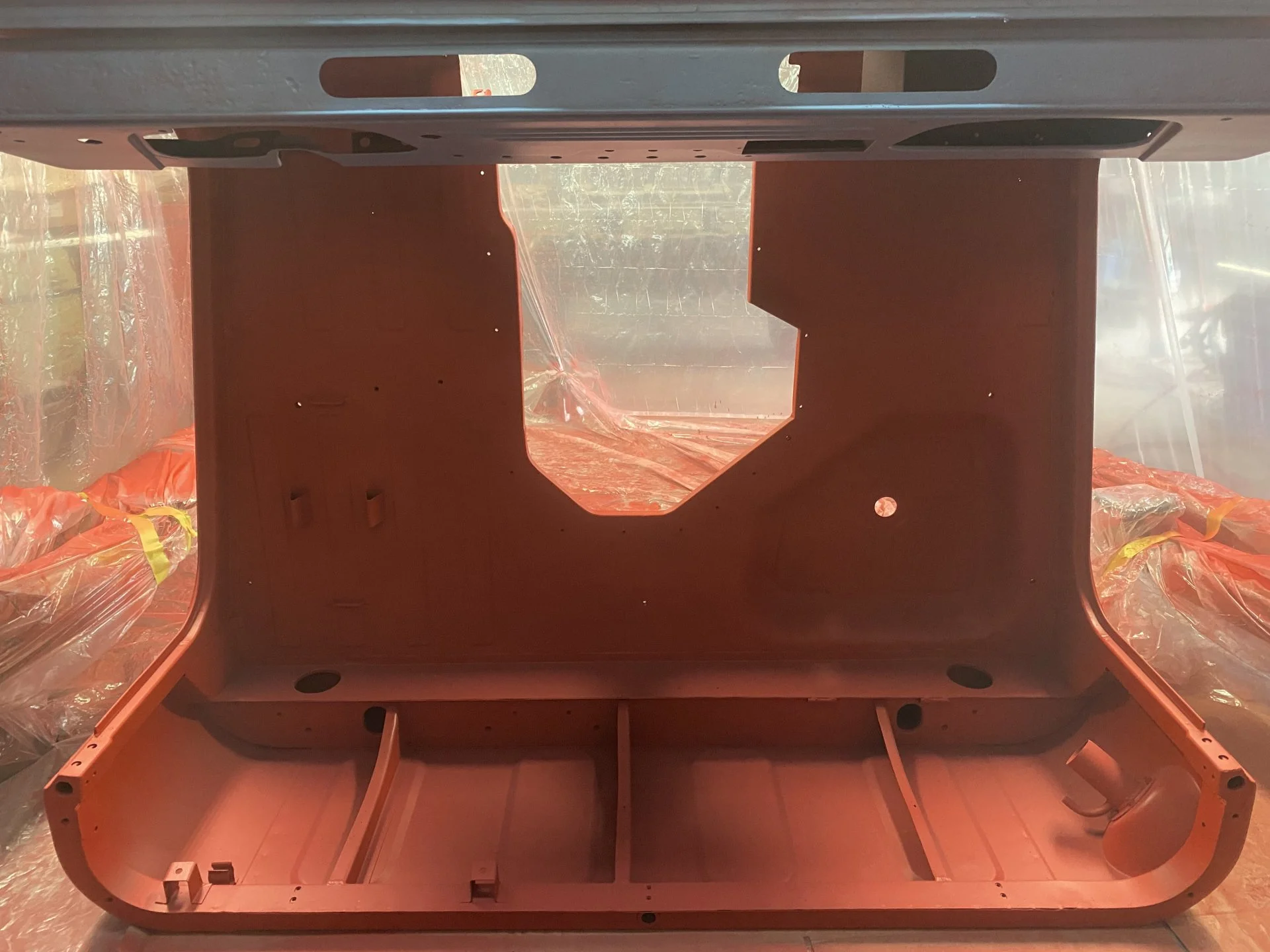

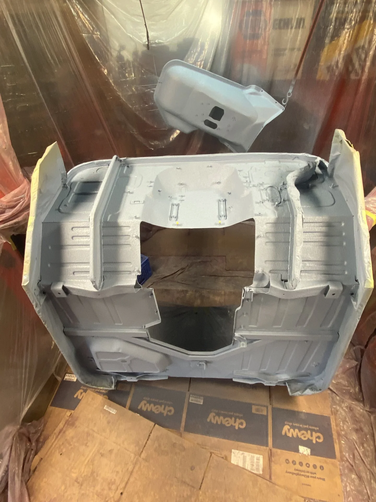

The epoxy and Horizontal Blue layers are done. It is not concourse but better, IMO, I won’t be overly saddened after the first scratch occurs which is likely during assembly as I fumble with things trying to put it back together.
I should be able to get the lizard skin prepared and sprayed today but will have to wait 24 hours before adding the Raptor liner.
I think if I ever take on another paint job like this I will get one of those body rotisserie’s it would make painting all the different angles so much easier.

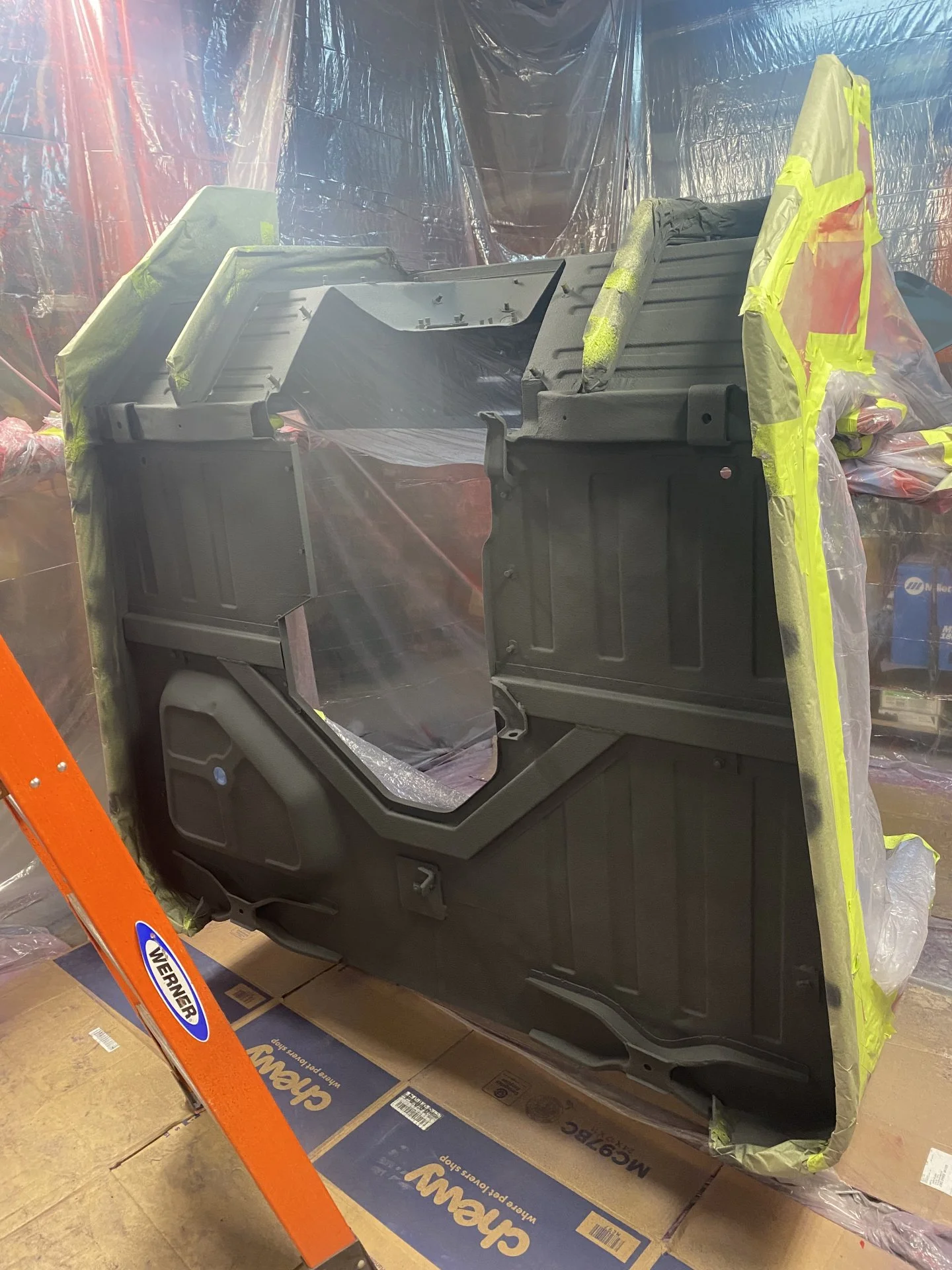

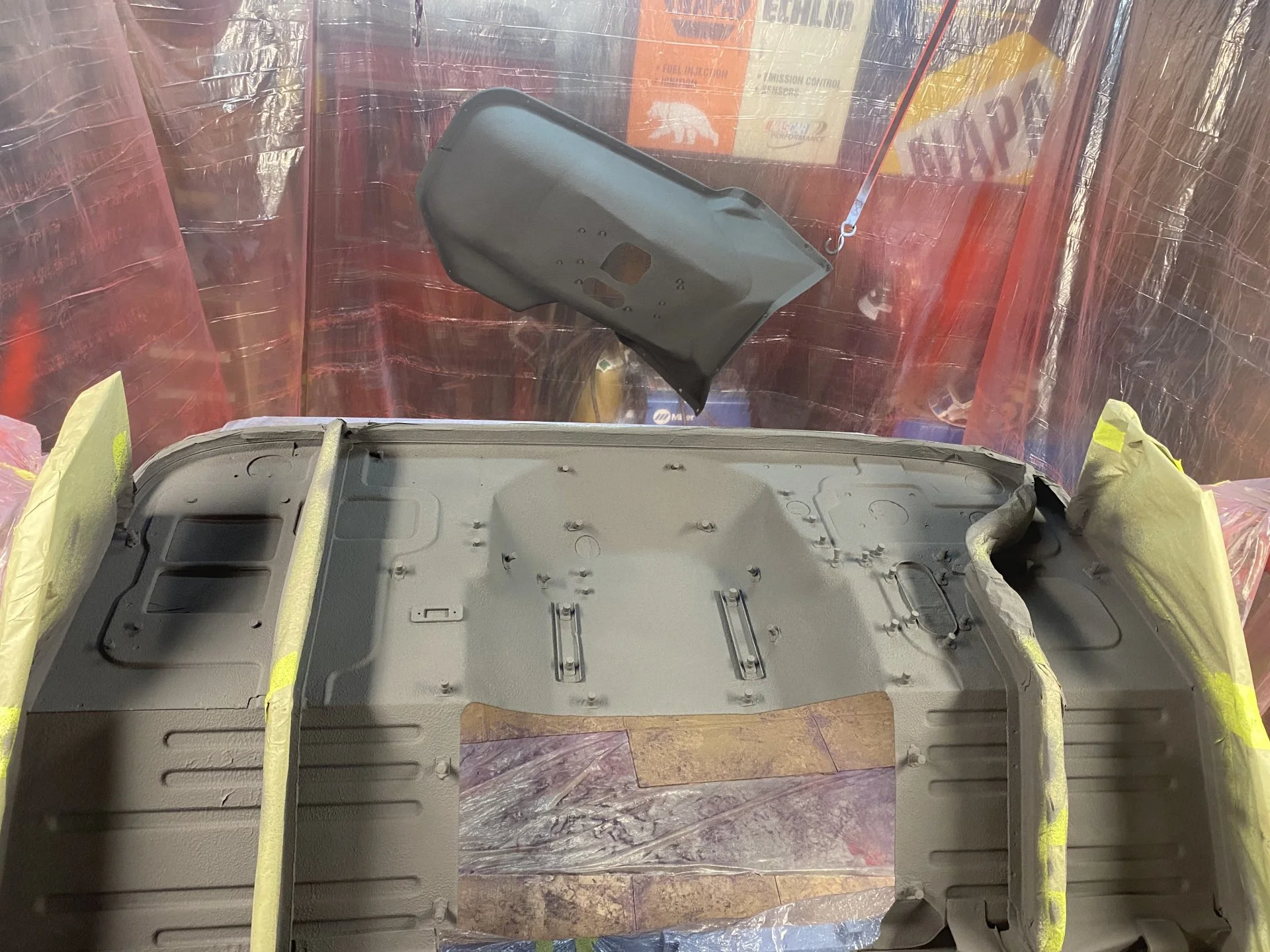

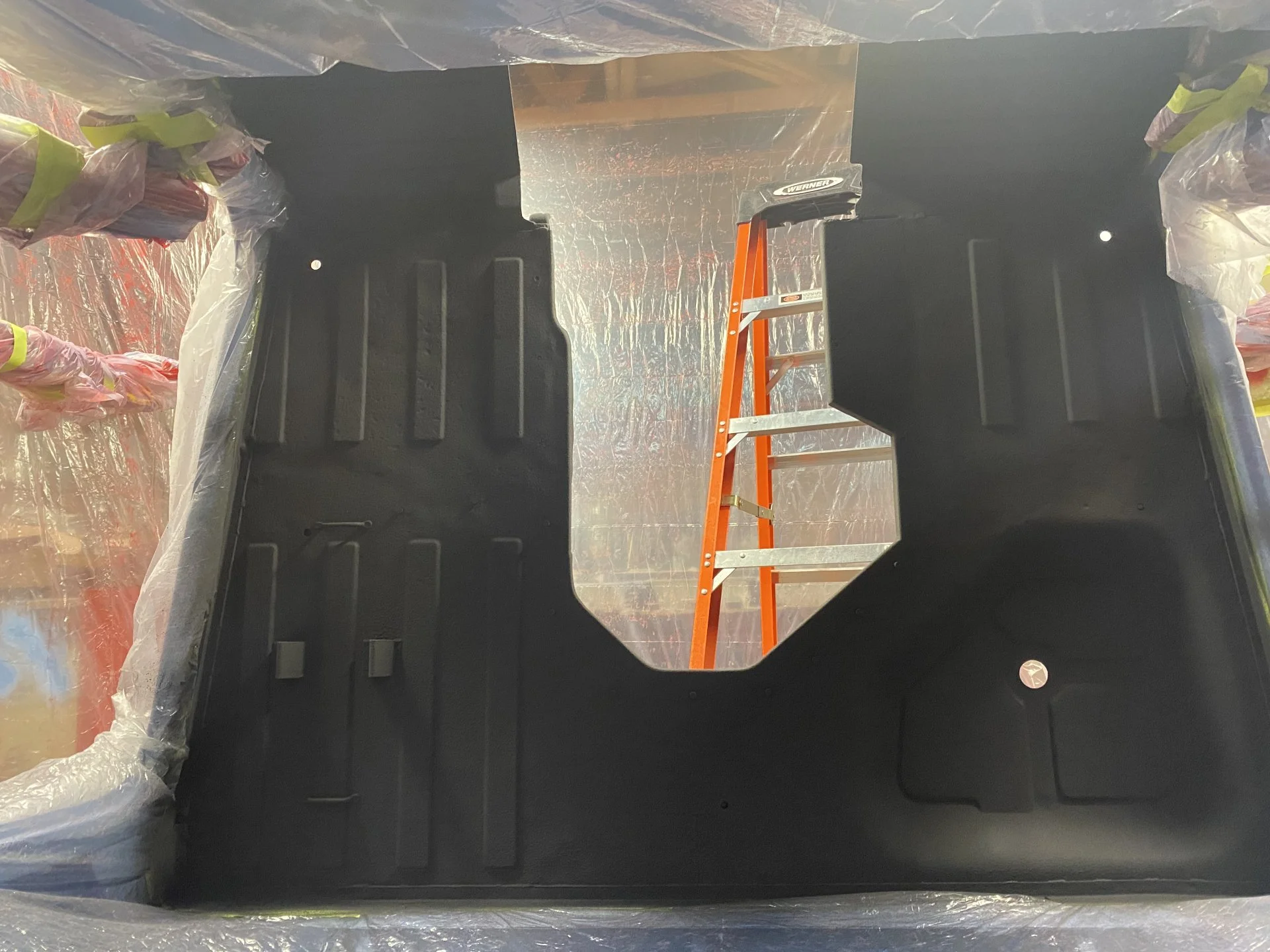

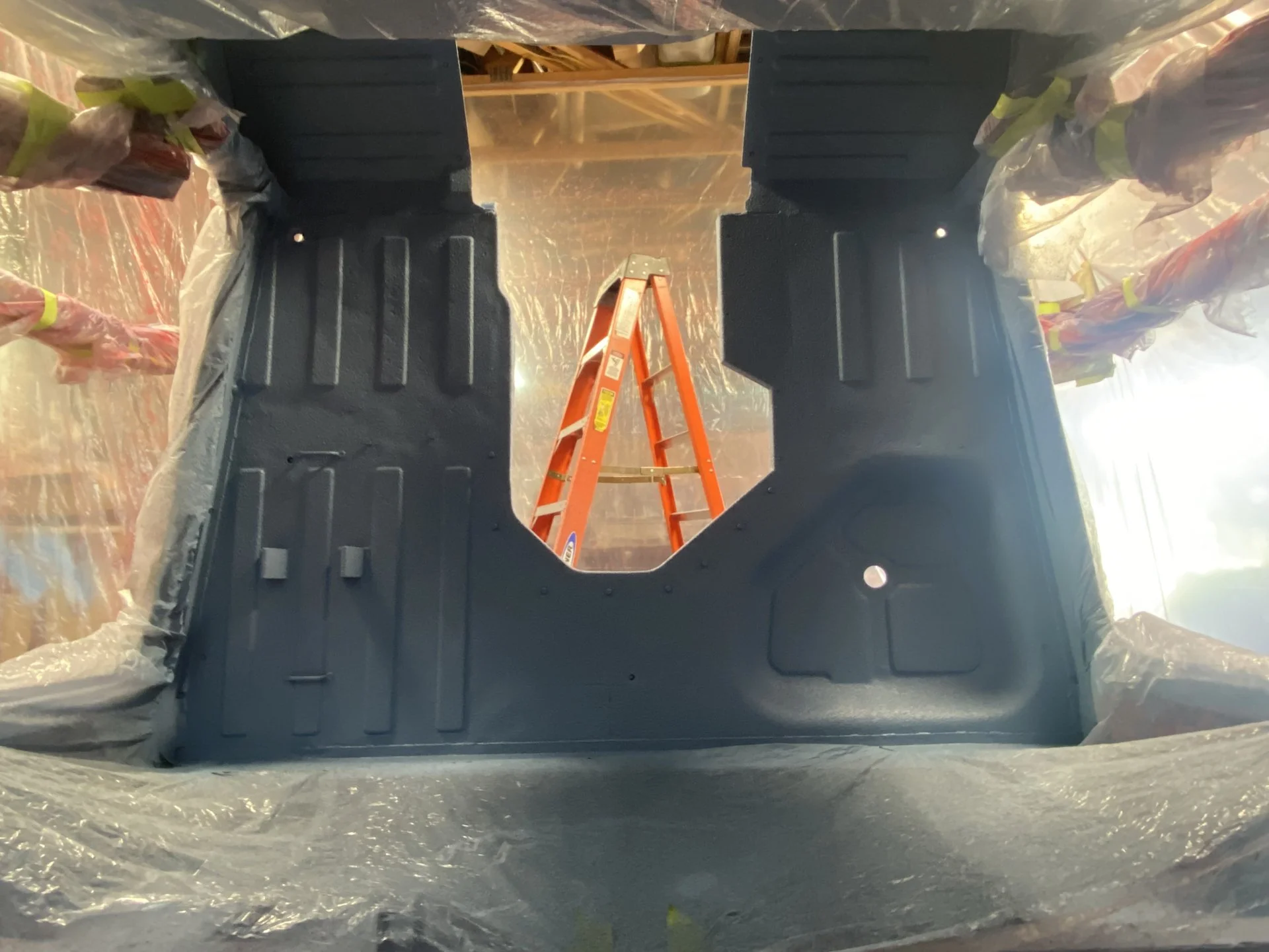

The remainder of the process was sanding and tape prep for the Lizard Skin, then spray and let it cure for 36 hours. I followed that by scuffing the larger flat surfaces, the Lizard Skin was pretty ruff as was and I probably could have left it but wanted to make sure adhesion wouldn’t be an issue.
Then I sprayed the Raptor Liner color matched to the same Horizontal blue. It looks really good. I can’t wait to start putting it together! Sorry for the crappy pictures lighting is not the best.

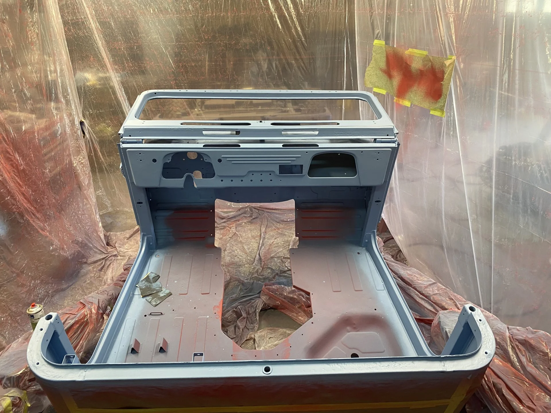

I put the cab back on the body today after more than 72 hours cure time. It seems to have turned out just as expected but the Horizontal Blue is more purple or violet than I expected. I wonder if the red primer is affecting it and if I should have sprayed more layers?
Here it is after setting it on the frame.
Here is a comparison picture of what I believe to be the original Horizontal Blue next to the new spray. When I had them mix the paint I asked for a satin finish rather than a gloss maybe that affected it?

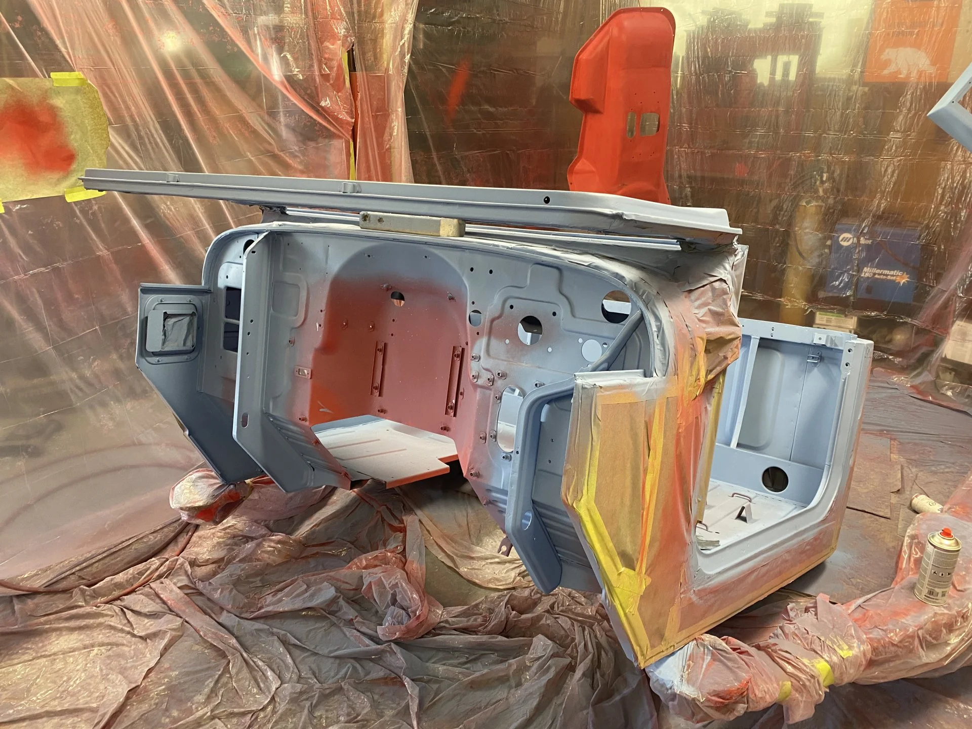

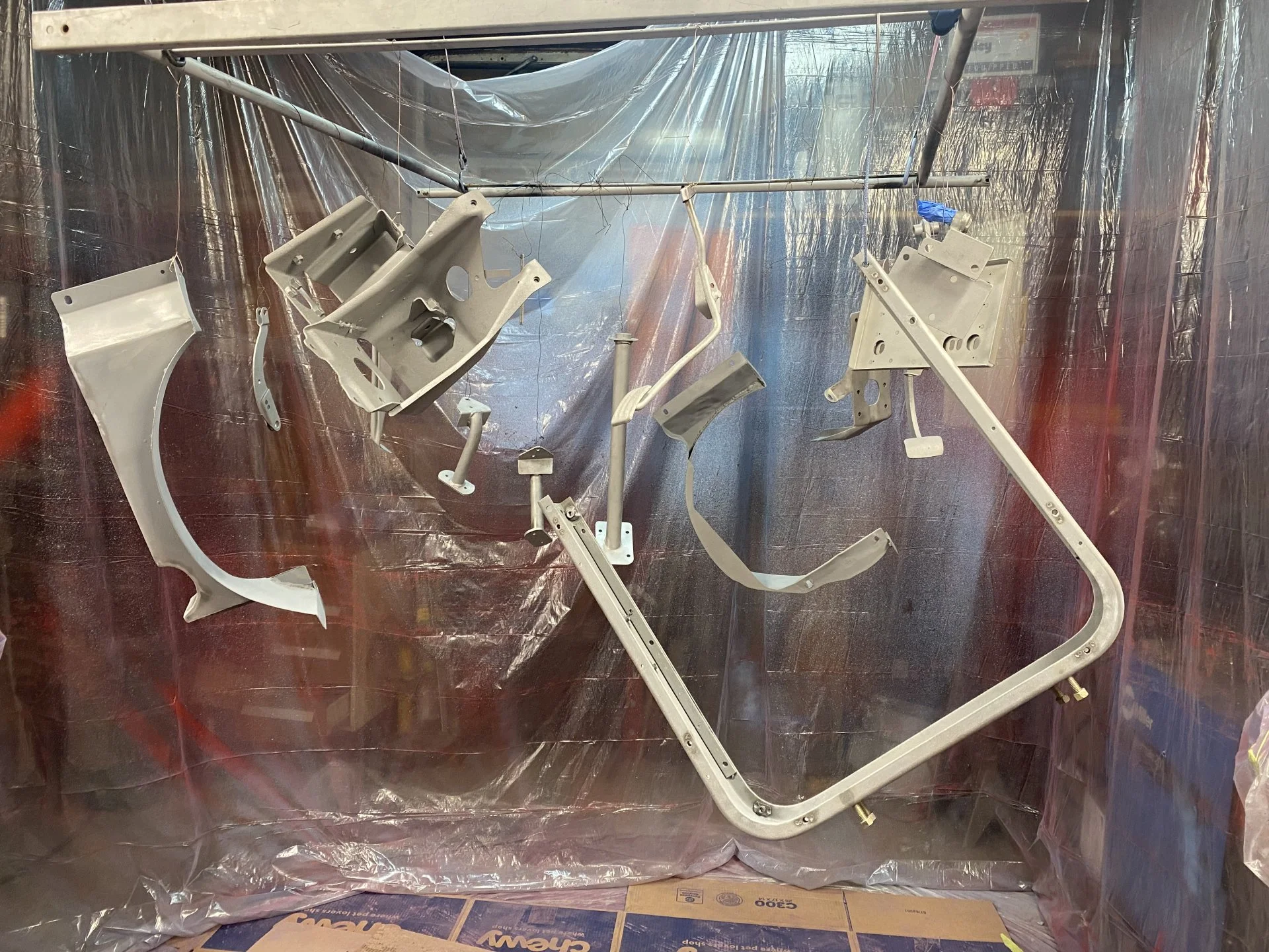

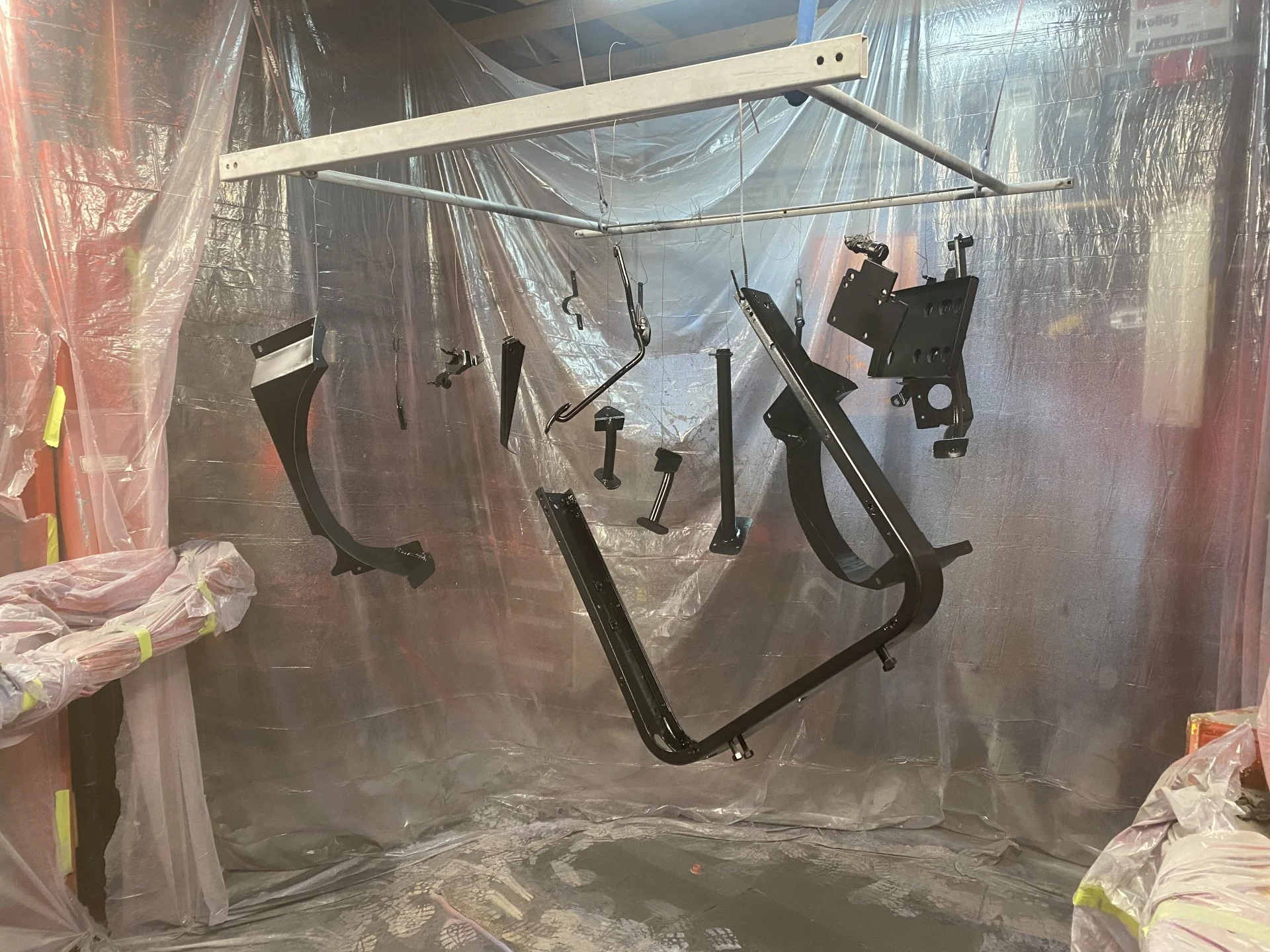

I am not repainting it, so I kept working. I knocked out some wiring harness adjustments, blasted some more parts, prepped, sprayed with epoxy primer, then some black. I wish I was done painting but there is still a bit more.

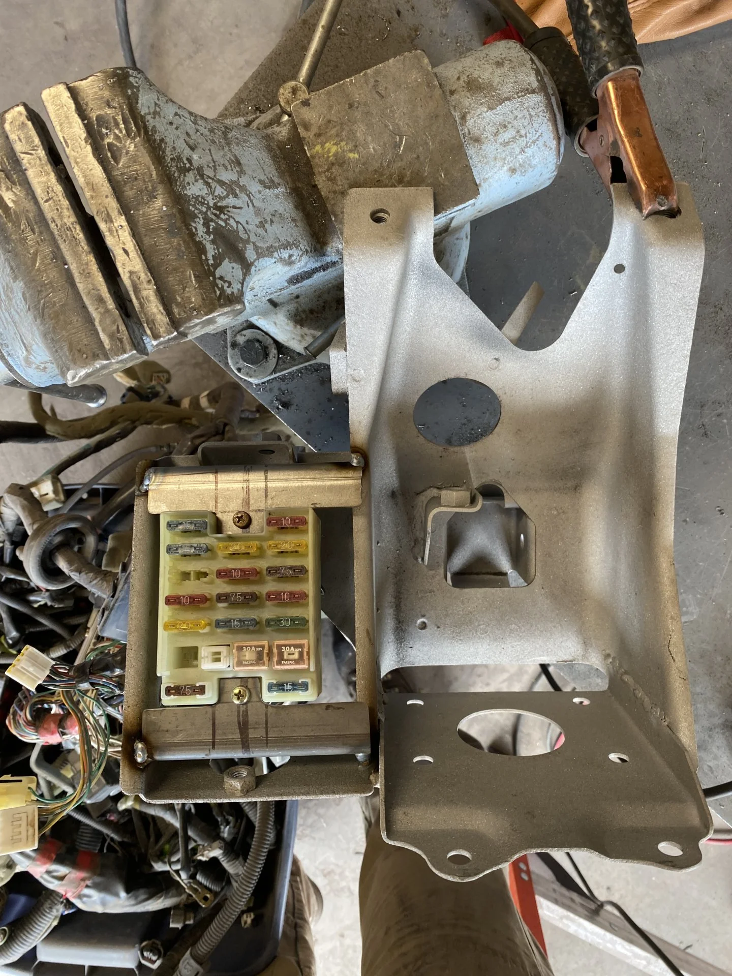

A lot more prep and painting today. I had forgotten that I needed to add mounts for the fuse box. I chose to mount it in the pedal assembly where the clutch pedal would have been.

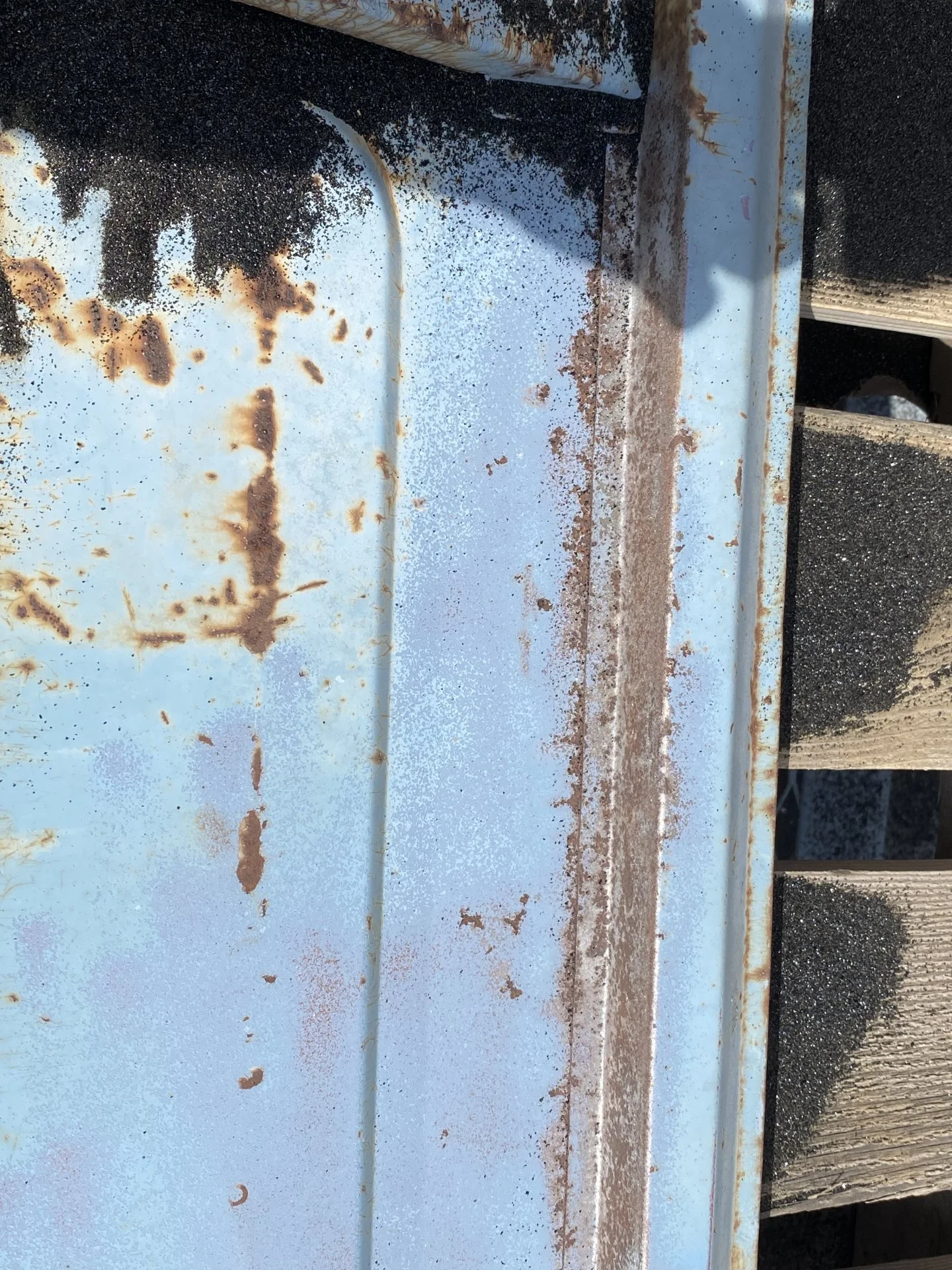

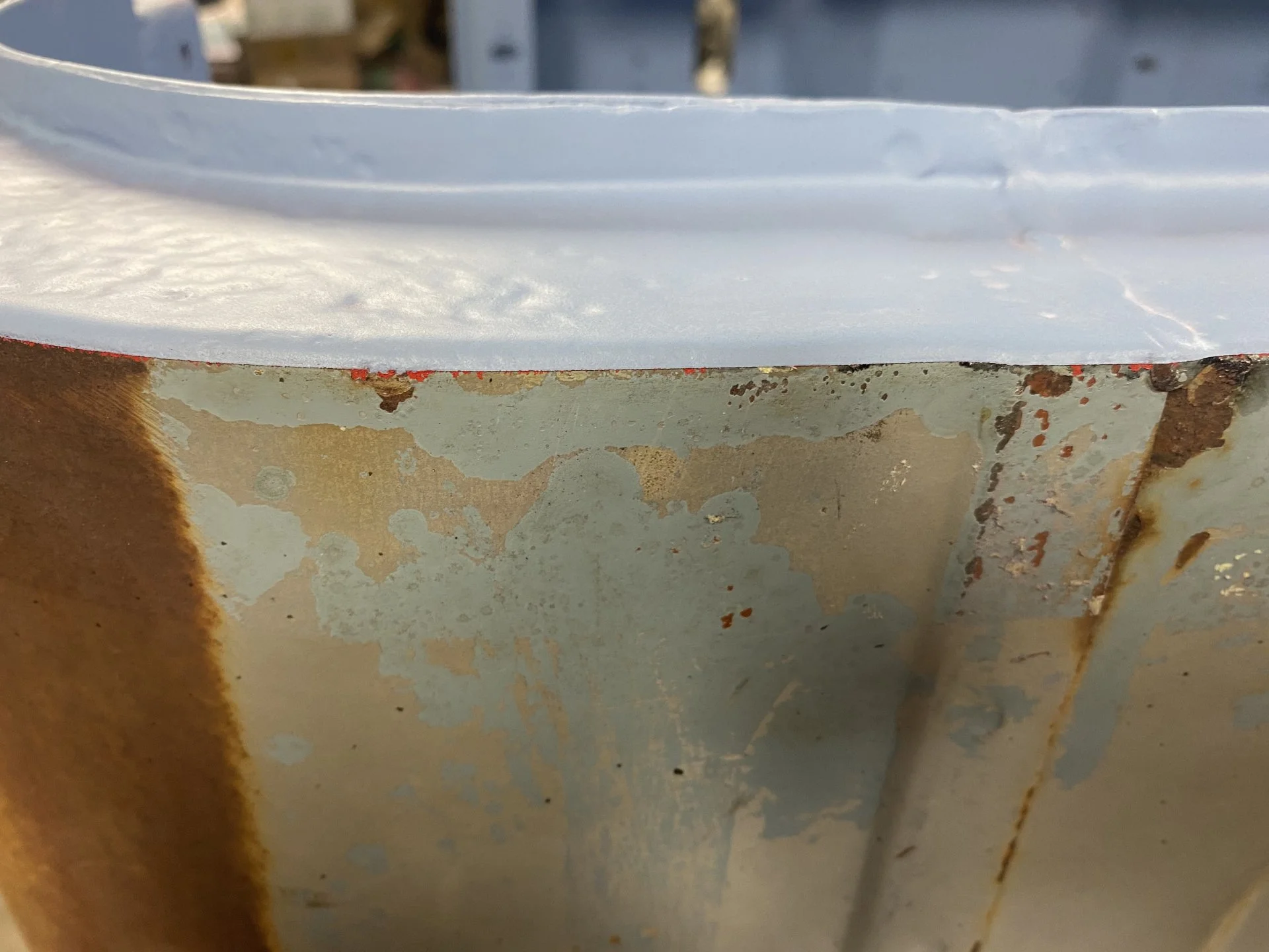

When I was blasting the inside of the top I realized that after the clear coat was removed the blue underneath was a lot like the blue I used on the interior. Probably harder to see in the picture but the degraded clear coat really hides the original color.

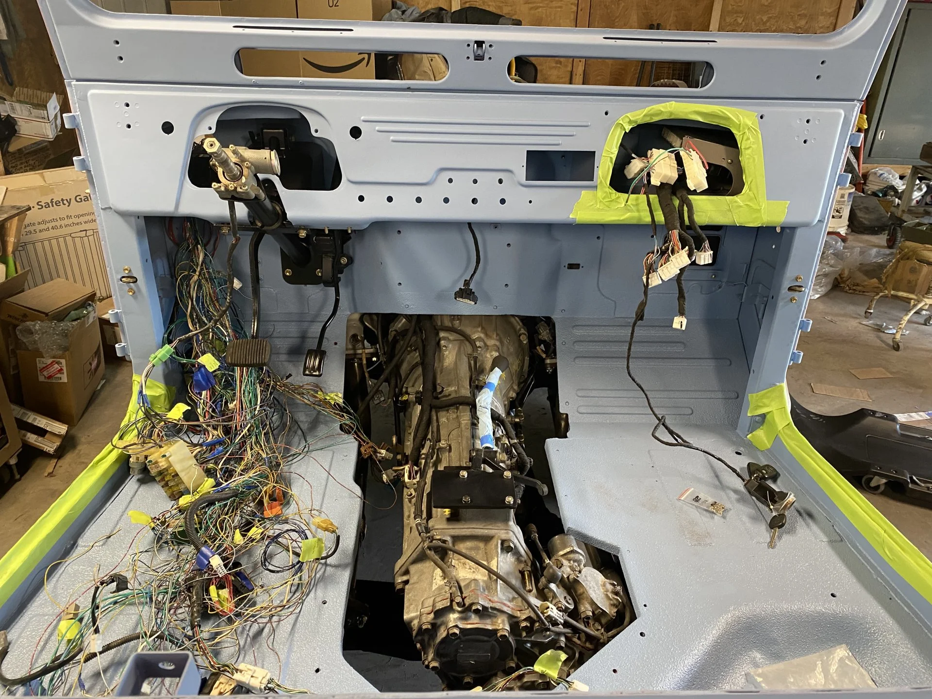

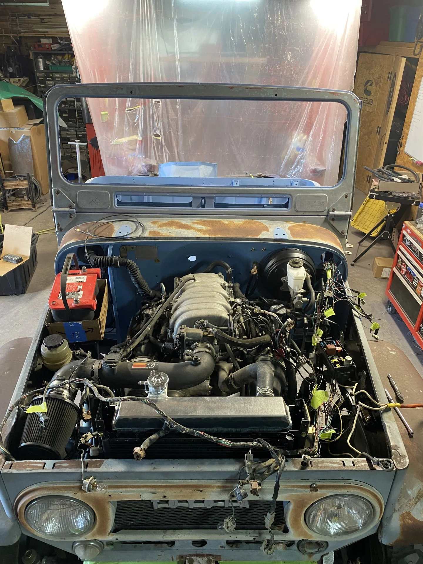

I have we been working every night and my weekends to get it back to together to where it is now. Most of my time was spent blasting, prepping, sanding, painting, sanding ppainting again and then reassembling. Most of all the fluid systems are all closed up, the last is the AC/Heater lines.
I have started fitting the harness back in. My goal is to hear it run before I start working on all the accessory items.
The Amazon battery tray will be replaced after the AC lines are done which run under the mount.

And boy, that looks familiar! Just about to close up my loom now that everything is working and she runs.
How much of the ECU wiring do you have to do yourself or is it a pre made loom? I'm sure you've stated already but I'm following way too many builds o_O

I paid to have a stand alone harness made. I still have someone wiring to do though. I made some modifications to it for fitting it where I wanted.
I had also changed direction on a few things such as the ignition and column that I had to adjust for.
