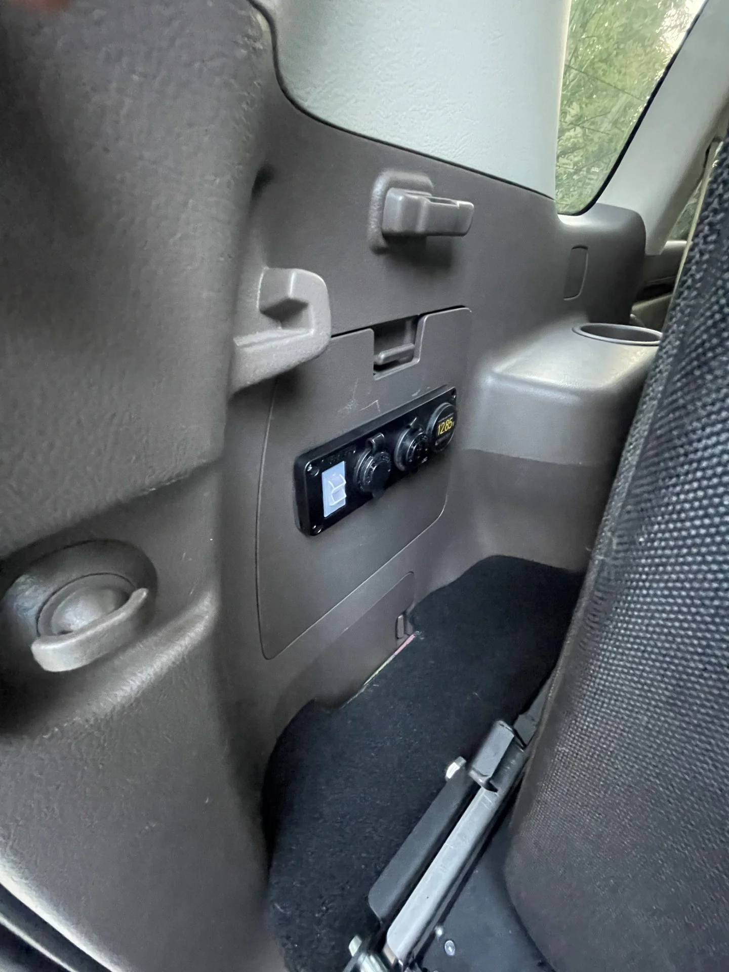

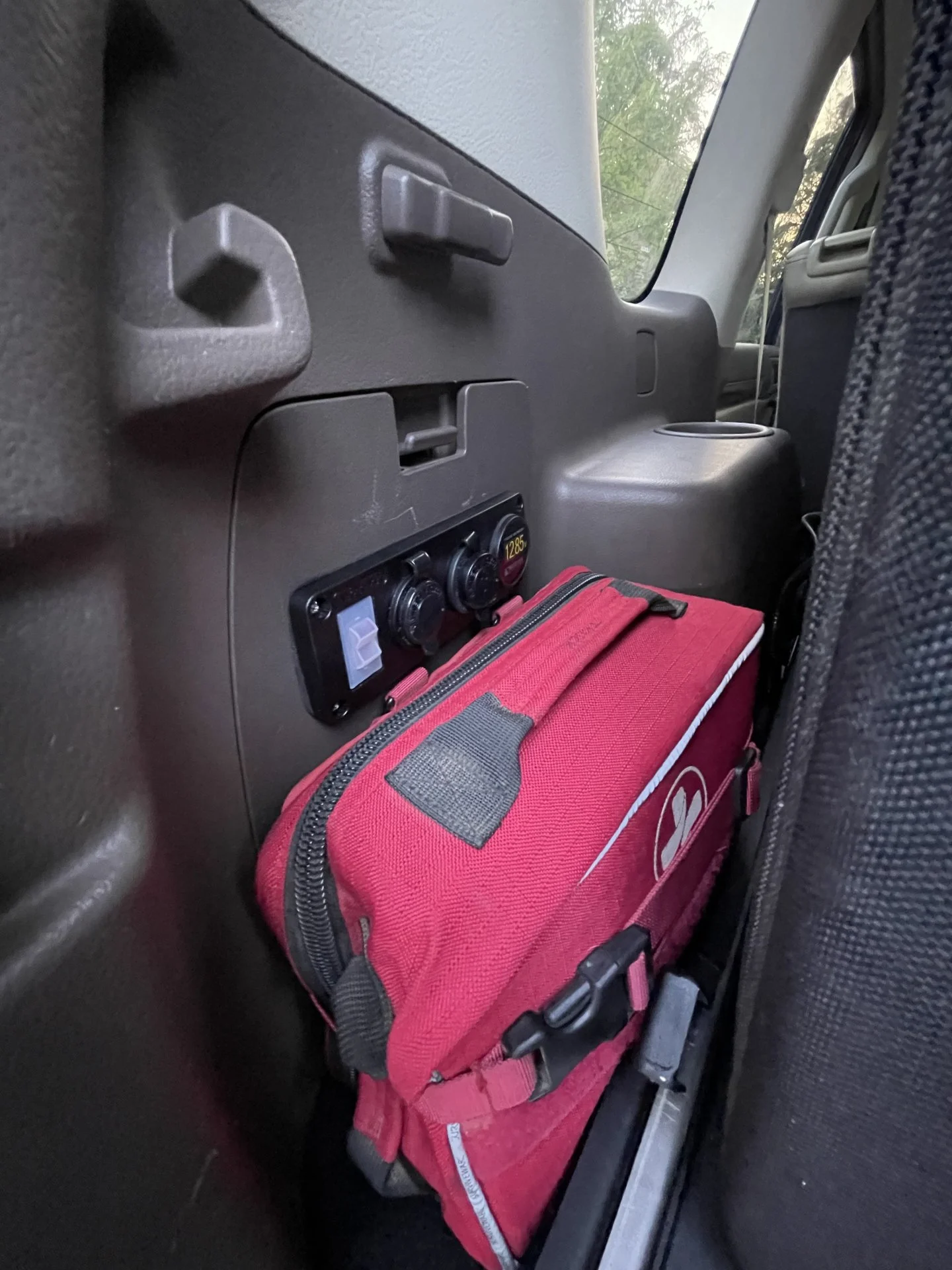

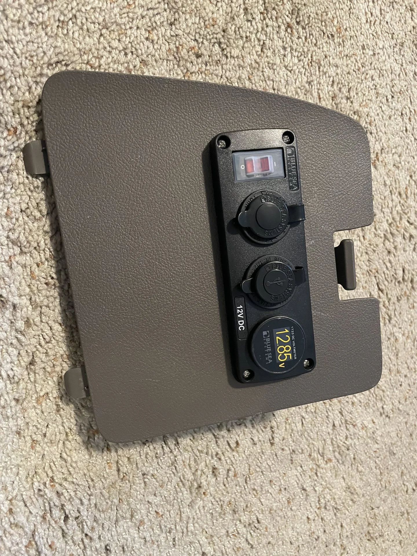

Also, I started building power stations for some friends and its turning out pretty good. I can build them using either the Big cubby cover ( where the ML subwoofer sits for non-ML trim) or in the Jack access door like in the picture below.
Pricing varies depending on what type of connections you need and how many, etc....
send me a msg and we can discuss further!
Cheers!!

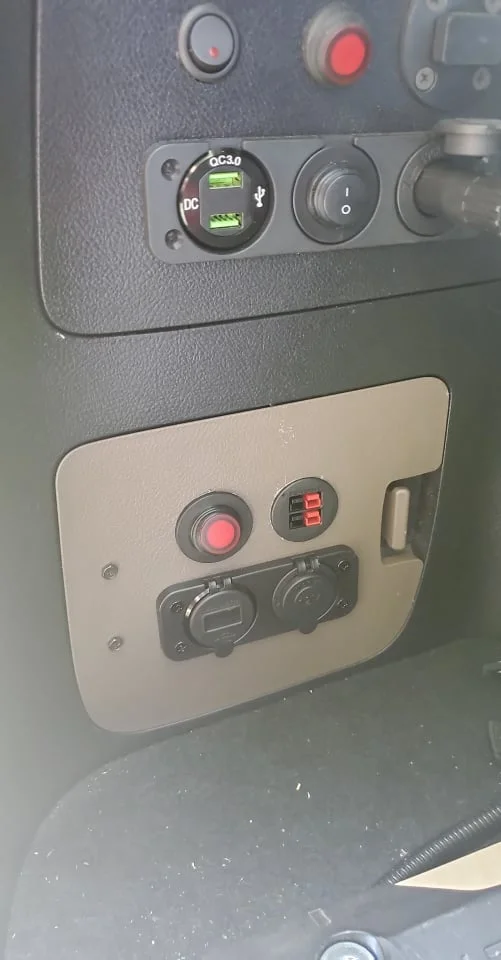

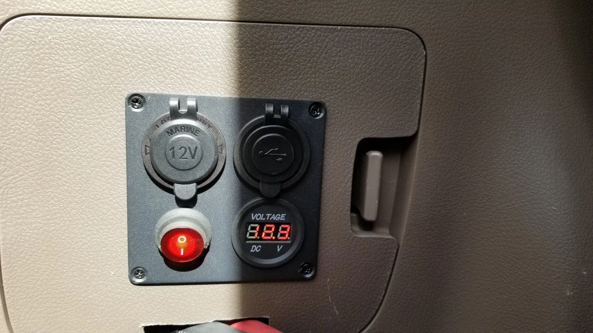

I did a setup like this years ago on the jack access panel cover. Works great and a perfect location for easy access.
20190331_152845-jpg.1941407
20190331_152900-jpg.1941412
