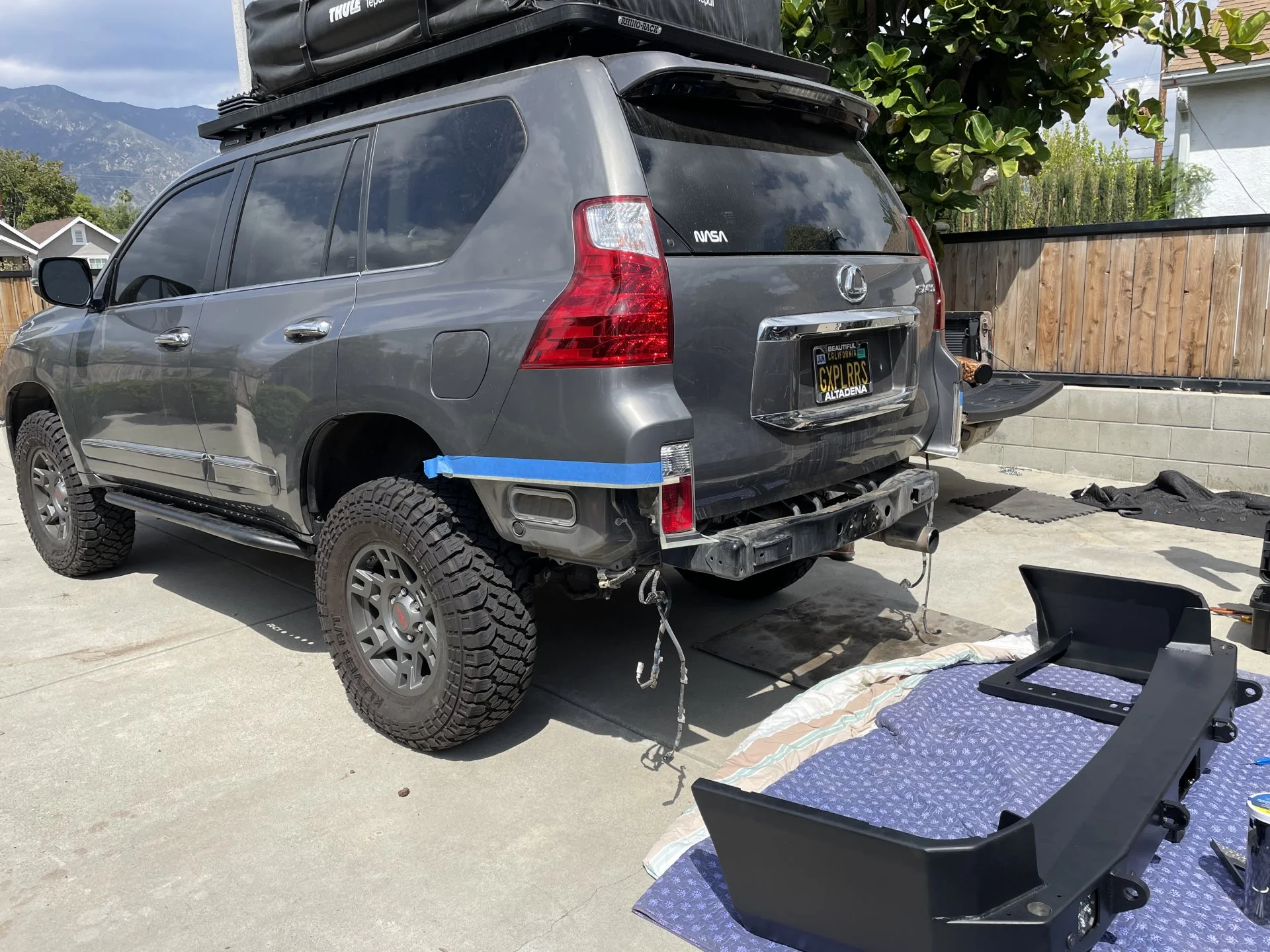

Rear Bumper Install
Thinking back, I think I my posts my be a little out of order from what I actually did. I was working the bumper installation while I was pulling the rear seats out and routing cables.
I had ordered a Victory 4x4 Strike Rear Bumper in August of last year, and it showed up right around the Christmas holiday. After sitting for a few months in my shed, I finally had gotten everything else to a place where I was ready for the bumper install.

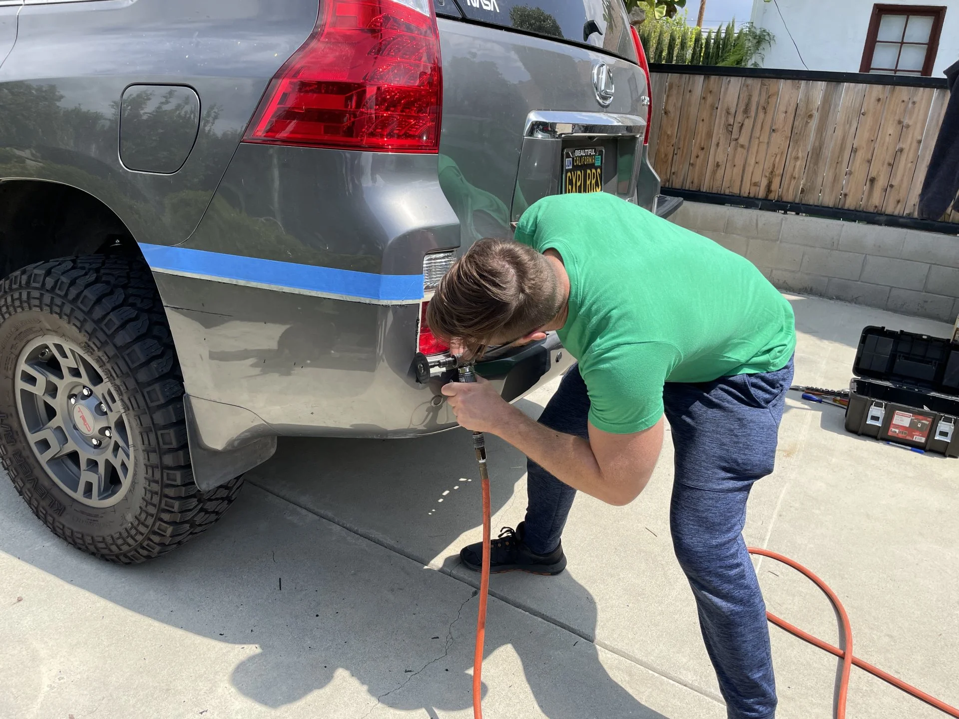

I had two buddies helping me, and we followed the Victory 4x4 Installation video for all of these steps. The only thing to really note here is that I did spend the money to buy the recommend layout tape that they discussed in the video. This was worth every penny, as it was pretty stiff when stuck down, but flexible enough to make bends. You could probably do the same thing with painter's tape, but this stuff definitely made the job easier...And after all, you kind of only get one cut to make it right. Here's a photo of the passenger side marked out:

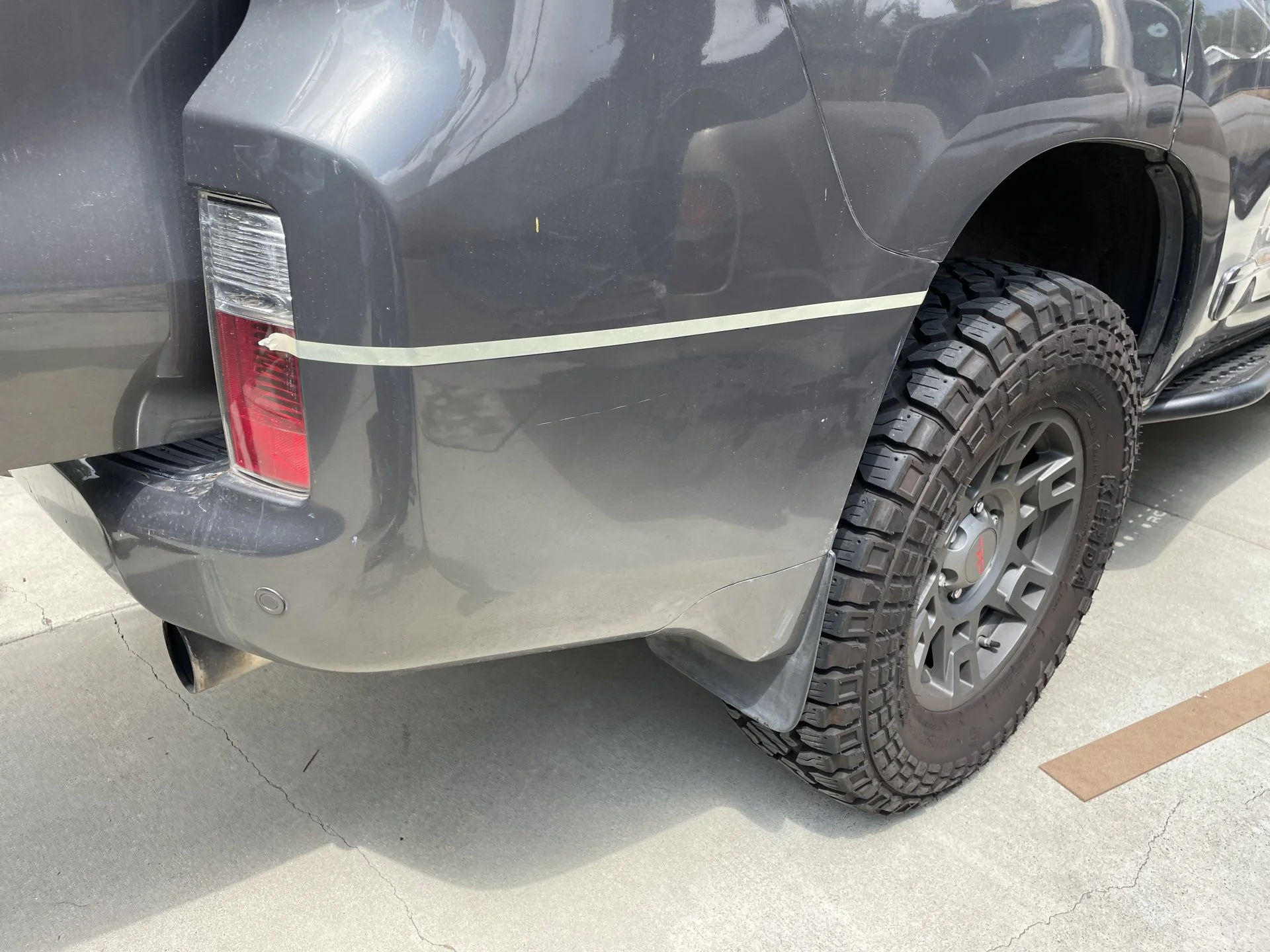

From there, I also applied 2" wide painter's tape above the thinner layout tape (above), to help protect the body while cutting. In terms of cutting, we used a rotary air tool with a new cut-off wheel. This is definitely the way to go, as the wheel doesn't get hot which prevents meting or bubbling of the paint. This left a somewhat rough edge which we then cleaned up with a file and a demurring tool.

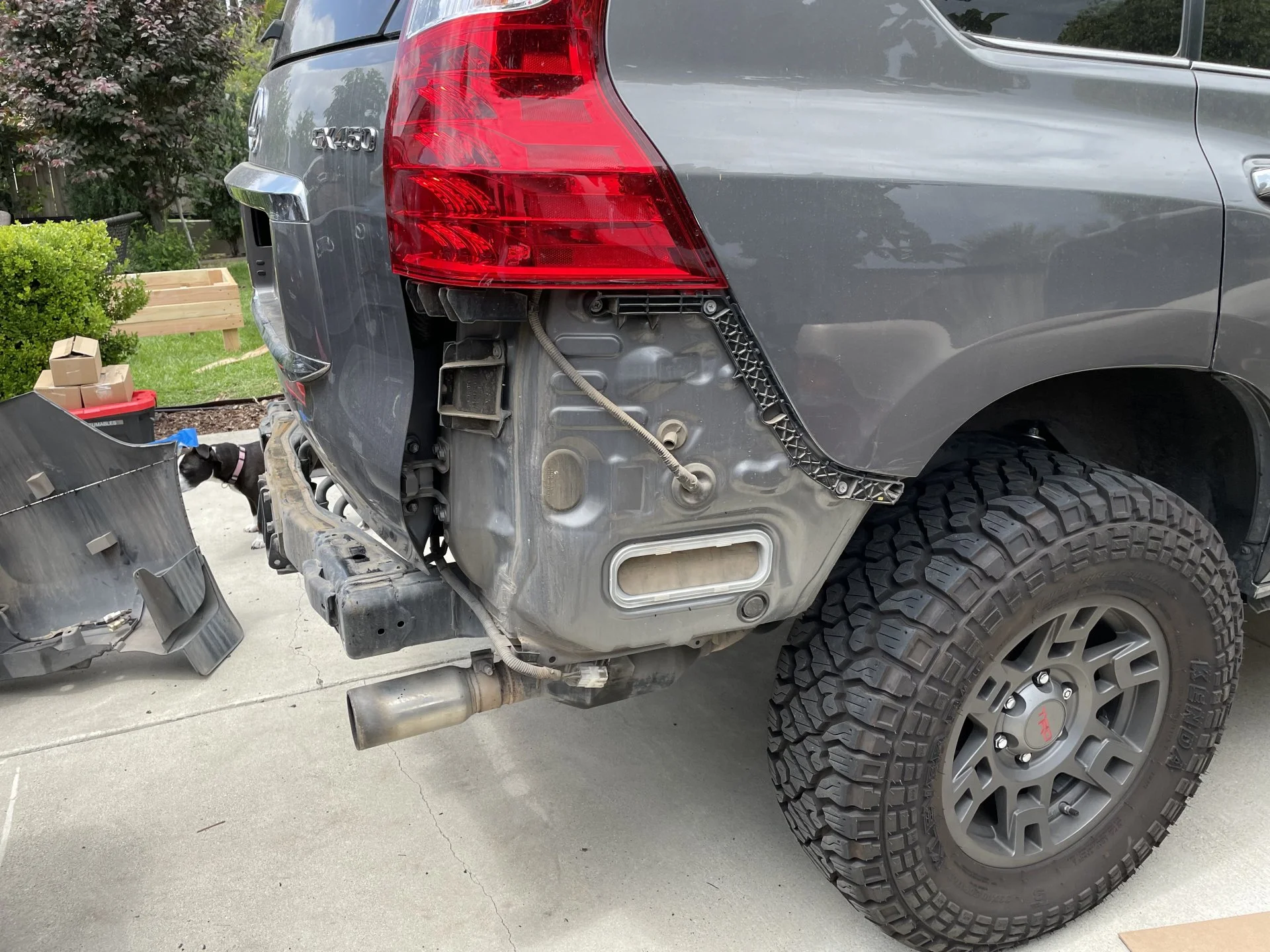

With the cuts made and a few electrical connectors later, the rear fascia is easily removable. It's pretty interesting to see the size difference between the "bumper" and the rear fascia, as shown in the photo in the upper right.
I don't have many great photos from this step, but I spent about an hour or so installing lights, routing cables, and connecting my rear proximity sensors in the new Strike Bumper. For lights, I went with the Diode Dynamics SS3 pods with a flood pattern. These easily assemble to the interfaces on the rear bumper, although the fit might be better if you were to use the Baja Designs variant, which the bumper was designed for. The below photo shows the setup right before final install. Note the dangling electrical harnesses. which were installed to the vehicle side before they were connected to the (lights & proximity) wires, which were routed along the bumper.

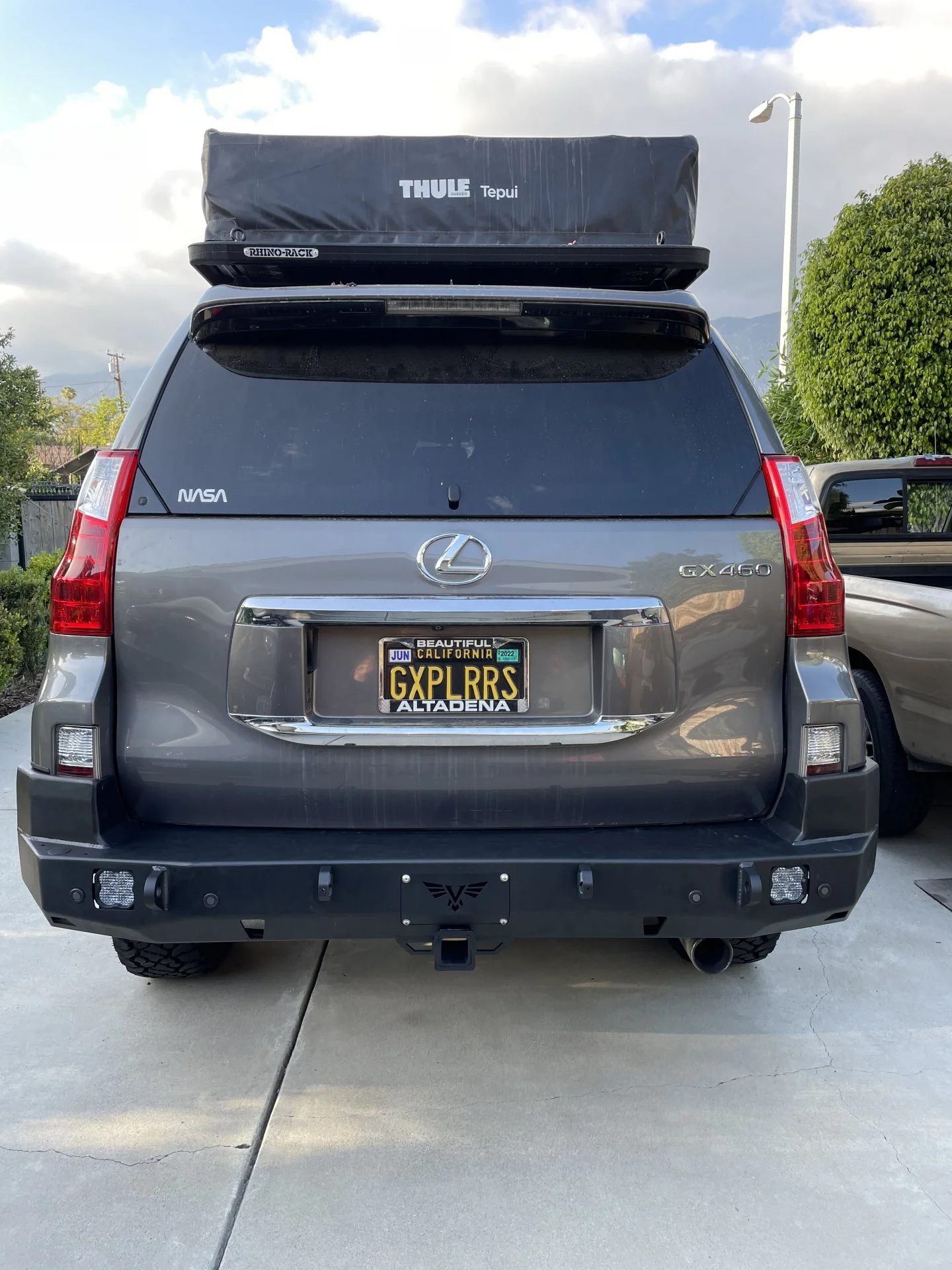

I wish I could say that at this step, we bolted the bumper up, and everything fit flawlessly. For whatever reason (and I'm not sure why because we had 3x Mechanical Engineers working this), there was a variable gap between the flat surface on the driver's side of the bumper and the flat surface on the driver side trim. The cut was dead nuts, but perhaps sloping down slightly, so we couldn't get the bumper to interface at the right height on the vehicle. After removing the bumper, cleaning up the cut, and reinstalling everything, the final product turned out pretty well.
In terms of time, this whole install took about 3/4 of a day, including the quick go-back to clean up our cuts. I ended up finishing the cut surfaces with weather stripping, which gave everything a really clean look.

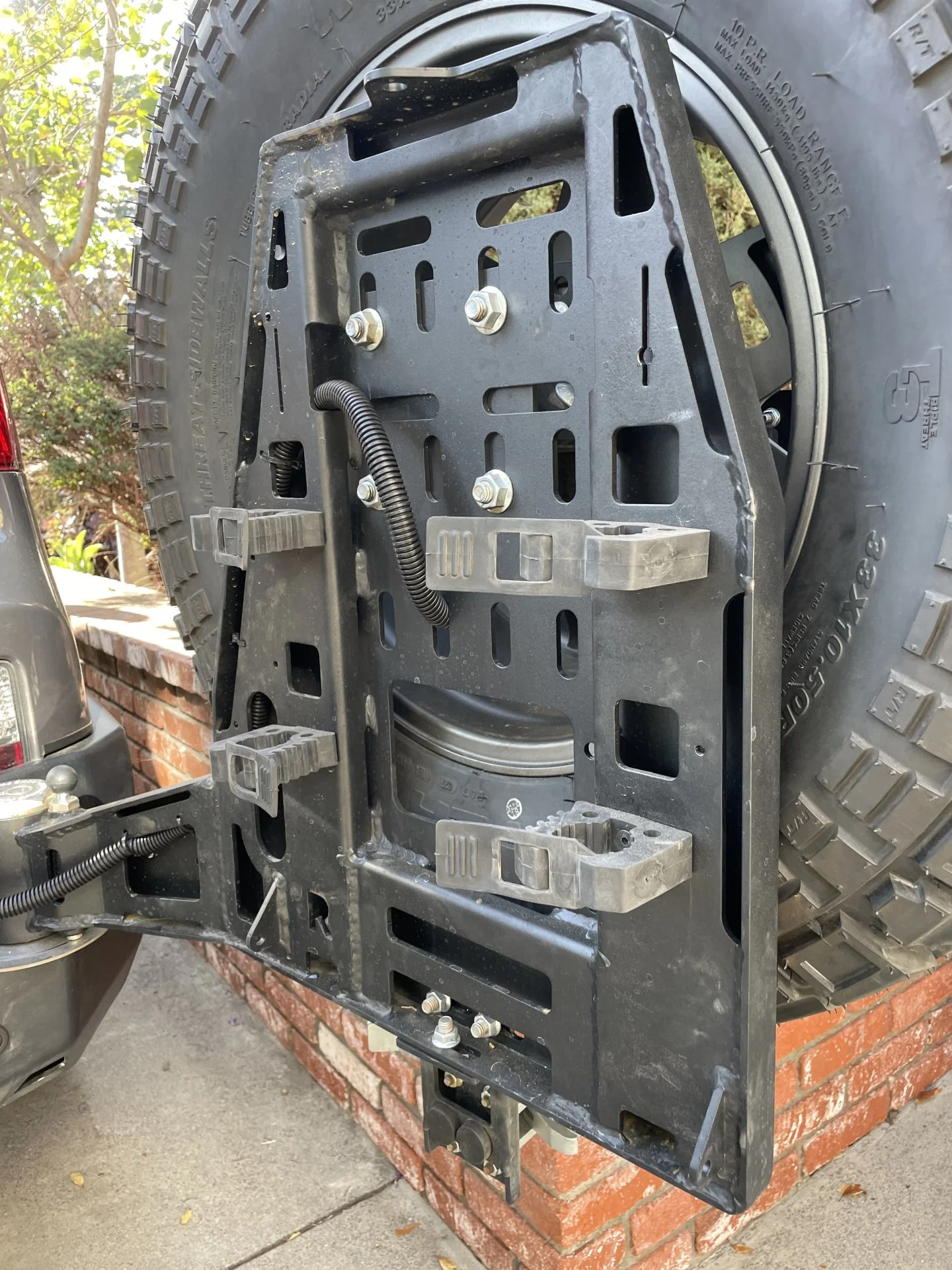

Swingout Install

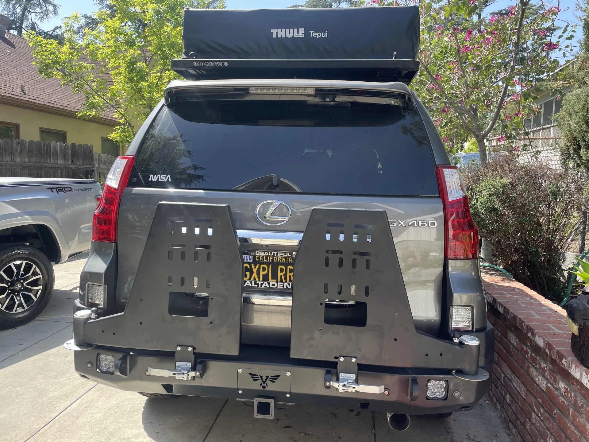

With the Victory 4x4 Strike Rear Bumper integrated with the vehicle, I then installed Victory 4x4's Adventure Carriers.
I had purchased both a driver side swing out and a passenger side swing out. The plan was to mount 2x 20L Jerry cans on the driver side swing out and my spare tire to the passenger side swing out. The thought here was that if I had a flat on the road, I would be removing the spare tire in the direction of the shoulder and not into the roadway.
I followed the Victory 4x4 installation video for both carriers, which did a good job detailing the assembly operations step by step. Here's what the Adventure Carriers looked like without the supplemental accessories.
I have to give credit to Victory 4x4 for the hardware that they selected for these carriers. The latches, bearings, and stops were very well built. Everything swings smoothly, and seems to be robust / sealed from the elements.
Overall, this was an easy install, but I did run into a couple hiccups along the way. The first issue that I ran into was that the spindles / pivots for each swingout were very difficult to install into the rear bumper. The install video shows the spindles easily dropping into the bumper, but I had to lube them up and tap them in with a mallet. Given that these are stationary components, I wasn't worried about my approach. The second hiccup was the fact that my 20L Scepter water cans did not fit into the Jerry can holder. I dug a little deeper on this, and it looks like the Jerry Can Holder was designed specifically for the Wavian sized cans. So, I replaced my Scepter cans with Wavian cans.
Here's the final configuration, with everything installed:

Swingout Install

That kinda sucks that the jerry can mounts only hold one type of and size of can. My MetalTech rear bumper easily takes the Scepter cans. Actually only have on water jerry can I keep on there all the time and the space is for a large ammo can I keep recovery gear in. The ammo can is a PA156 81mm Short Mortar Ammo Box that measures: 23" tall, 14" long, 5.5" wide. Fit's almost perfect in a jerry can slot! (although not sure if it'll fit in yours...)

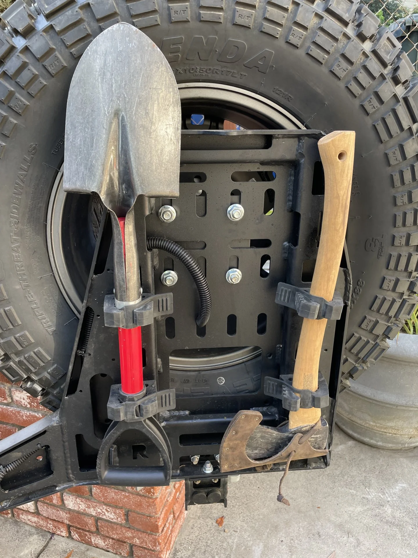

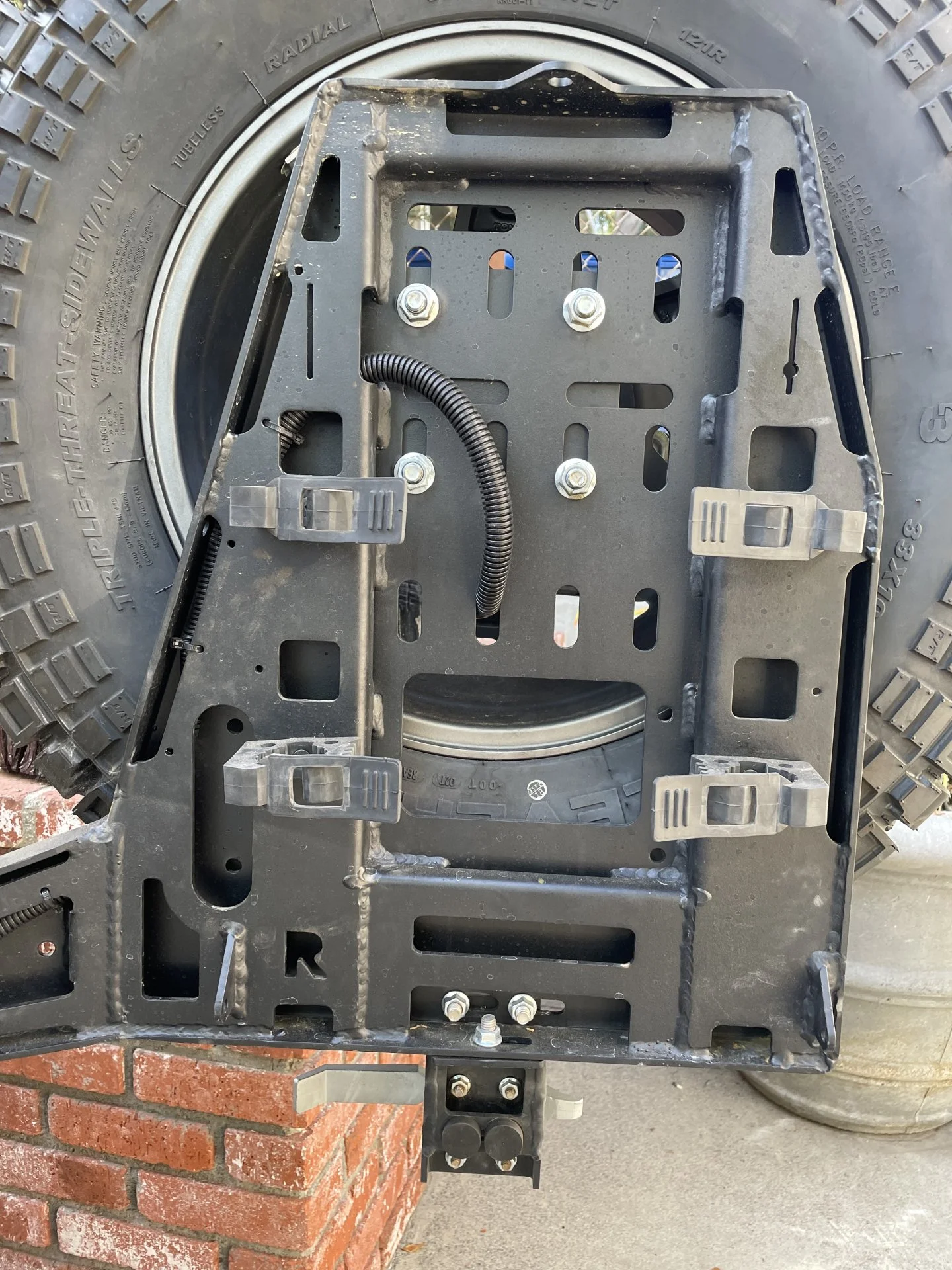

Shovel & Axe Mount

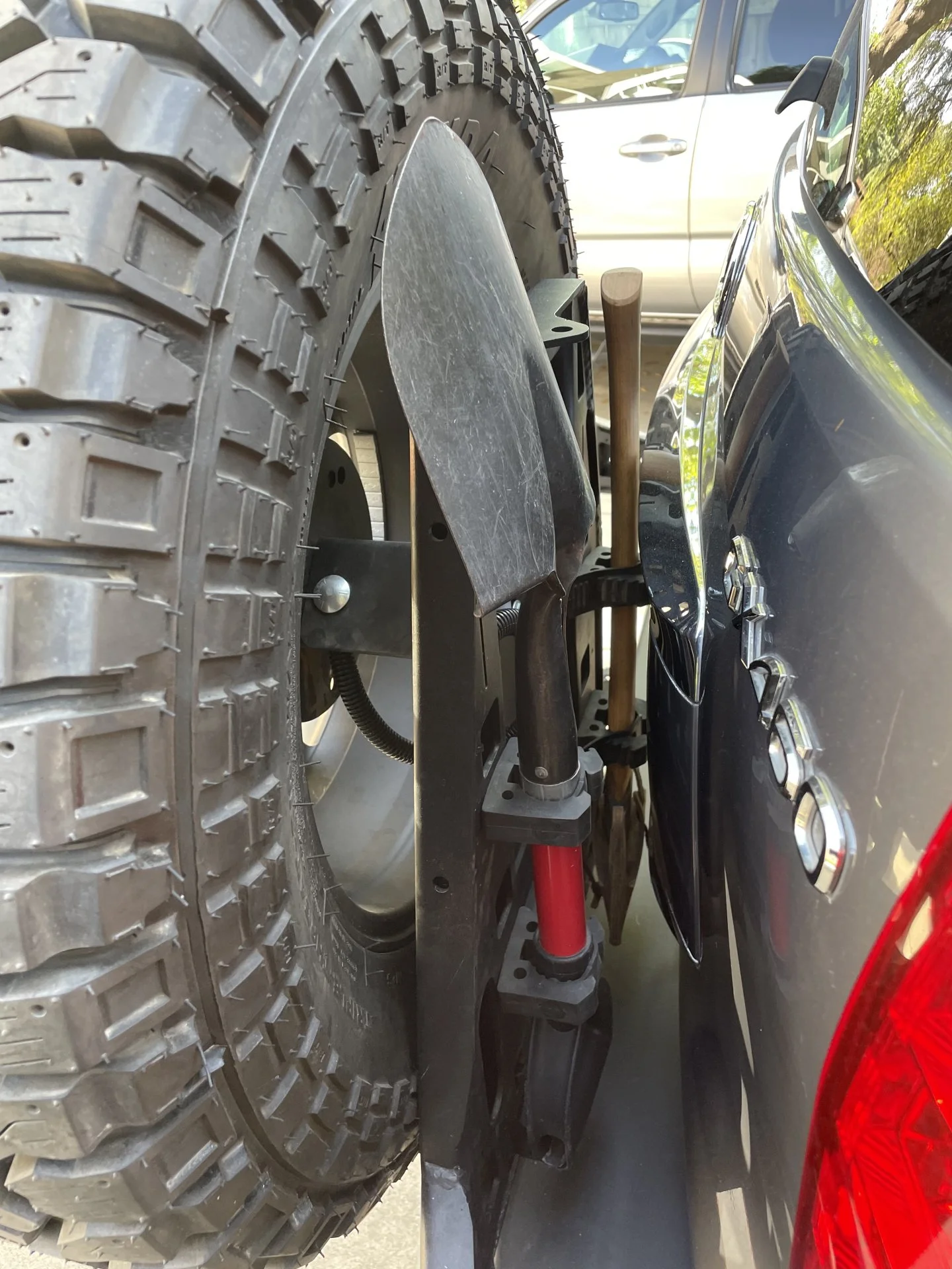

With the adventure carriers installed, I wanted to mount my shovel and axe to the back side of one of the swing outs. I was thinking that this would be cool becuase the items would be easily accessible, yet would be tucked into what was previously dead space. With this install, I also opted to mount everything on the passenger side swing out, so that I could grab items off of the car, on the side of the road, without having to be in the roadway.
This install was easily accomplished with a few Quick-Fists, and interface hardware from my local hardware store. I mocked everything up and then drilled two holes in the back of the passenger side adventure carrier. I demurred those holes and hit them with some black spray paint to prevent rusting (all other surfaces on the adventure carriers are powder coated). Here's what that looked like:
With my shovel and axe mounted, here's the final product. I probably could have shifted the top quick fists to be a little higher up, but due to the angle of the adventure carriers, they would overhang the edge, which I didn't like. This configuration seems plenty sturdy, and if (worst-case), one of these things were to fall, it's basically trapped against the rear bumper.
All in all, this was a pretty straightforward project, that took all of 30 minutes. From the looks of it, this will improve functionality, and eliminate these items from inside the truck!

Shovel & Axe Mount
View attachment 3012562View attachment 3012565

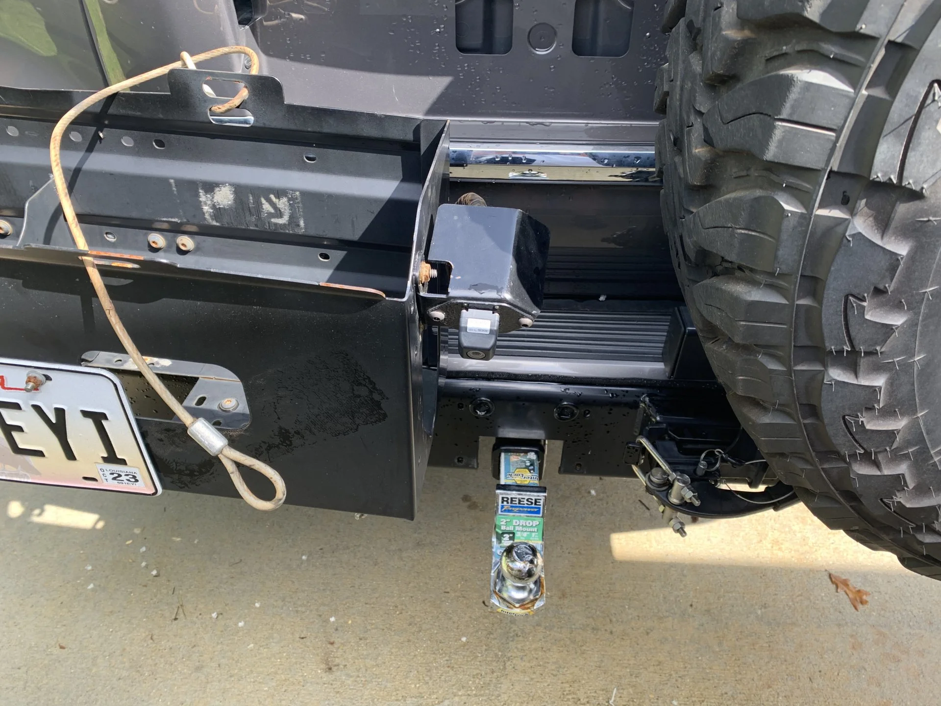

Looks great! I've done that also with some of my gear, to get it out of the cab.
Just a suggestion, especially since you're in L.A. (about 50 miles north of me). I'd run a wire cable through your shovel, axe and tire carrier with a simple padlock. Helps to keep the honest, honest if anyone see it. I have every thing on the back of mine locked. I use the set-your-own combination locks so I can 1) have my own combination, easier to remember, 2) they're all the same combo which, did I mention, makes it easier to remember.
If you go to my build thread at post page 4, #68: Builds - R2M 2013 Lexus GX460 Overland Build - https://forum.ih8mud.com/threads/r2m-2013-lexus-gx460-overland-build.1104719/page-4
It's not a great picture, but you can see a cable running through my MaxTrax and the combo locks for my jerry cans. I also have a short cable looped through my HighLift with the same type of lock.
Good thinking! I have my maxtrax and fuel cans locked with padlocks that are keyed the same. But, I should probably do something about the axe and shovel as well. One of the selling points for me on the drawers, is that those also have built in locks, which adds yet another layer of security against the gear that is left in the car. I think the next thing for me is going to be some rock lights from Diode Dynamics, when they eventually are released!

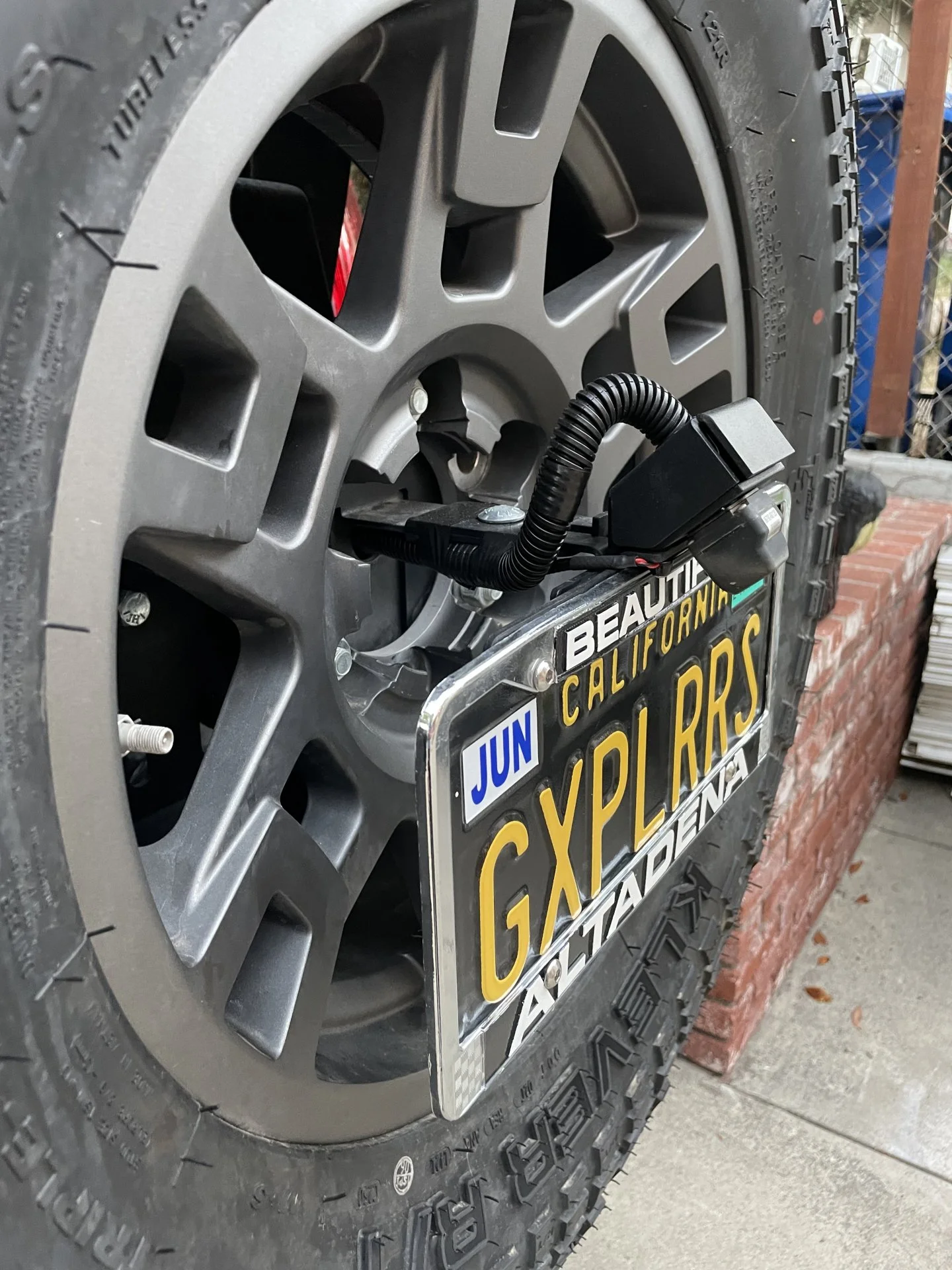

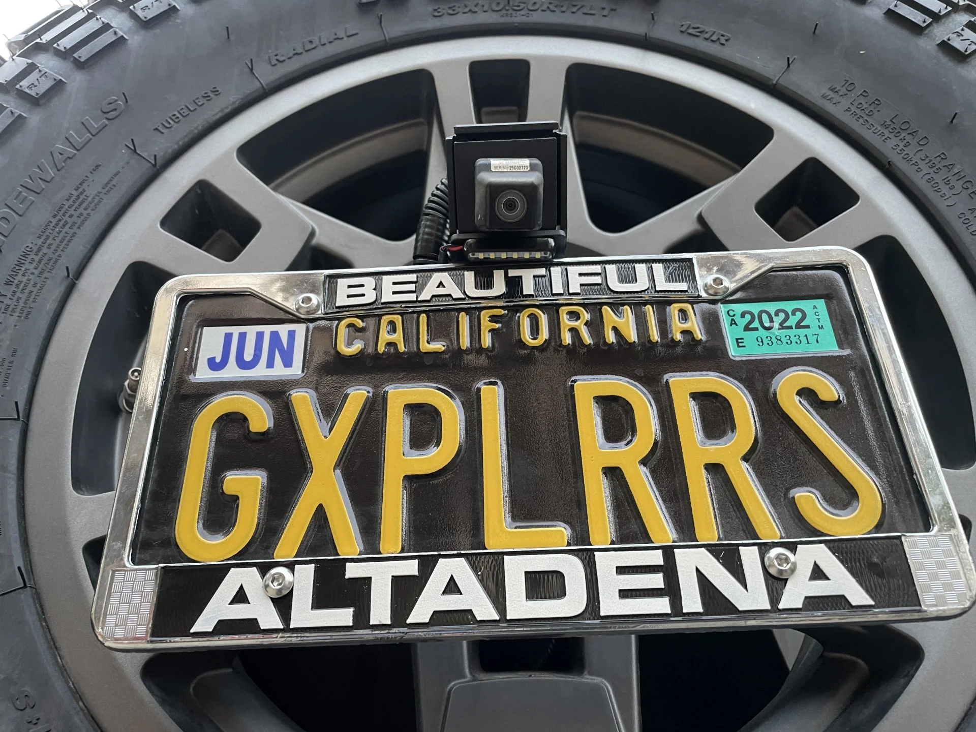

Rear Camera & License Plate Relocation
Next on the hit list is the relocation of the rear camera and license plate, since the swing outs, spare tire, and jerry cans fully obstruct the rear camera and license plates in the factory location.
Following with the implementation of the Victory 4x4 products, I purchased their universal camera and license plate relocation kit, which fits 460's. The kit includes everything you need to move your license plate, add a new rear-license plate LED light, and relocate the camera. The install video for the 4Runner appears daunting, but the 460 installation is simple.
I unfortunately don't have many in-process photos, but the Victory 4x4 installation instructions do a great job showing the process. Here's a few photos of the final confirugraion.
After installing this kit, functionally, everything works great. The camera's view is unobstructed, the license plate is visible, and the new license plate LED light functions. However, I think that Victory 4x4 could have done a better job with the packing, as it looks a bit like an after thought. Plus, I can't use a spare tire trash bag with the current placement of the license plate and rear camera.
A few last-minute comments if you're thinking about this install. If you plan to do a table on the rear door that requires the removal of the interior trim, that would also be a great time to do some of this rear camera work. Since I had already been into the rear door for my table install, I was familiar with everything, but you could save yourself some effort and do it all in one go. The other recommendation would be to do this without a drawer system installed! I thought I'd easily able to do the wiring on the side of the drawer system, but this turned into an arduous task.
With all of that, I think my next step is going to be a relocation on the relocation, so that I can still have an unobstructed view with a spare tire trash bag installed. Stay tuned, as I'm sure there will be more to come on this...

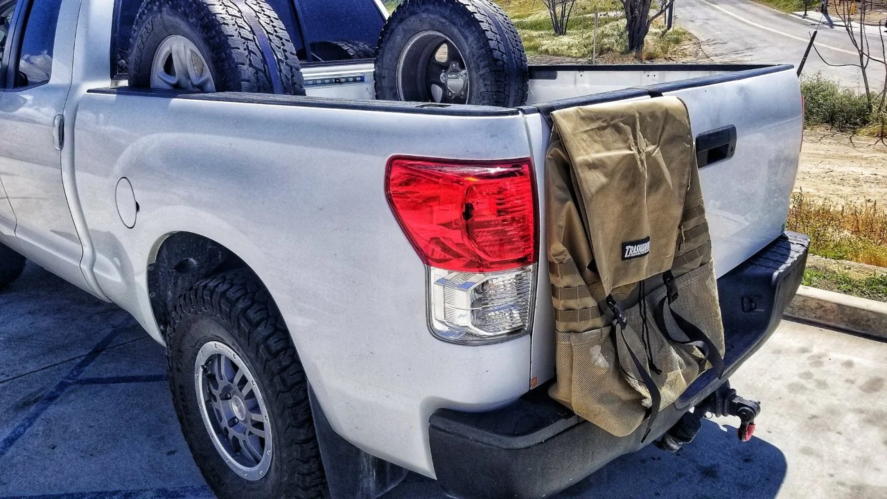

I've never used a spare tire trash bag, but can you hang it over the hatch through the hatch window NEXT TO the tire?

Thats an interesting thought. I used to run a spare tire bag around a tailgate on a prior vehicle, so I think that could work. You mentioned that you don’t use a spare trash bag. Do you have an alternate trash solution?

This is what I was thinking - but using the lower part of the hatch as the "tailgate" essentially:

YES you can! JakeMcCurdy was curious about it and since I have one, as a favor I took it off my spare and tried it on the rear door with the top of the bag straps going through the rear window and just shutting the window on them. Then just cinch up the bottom straps on the inside of the door.

This is exactly what I did when I had a Chevy Colorado. I didn't even think to try this on the GX through the reach hatch, so great idea! I wonder if I'll have issues because of the swing outs...In any case, I'll have to try! Thanks for the recommendation
View attachment 3016837View attachment 3016838
And with that, this thread is up to date! :steer:

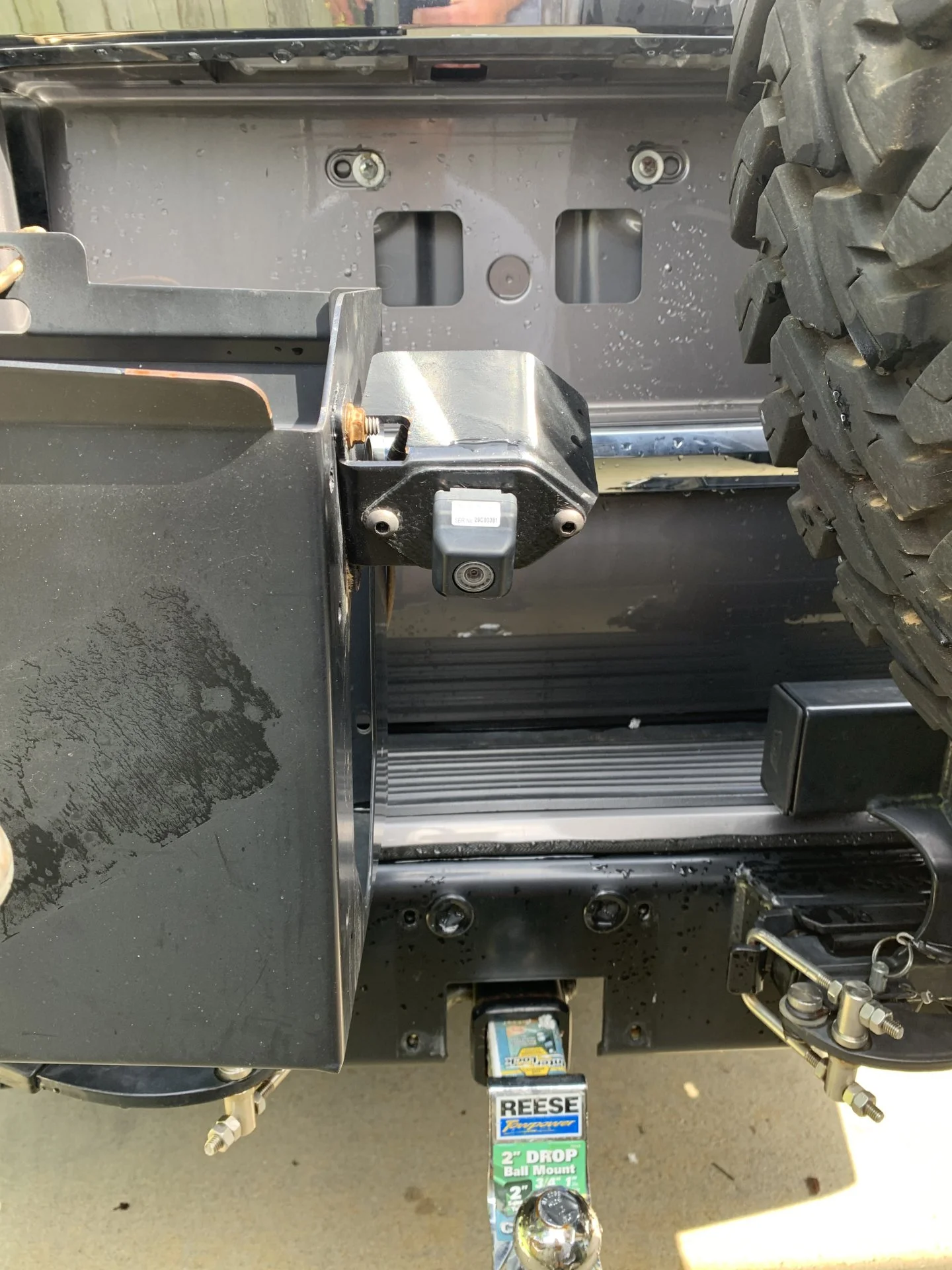

I had a local shop bend me up a bracket that could be attached to the jerry can basket for the camera. I'm sure you could get someone local to do something similar.
