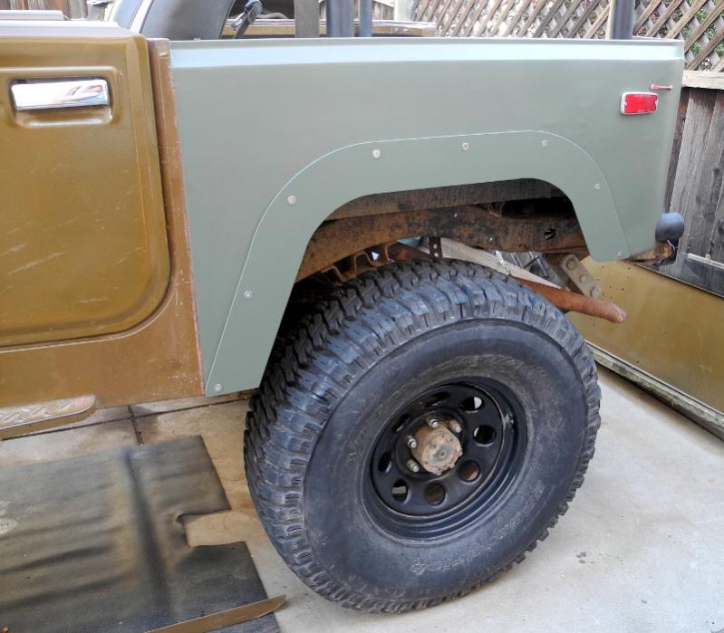

Did some tire/wheel test fitting, 315's, used a spacer to simulate the FJ60 axle. It's close, hoped to run the bushwacker flares (have a new set), but maybe not, especially if the axle is moved back?

the tires would stick out too much

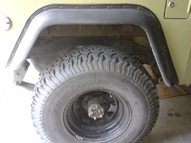

I've got the axle back 2" with bushwacker flares and fj62 axles and it's perfect as far as width.
... especially if the axle is moved back?
The new spring perches allow the option of moving the axle back ~1". This would come in handy with the H55 and split case going in, the drive shaft is going to be short and angled. Anything we can get will be helpful?
Thanks for that, looks encouraging. Agree, the width looks good. From looking at the rig and pix, my concern is more about rearwards flare/quarter opening clearance when fully flexed/compressed. With the 4" springs, when compressed, the axle/tire moves significantly rearwards, going to be close! As of now, the tub is just sitting on the frame, so can't do a flex test, yet, and it sitting higher that it will be mounted, so can't be sure,,, yet.:hillbilly:

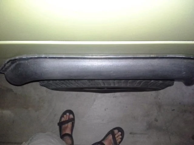

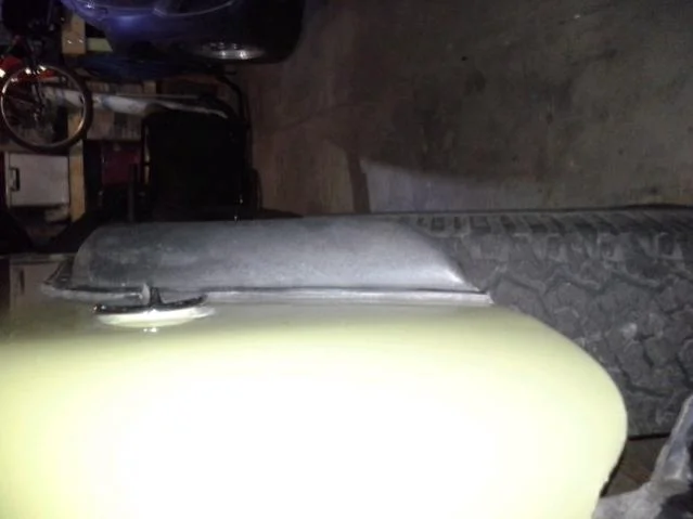

I left the front of the opening uncut and cut everything from the rear of the well opening. Under full compression with 2" aft axle, no rub anywhere. I used a front CV shaft from an '86 FJ60 as I had a bit of vibration at about 65 mph. Now it's perfect.
My rims are standard 15x8 Sunraysias. They do stick out a bit more than my steel 80 series 16" rims did but the backspace is similar.
I plan to go another 1" aft when I put 60 series rear springs in.
Good deal, those look to be mounted significantly more rearward than these.
