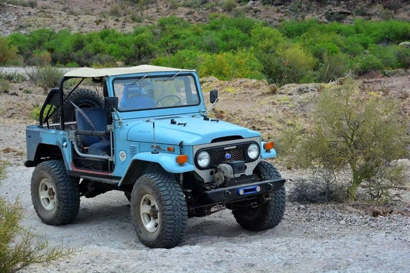

First update for the new forum: It runs, shifts all gears, went gallivanting around the parking lot. :D A "few" things are still needed, like; rear brakes & clutch bled, front drive shaft, skid plate made, not going to sneak up on anyone with the open header, etc.

Claudia, congrats... Your rig looks amazing! It's so inspiring to get the rust out and not have to feel like it needs a $5,000 paint job. I am totally digging the 80 series wheels. Did you go to 60 series axles? I think I remember reading that. I might have to find a set of spacers to run a set of those wheels. You've nailed the perfect stance, without killing on road manors.

... I am totally digging the 80 series wheels. Did you go to 60 series axles? I think I remember reading that. I might have to find a set of spacers to run a set of those wheels. You've nailed the perfect stance, without killing on road manors.
Agree on the '80 wheels, they are ~4.5" back space, for a '40 want somewhere ~3" backspace. It has a wider FJ62 rear axle, that mostly takes care of the rear. Her tires are slightly more rounded (sidewall) than most, so have slightly touched the inner fender well. May or may not do something about it? The front has 1.25" spacers.
IMHO it drives well, has significantly better manners on both the road and trail.
The '80 wheels with 315 tires thing is popular with local rigs. A couple have '60 rear axles, the others have spacers, 1.25" or 1.5":

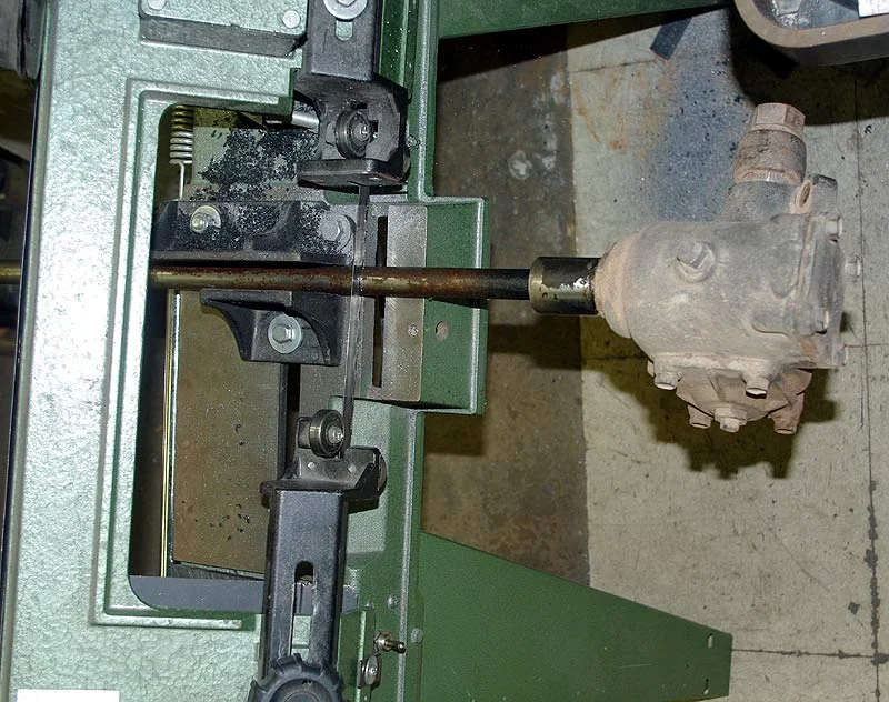

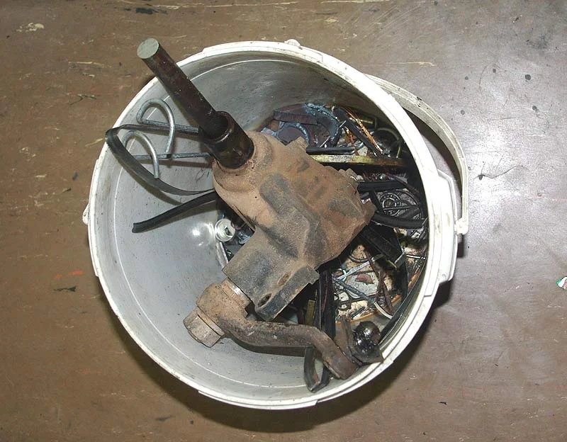

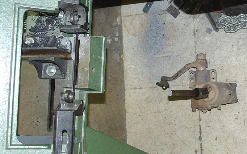

Going to need a column. Claudia prefers the stock turn signal, key in the dash, wheel, etc, so, snatched the polished turd out of the rig and beheaded it. Placed it where it has a chance of being reincarnated as a tuna can, manhole cover or something usefull! :hillbilly:
View attachment 794469View attachment 794470View attachment 794471
