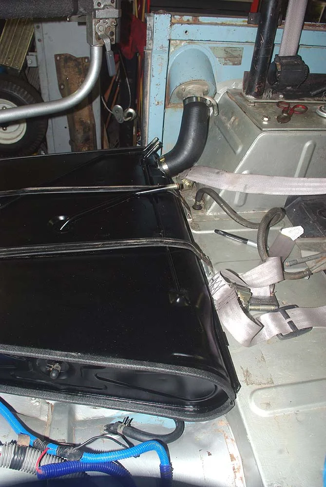

The stock filler elbow was too short. The neck measures ~2-1/8", best we could find was 2-1/4".
With that solved, snatched it out and gave it a full spray bomb.
The main vent line is 14mm at the tank, 12mm at the neck, used 9/16" fuel hose, worked.
All of the small vents on the tank are 8mm, some on the vapor separator are 10mm, so used 5/16" or 3/8" as needed, worked.
May make a cover, or not.
I am having some trouble using this exact CCOT tank on my early 1967 FJ40. Since my truck has an SBC 350 engine, I am not certain if those three "vent tube" near the filler neck are supposed to be capped off? or Vented somehow? Currently, the filler neck just fills up with fuel, and barely trickles into the tank. Any idea what I should do with those three vent tubes? Block off, or route out the cab with check valves? Thanks!!
