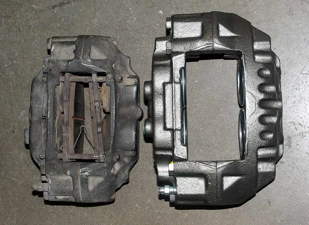

Haven't kept this up to date, so here is a bit.:redface: Have done a ton of fiddly stuff, one was the brakes. They worked but had some tuning issues that we didn't like, the rears locked first and the pedal was short and solid.
Swapped the FJ62 calipers (43mm and 34mm piston) out to a pair of 4Runner calipers (all four pistons 45mm). This increased the hydraulic leverage, made the pedal throw longer, easier to modulate, and overall more powerful for the same pedal effort. The effect is bias to the front, so solved the rears locking first thing.
Had to trim the backing plates slightly, other than that, bolt on.

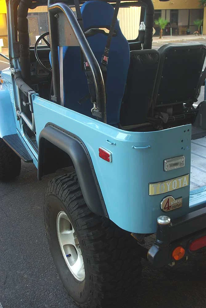

Slobbered paint on the rear of the tub. Good thing our paint guy has patience, took some doing to make it close!:hillbilly:
The new emblems and backup light (yes, it's wired, works) that will soon be unceremoniously covered by the spare tire!:hillbilly:
At this point, the tail gate was not cooperating, didn't like paint, finding the correct hardware, etc.

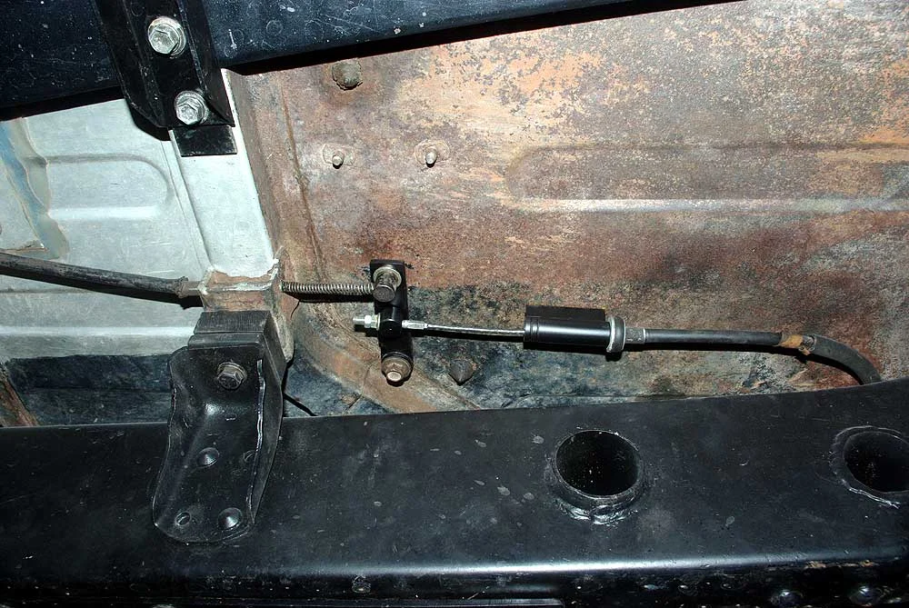

When using the dash e-brake handle with the FJ62 brakes there are a couple of challenges. The two cables don't cleanly couple and the travel/leverage is off. So, made this lever/bellcrank, it reduces the travel by half and increases the leverage by double.

Hmmm..., I wonder if these would fit under stock steel wheels? Good idea and execution in any event.
:cool: thanks for posting the pics
are you missing the truck yet ? :flipoff2:

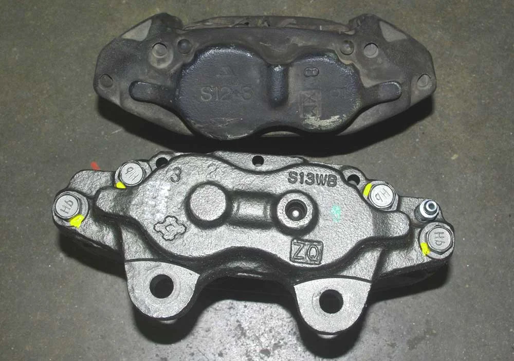

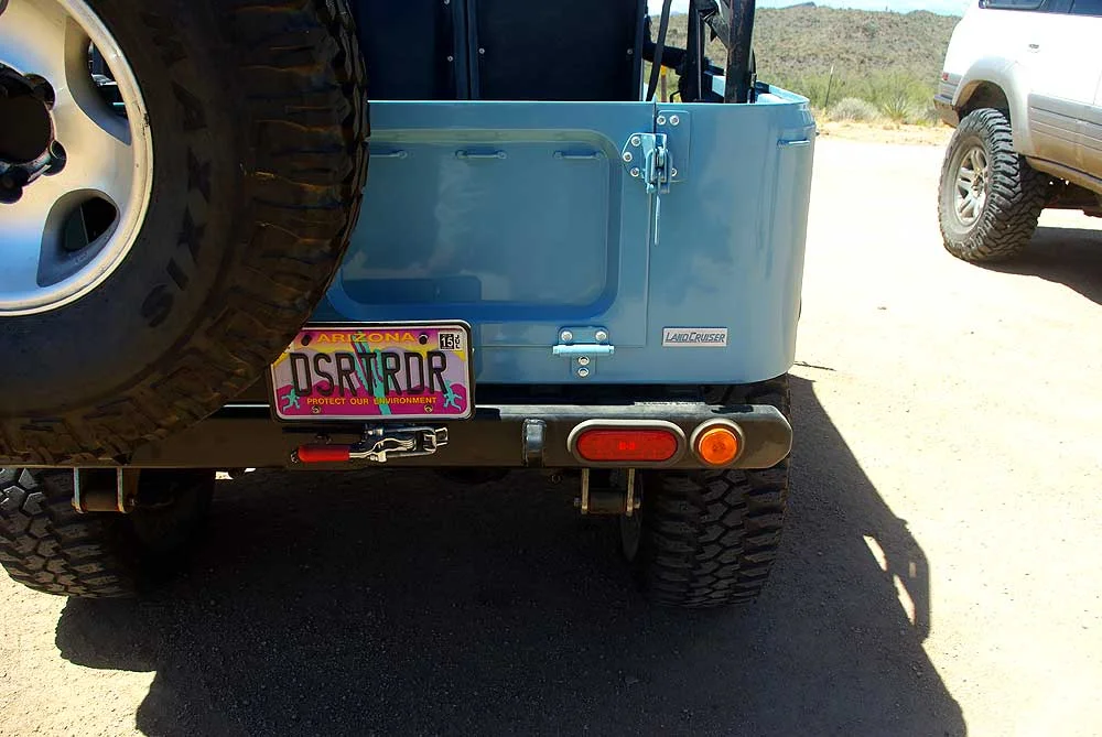

Not likely, they are big. Another option is the S12W, 4 X 43mm pistons, closer to the S12+8 in size.
