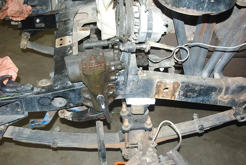

After some distractions, did get some stuff done!:hillbilly:

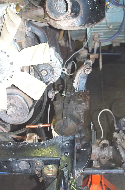

I tossed a wrench in the works.:o Have done a few '60 box conversions, kinda have that one down. Had the '60 box mostly fitted, but grabbed an '80 box set it on, it fit. Spent some time figuring why it wouldn't work, it's larger, will require moving the radiator more, doesn't matter, we are moving it and making a custom shroud anyway, the 3FE vane type pump should drive it, etc. So, back in uncharted territory.
The '80 box has a few advantages: Has a "preload assist mechanism" reducing play at the center of travel, helps for the high speed stuff. Has a larger piston, so has more boost, should help with the 35" tires and locked. The pitman arm is flatter for more spring to draglink clearance. Is overall a larger, more robust box.
The setup is cut/clearanced for ether, so if the '80 box doesn't workout, can swap back to the '60 box. Don't see that happening?

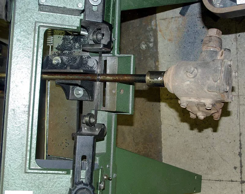

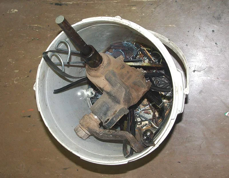

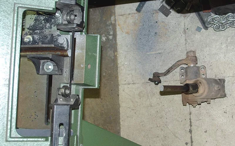

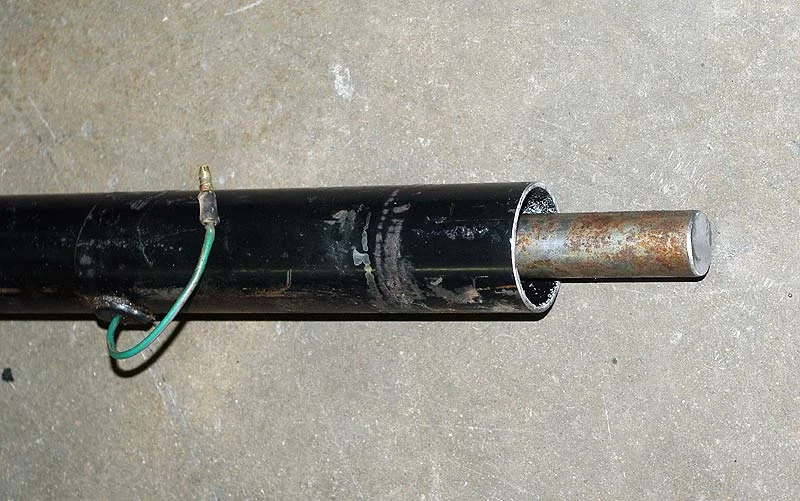

Going to need a column. Claudia prefers the stock turn signal, key in the dash, wheel, etc, so, snatched the polished turd out of the rig and beheaded it. Placed it where it has a chance of being reincarnated as a tuna can, manhole cover or something usefull! :hillbilly:

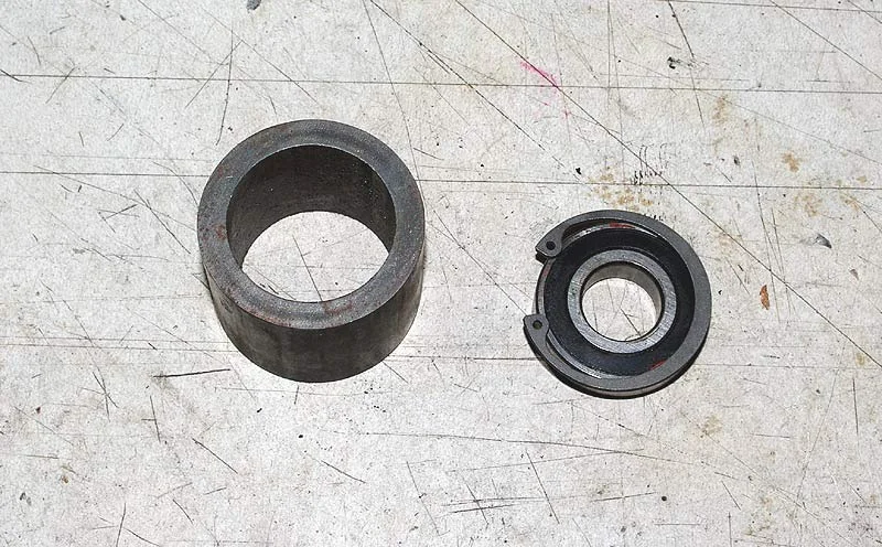

Cut the column cover tube to length. It has a bushing at the top, but no real support, that was provided by the steering box.

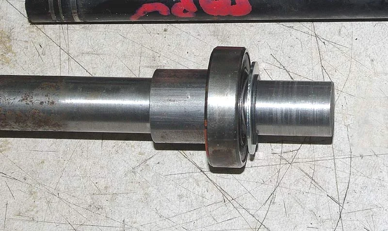

In this hunk of tube is a bearing holder, was liberated by the lathe.

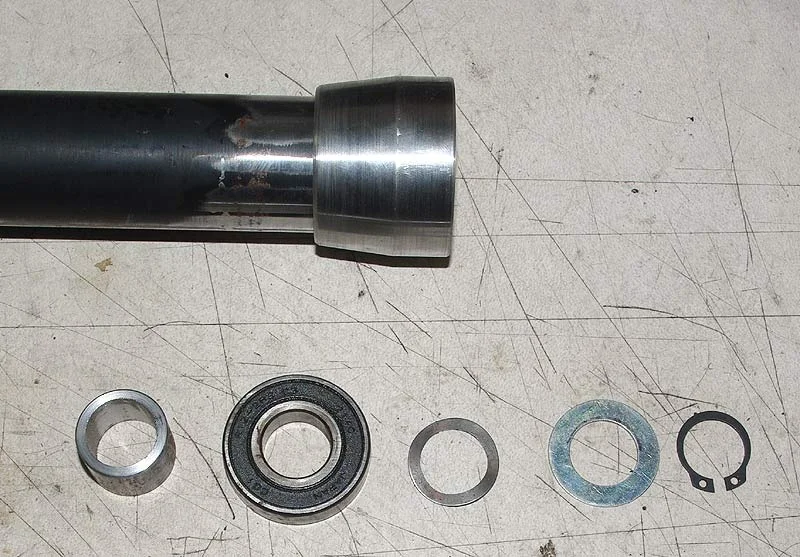

The stackup that goes over the shaft, a collar that gets welded on, the bearing, belleville and normal washers, all held in place by a snap ring.
