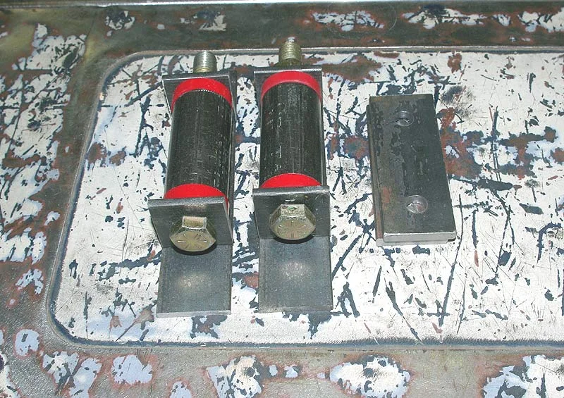

JJ started on the roll cage to frame support leg brackets.:cool:
looking very nice Kevin!!
How many sets of hooks did you make? I'm in for one set.
Can do, they are custom, so how many holes/sins do you need to cover?

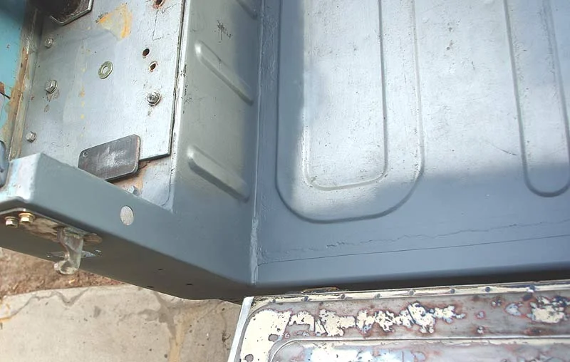

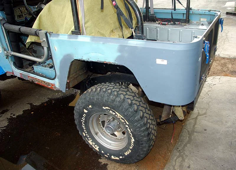

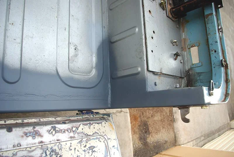

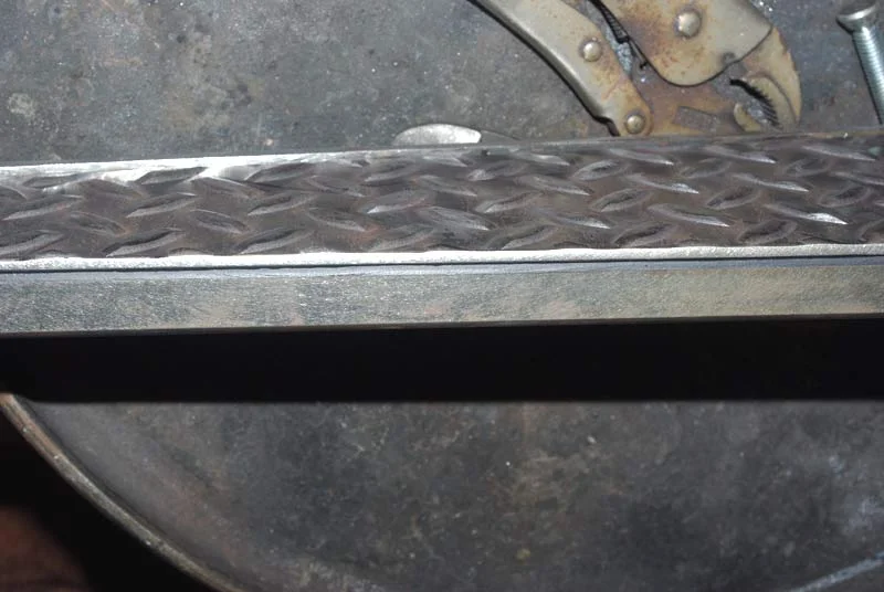

Taped the steps, applied a couple of coats of seam sealer, to reduce the shadow line and seal the gap.
the steps look much better in person :cheers:

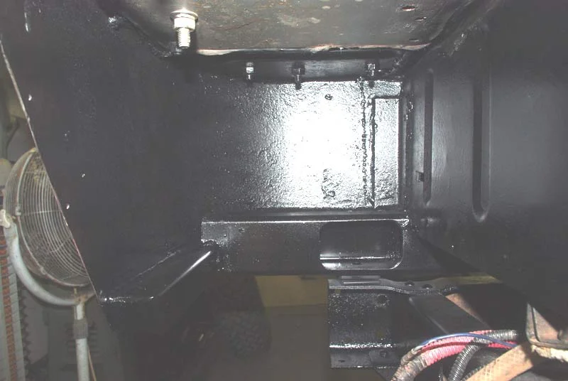

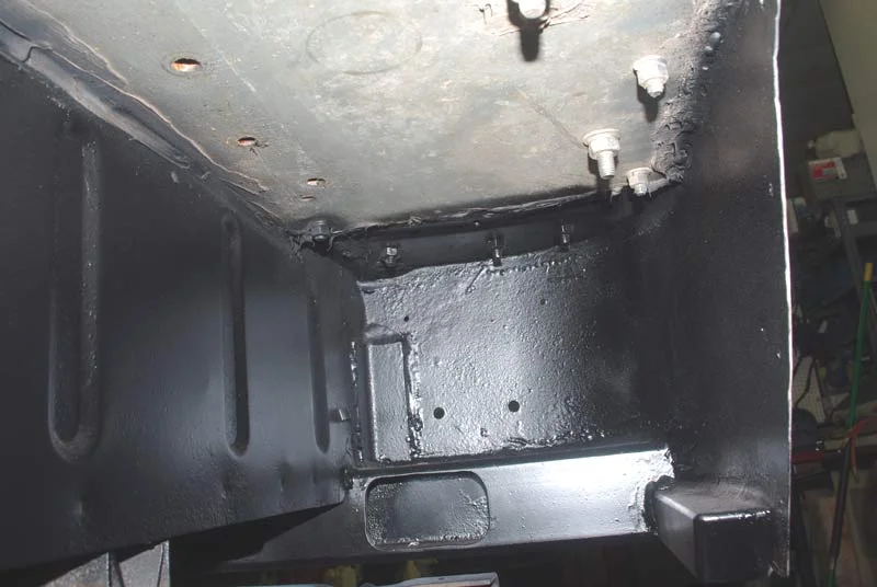

The inside of the quarters were, cleaned, sanded/wire brushed/treated the rust, seam sealer on all gaps and over welds, a light coat of rubberised undercoat, then paint. Messy job, likely not perfect, but looks and should last much better than how it was?

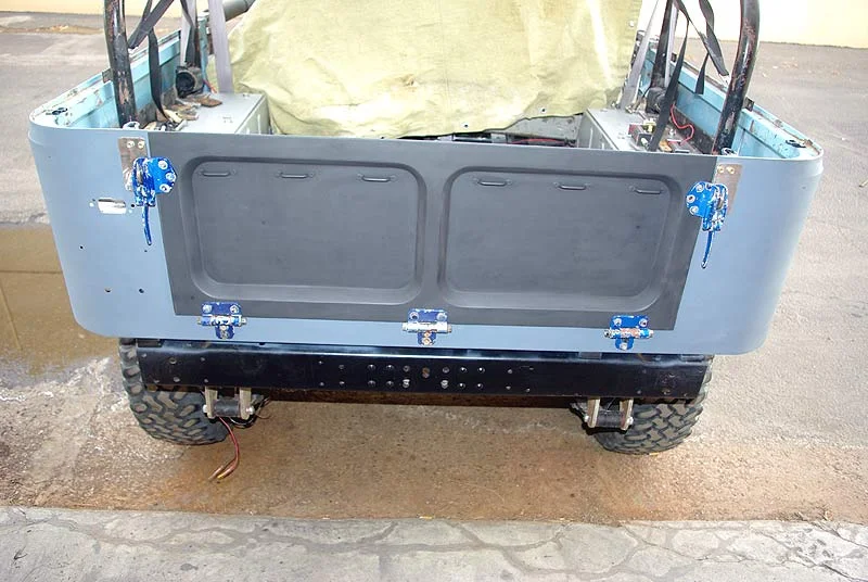

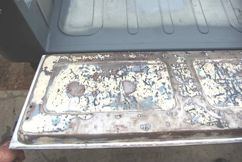

More seam sealer on the tailgate and all of the welded areas of the tub. Still need to primer the inside of the tailgate, it is reported to be getting carpet, not sure how much will be covered?
