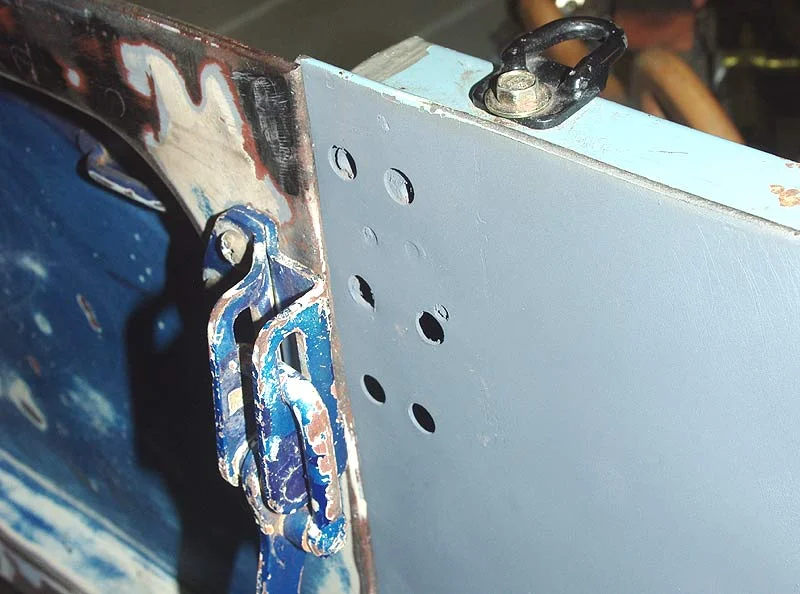

Started working on fitting the tailgate. Got it tweaked back to somewhat straight, fitting well. There are a bunch of big holes drilled where the latch hooks need to go, none of them are in the right place for the stock hooks, so more would need to be drilled.

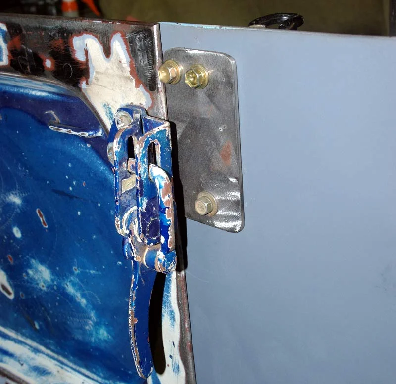

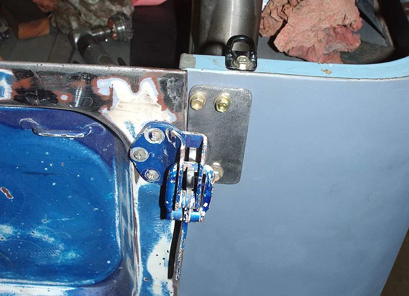

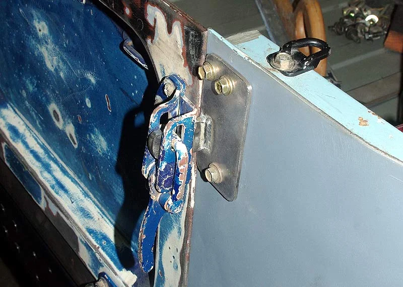

Talked about cutting even more metal out, but it's not in the easiest spot, so decided to make new hooks. Made the new hook bases large enough to cover the holes.
Works great, pulls in tight, no rattle.

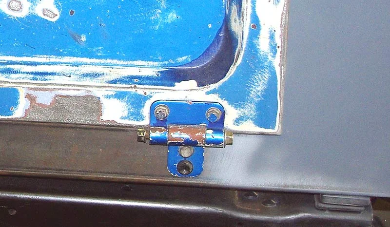

Using bolts as hinge pins, are replacement hinge pins available?
