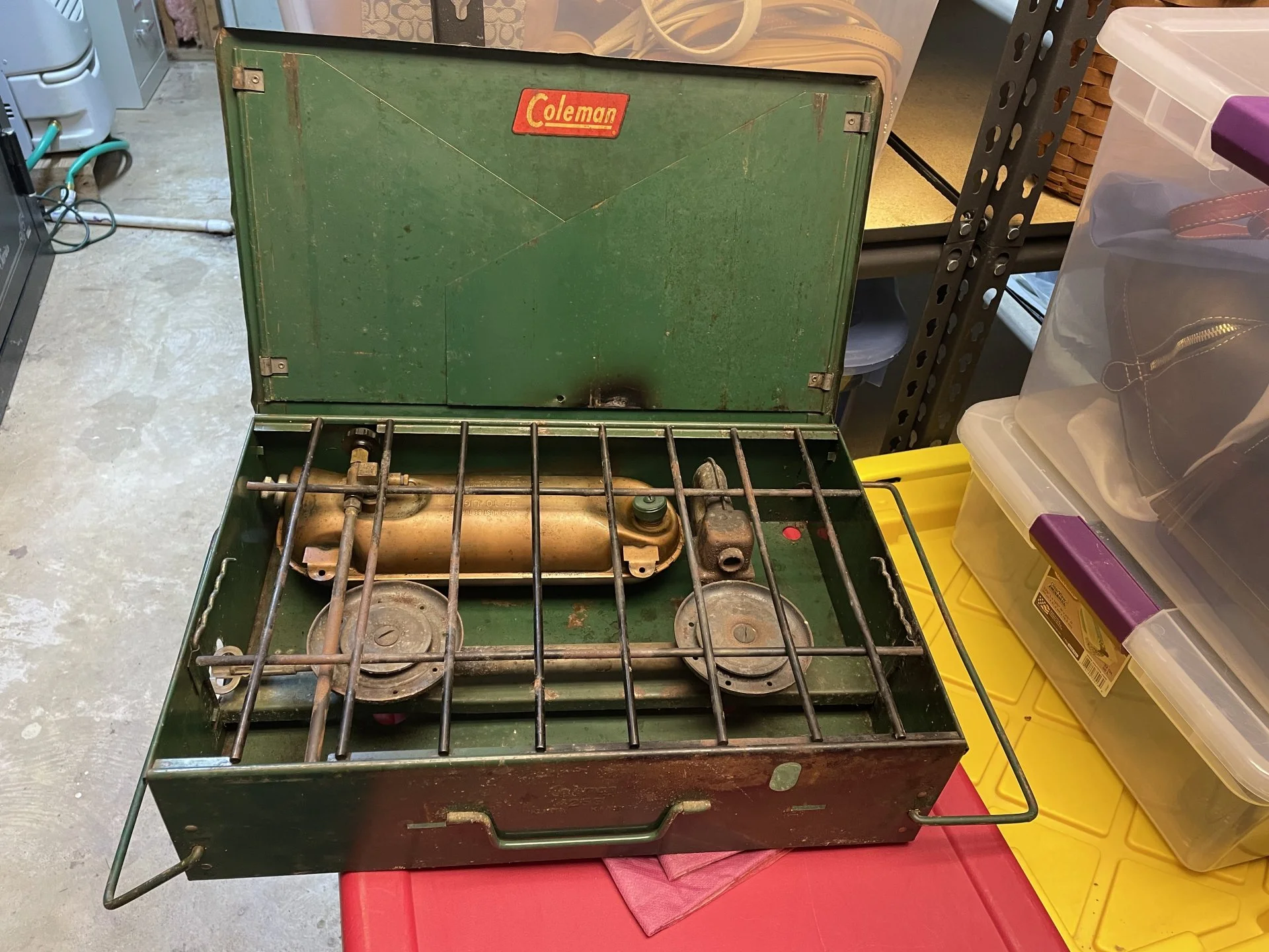

Another $10 and I think I have rounded out my collection.
Needed nothing but started right up.

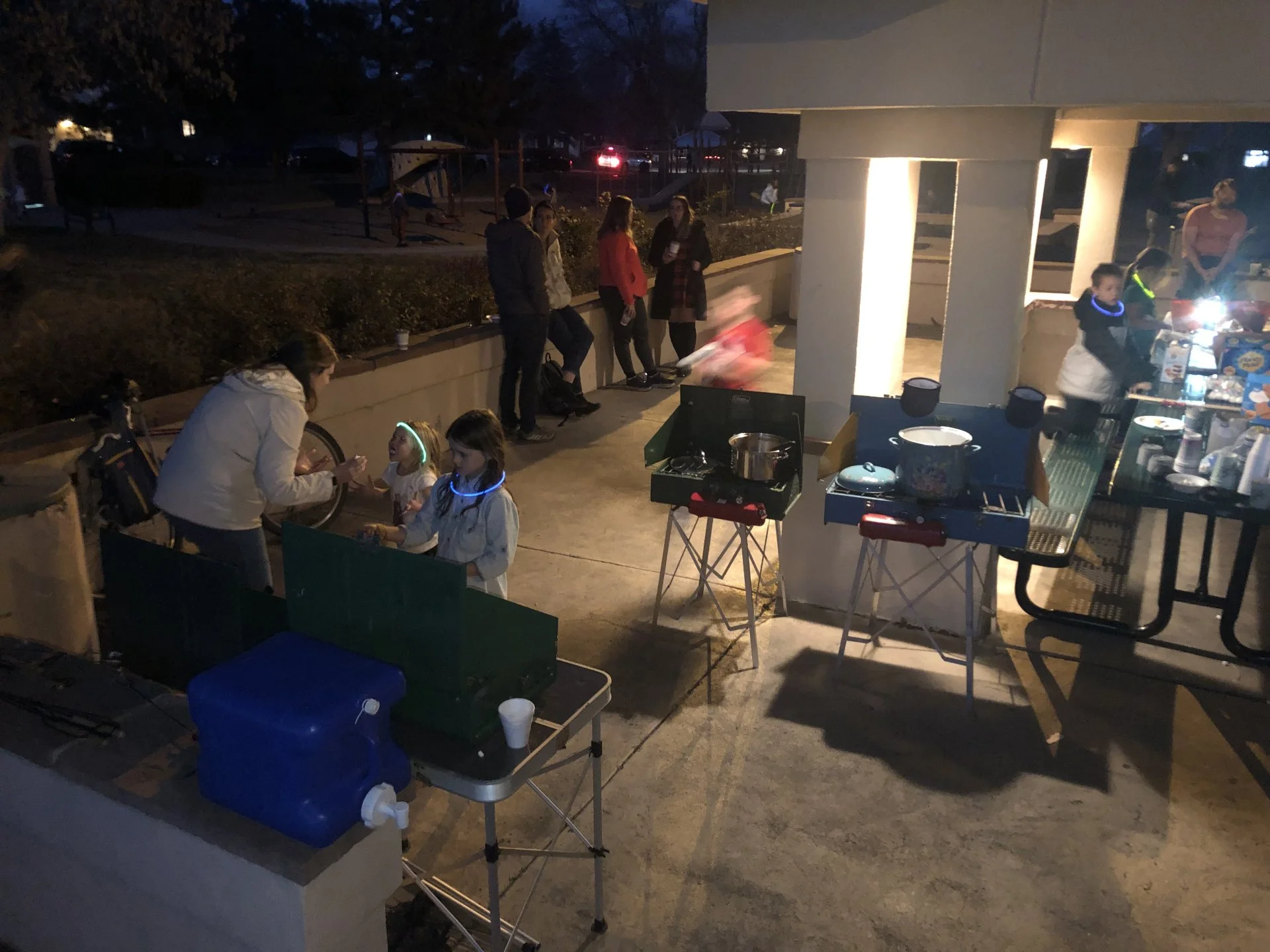

If you’re going to be a hoarder you may as well put them to good use. We had a four-stove affair at the park tonight. @Cruiserdrew there’s your Sears right there.

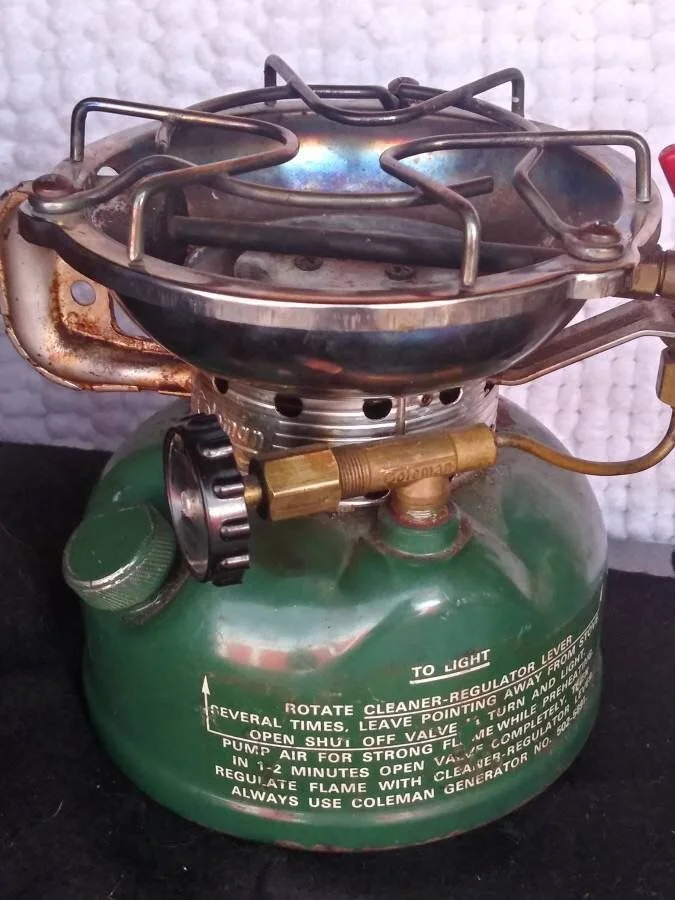

Picked up some items from an acquaintance that recently passed away. 8 lanterns & 1 Coleman 500 single burner stove. As best I can tell this particul stove was made in 1946 ish. Should have taken some more before pictures, but I really did not think I could get it fired up much less to run good.
EDIT: After further review, it has a date stamp of B - 53. So either Feb1953 or 2nd quarter of 1953.
Basically did a complete tear down, soaked things in vinegar . Did not buy any parts & while it runs good, it pulses just a little. I was able to clean up the generator & reuse it…it is damaged tho & I may need to get a new generator.
Again, should have taken more pictures but here you go. The 500’s are great little single burners.
