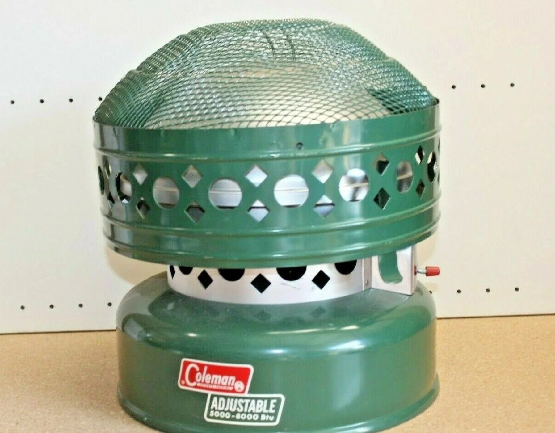

Anyone have experience with these old Coleman heaters? Thinking about picking one up that looks to be in serviceable shape....I know nothing about them...other than I don’t have one.
Or, you can go Frankenstein with one of them…if you suddenly find yourself over run with Coleman Stuff…
I've had one. They're pretty cool. I think I only fired it up in the garage a couple.times.... got it from a friend, never really devised a use for it though...

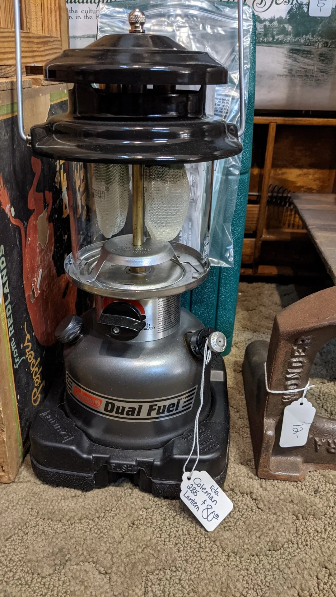

$80.00?!?!?!? Holy cow, that's ridiculous. I dont even want to know how much they wanted for the other appliances. The most I've ever payed for a lantern is $25, and that's only if it's a real nice one.
Yeah, the $80 was at an antique store, the stoves were in a thrift store, $25 maybe?

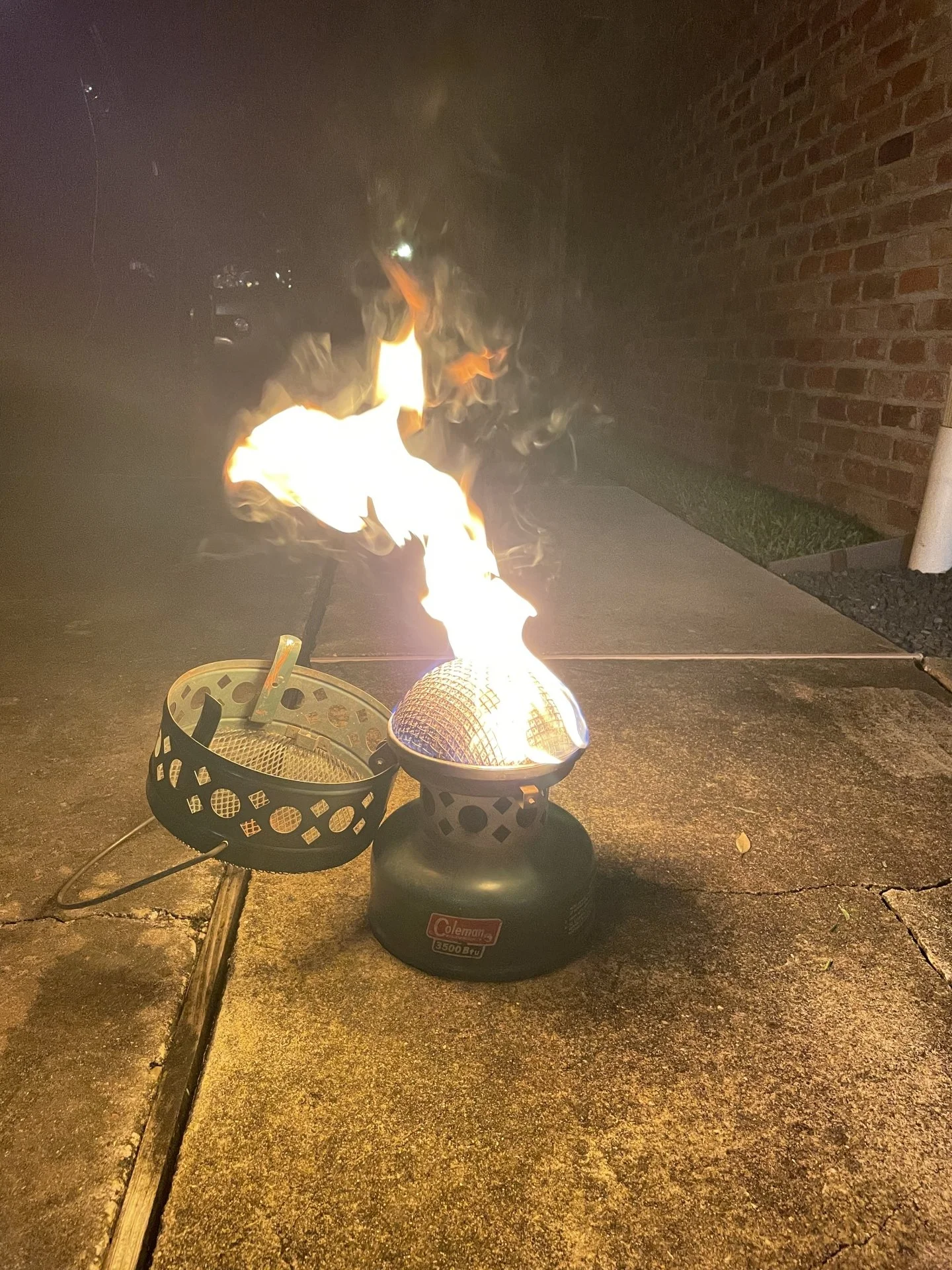

Initial firing after coating and rebuild.
Getting ready to visit Dinosaur National Monument, and then presenting to Uncle!
Is that vent painted? It may not hold up unless you used very high temp paint. There is a place that will actually use porcelain(like from the factory)if you ever want to go that route.
