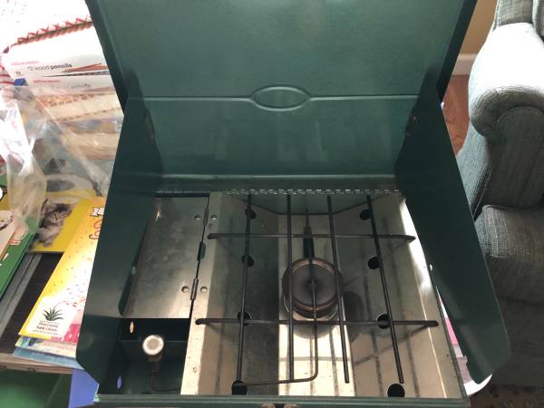

Here's another one that looks like it could be had cheap and cleaned up. What do yall think?
Will sell individually, wonder if he will ship? Looks to be about $20+ shipping.
anybody know about these stoves? something to pick up or give it a pass?
Pass. The Coleman ones used a proprietary canister that is NLA. Don't know about this one. Coleman and other liquid fueled appliances are so frickin' cool why do anything else?

thanks Prairie Swamp, I was thinking it'd use the same canisters as these little guys which I love.
