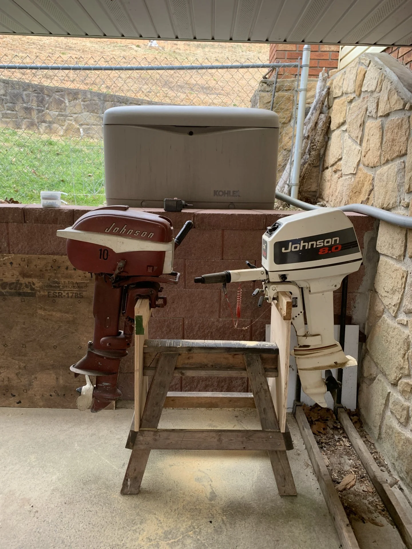

These came from my wife’s late father’s garage I never thought much of his camping stuff until recently as we got two Coleman stoves (posted earlier) this trip was for a 1956 Creastliner v bottom boat and two motors. We just happened to grab the lamps. There are two more lanterns there I will grab next trip both red one with a broken globe, not sure the models.
Small Johnsons.....not that there's anything wrong with that...:rimshot:

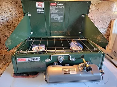

I took the plunge and graduated from a single burner Coleman 502-700 Sportster to a Coleman 414 PowerHouse Dual Burner stove.
I also got the Mr Heater propane adapter for it.
I must say the flame using the liquid fuel is impressive, the flame via propane a little less so but certainly adequate.
The first trip will be in couple of months.
So: what spare parts for the stove do I want NOW?
Liquid fuel:
1 lb. propane bottle:
@FrazzledHunter Unless you actually damage a part of your new stove you shouldn’t really need to carry around parts. These items don’t really ‘wear out’. The most likely thing they will need from time to time is a cleaning of the generator and or the fuel pick up tube. Both are pretty straightforward when needed.
You have a nice looking stove.

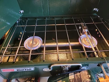

Thanks for the reply. Understood. The only thing I ever had to replace was the plunger on my old 1970's 502 LOL.
I found the flame output on this thing surprising. I ran it full for a few minutes to test it however, the photo shows both burners running lower.
Running full, I was afraid I'd set off the house smoke alarm even though it was running under the exhaust fan on high!
Coleman is the only manufacturer of these liquid stoves; pretty much everything else is propane at least for the larger stoves. So I have a fear that Coleman will one day quit making these stoves and parts will become very scarce.
Roger on the generator cleaning, I'm familiar with that process.
And one other thing that I forgot. The pump up cup. Older ones are leather and they can be easily rehabed with a small amount of oil.
What John said. They last a very long time with occasional cleaning.

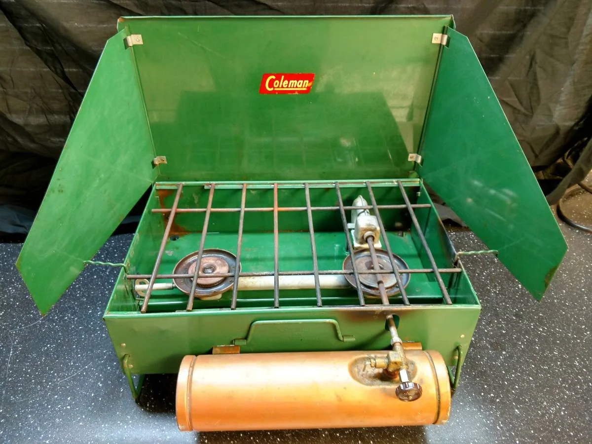

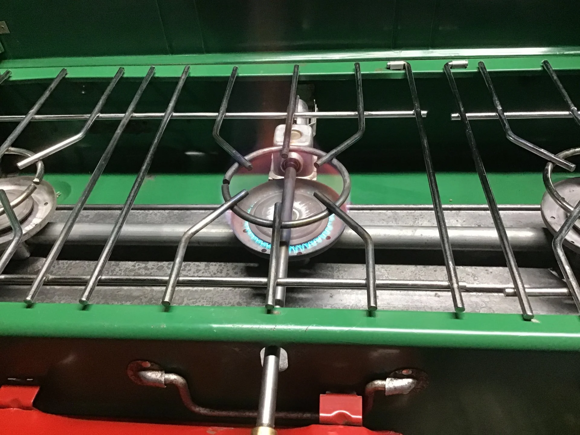

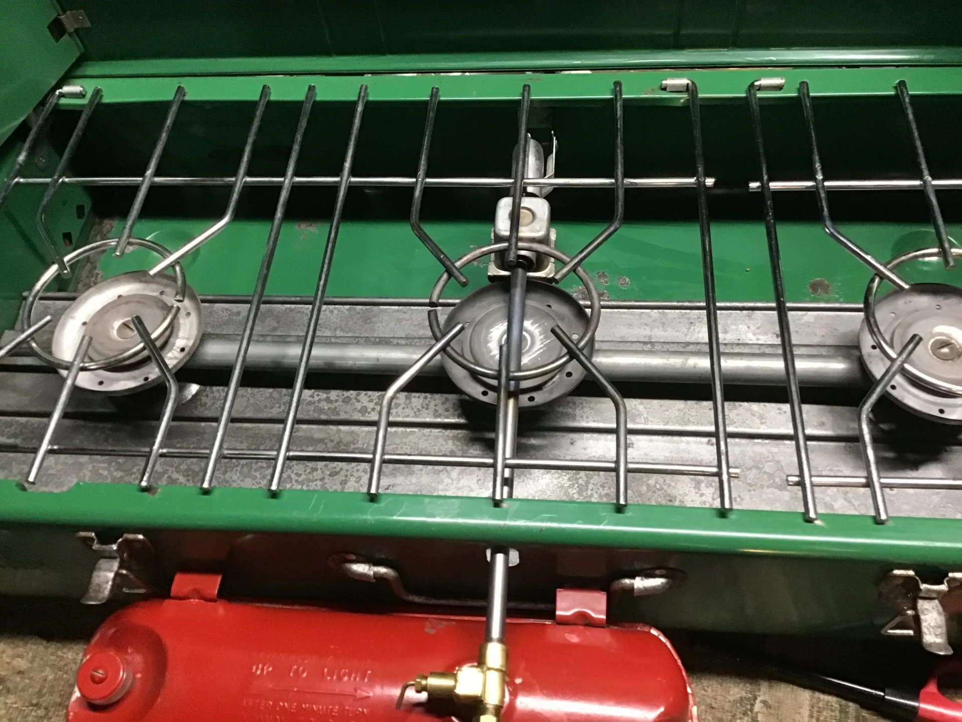

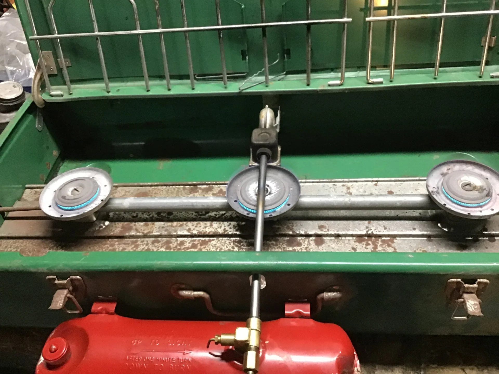

Here’s my project for today. Picked up this 426D dated 3/‘70 for $10 last weekend. Rough shape all around and the fuel tank was really bad inside. Cleaned the generator and fuel pick up tube, runs much better.
A bit of TLC, Naval Jelly, vinegar and some Acetone for the fuel tank & it looks much better & runs great. Not a garage queen but at least the rust is gone & it’s not grungy.
Before TLC
After TLC
And after TLC
Before TLC
