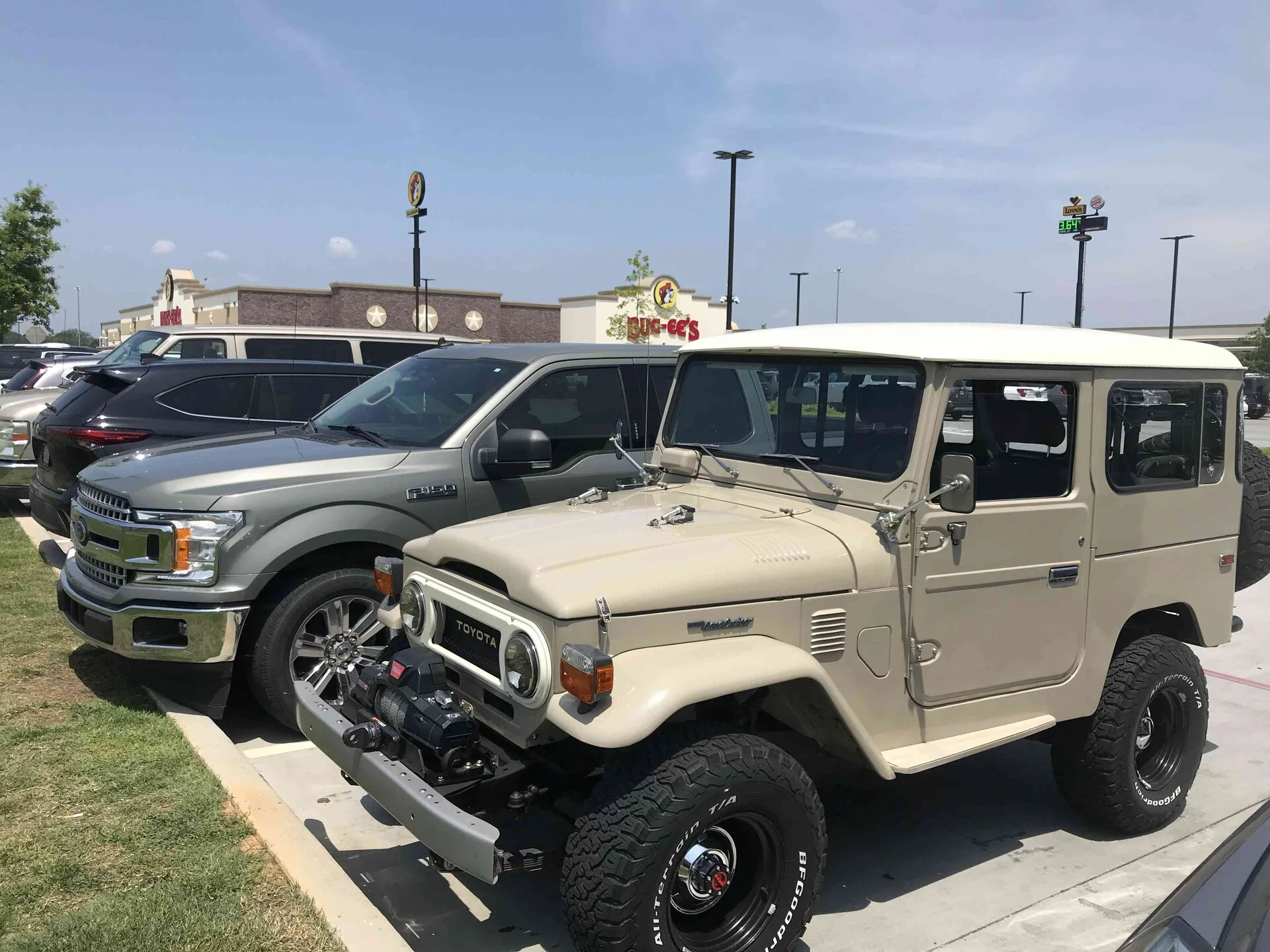

Still cant get over how wide your wheels are - looks incredible.

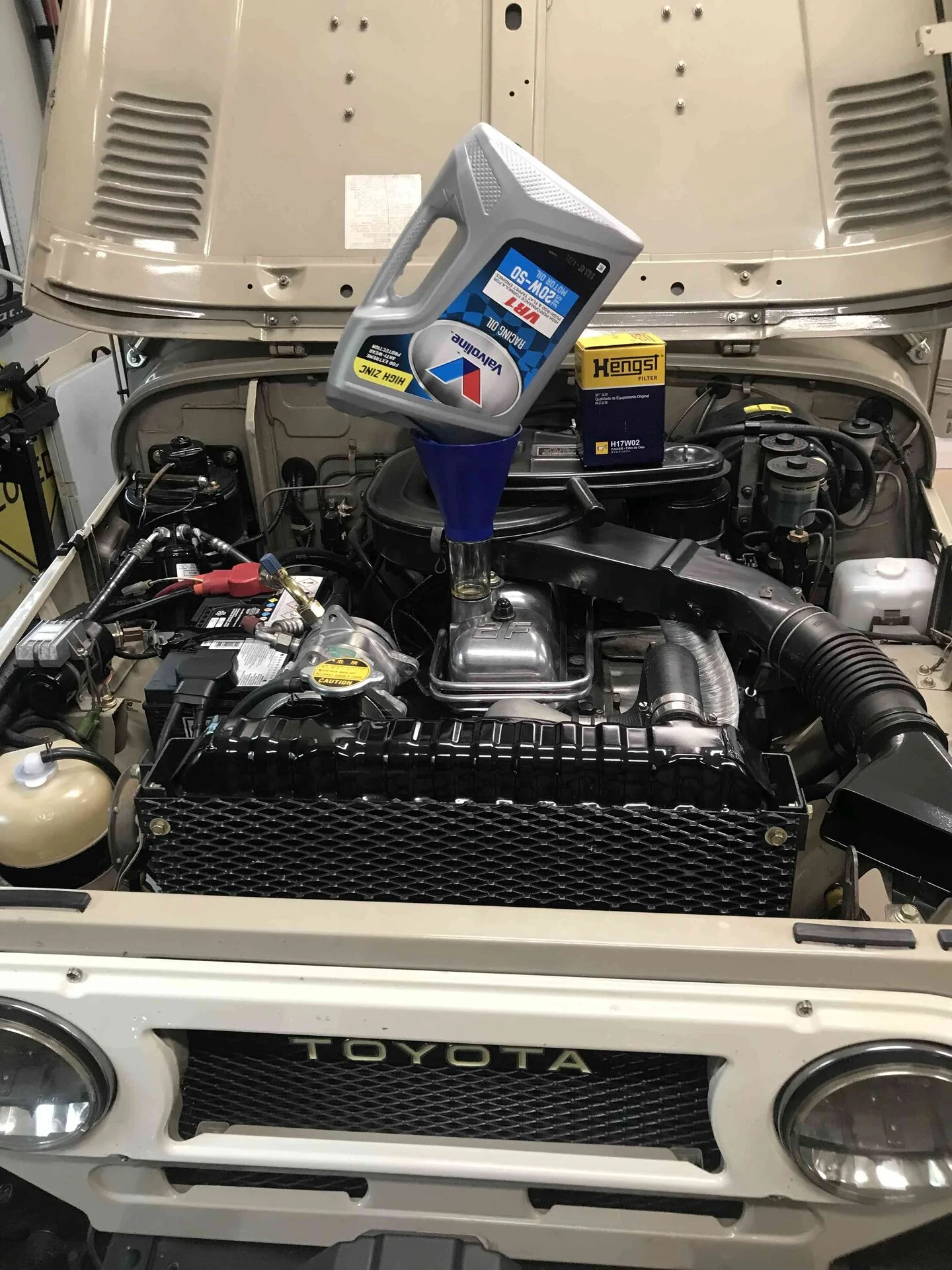

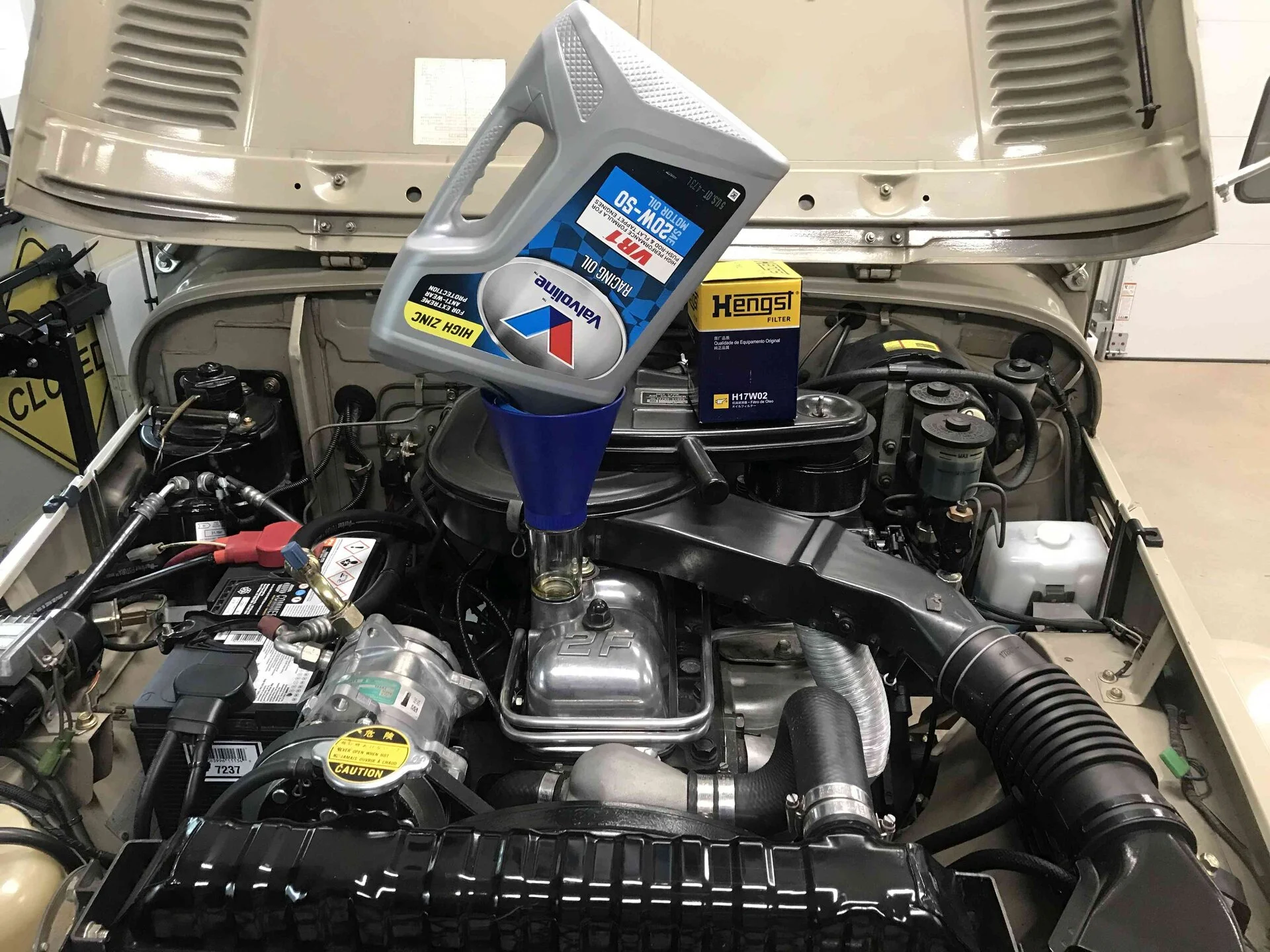

Time for an oil change & wash.

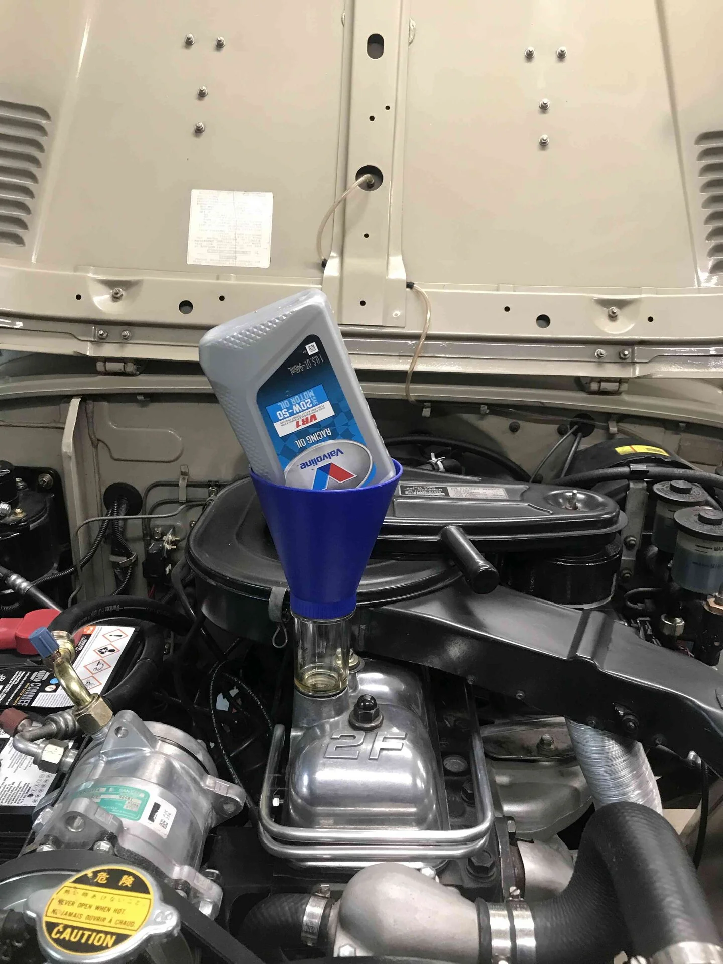

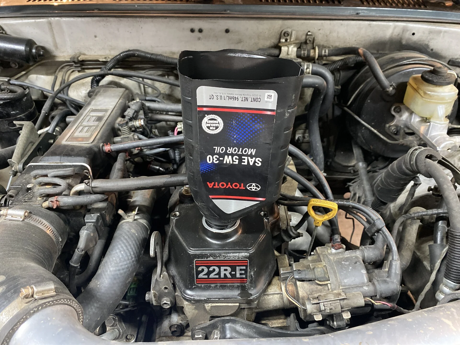

Why the Hengst? Eh, no particular reason, just switching it up a bit. However, the 'Locking Oil Funnel' is nice and worth the price.
Checked the spark plugs, and they looked good....Drive on, I will.
Those wheels. That stance. Just brilliant @GA Architect …. We need to do a local meet up soon.
Here’s a picture of what I was talking about. I don’t buy that Toyota oil is some special concoction formulated specifically for our engines, but I usually just pick it up while I get a new filter as it’s just as cheap as the parts store. I figured out by accident those bottles thread into the valve cover. So I made one into a dedicated funnel and have had it for years.
Anyways, I’ll quit mucking up your thread good stuff as always Rick!

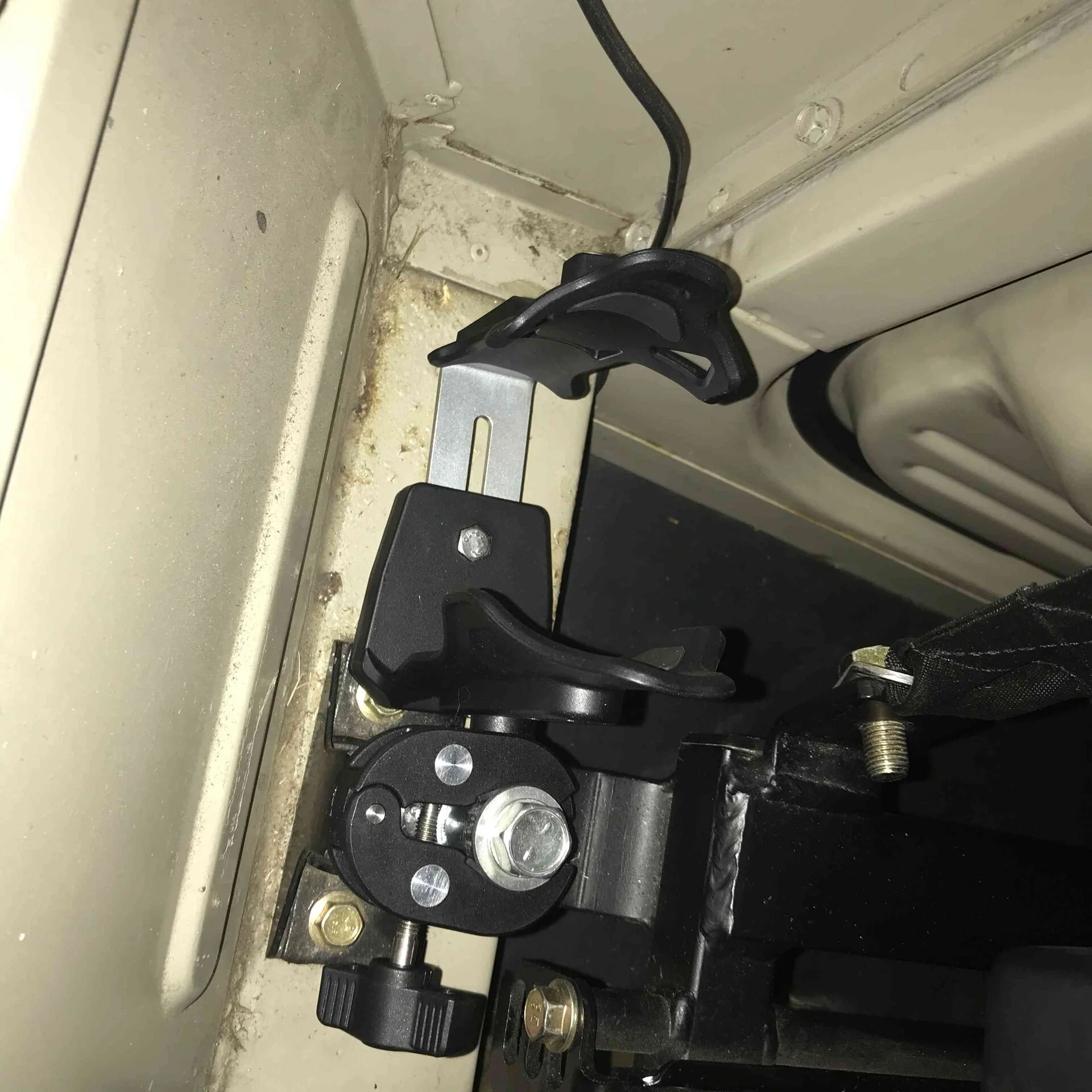

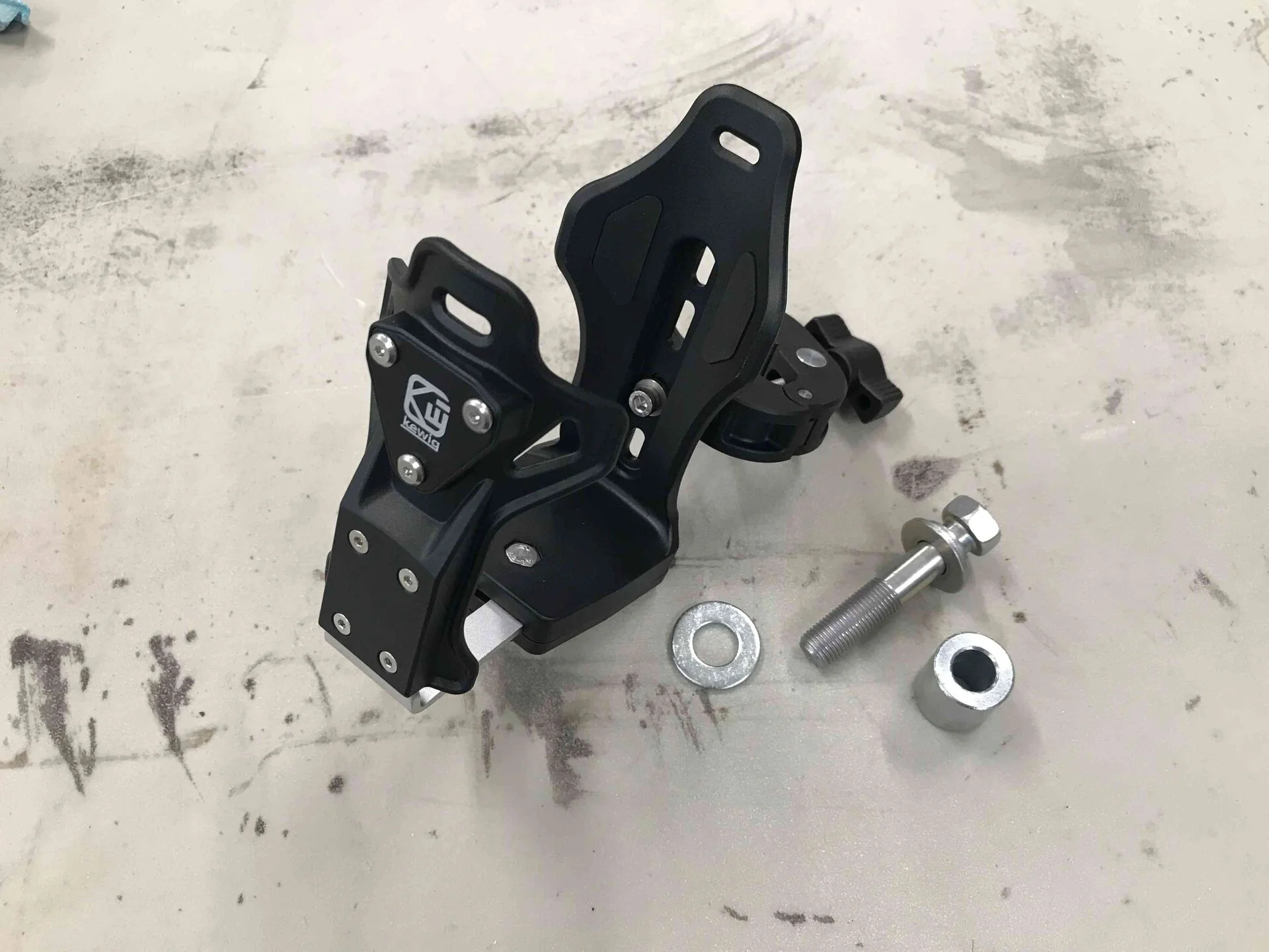

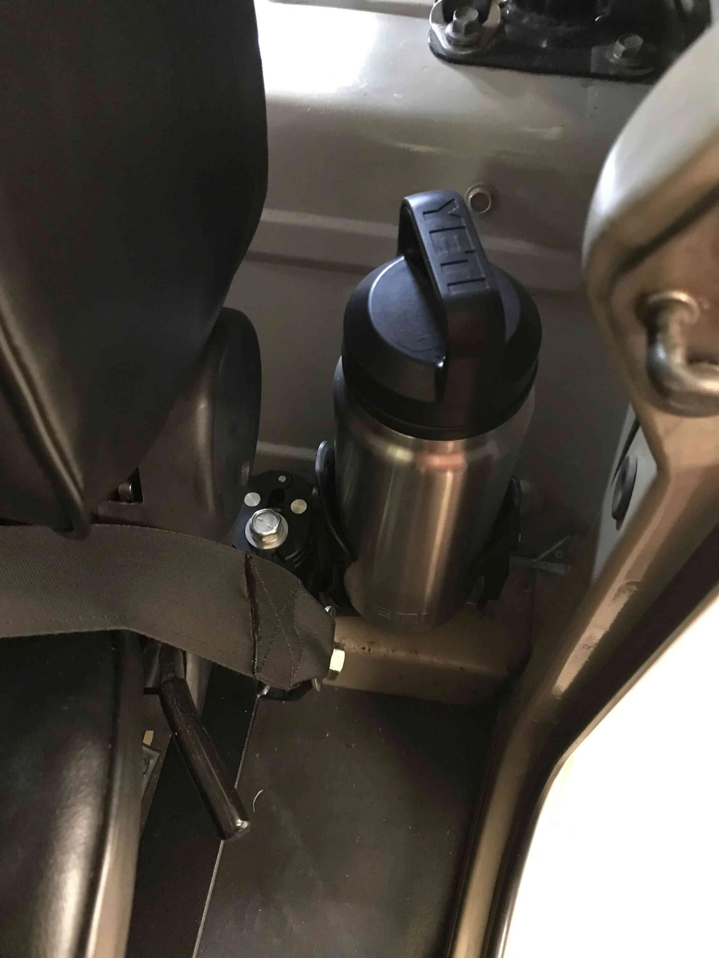

A possible new cup/bottle holder & location. I just started playing pickleball and picked up a new larger water bottle to take to the court. Being my rig has several cup holders, it really didn't have a bottle holder, per se. That got me searching for bottle holders on the interweebs....and I found this adjustable clamp-on one for use on a scooter's handlebar.
Amazon product ASIN B0C616LYQX
First thought was to clamp it onto my seat post some how, but they use square tubing and or irregular shapes. Being I have a void between the driver's rear seat frame bolt and the side wall, why not figure a way to put it here....so this is what I came up with:
Note, the M12x1.25 bolt is actually a Toyota 91659-61260 (90080-11425) part --- steel spacer is from ACE and is a 7/16 x 7/8 x 1.5" unit cut down to 1" in length --- and the additional thick washer is from ACE.
NOTE:
If for any reason this is deemed unsafe, please let me know and I will come up with a different attachment using 1.5" x 1/8" flat bar as a oblong washer with a solid 1"x1" round bar welded for the attachment.
