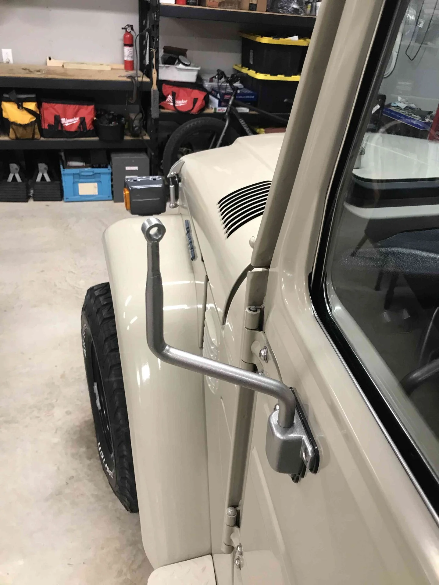

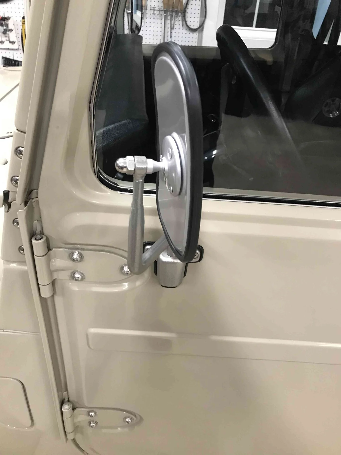

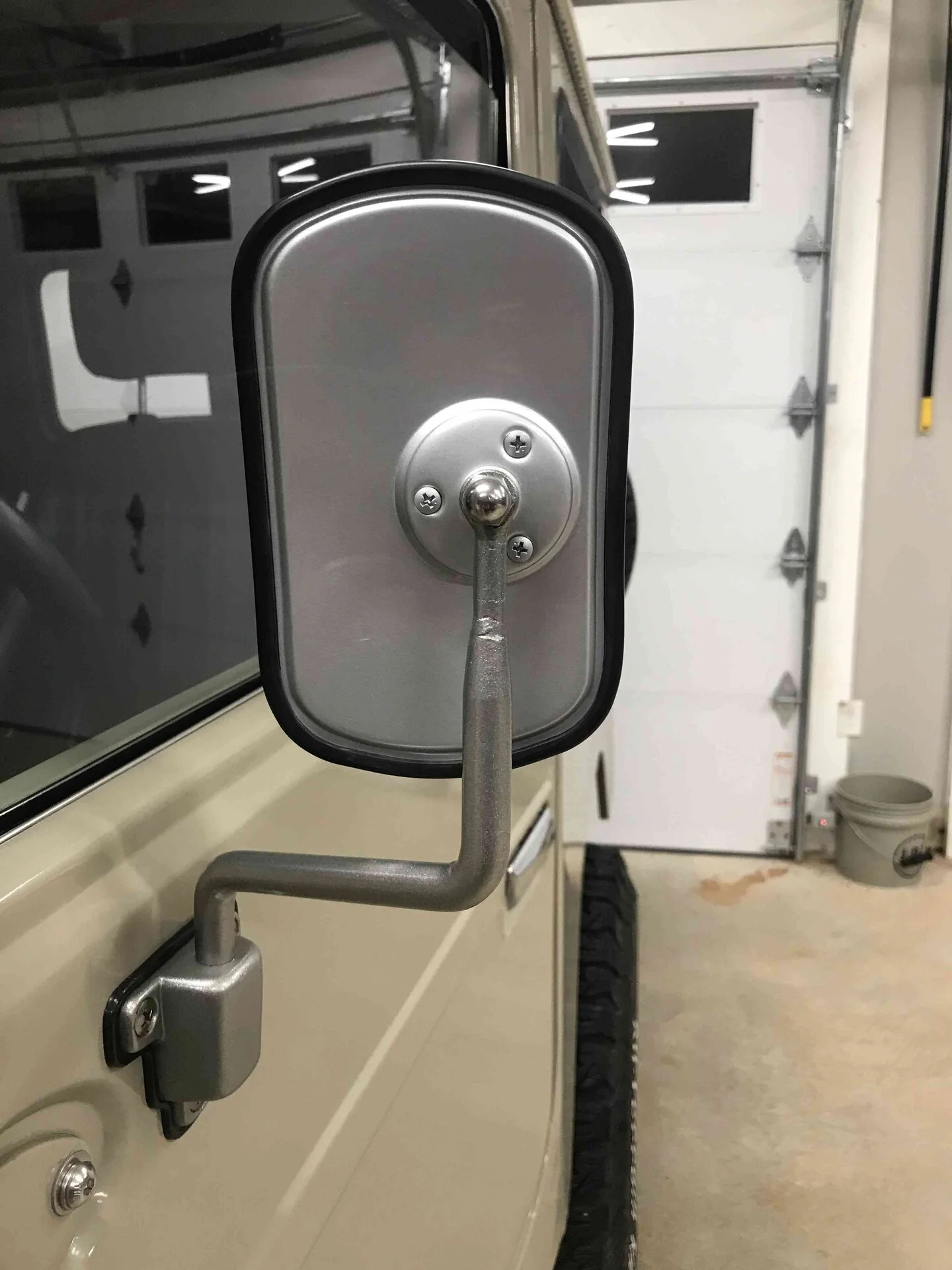

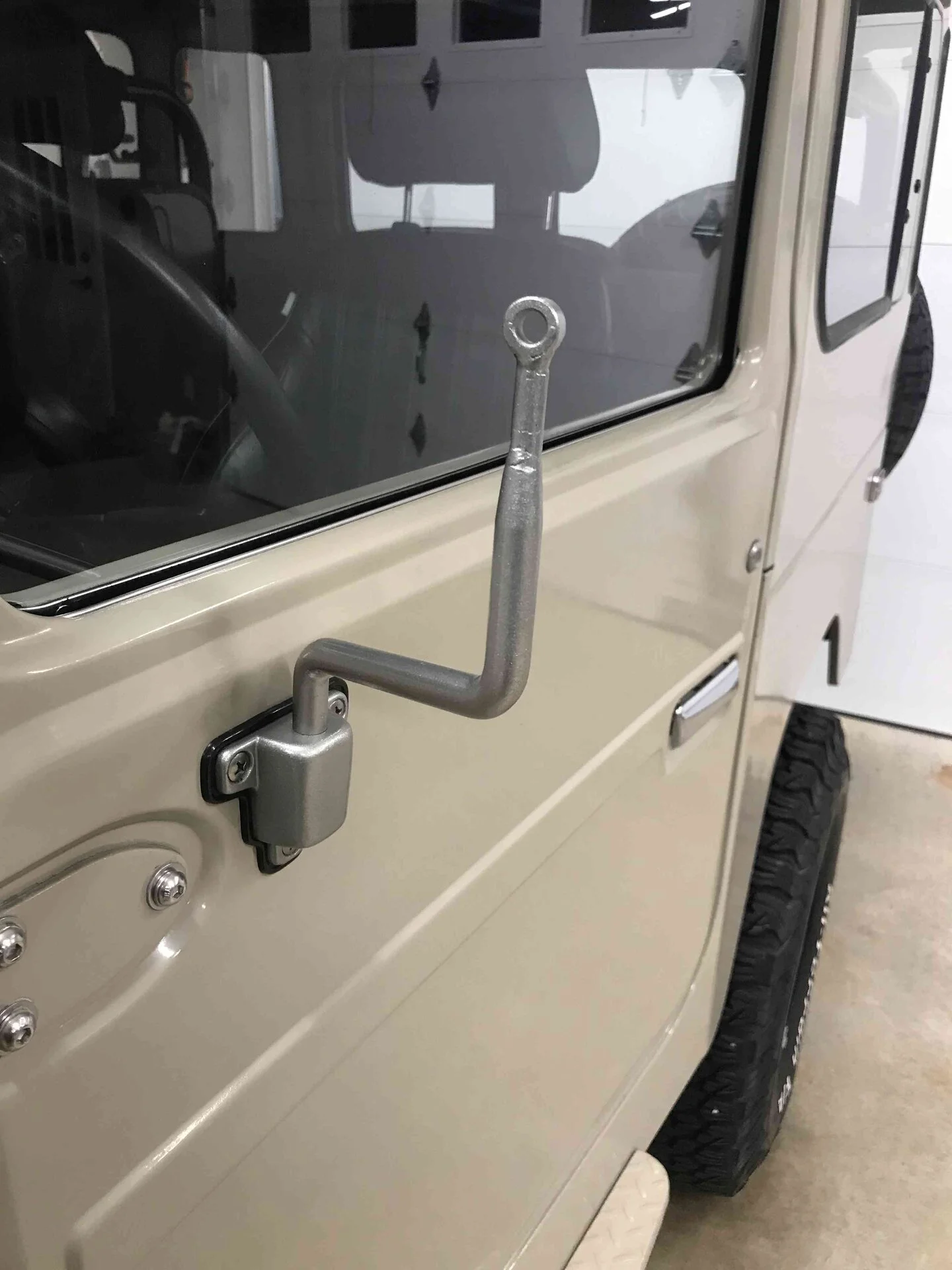

Some may have noticed I was looking for a certain set of door mirror arms...here is the reason why. The question about the plastic mirror's that attached to the mirror arms with the ball joint, some people have trouble keeping them steady at higher speeds. I have/had my plastic ones set good with the tooth washer behind the ball joint, and that worked very well. However, I was looking for another solution to keep the door mirrors more steady...well, here is my solution:
The non OEM door mirror arms I took apart and cut the ball joint off.
After a little welding prep, I took some 3/8" round bar stock, cut at 3/4" long and welded to the mirror arm where I cut the ball joint off. Then I took a 5/16 x 5/8 x 3/8 heavy steel bushing and welded it to the 3/8" bar stock at about the same angle the original ball joint was. Then primed & painted, installed a set of convex Toyota 87901-55012 units, and here is the result.
Yeah, my welding & griding skills are lacking, but it gets the job done. I will be doing another set and taking a little more time with the bushing angle, welding and grinding. Note, the mirrors are the same part number I use with the arms that attach to the windshield bracket when the top is off. Thus, you can use any of the mirrors with the screw post attachment. As of now, I've been running these for a few weeks and I really like them. Also, I've been up to 65mph with them, and they seem solid.....so they will stay for now.
That’s a million times better. When I finally get around to putting my doors on I think I’m going to steal that idea.
Personally, I'd do the round mirrors with the laid-back arm mounted on the door hinge, not sheet metal; I'm assuming there is less vibration on that part. I think that the GA Architect nailed the solution for the later doors though. Your's are a pair doors for '73 @thatcabledude?
View attachment 3201912....View attachment 3201913
View attachment 3201914....View attachment 3201915
This solution really is the best. Fantastic!
What did you use for rubber trim around the convex mirrors? Mine didn't come with that... is it aftermarket?

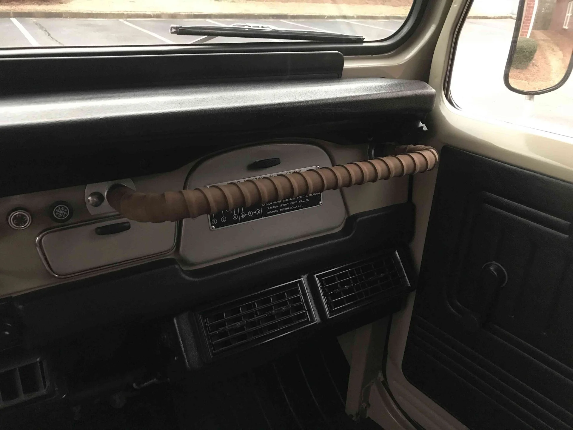

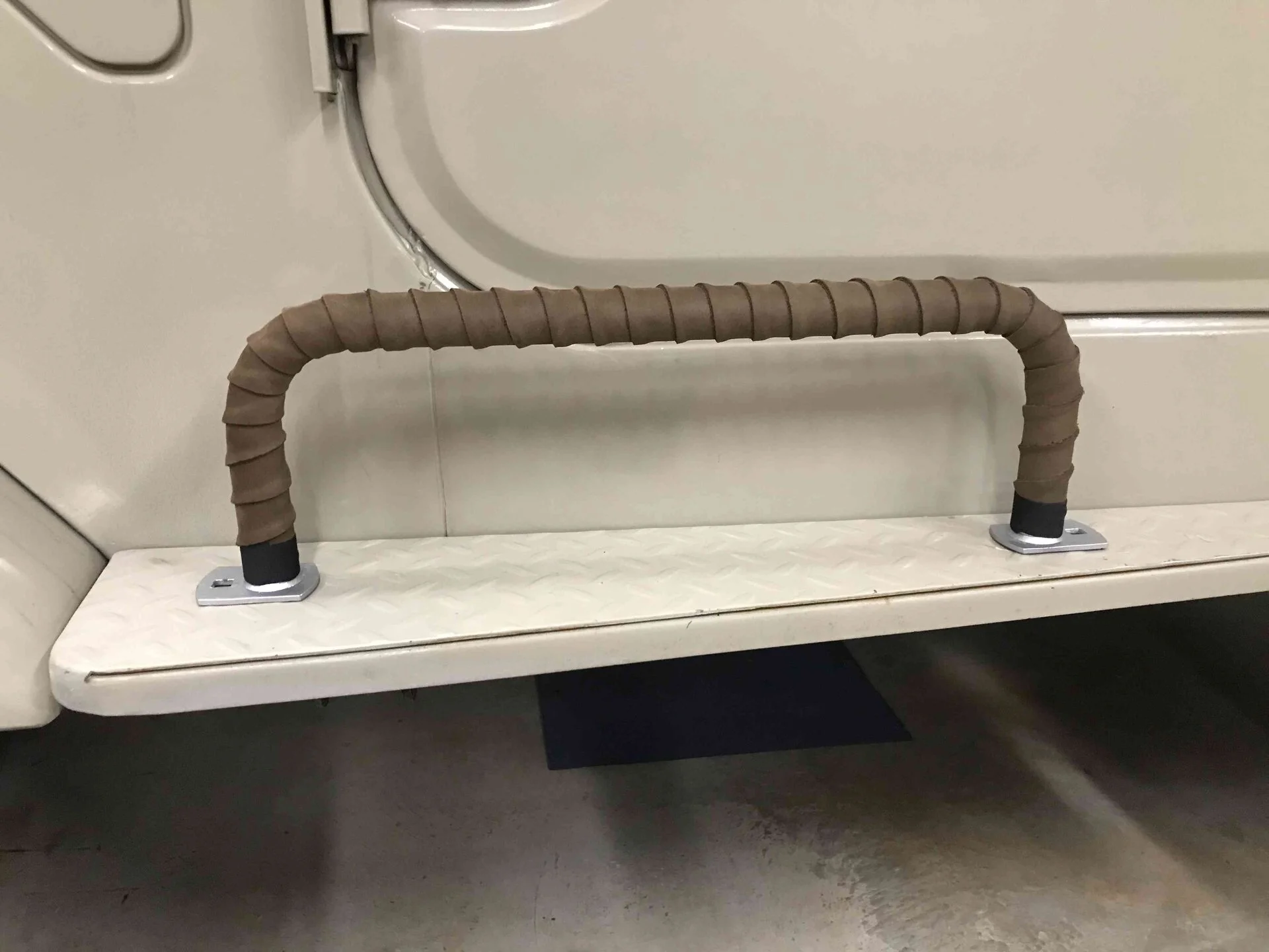

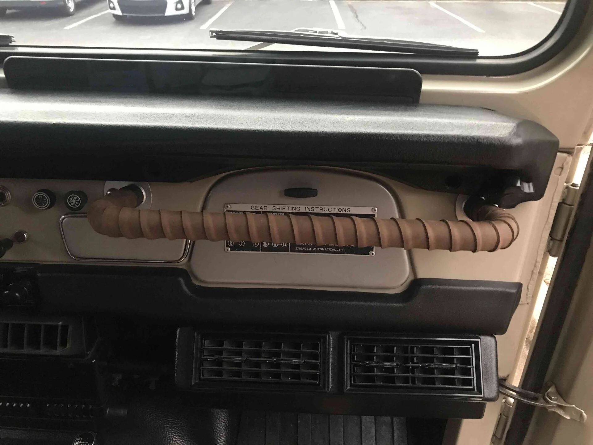

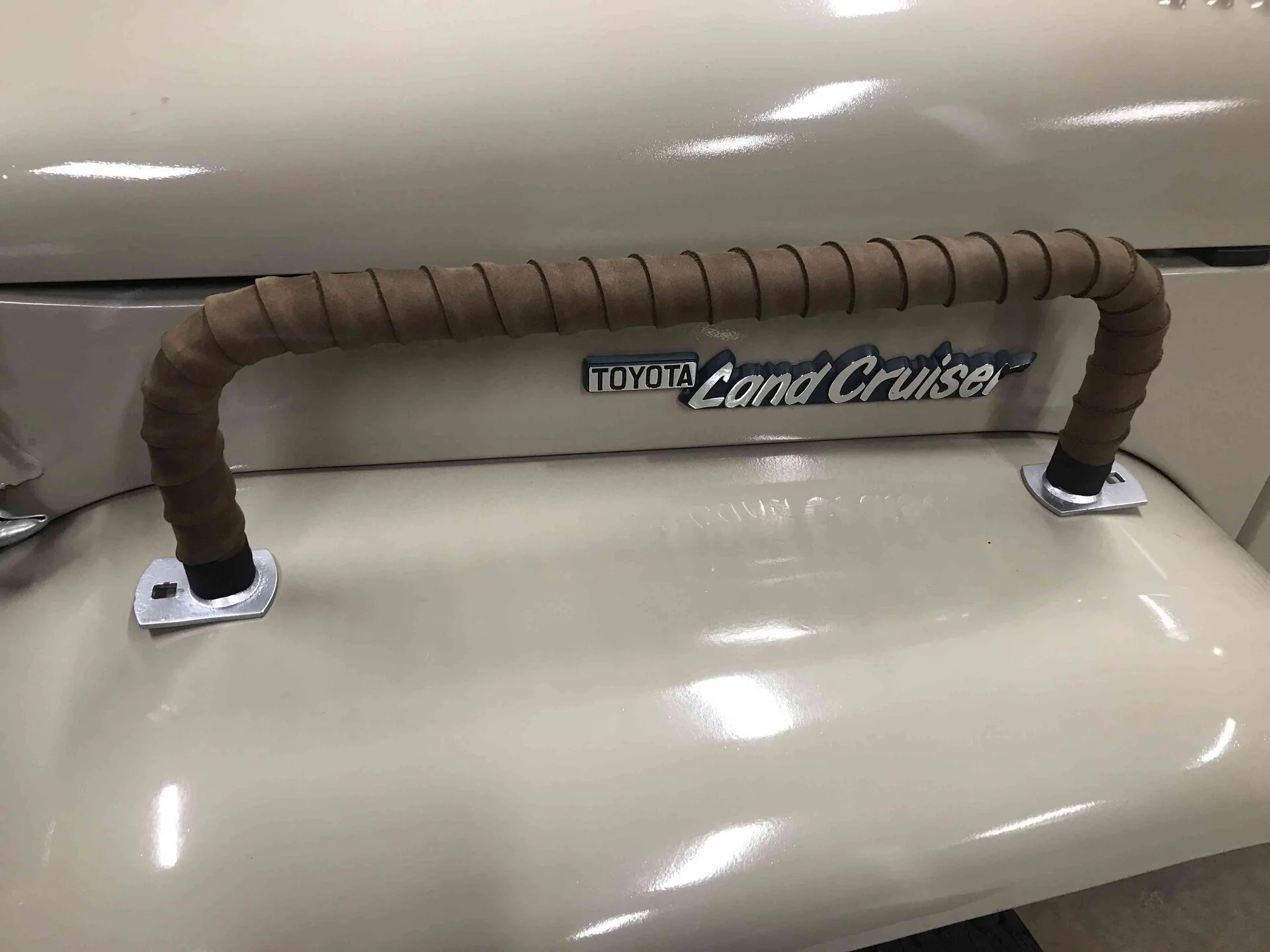

Note much work done on the truck, just driving it most every day. However, did come across an old Con Fer dash grab bar to help my 5' nothing wife get into my 40. Did a little refurb to the handle, wrapped with some leather and installed it.
Didn't like drilling the holes, but ehhh.....wife approves.
View attachment 3256091...View attachment 3256092
View attachment 3256093...View attachment 3256094
Date night at 'CUE Barbecue in Milton....yum-yum
Nicely done as always Rick. Greetings from Arizona👍
The leather wrap is a nice, good-looking detail.
My wife is a 5-footer, too (barely) and she gets mad as hell when I push her butt to help her up. She keeps asking for a grab-bar.
It's fun to get 'the look' when I 'help'. :D
Nice leather work !
Mine is only 5' as well. She likes the grab handles on my MetalTech "Jackson" roll cage.
Same here. I have grab handles in all my Landcruisers.🤔
And she carries MY grab handles very well.😉

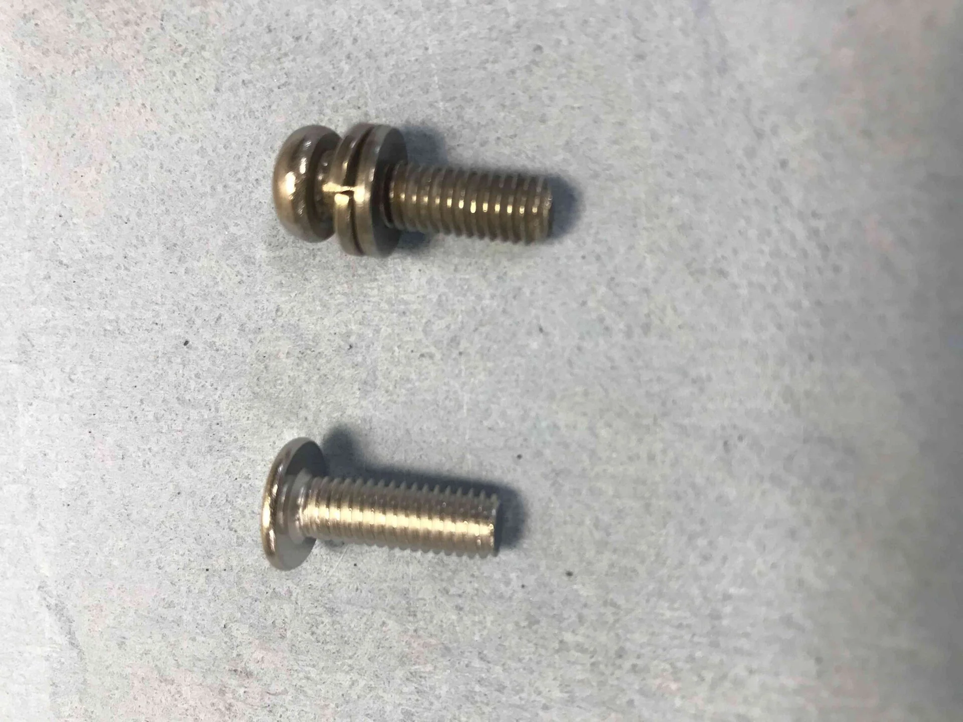

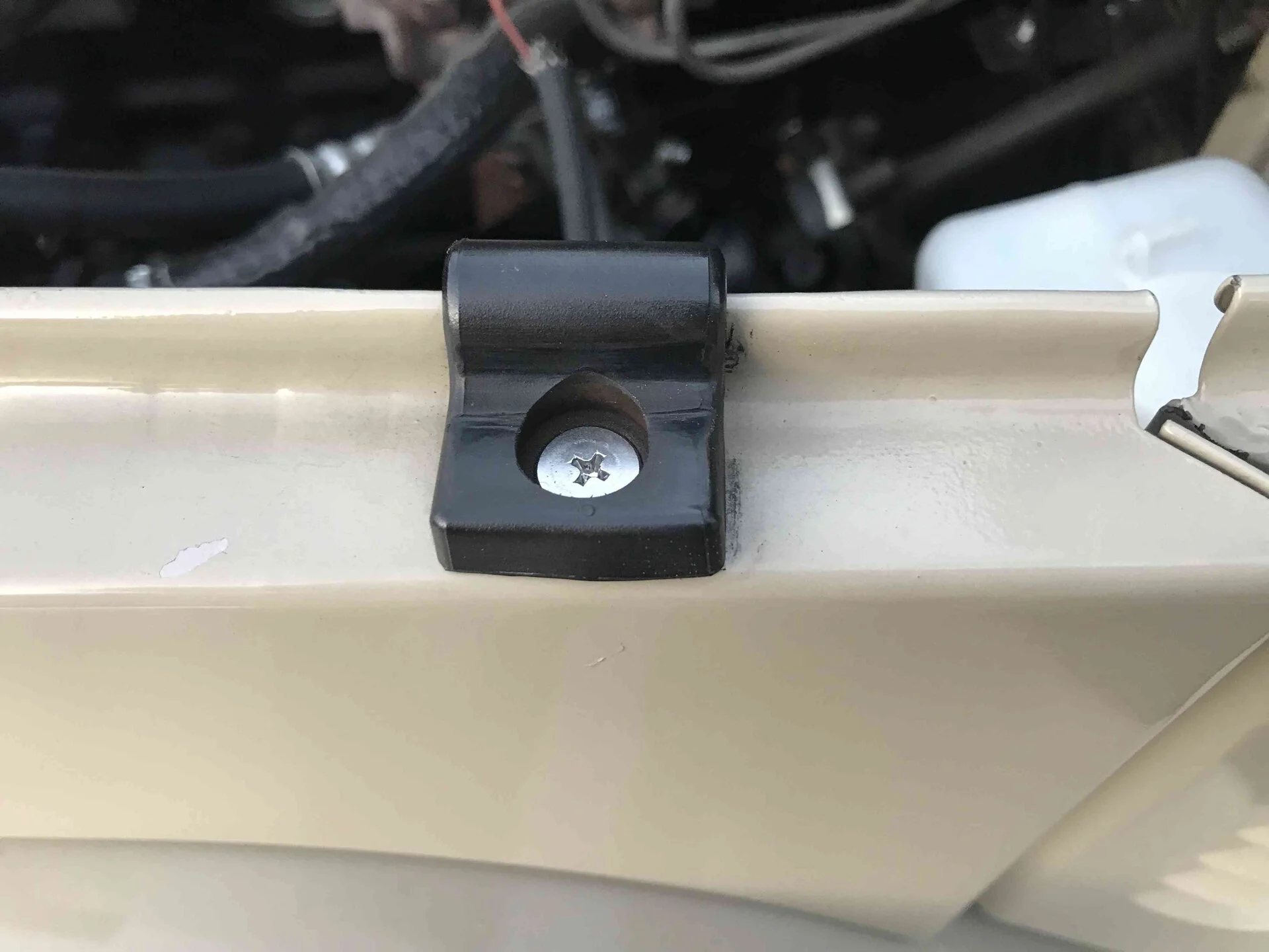

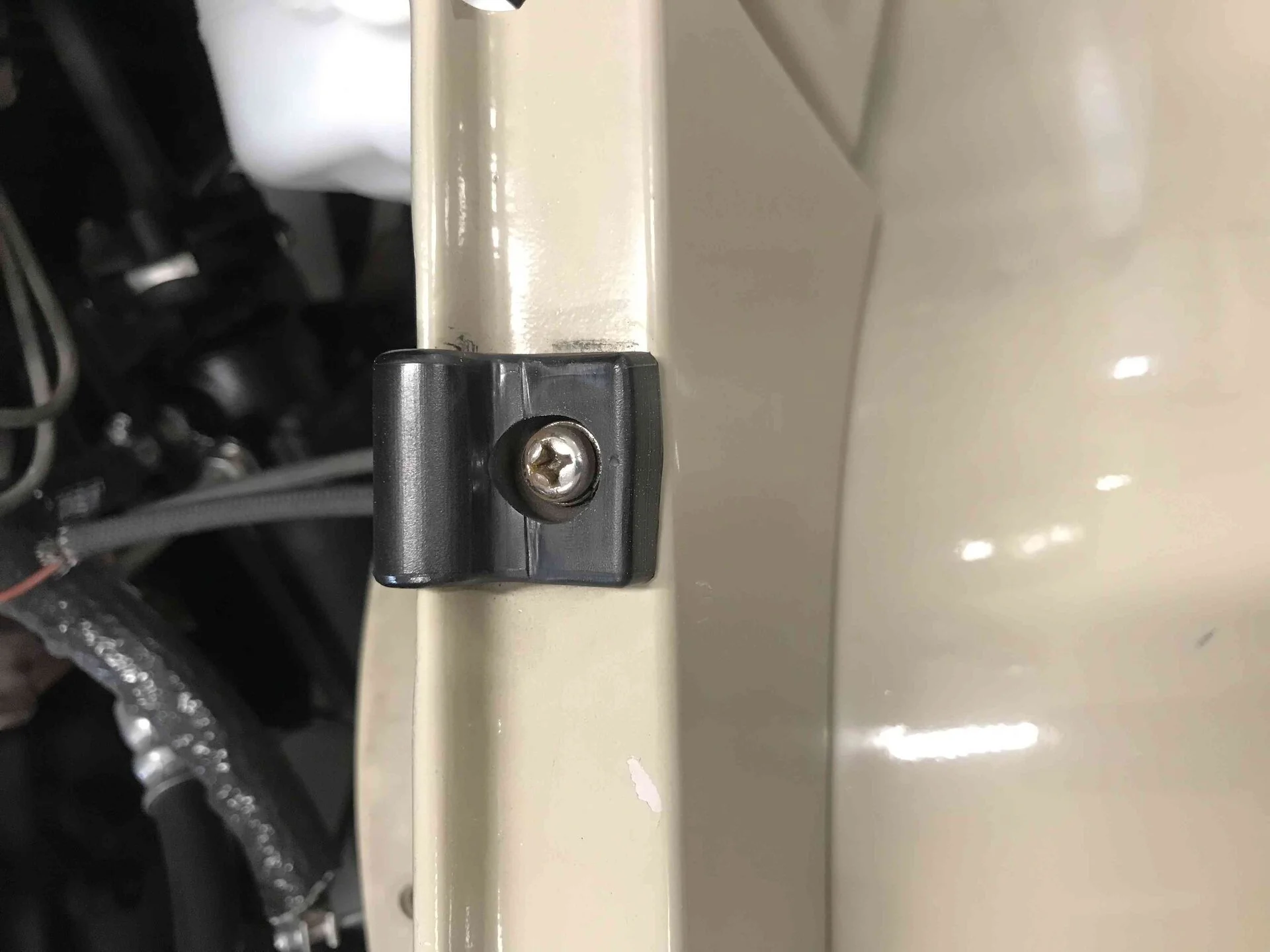

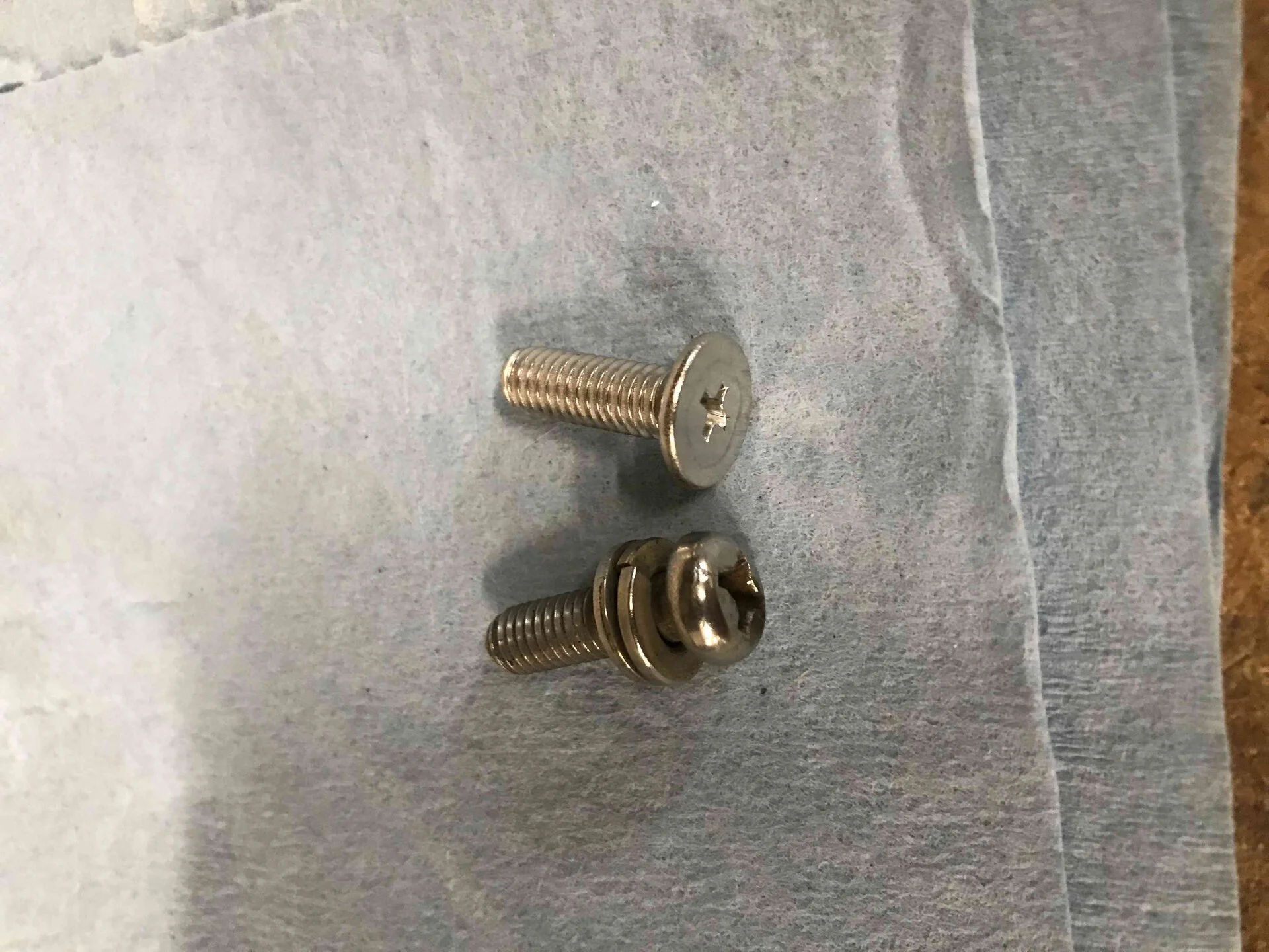

Over time, my hood would cut into the fender-to-hood bumpers and would come to rest on the screws. This caused the screw tops to rust....here is my proposed solution to that: < M6 X 18mm >
Time will tell if this is a good option. For now, I'll order a few sets of the fender-to-hood bumpers (53349-90300) for backup.
