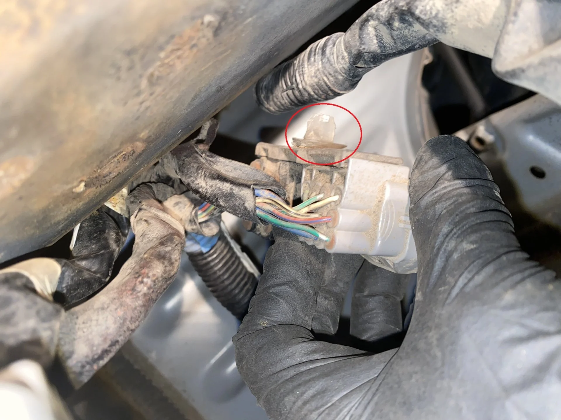

As mentioned by @uHu and @2001LC, a repetitive fault of this nature suggests a short circuit somewhere which enables such a large current flow. This seems more likely than an overload.
May I add the following to the suggestions already made in earlier posts in this thread:
  1. Check the AHC Motor Relay for correct operation and no short circuits -- failure of this relay is unusual but not impossible -- it is located in the Junction Box in the Engine Bay (not to be confused with the AHC Main Relay which is located on/near the Suspension ECU under the dashboard). ,
  2. Check for short circuits in all parts of the harness and all connectors between the 50 Amp fuse-link and the AHC Motor. For example, it would not be the first time that problems have arisen in 100 series vehicles below the Junction Box in the Engine Bay,
  3. Suggest always look for simple things first,
  4. After the “simple things” it may be necessary to look closely at relevant parts of the wiring harness, searching for road debris or sticks-and-stones damage and/or damage caused by heat from hot exhaust leaks and/or the effects of salt and water ingress into supposedly water-tight connectors, and/or test for short circuits, etc, etc, etc. See for example the stories and pictures relating to various circuit problems in the following threads:

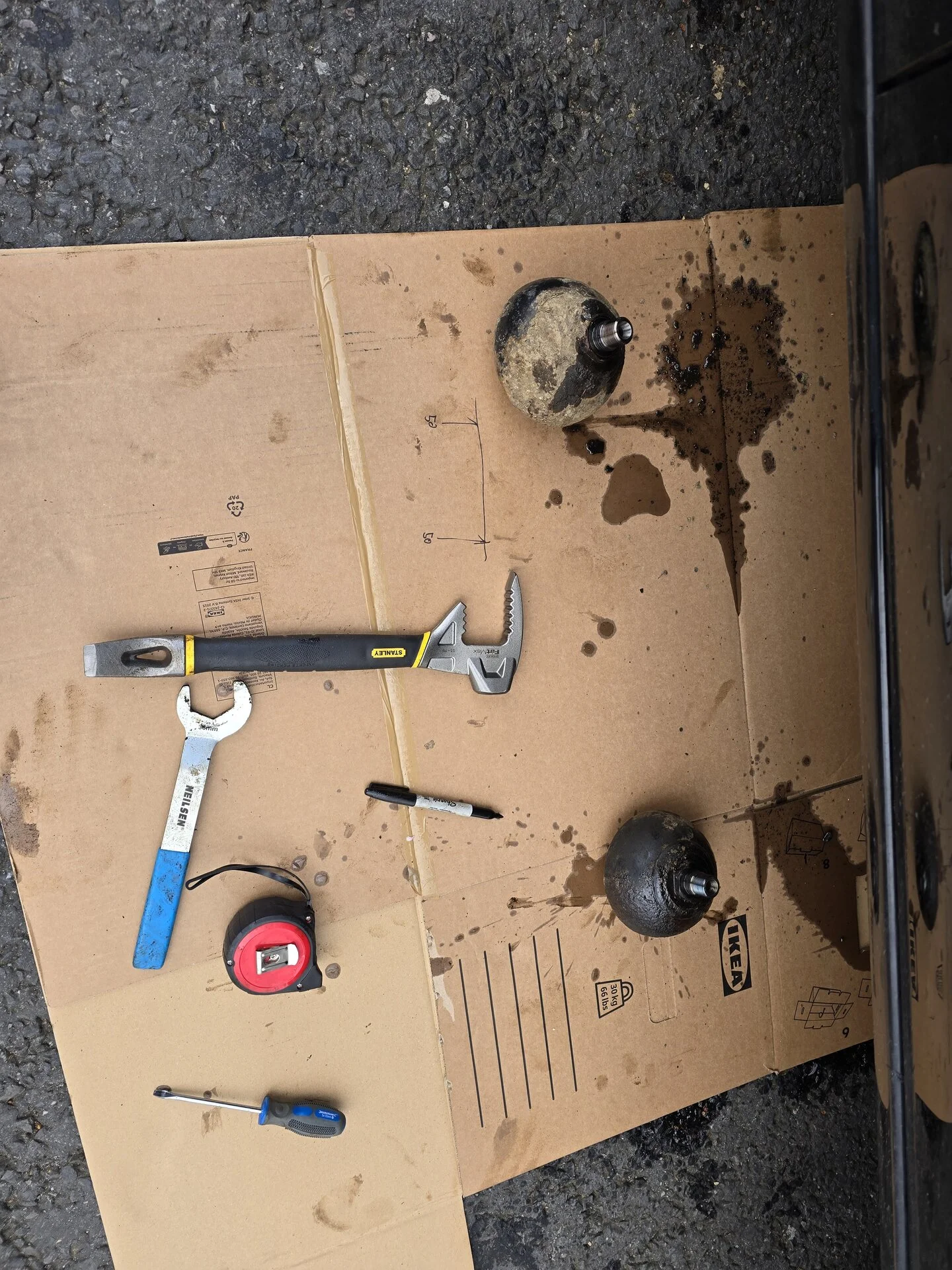

Just wanted to share a few points after getting my system dialed in a little better:
After swapping out my globes, (replacing AHC globes/accumulators - https://forum.ih8mud.com/threads/replacing-ahc-globes-accumulators.716383/post-15227827) I started tuning. As expected, the pressures were high, but not too bad. Low 7s for the front and right around 7.0 for the rear.
Front: Front was a little low on the left, so with a few twists of the TB was able to get it aligned with the right. Overall needed about 5 turns on the left and 2 on the right and was able to get it in the mid 6s for the front with right around 19.75 wheel to fender measurement.
Rear: For the rear I ended up with 30mm spacers (note: get the Slee spacers) and that brought mine down roughly 0.5MPa. I didn’t see the 1MPa drop that others have mentioned. Even though I'm sure my 250k springs might be tired, still doesn't seem like new OEM springs are really going to change things that much here? I’m planning to stay mostly stock so I think the king springs would be overkill. Nevertheless, I’m happy with where I ended up, I will take 6.4 MPa.
The Ride: Man, I know others have already figured this out, but it is just SO lovely. It isn’t like magic or anything, but it is just so much difference with new globes and dialed in pressures. Again, thanks to all those for all the research here, esp YodaMD with the very approachable sheet and video which makes this far less intimidating. For anyone debating if they should do this after globes, the answer is an easy yes. Adjusting the TBs and adding the spacer was just as impactful as the new globes themselves.

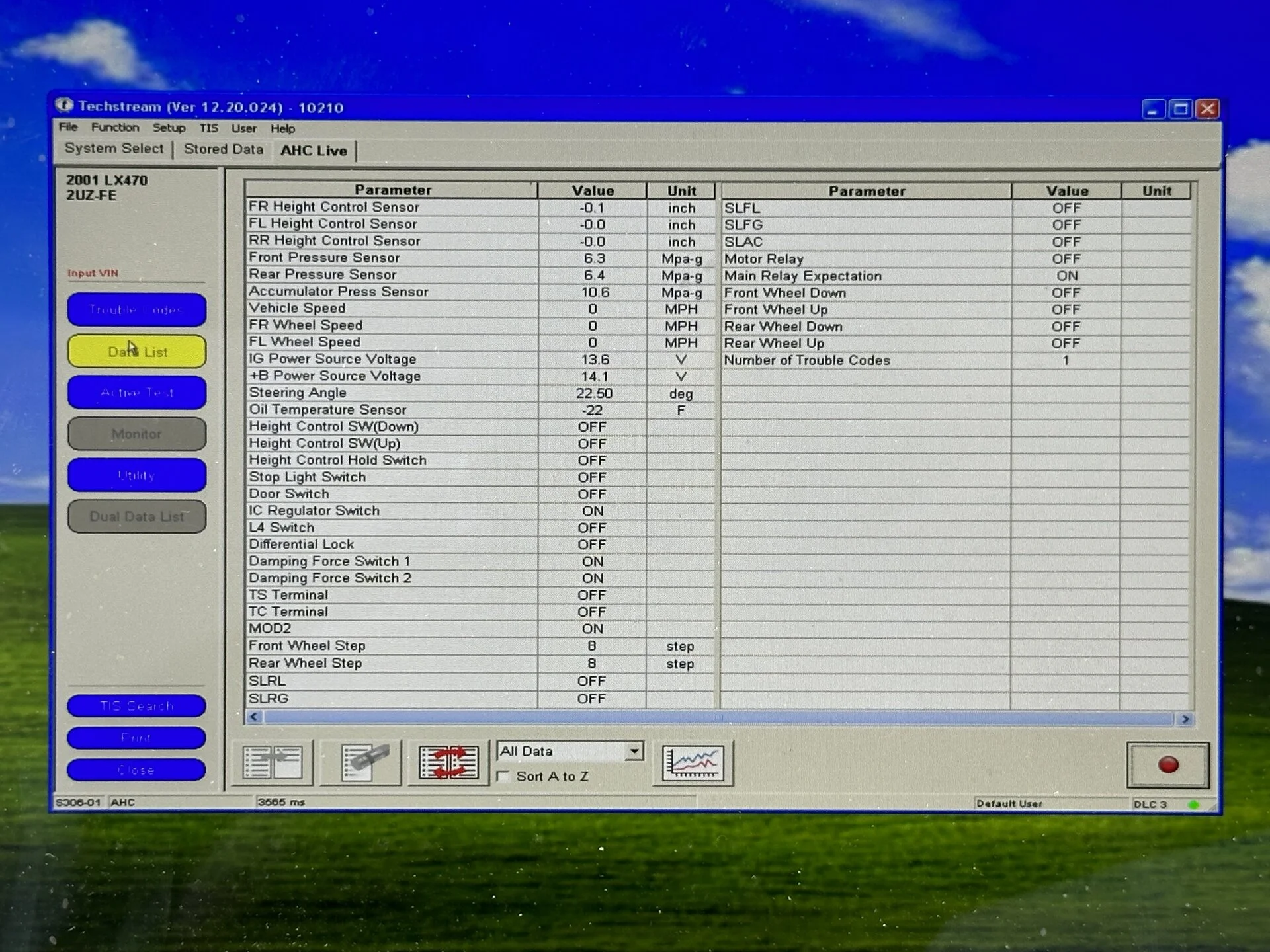

Current specs after crossleveling and torsion bar pressure adjustment:
FR Height Control Sensor: -0.3 inch
FL Height Control Sensor: 0.0 inch
RR Height Control Sensor: -0.2 inch
Front Pressure Sensor: 6.7 MPa
Rear Pressure Sensor: 6.6 MPa
Accumulator Press Sensor: 10.6 MPa
Do I mess with the FR height sensor and RR height sensor to get closer to 0.0 or just let it ride? It's ever so slightly low on the hub-to-fender measurement.

If new OEM AHC springs, then AHC pressures are function of the weight of the vehicle and the 'ride height' of the vehicle at the "N" height setting -- more weight than stock and/or more height than stock means more AHC pressure. If Rear AHC pressure is not sufficiently corrected by a spacers (which causes pre-loading of the springs), then more spring rate is necessary, such as with King KTRS-79 springs.
You already understand the Height Control Sensor readings -- but to set it out again for anybody else who comes this way ....
Suggest re-check front cross-level on level ground -- “level” means a levelled concrete surface like a garage, or within a built parking station, or similar -- not in the street nor in an open parking lot -- these are cambered or sloped to drain and are neither flat nor level by design (or lack of design). Then look for tape-measurements hub-to-fender which are equal within FSM-specified tolerance of +/- 10 mm (0.39 inches), adjusting the equalisation if necessary using ONLY the torsion bar adjusters with engine OFF per FSM, and NOT using the Height Control Sensor adjusters. At this point, the actual hub-to-fender measurements are interesting but unimportant -- it is the equal heights within tolerance which are important. Vehicle ‘ride height adjustment’ is a separate step which comes later -- on an AHC-equipped vehicle ‘ride height adjustment’ is NOT done using the torsion bar adjusters.
A check of Front cross-levelling is the starting point for any adjustments on the AHC system.
By the way, the hub-to-fender measurements are not the FSM-specified method of vehicle height measurement but are an easy-to-use, widely recognised and reliable approximation. The FSM method is more accurate but is very fiddly and inconvenient.
With the Front of the vehicle properly cross-levelled, and with vehicle in “N” height setting and still on level ground, check Height Control Sensor readings Front Left, Front Right and the single Rear sensor on Techstream (or other suitable reader), looking for zero within FSM-specified tolerance of +/- 5 mm (0.2 inches).
If necessary, adjust the Sensors with engine OFF by using the slider adjustment to obtain as close to zero as possible -- can use the threaded heim arrangement on the Front sensors (not fitted on the Rear sensor) but these are very fiddly so suggest use slider first (as also mentioned in FSM).
Suggest be wary of “pursuit of perfection” in these measurements and adjustments. There can be some variation, especially if the ground is not level, or due to age and wear of suspension components and bushings, and/or small variations in manufacture of the vehicle (although Toyota/Lexus manufacturing tolerances are quite tight), and/or body or chassis damage in an accident or very hard use, etc, etc -- which can cause the vehicle to settle a little differently from time to time -- this is the purpose of the “tolerances”.
Suggest be aware that Height Control Sensors cannot be used to adjust side-to-side vehicle height differences on the AHC/TEMS system on LX470 (or LC100 where fitted). Attempting to do so is guaranteed to lead to frustration and re-work.
This is because the Gate Valves in the Control Valve Assembly are “normally open” when the vehicle is stationary or not cornering at speed. This means the pipework connecting the Front Right and Front Left sides of the suspension equalise the system pressures on Front Right and Front Left sides (ditto at the Rear) when the vehicle is stationary or not cornering at speed.
If the Height Control Sensor readings are different, then then the ECU works out an average and commands an up/down signal to get the sum displacement to zero -- if one sensor says +2 and the other says -2 then the sum displacement is 0 -- the ECU causes the vehicle adopt a vehicle height related to the average of the readings.
If the differences in Height Control Sensor readings readings are too far different, then the ECU may be unable to resolve the differences and may put the vehicle in ‘fail safe mode’ – fixed height, fixed damping, no automatic AHC or TEMS response, rough ride. Sometimes this is indicative of a failed sensor -- especially if the fixed height is strangely high or low.
‘Ride height adjustment’ is achieved by setting the vehicle at the desired height at “N” height setting (using jacks or some form of lift or by using the “Active Test” procedure), then adjusting the Height Control Sensors as close as possible to zero with the engine OFF. The vehicle is then set to return to this height at “N” height setting, provided the system is healthy and not overloaded. The ECU determines the heights at “LO” and “HI” height settings -- these cannot be adjusted independently of the “N” height setting.

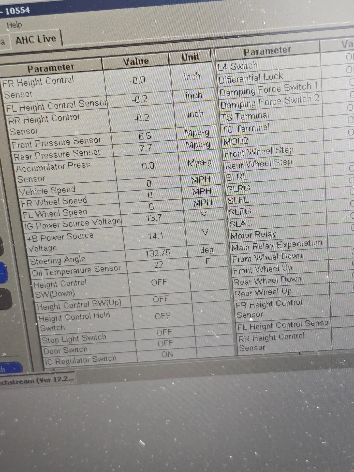

Hoping you guys might help shed some light on my situation..................
2006 100 series with AHC (UK)
Since I did some offroading with heavy articulation a couple months ago, my ride quality has gone down hill (jarring on bumps etc.).....
I am getting about 10 graduations of fluid.... however im not in spec so that means nothing??
1) Did an AHC fluid flush (it was black!) and refilled with Toyota AHC fluid
2) Adjusted torsion bars, brought the front into spec :) slight improvement for a while

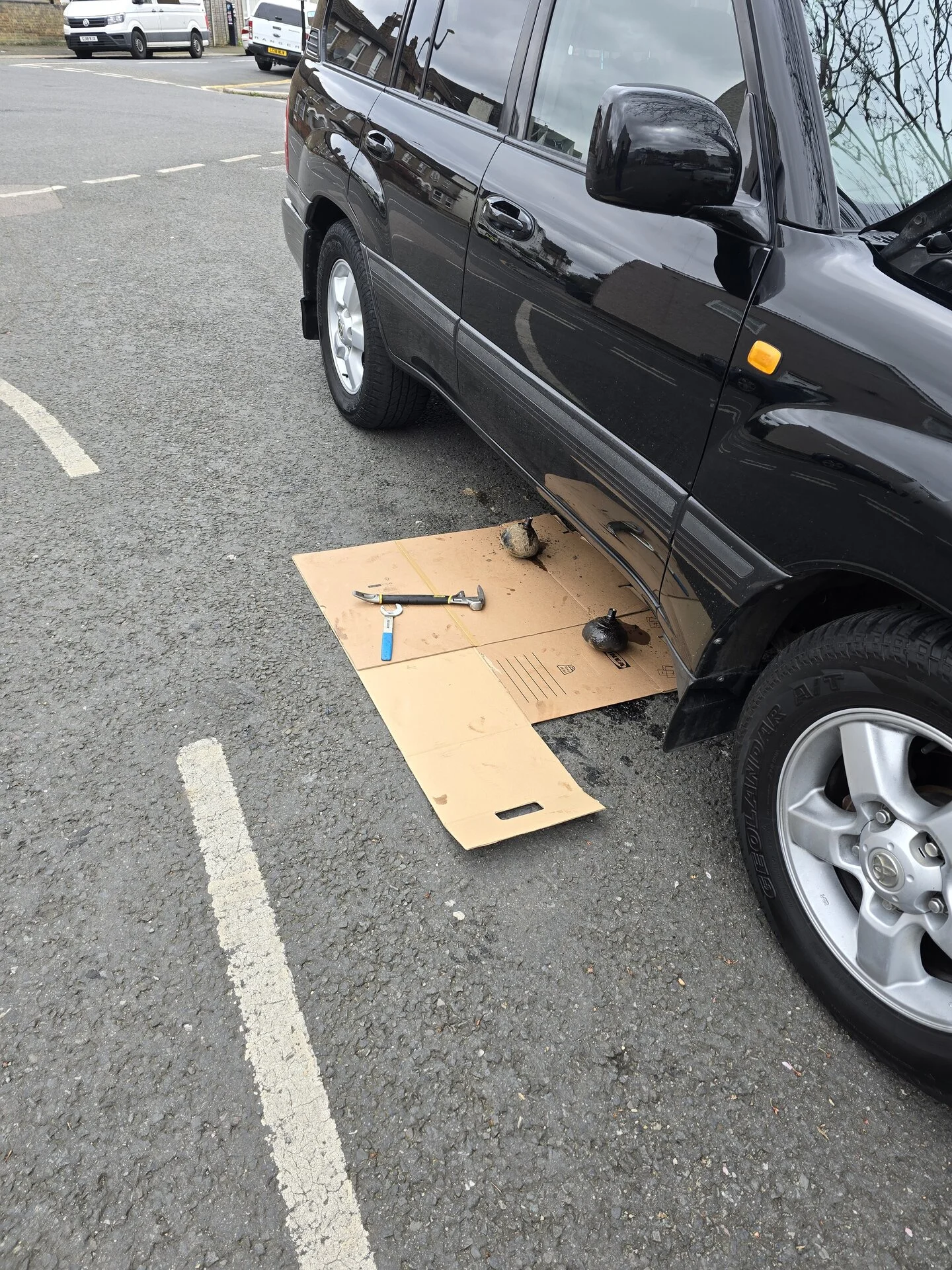

4) Decided to "pencil test" the globes hoping I had a glaring failure.... nope. All had 5cm of pencil depth in them..... apparently that doesnt mean anything either!
5) Front is 6.6 and rear is 7.7............
Do I chuck new rear springs in? Or go for new globes? I believe both may be original to the car.....
Appreciate your thoughts
r
@john100
Definitely get new rear springs. Get 48231-6A780 (Brown paint spot), if you are not carrying a lot of permanent extra weight. They are slightly stronger than the standard purple spot. Toyota 48231-6A780 (482316A780) SPRING, COIL, REAR - https://www.amayama.com/en/part/toyota/482316a780
If the globes are original, I would say they are probably worn out. The pencil test will only tell if the membrane is completely ruptured or not. You need more force than a pencil can take to test the remaining nitrogen pressure.
Edit: Good job getting the globes off. Looks like you don't give up easily. Make sure to bleed well, and more than once.

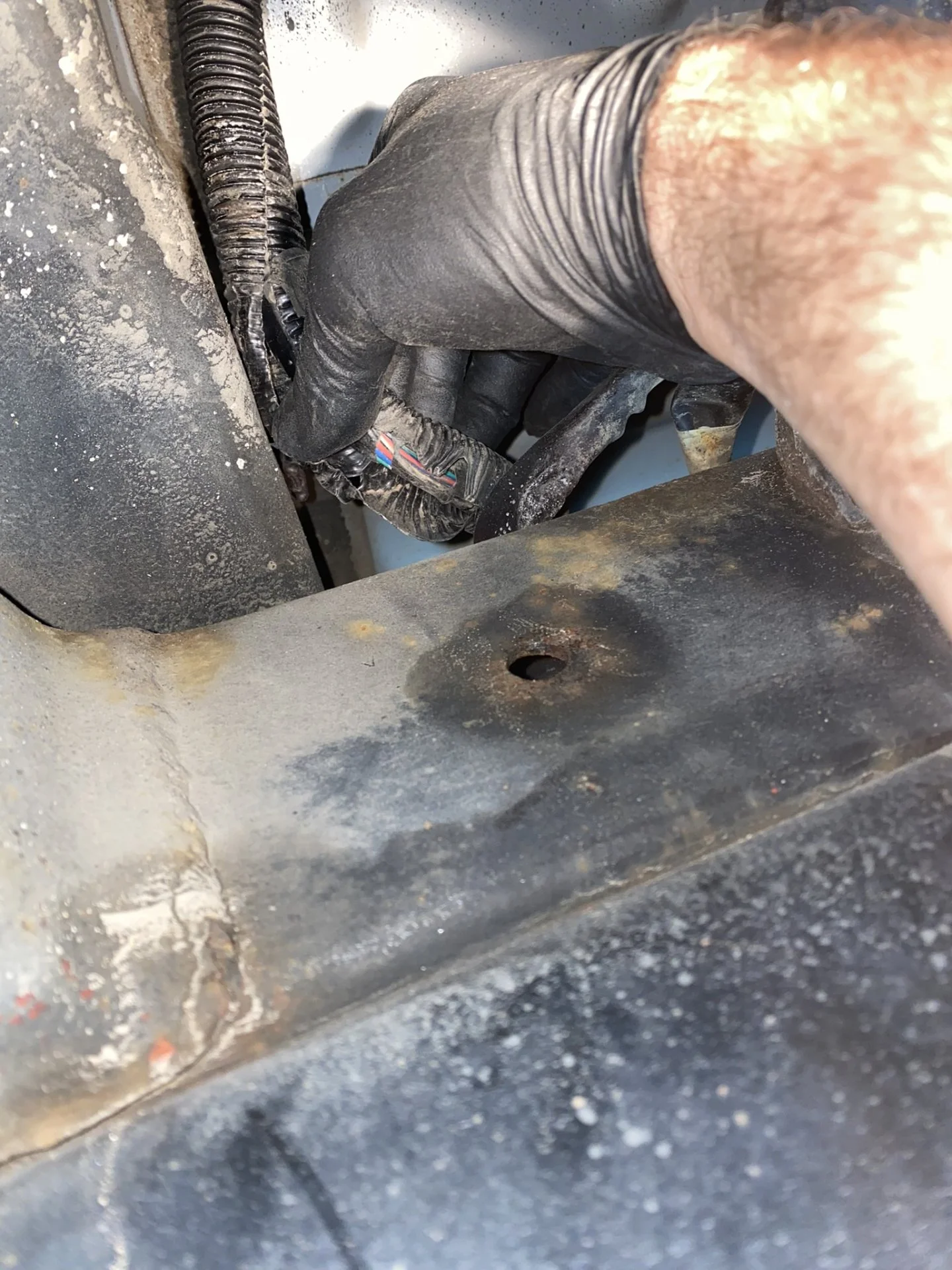

I do agree, it would seem this wire block housing had some part in the failure of AHC. Good Idea Andy, replacing the connectors. For now, we're going to see how the system behaves as is.
It may be best to just replace the harnesses :hmm:
I would have like to test resistance of all wires, that I checked for continuity. But for that I'd need new wire harnesses to compare with.
There was something else on harness I noticed. It was what looked like heat damage on wire harness outer wrapping (Wire Loom Tubing - Split).
Wire harness at rear 1/4. Looks like heat damage, but wires inside seemed okay. At least I couldn't see any wire damage.
Even the 2 (1 at duel block hanger and 1 at single block holder) plastic clips holding harness on frame, were brittle and falling apart. Not what I'd expect on a clean 150K 01LX mostly garaged and rust free. I did strap the harness to the frame. Since these clips weren't very securing well in current condition. Which should keep from bouncing around.
The computer did test bad, and replacement did test good. Both before and after I cleaned up wire housing blocks. So it was a bad AHC CPU. Why it went bad I can only speculate. But could be increased resistance in wiring over time. Could be aftermarket AMP & radio installer some how shorted.
This harnesses wires and its housing blocks, may have/are increased resistance. It could be why I kept seeing the +B voltage about 1 volt lower the IG voltage at most times, while working. Never have I seen +B higher, in this 01LX. +B would drop to near 1 volt when in fail-safe. But this is pure guessing with little basis. As I've never paid much attention to the voltages displayed in tech stream. Nor do I actually know what their telling me/us. I'll also note, IG was about 1 volt below what I'd see at battery, before cleaning up wire housing blocks. I did see improvement after, where IG was at or near battery volt, but still +B below each time I looked (best was .5 volt lower). Which perhaps, just happen to be when I was looking. I have seen other screen shot in mud and in my shop (looking over pictures on file) where +B higher voltage at times, than IG volts.
Can anyone explain what the IG and +B voltage is telling us?

Did you ever get a response for the difference in B+ and Ign. Voltages? I'm trying to figure out or understand why you are so concerned about them. I've never heard or seen anyone on the AHC forum be concerned about them, ( unless there is an electrical issue!) I also have the fail-safe issue with a 1762 code, but my LX is in Dallas and there are no corrosion or salt environment issues here. I thought the B+ V was always a 0.5-0.8 V less due to resistance in all the wiring /connectors/ etc. Does anyone have any experience with this subject, that could be helpful with a fail-safe mode that won't go away. I cannot get the ACTIVE test to run in my LX... and its killing me! After 3 months... and a new PS on the pump and a new pump assy... still wont work
