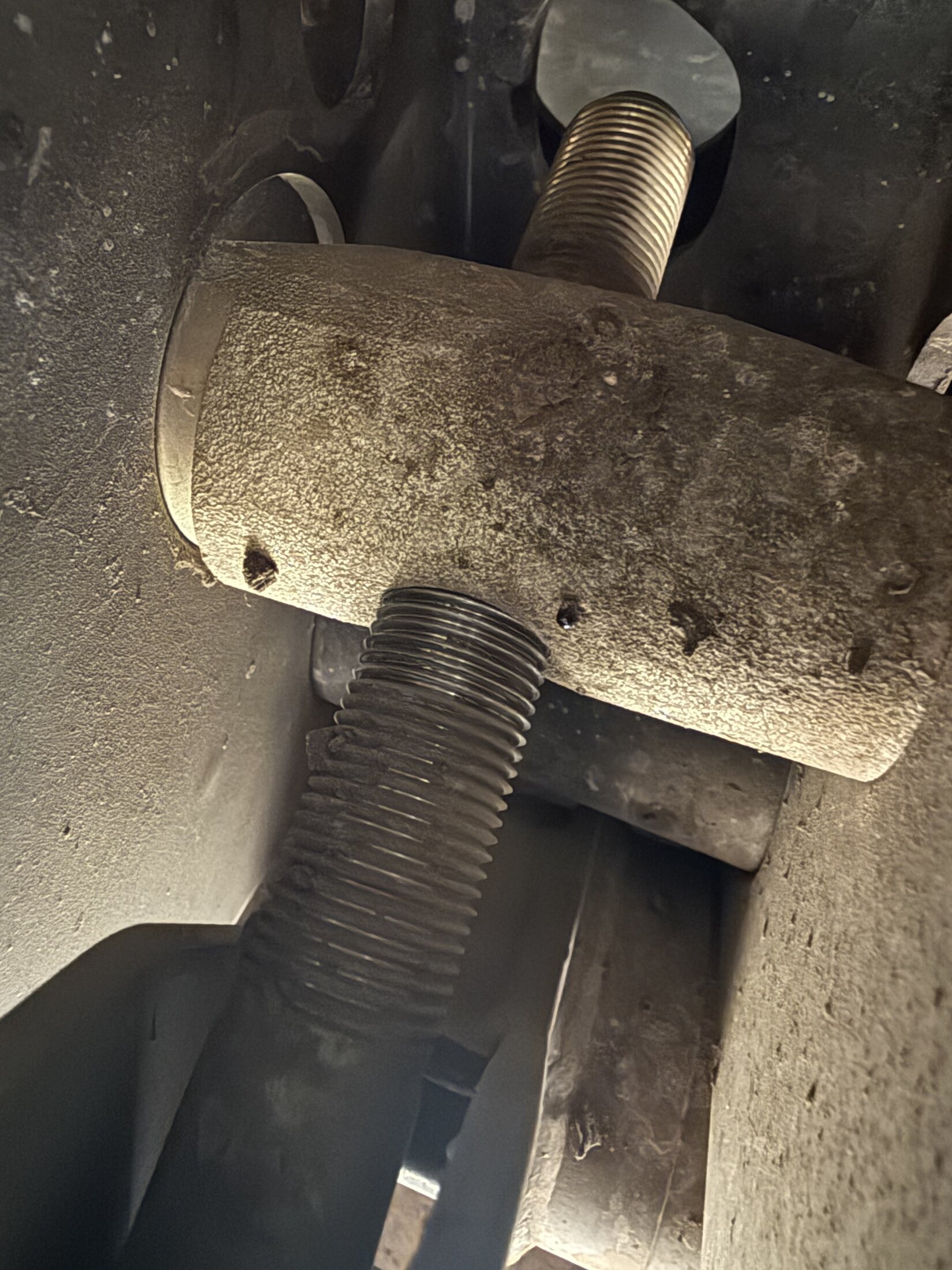

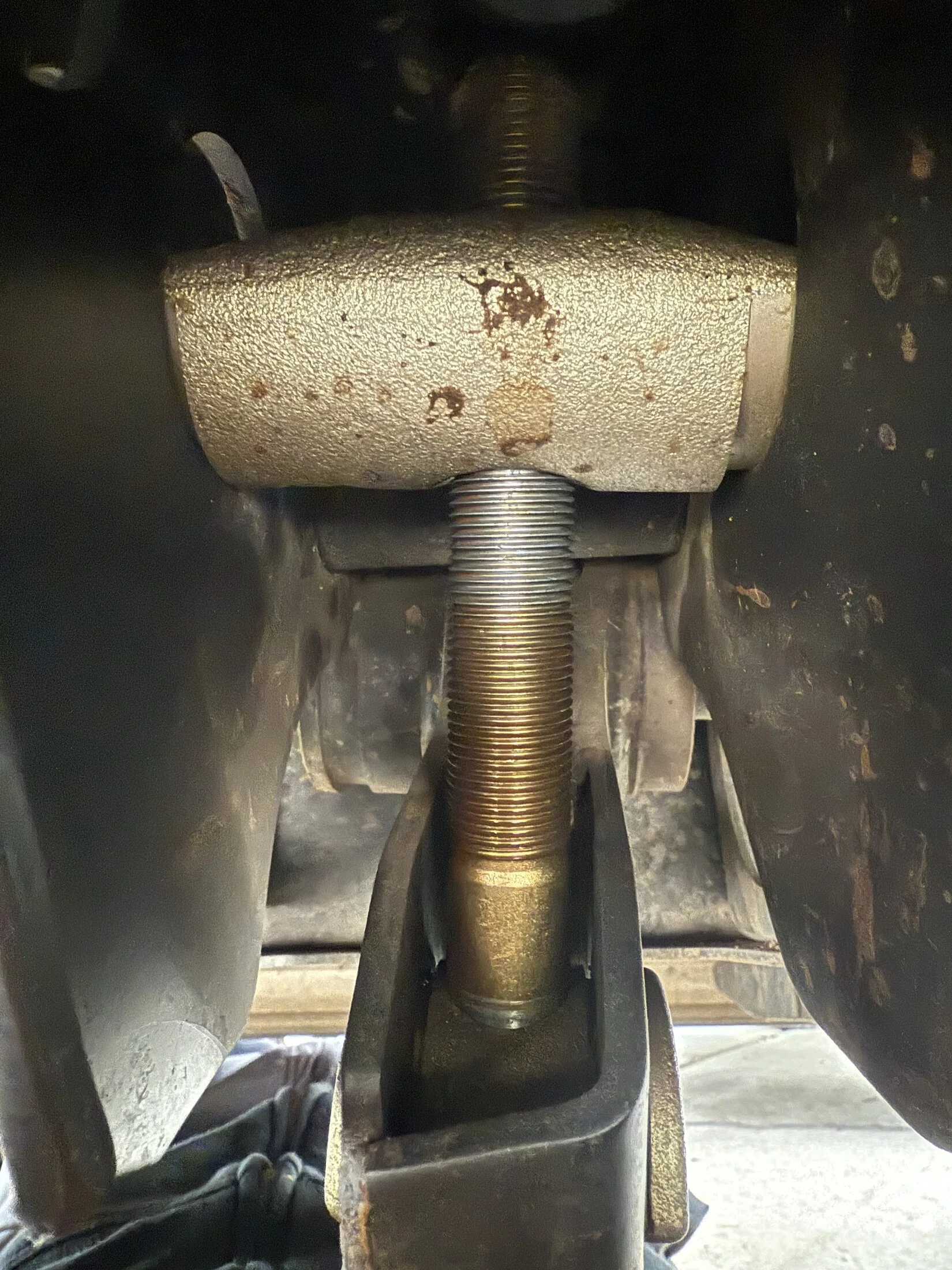

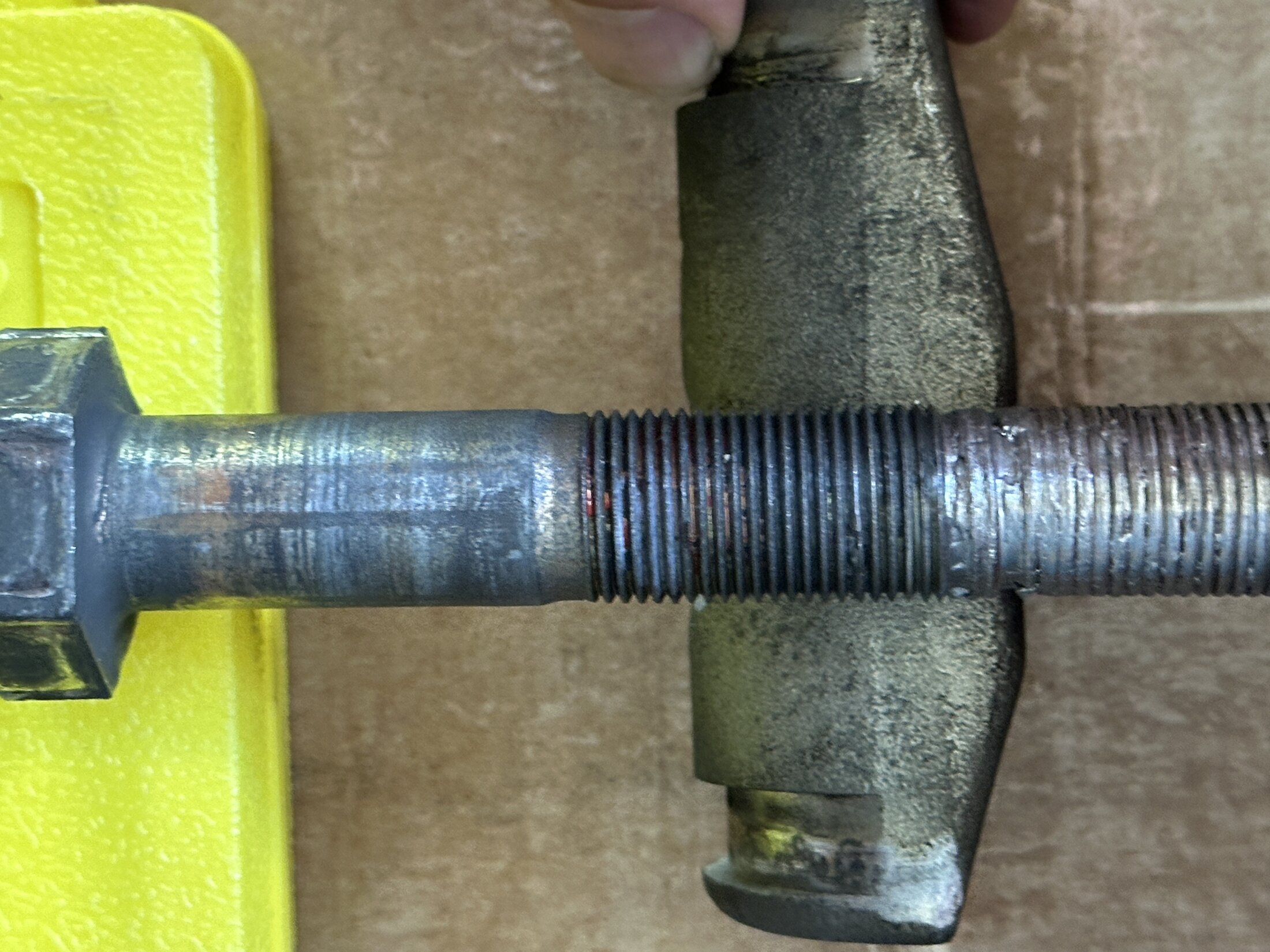

Just want to issue a bit of a PSA here: Just be a bit careful if you start to encounter too much resistance when adjusting your torsion bars.
About a year ago I adjusted my T-bars just fine with the vehicle on the ground when going through the process from this thread. But more recently I did a big front end rebuild and fully disassembled the T-bar bolt and screwed something up when putting the driver's side back together. I might have messed up the threads when using an impact when taking it apart, but I still am not 100% sure. You can see in the picture below what happened. Apparently I'm not alone, you can see more here
Anyway, I'm not trying to scare monger, but I've learned from other threads it is a little bit safer/easier to adjust the T-bars if they are slightly unloaded. You can do this by putting AHC on high or even better, jacking up the front end. While I know this kind of goes against the adjustment advice in this thread, just something to think about.
Although not proven at all, I also think blowing off the dust from the threads and/or using PB blaster to help lube the threads a little would probably help add a little safeguard for AHC adjustments if you didn't feel like raising up the vehicle.
This looks like it was cross threaded and then run forcefully through with an impact gun. That is a very large hardened bolt that is difficult to mess up. Also, always have the front wheels up in the air when adjusting the TBs
I know it looks that way, but that was not the case. I used an impact to loosen it, and when I put it back together, I started the threads by hand, used a drill to take up the slack (roughly half the threads), and as soon as the slack was gone, I stopped using the drill and used hand tools. With the hand tools it was going in fine until the very end and then started to get really tight. When I started to take it back out it was just as tight and that is when I knew I was in trouble. Most of this damage all came from me then trying to get the bolt back out.
The only thing I can think of is that when it was originally under tension, and I used the impact to loosen it, it might have slightly warped the threads. And when I was putting it back together, it mostly screwed in fine because the threads at the top of the bolt were mostly ok. And then when I started to engage the bottom of the bolt that is when the slightly warped threads were then again put under pressure. And as I tried to get it to the final position of my paint marks, when the bolt is under the most pressure, something finally gave way.
In either case, I'm of course now paranoid and won't use an impact even to take it apart.

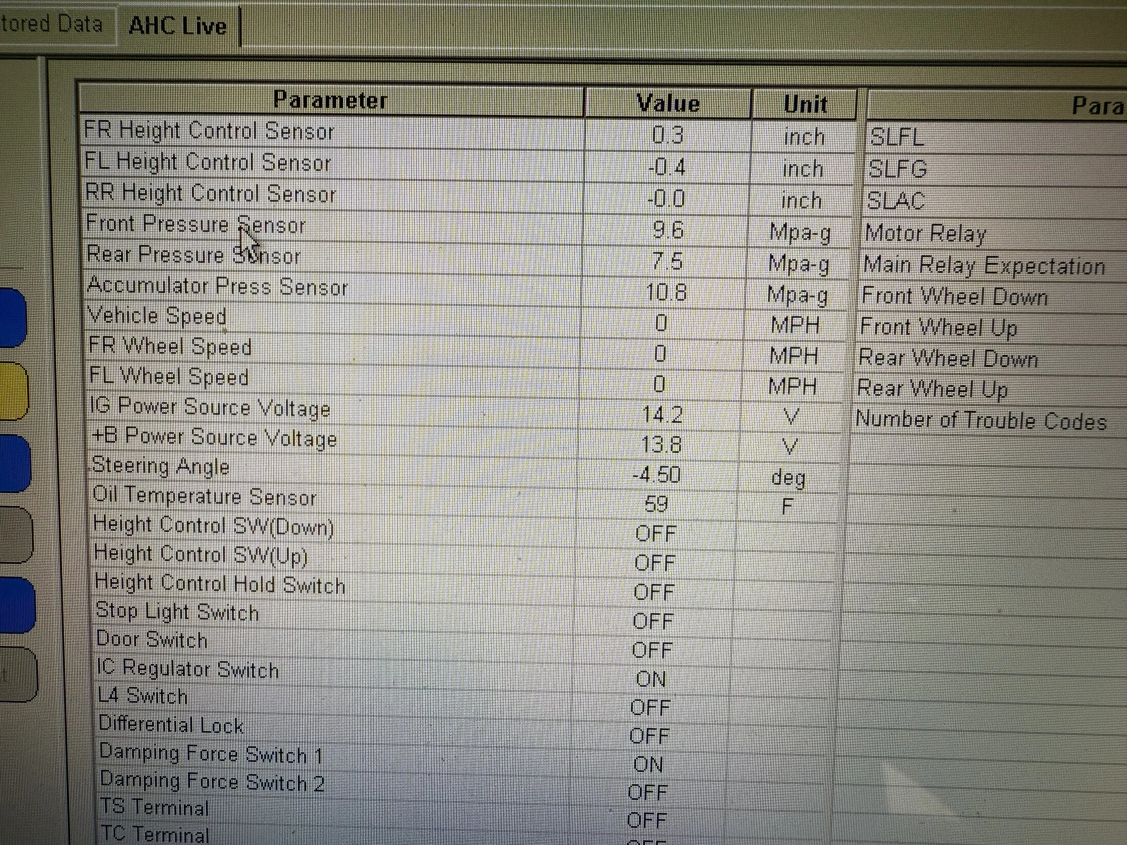

I just followed the steps above on my 2003 LX. Heights were good, so no adjustment needed. Checked pressure in TechStream:
Front pressure @ 8.2,
Rear pressure @ 7.3.
Cranked the torsion bars 7 turns and ended up with:
Front pressure @ 6.5
Rear pressure @ 6.9
so pretty close to spec in the front, still high in the rear. The ride is drastically improved. I thought it was good (a bit mushy, but comfy) before.
I did order some new springs, the LC w/ AHC springs. They are slightly stiffer than the LX springs (or so I've read). I do plan to tow a boat occasionally, and like to load up the family for road trips. I want to make sure the rear is supported well. I will post after install in case others are curious about the difference.
I currently get about 7/8 graduations of AHC fluid. This is on a truck with 260,000 miles and original spheres!
Update:
So after installing the LC AHC springs my pressures are at 6.8 front and 6.5 rear. I backed off the torsion bar one rotation from my previous reading to get the front closer to spec of 6.9.
The pressure with the new springs are not a huge difference, but driving the car, especially over speed bumps, is much improved. The rear doesn't sink as low after going over a speed bump as before, and the rear generally feels more planted on the road. One note, when adding replacing rear springs, remember to disconnect the height sensor bracket, or you may be in for some of this.
With a little reading, $90 in AHC fluid, and $250 for new rear springs, I have a comfortable suspension that rides almost like new. One day I will need new globes, but now that I know what AHC is supposed to feel like, I am certainly going to keep it.

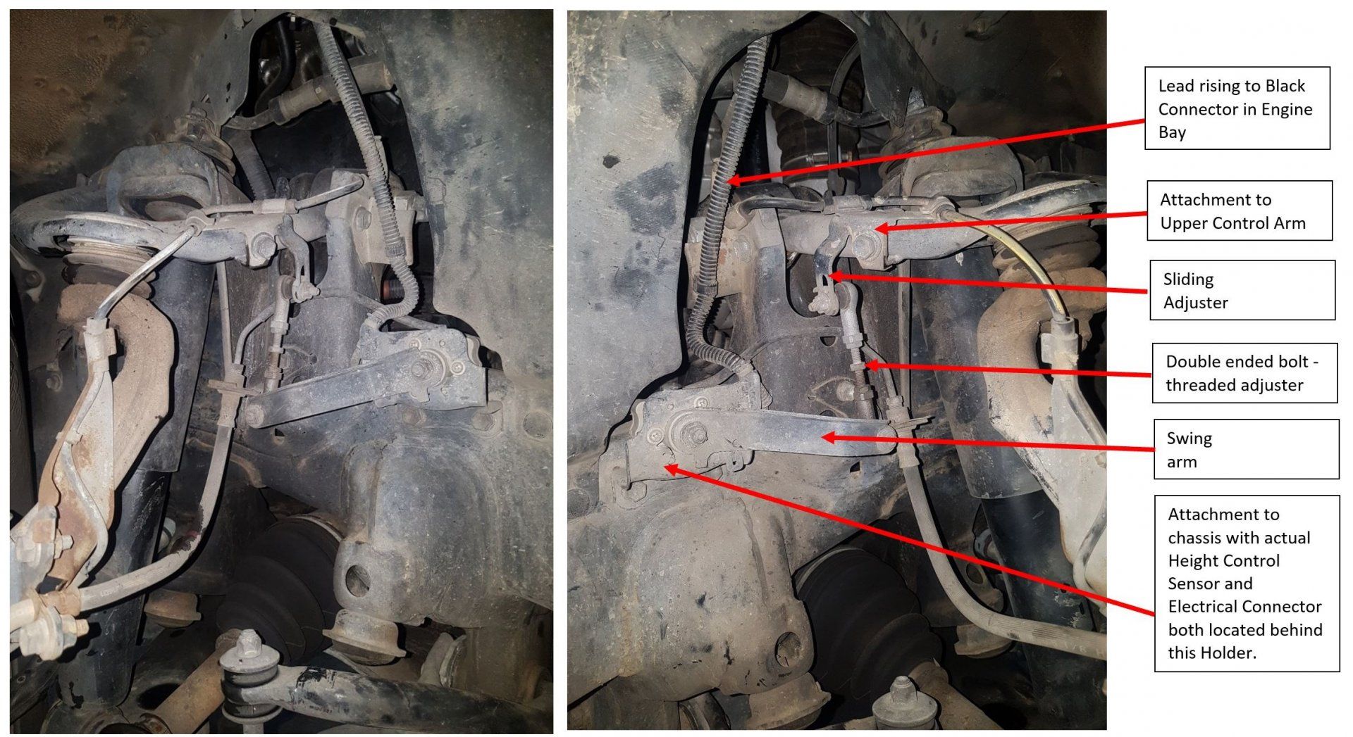

Apologies – I can see that my wording has caused some confusion so I will try again to be more clear.
No – the torsion bar adjusters are not “used to set the correct height (19. 75 front and 20.50)”.
The torsion adjusters are used to do only two very separate things in a vehicle with AHC suspension:
  1. Cross-levelling
  2. Adjusting front AHC pressure
The aim of so-called ‘Cross-levelling’ in Step 1 using the torsion bar adjusters is only to get the same load carried by RHS torsion bar and LHS torsion bar. It is not to set the height of the vehicle. The principle here is that torsion bars behave like springs. To get the same load, we want the same deflection or movement on both the RHS side of the vehicle and the LHS of the vehicle, without any involvement of the AHC system. This is why this is done with engine and AHC turned “OFF” in this Step. We assume that the RHS torsion bar and LHS torsion bar are the same product, same specification and not defective. Then if the front hub-to-fender distance on the RHS and LHS are the same, we can conclude that the RHS torsion bar and the LHS torsion bar are carrying the same load. It is only important in Step 1 that the RHS front hub-to-fender distance and the LHS front hub-to-fender distance are equal. The actual distances do not matter in this Step. Do not worry about 19. 75 front and 20.50 rear in this Step – it is not relevant in Step 1. Those numbers are the specifications which are only relevant when the engine and AHC are switched “ON” and running. That comes later, not in Step 1. Achieving “19. 75 front and 20.50 rear” is never done with the torsion bar adjusters.
It is important to have the torsion bars carrying the same loads because
  • the Right and Left sides of the vehicle must be in balance so that the vehicle does not behave differently when turning left and right, and,
  • so that the operating heights can be set correctly in the later Steps.
When ‘cross-levelling’ complete, then we think about correct heights. We switch “ON” the engine and also make sure that the AHC is switched “ON” and operating. The AHC Electronic Control Unit (ECU) will now receive information from the Height Control Sensors at Front Left, Front Right and Rear. These Sensors will determine the actual heights. Probably the heights will not be correct. We now wish “to set the correct height (19. 75 front and 20.50 rear)” on the RHS and LHS of the vehicle. We definitely do not do this with the torsion bar adjusters because that would change the loads carried by the torsion bars and make them unequal. That would destroy the effort already made in Step 1. So we “set the correct heights (19. 75 front and 20.50 rear)” using the adjusters at the Height Control Sensors, starting at the Front LHS and RHS and then at the Rear.
After “setting the correct heights (19. 75 front and 20.50 rear)” using only the adjusters at the Height Control Sensors (not torsion bar adjusters), then it is time to consider Front and Rear AHC pressures.
The front AHC pressure is adjusted using the torsion bar adjusters. Note that this will not change the operating heights because the heights are set by the Height Control Sensors when the engine and AHC are running and these already have been adjusted.
In your case, you mention that you have “high 7s low 8 (Mpa) at front”. This may be different when you have set the correct heights as previously discussed – so the AHC pressures should be measured again before going further. If the pressures really are so high even at the corrects heights (maybe due to other loads, 'armour', or equipment on the vehicle?), then you need to get down to the lower part of the FSM-specified range for front pressure of 6.4Mpa to 7.4Mpa. Usually, one full turn on both torsion bar adjusters in the same direction makes a change of about 0.2Mpa, so you will need to do at least 5 turns, probably more like 8 turns.
After such a big change, you should again re-check the ‘cross-levelling’ (with engine and AHC “OFF”) and the correct operating heights (with the engine and AHC “ON”), in case something has been disturbed.
Hope this is more clear.

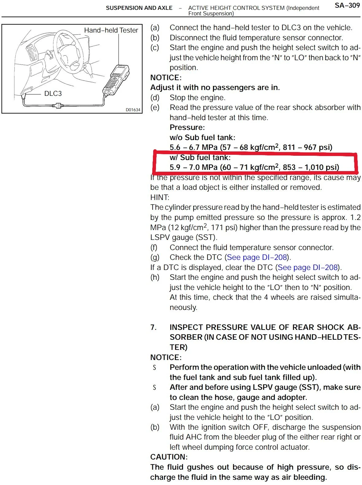

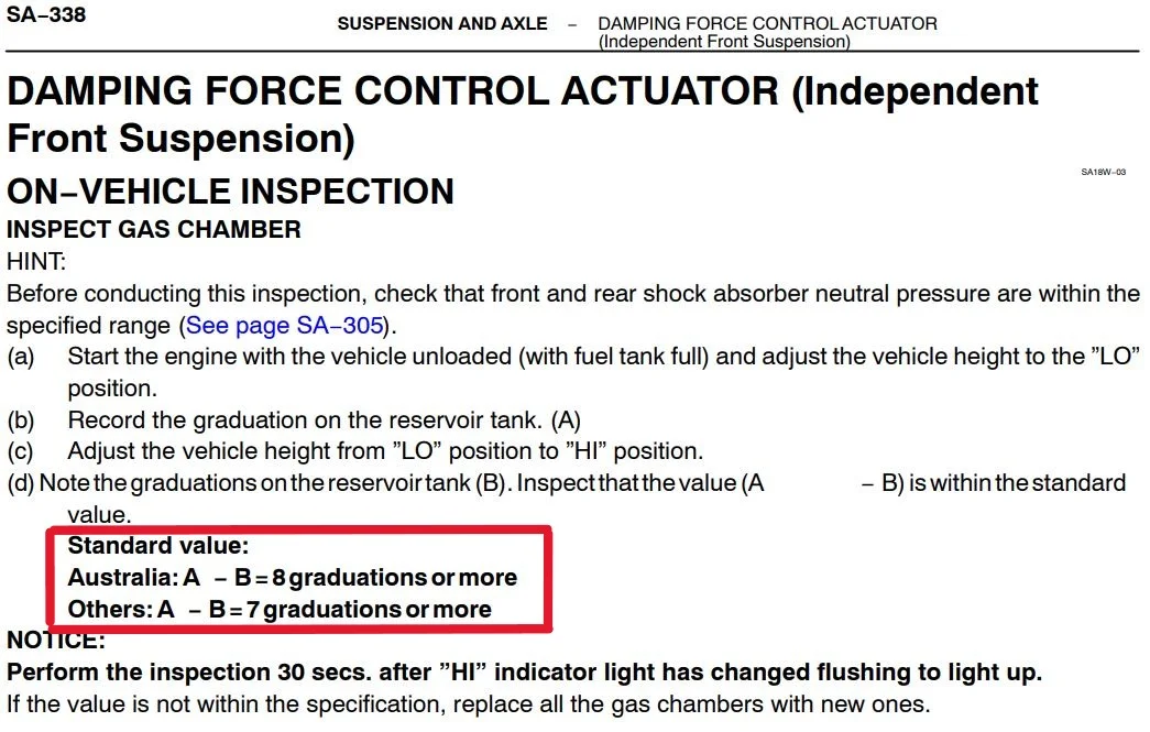

Just thought I'd rock the boat a little bit here, I've gone through the entire thread (very informative btw) and I haven't seen this mentioned but I have seen it mentioned by @IndroCruise in another thread.
For vehicles fitted with a sub tank, the FSM states that rear pressures (when using the computer) are to be between 5.9 - 7.0 MPa.
Also, for Australian models, the FSM states that the minimum specified graduations are 8.
I'm interpreting this as the specs for any LC100 fitted with a sub tank which would cover LC100s sold in Australia, Middle East, Africa etc.
I'm also running on the theory that if I set my ride up to the above specs and ran my sub tank dry that I would see my rear pressures drop by about 0.3 MPa (as measured using the computer) and fall within the specs of an LC100 fitted without a sub tank; I suppose a similar increase in pressures could potentially be seen on LC100s without a sub tank if we were to load up the boot with 50kg.
For pressure specs.

For graduation specs.
LC100 Workshop Manual - https://lc100e.github.io/
+ Repair Manual
+ SUSPENSION AND AXLE
+ DAMPING FORCE CONTROL ACTUATOR
+ ON-VEHICLE INSPECTION
Anyway, just something I stumbled across while reading the FSM and as this is the first stop for most who are looking to spruce up their AHC it may be worth mentioning it in step A-5.
