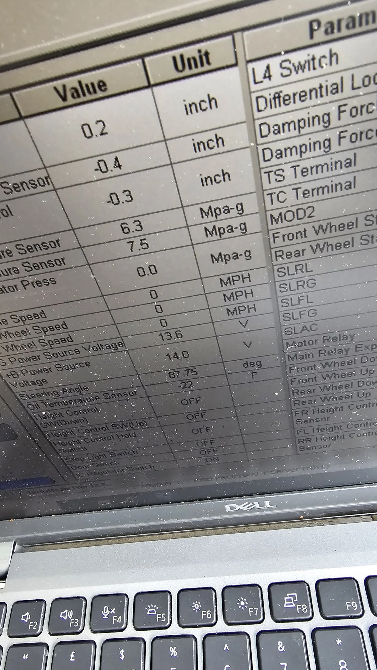

@uHu Thank you for your help. I got my new rear springs from Amayama delivered the other week and installed them :)
I have adjusted the torsion bars and I'm only seeing 0.2 drop in pressure (6.3 and 7.5 rear now)...... However more worryingly I noticed 2 things on my readings.....
1- My steering angle sensor was way out. I have done a reset on that and thats now fine. (obviously over 30 degrees is no good). Great.
2- My Accumulator pressure Sensor reads ZERO!? (same everytime i took a reading, see previous post)
I have to admit I forgot to bleed that last time and I only bled once. I will bleed a couple more times now. However im worried that the accumulator is the issue now?
What do you guys think?

Yes -- best to bleed the Height Control Accumulator.
Probably preaching to the converted but suggest when doing a raise LO > N (or N > HI), listen for the AHC Pump which should continue after the raise is finished and the green AHC light has stopped flashing. Allow say 30 seconds after the AHC light shows constant green with engine and AHC running before reading AHC pressures.
Re-charging the Height Control Accumulator is the last step in the sequence of a raise before the Pump turns itself off.
There is only one Pressure Sensor in the AHC system (next to the Pump). It displays the AHC final pressures in sequence with the Height Control Accumulator reading being the last reading to populate in the ECU memory and then show in Techstream (or other reader).
If still concerned about the Height Control Accumulator, suggest test the raise time LO > N -- should be ~15 seconds on a new stock vehicle, gets longer as the vehicle gets older (and heavier as more things are added to the vehicle).
The Height Control Accumulator has only one function in the AHCsystem -- to speed up the raise. It has no other role at any other time.
Suggest place the vehicle at LO, then listen and feel for the operation of the solenoid on the front end of the Height Control Accumulator when another person presses the button on the centre console to initiate a raise (or, press the button with the LHS Front door open, then close the door when ready for the AHC system to initiate the raise).
If the Height Control Accumulator really seems not to be operating, check the solenoid per FSM. If that checks out, then check the connector for damage and check the harness/wiring for continuity.

-- condition and age of Height Control Sensors (poor sensors can send an erroneous voltage signal to the Suspension ECU causing strange effects WITHOUT indicating a DTC),
-- there may be other causes.
Meanwhile, no damage is done by bleeding after dropping from HI to N -- but it does mean that the 'shock absorbers' are not sweeping through their full stroke, not clearing out as much as possible of air-polluted fluid. This will make bleeding less effective -- but probably solved with multiple bleeding attempts.
Thanks for that info. I do plan on swapping the sensors at some point soon.
I was able to get it to go into L by putting some more weight in the truck and driving it a bit, and it’s visibly in L now.
