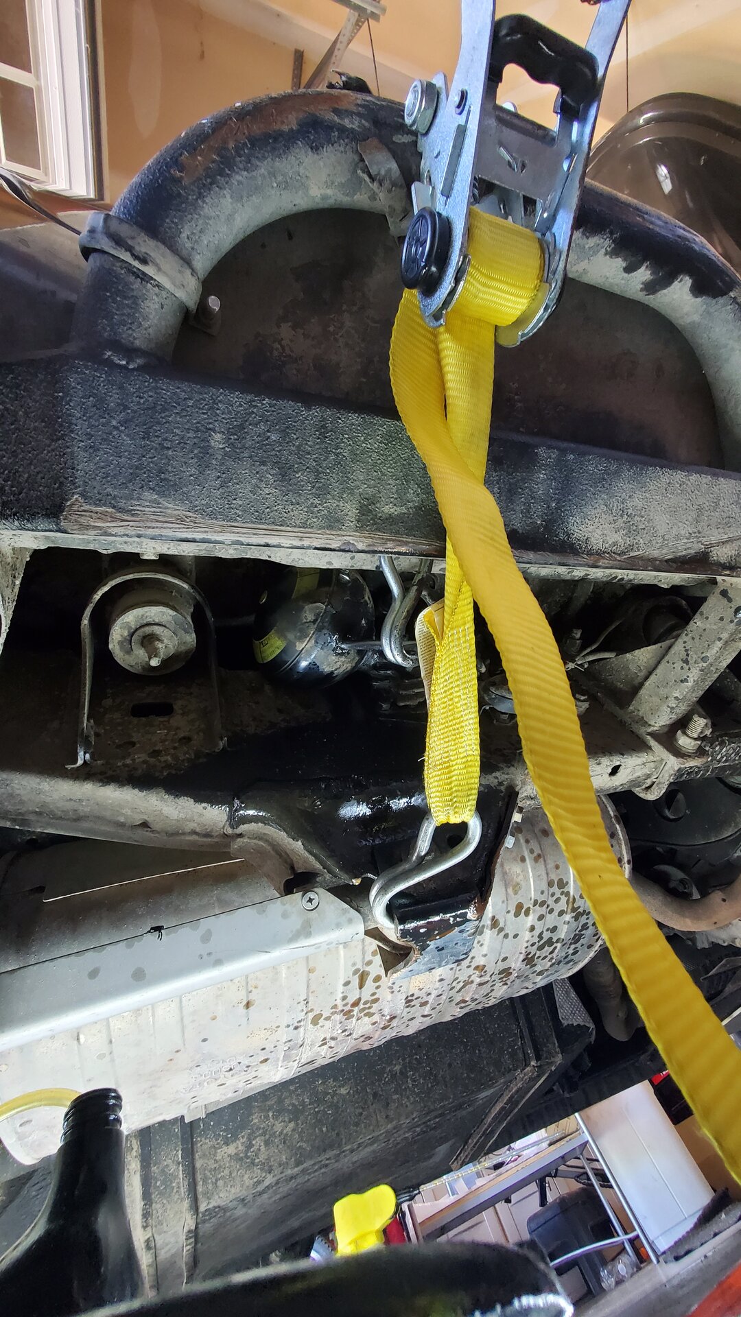

Glad yours came off easy. Mine were only about 2 years old and fought be hard! I ended up drilling a hole in it, then stuck a screw driver and used a ratchet strap to get it to move!

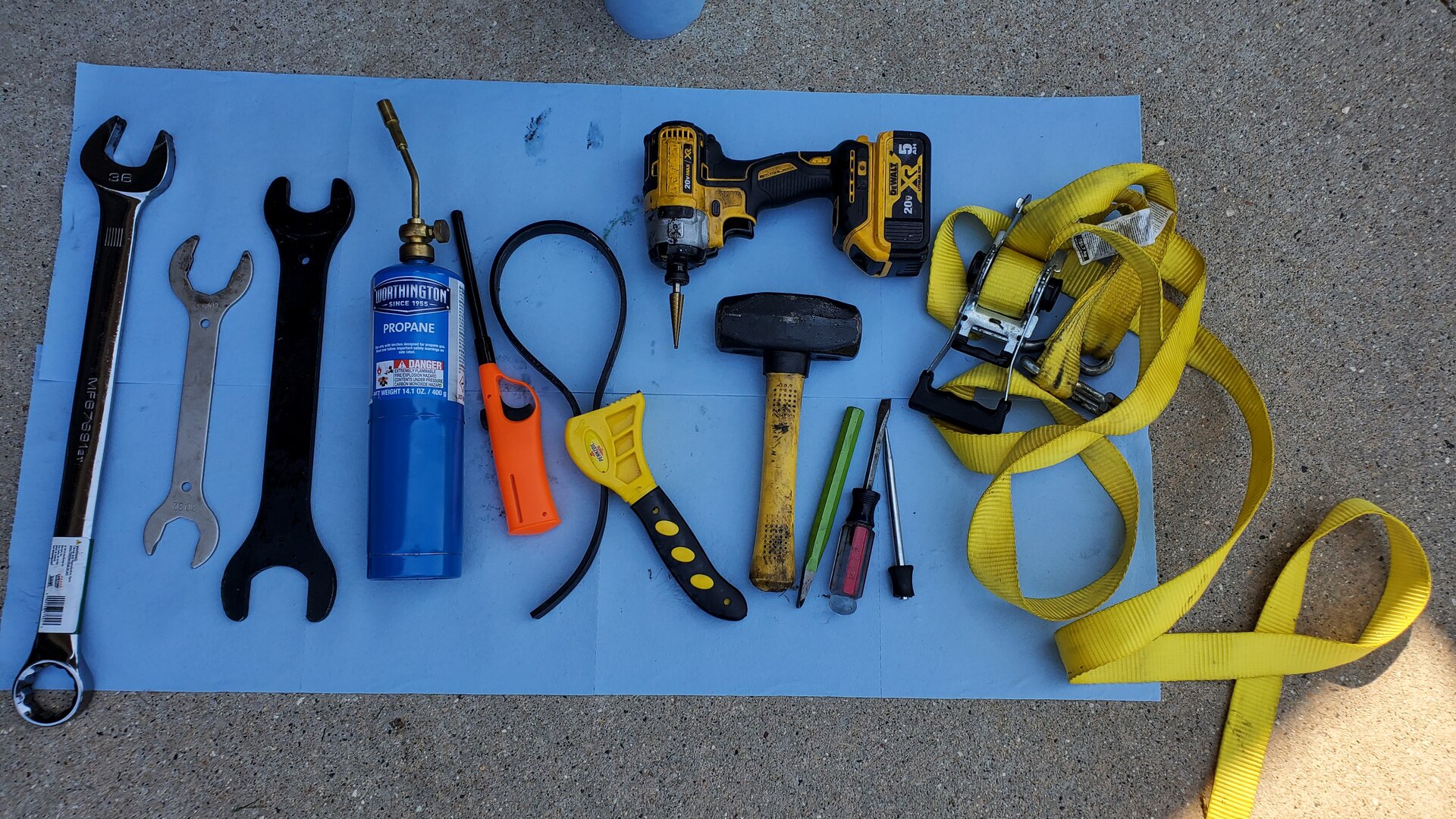

Order in which tools were used:
That looks brutal. I've been lucky because my LX470 spent most of its life in Florida so everything I've worked on so far has been very easy, at least in terms of removing the nuts and studs and bolts. Drilling a hole in the accumulators is a big step. No turning back once you do that!

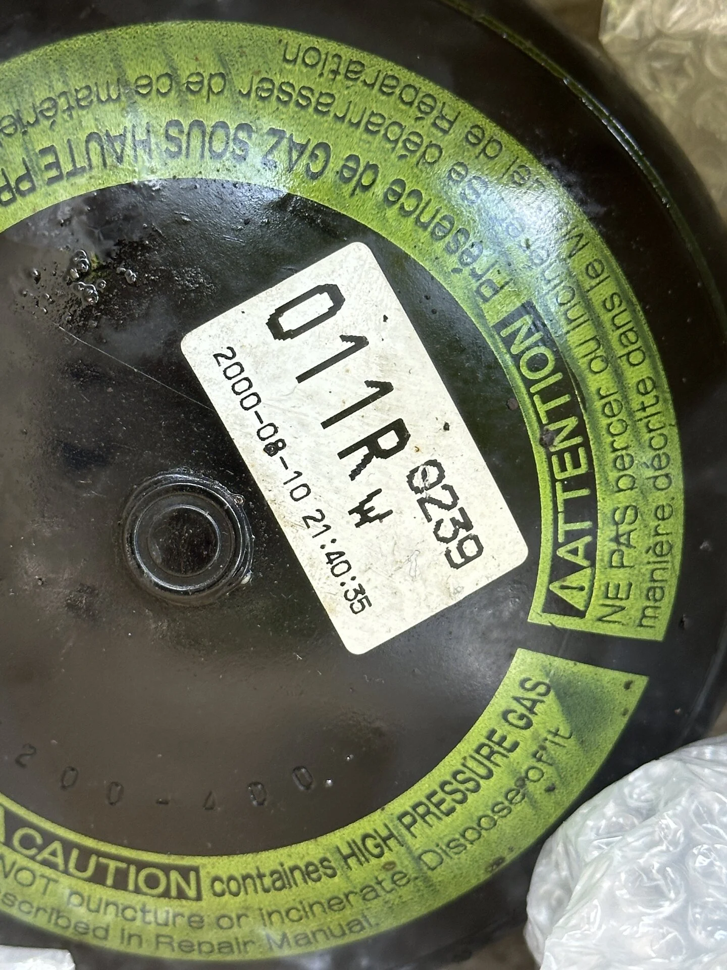

2001 LX470 with 250k miles. Sunbelt car (TX & CA) so not too rusty. The Globes that I took off matched the build date of the car, so yes, they were 22 years old.

Some ooooold globes in there:
