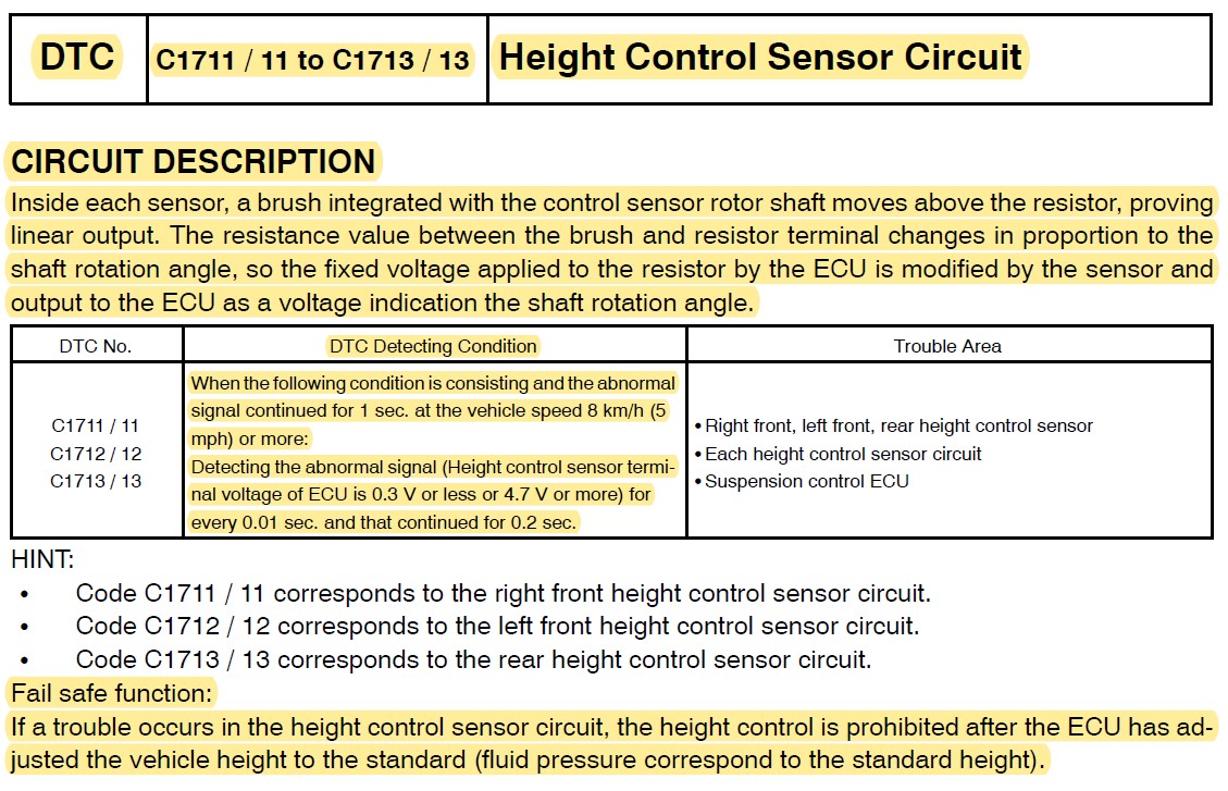

In this vein and with the experience now gained, it is worth another look at what the FSM has to say about the Height Control Sensors:
It can be seen that the ECU may not respond, and is designed not to respond, to excursions of short duration (such as a ‘bump’) outside the specified voltage range of 0.3 volts to 4.7 volts -- and the intended actual working range of the Height Control Sensor circuits is smaller than this limit -- FSM-specified as at 0.45 volts to 4.5 volts.
The ECU will respond to an “abnormal signal continued for 1 second at vehicle speed of 8 kph (5 mph) or more” AND the “abnormal signal …. is detected (checked) every 0.01 seconds …. and continued for 0.02 seconds”.
If the “DTC Detecting Condition” is reached, then the ECU will record a DTC code and also initiate the “Fail Safe Function” defined for this specific condition. The designer did not intend that the system be merely 'bumped' into 'fail-safe function' -- and certainly in my own experience the system has proven to be robust and reliable in very tough conditions, if the system is well-maintained.
As mentioned previously -- and as I suspect you are discovering -- if a fault that causes a signal of required duration, within the prescribed voltage range, but is the wrong signal for the actual height of the vehicle, then a DTC may not be recorded and the defined ‘fail safe function’ may not be initiated -- but a fault definitely is present. Such a fault would be due to the resistance within the Sensor being higher or lower than ‘as manufactured’ due to wear and tear, moisture, corrosion or whatever, or, by problems of resistance or poor continuity somewhere in the wiring harness, meaning the overall Height Control Sensor electrical circuit.
The Japanese-to-English translation suffers a bit in the FSM wording, but the gist of it is clear. It is also very clear that the ECU is very fussy about the signals received from each Height Control Sensor circuit. Resolving very different signals from different Sensor circuits will be problematic for the ECU at N height (or LO or HI height if selected at the console switch) and easily can result in strange behaviours of the AHC system, including strange Front and Rear heights adopted by the vehicle, with or without a DTC.
Toyota/Lexus tells us little or nothing about the internal hardware and software of their proprietary Suspension ECU and how it is built and programmed. All that can be done is to avoid speculation and make careful observations and look for actual data -- which is what you are now doing.
Hopefully your work on the actual Sensors and/or the Sensor circuits resolves the issues on your vehicle!

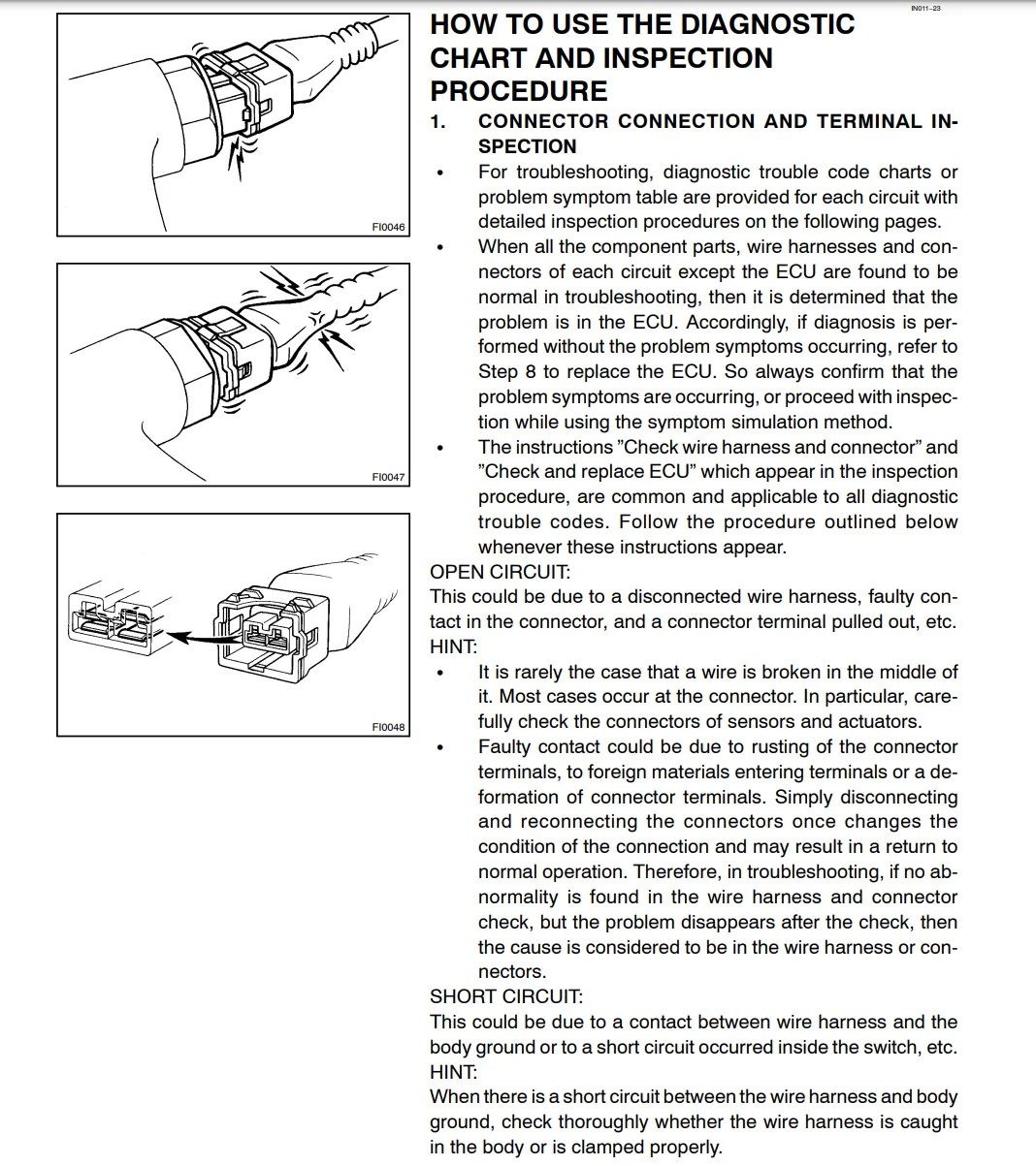

Probably been posted before but in reviewing the AHC diagnostics (from the service manual) posted previously by @IndroCruise, came across this:
Check for open and short circuit in harness and connector between height control sensor, fluid pressure sensor, fluid temp. sensor and suspension control ECU (See page INï35).
Referring back to that section of the manual, (attached pdf) it goes in detail over checking continuity, open circuits, short circuits. Still pretty daunting and right now I'm hoping it's just a connector/continuity problem!

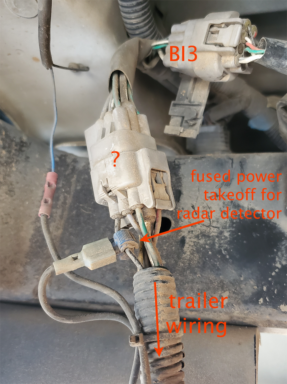

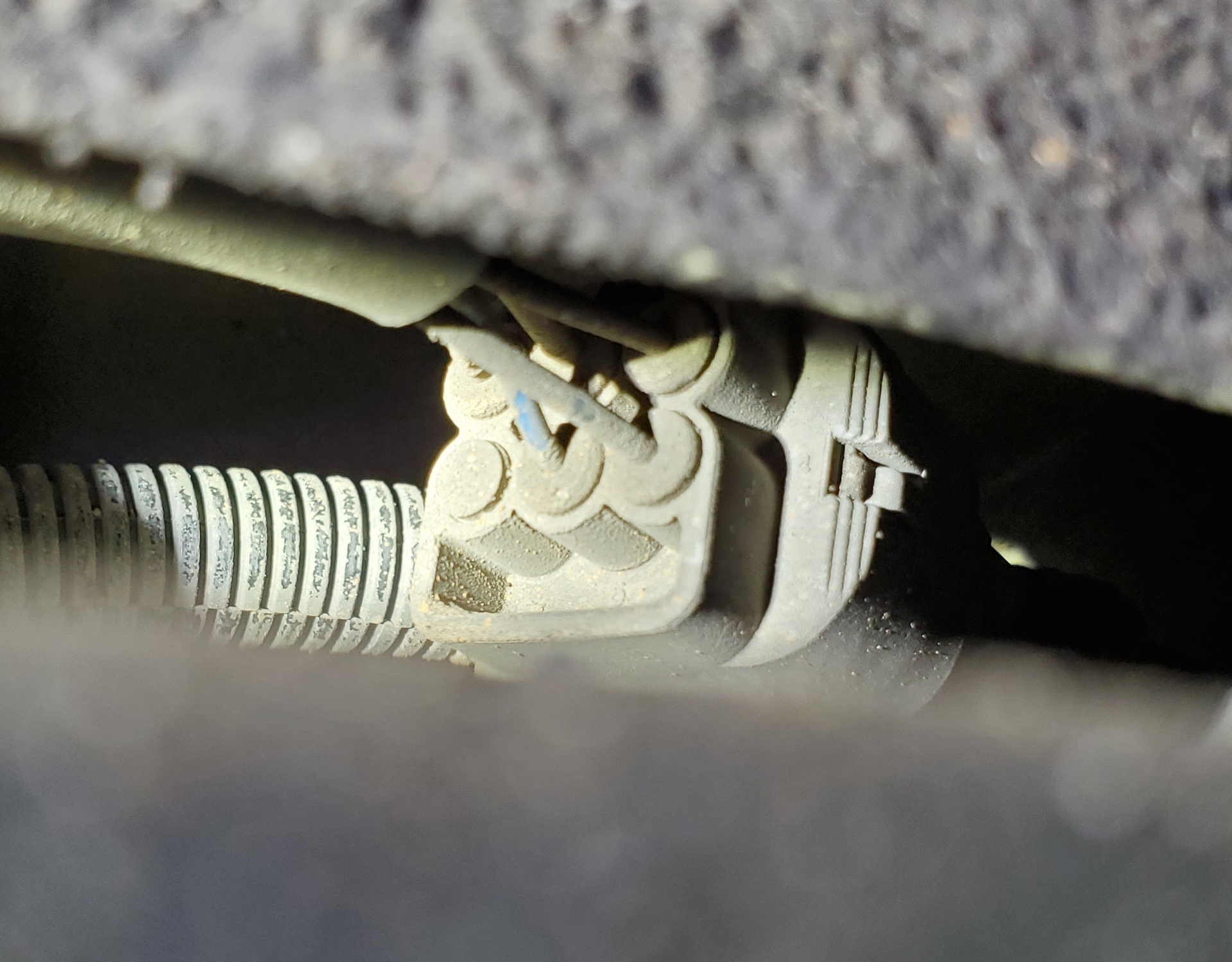

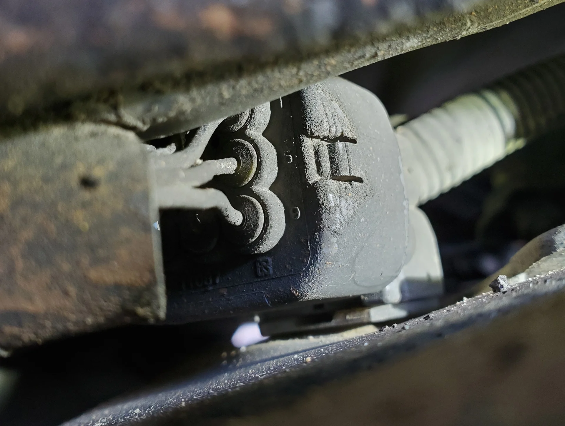

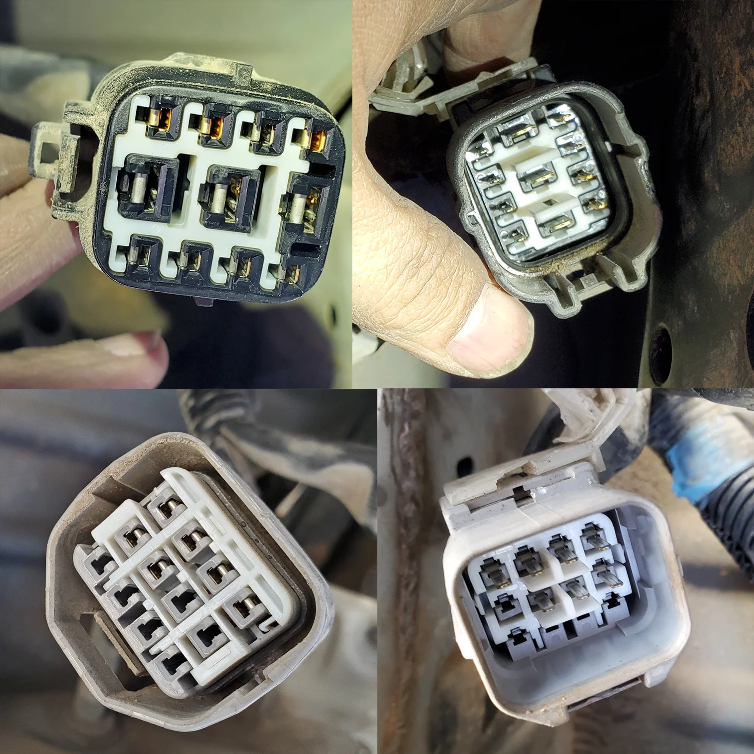

Well, I checked out BI1/BI2/BI3. I had a heck of a time prying them open. They all looked good. I was almost disappointed, I was hoping I'd finally find the culprit.
There is another unnamed connector right next to those three that in mine is used for trailer wiring and also for power for a 'K40' rear radar detector (came installed). Just putting this up in case you guys think this might be a problem (but I don't think so...).

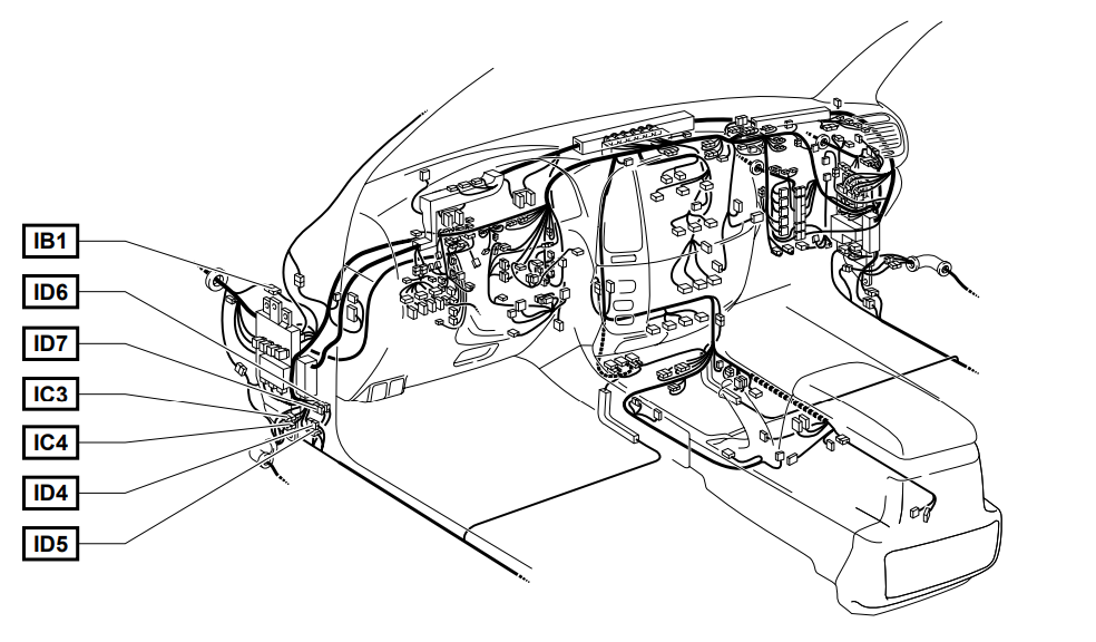

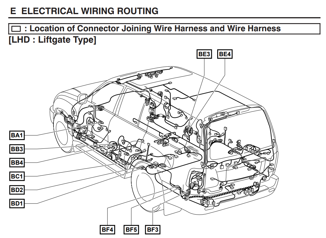

Also tried to find BG1/BG2. Felt along the top of the passenger side rail along the area of the exhaust, and didn't feel anything melted/fried.
BF3 is a blue connector in the cluster of wiring where the jack goes; I can see it but I held off on digging it out, looked tedious. I couldn't find BF4 or BF5.
Then BD1 and BD2 are grey connectors visible from the driver's rear wheel between the wheel well and the frame rail. Again, cables going to and from appeared okay but I held off on doing surgery on the wheel well in order to extricate the connectors.
I'm kind of stuck. I reseated BI1, BI2 and BI3, and it didn't fix my issue. I'm looking for some guidance in terms of what to actually investigate and how...

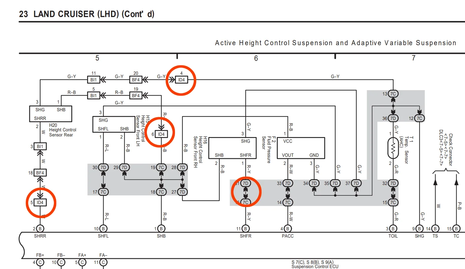

The reason I was looking at all these connectors (BG1/2, BF1/3/4/5, BD1/2, ID6) is because they are upstream/downstream of BI1/BI2 and also most of the AHC system, and were implicated in previous posts. But most are related to the damping force control, not the sensors. I was wondering if it would be better to check the ones that are way upstream of the sensors, such as ID4, which pops up in the sensor circuits prior to connecting to the Suspension Control ECU, or the 7C/7D relay, which is also part of these same circuits. These also have the benefit of being more accessible..
Looks like ID4 is in the left kick panel. Relay 7C/7D behind the glovebox.
@IndroCruise or @uHu (or @PADDO ?) am I on the right track? Where would you suggest starting to check for continuity? All the way from from BI1/BI2, or the sensors, to ID4 and relay 7? (Suddenly throwing a few hundred at new Aisin sensors 'just in case' is looking like a better option than testing circuits. But it certainly seems like the sensors themselves are fine...)

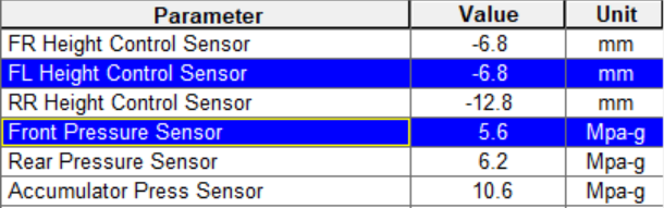

On testing for AHC pressures, or simply checking ‘ride heights’, the vehicle refuses to return to the null position at N after N > LO > N test movements.
Instead, Height Control Sensor readings on Techstream are not near zero, instead readings settle after driving to:
FR = negative 6.8 millimetres
FL = negative 6.8 millimetres
Rear = negative 12.8 millimetres
and ‘ride heights’ settle to
Front Hub-to-Fender Height = ~19.25 inches (equal both sides)
Rear Hub-to-Fender Height = ~19.75 inches (equal both sides)
(with some variation between tests of up to +/- one-eighth (0.125) inch)
Front AHC pressure after attempted N > LO > N = 5.6 Mpa
Front AHC pressure after attempted N > LO > N = 6.2 Mpa
Raise time: L>N = 19 seconds, with a total of 38 seconds of 'pump noise'
Raise time: N>H = 7 seconds, with total of 16 seconds of 'pump noise’.
Difference in AHC Fluid levels at AHC Tank, HI to LO = 10+ graduations
(this reading is a guide only -- may not have been taken at conforming AHC pressures)
Other details on Techstream screenshots (where provided) after N > LO > N appear normal.

Locating, opening, inspecting and closing connectors in the Height Control Sensor circuits such as BI1 and BI2 is a very good thing to have done.
May I very respectfully suggest that this is necessary but insufficient -- because a clean connector is encouraging but that is not enough to “certify” the Height Control Sensor circuit.
By itself this does not tell whether there is/are broken or damaged wire(s) somewhere on either side of any junction causing problems with continuity, resistance or voltage in the circuit -- and ultimately causing incorrect signals to the Suspension ECU and resulting in the problem behaviour of the vehicle.
May I now suggest that the search for broken or damaged wires requires further action -- including methodical testing as set out in the FSM attachment added by @usedname at Post# 404 (added again below for convenience). In effect, Section 1 of this procedure has been done – even more important are sections 2, 3, 4, 5, 6, 7 and ultimately section 8. (It would be easy to jump to a conclusion that there is an ECU problem -- but I would recommend arriving carefully and methodically at that conclusion.
The last thing wanted is to install replacement parts only to endure an unchanged problem because the cause is elsewhere. How do I know this? Because without checking out the circuits, I replaced all three Height Control Sensors on my vehicle in the hope of chasing down a similar fault and also because the Sensors were old and I wanted long term reliability – good idea, good long term maintenance, no regrets -- but it made no difference to the Height Control problem I was chasing at that time!!!!
Where to do next?
Subject to better advice from others,
my suggestion is to start at the harness plug at the connector at the each Height Control Sensor itself and work towards the Suspension ECU, firstly testing the overall circuits between these two points for each of the three Sensor circuits -- and if a fault is indicated in any circuit, then test at each junction, step by step, as you go from the Sensor to the ECU -- and sadly this does include the pain of reopening BI1 and BI2.
You could go the other way -- from the ECU back to the to each Sensor. My instinct would be to check the most exposed parts of each circuit first – it would be supremely unlucky to have developed a fault in protected positions such as behind the front internal kick panels (for example connector ID4 as mentioned) and in the dashboard (for example connector, not a relay, 7C/7D as mentioned), unless previous work has dislodged something or unless the relevant junction boxes have been affected by a water leak or other accidental damage.
My instinct also would be to focus on “certifying” all three Height Control Sensor circuits, from each Sensor to the ECU, before branching out to other circuits.
I may well be missing something -- or not according enough attention to other possible causes of the symptoms and data listed far above -- hopefully, others will offer thoughts and corrections if that is the case.

Huh, didn't think about the utility of BI1 in that way - a lot of the signals that end up at the AHC ECU go through there. Including the rear height sensor, but unfortunately or fortunately, not the front height sensors.
NO current codes or other symptoms, aside from, I suspect, a rougher ride than the AHC usually provides over smaller bumps.

Mmmmmm -- I think I would suggest that all three Height Control Sensor circuits can be accessed via BI1 albeit the pathway passes via various other connectors along the way -- unless I am misreading the attached 2006 LC100 two-page EWD for AHC.
I do have to agree that a coloured version of the EWD would be a great deal easier!! As far as I know, AHC/TEMS wiring is common to both LX470 and LC100 (where AHC/TEMS is fitted) -- but just to be sure, if ever required, it would best to hang out for the appropriate LX470 EWD for your model year and/or meanwhile see whether @suprarx7nut or others might be willing to scan the appropriate EWD pages.
As you know, I started out pointing to the Sensors themselves -- especially the Rear Sensor which seemed most wayward to me -- but accepted your testing of all three Sensors per the FSM battery method -- particularly given that I had myself replaced all three Sensors with new OEM parts on my vehicle but without good effect, when faced with a similar problem.
In any case, for a vehicle of 17 years of age and service, replacing the Sensors certainly is in your future even if they are working now. They are 'wear items'. Obviously, deferring expense until really necessary is a good idea -- but @suprarx7nut is persuasive as always, and replacement is not going to be a waste of money if it is your plan to keep this relatively young vehicle, 2006 LX470 with a very low ~130,000 (?) miles, and retain AHC/TEMS.
Anyway, 'due diligence' has been done and a decision has been made -- hope all goes well!! :cheers:
Mmmmmm -- I think I would suggest that all three Height Control Sensor circuits can be accessed via BI1 albeit the conductor passes via various other connectors along the way -- unless I am misreading the attached 2006 LC100 two-page EWD for AHC.
Hah I don't know if it's due diligence or wishful thinking on my part. Stepping back it looks like you as well as a couple other forum experts have said to throw a new sensor at it, and perhaps I should have listened sooner! Will update once I have more data or a fully functional system.
Edit: I'm using that same EWD and I don't see where the front sensors go through BI1/2. They connect to the ECU pins SHFL and SHFR, and their only other connections are to junction box 5 (for SHB which I think is power?), and ground (also through JB5).

I checked if 'F/R wheel steps' changes as I'm riding around, and it does. The numbers are highly variable as I drive, and seem to be affected by the damping mode. I assume this is normal.
Also of note, when in Active Test mode, I couldn't get the car to rise or fall in Comfort mode, but I could in Comfort+ and Sport+. The buttons did different things in each mode. I thought perhaps that means there is something wrong with the damping mode switch, but in Techstream the 'Damping Force Switch 1/2' both change appropriately according to the four modes.
Everything is still working. Car just refuses to go back to the right height. Rear is still -13mm.

WOW, must be rusted to the frame!
I finally got the 4th globe on today.
You gave me a clue when you said 2 bolts and 1 nut holding the whole assembly to the frame. I found the second bolt on top of the frame UNDER the exhaust shield.
Well I got the assembly off, put the globe in a bench vice and used a giant pipe wrench on it. Man it was on there!
Now it's all put back together and bled. I'm getting like 17 graduations. My heights are off but I'll work on it tomorrow.
