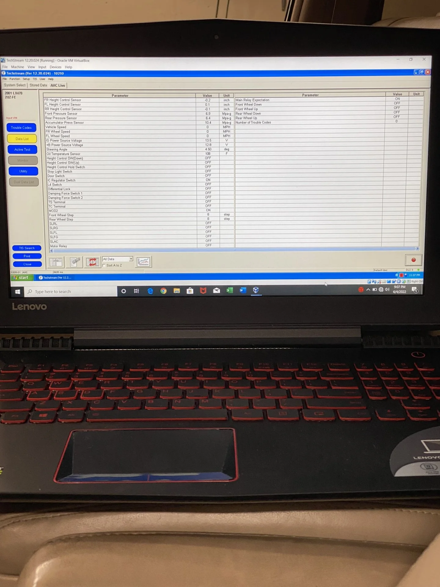

Would it be normal to have to only re-index one torsion bar?
My 98 LX had the left side about an inch lower than the right, so I finally got around to fix this after much reading on how to do this correctly. Truck has 270k km on it, PO did minimal service at the local Lexus dealer (regular fluid changes (AHC about 50k km ago), but only fixed items when the car wouldn't run.
The left linkage was seized and not securely connected on the top bracket which gave random incorrect readings most of the time, so I ordered a new one and started once it arrived.
- With AHC off, I adjusted torsion bars to level out the front. Required tightening the left side 8 turns and loosening the right side 9 turns.
- Adjusted linkages to have Techstream report height sensors 0 to -.1 when at N. Measurements at N were 19.7 inches hub centre to fender lip.
- Checked graduations, there were 9 graduations when going from H to L.
- For pressures, they ended up at 8.2 front, 6.8 rear, and 10.6 acc. The front is quite high, so it looks like I will need to tighten the torsion bars about 8 turns to bring the pressure down to spec. There are only about 4 turns left to tighten the left, so I will need to re-index.

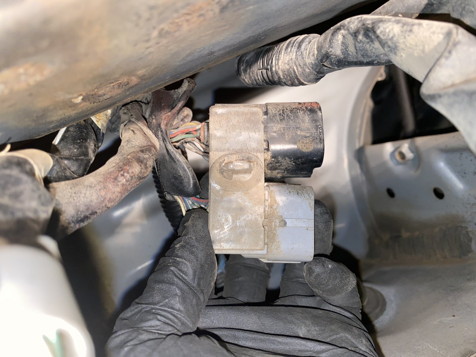

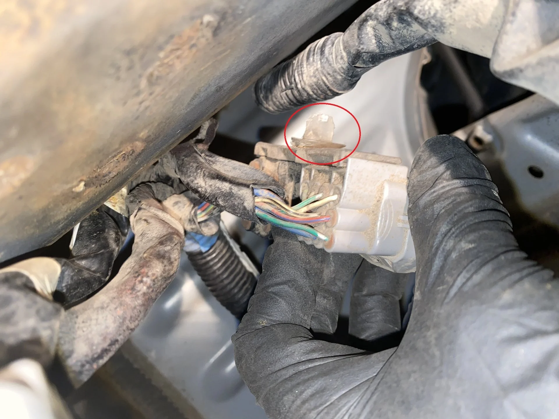

Here's what I'm working on now, a troublesome case of AHC in fail safe (flashing off), on a 01LX w/~150K miles rust free:
It's AHC failed last year and was driven on for months in fail safe with a very bouncy ride, from what I understand.
It then came to me and I found DTC:
C1736 Accumulator Solenoid Circuit,
C1762 Abnormal Oil pressure pump.
The diagnostic tree lead me to AHC CPU, which I ended up not testing at that time. I had spoken with you Andy, on a similar case you had. In which you found a dead wire. Which I understood to be in harness on top of the LH rear 1/4 frame. Which until you found it, I didn't realize the AHC wires ran that far back of rear height sensor.
Anyhow, after disconnecting and reconnecting the LH rear 1/4 wire harness wire housing block. I got some results in AHC, in that it worked again, but failed again. Once I did get working, the rear was high. I messed with rear sensor and got it working better, but still rear was high. I ended up, replacing rear sensor adjuster arm, which found the ball joints frozen. It did not help a height come down. So I tossed in a "used" rear height sensor. Now system work fine, rear height came down to normal in N. I ended finding all 3 height sensor linking/adjusting arms balls frozen and replaced all 3 arms. AHC worked repeatedly in the shop.

Interesting: Every time I went into active test through tech stream, when last working. The moment I activate any test, system would shut down, go back to safe mode.
I can not get system out of fail safe (flashing off) any more. And have since, replaced front globes and bleed fluid off (no air bubbles). I'm now on the bump stops more or less.

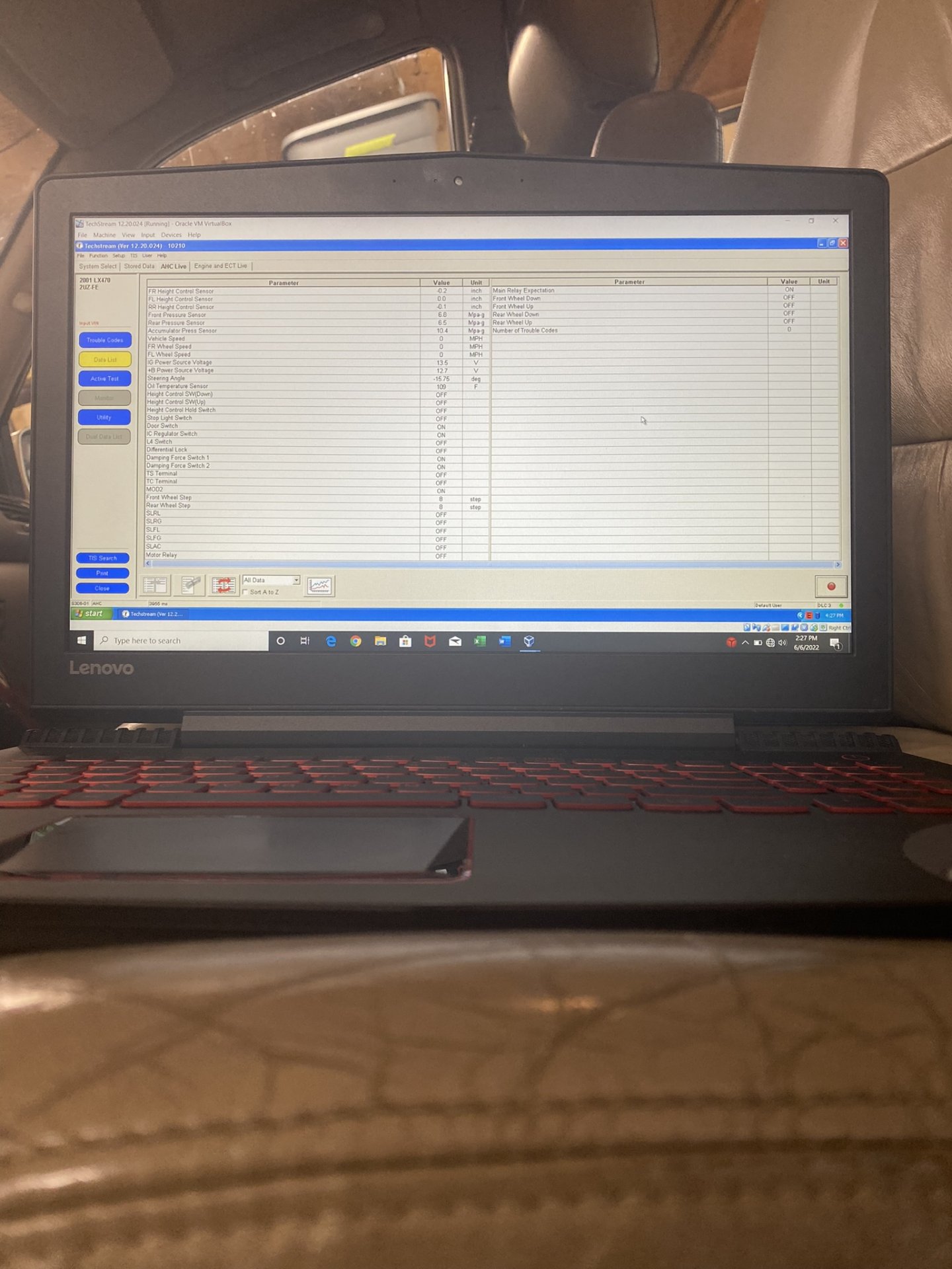

AHC CPU SHB & SHG value below limit of ~5 Volt at 3.41V during a test. I hooked up another AHC computer, which reads within spec voltage, 5 volts. So I assume good as was advertised.
System will not clear DTC of C1736 and C1776, and not come out of safe mode.
Any thoughts guys and whats going on here?
Could it be contamination and/or blocked pipes? Jumping pressure & C1736 Accumulator Solenoid Circuit sounds suspicious. C1765 is a catch all for when the system can't get to pressure immediately or over pressurises. Or maybe bad wiring? Aftermarket wiring for radio is another suspect.
AHC CPU SHB & SHG value below limit of ~5 Volt at 3.41V, while OK with another ECU is a different pretty big red flag.

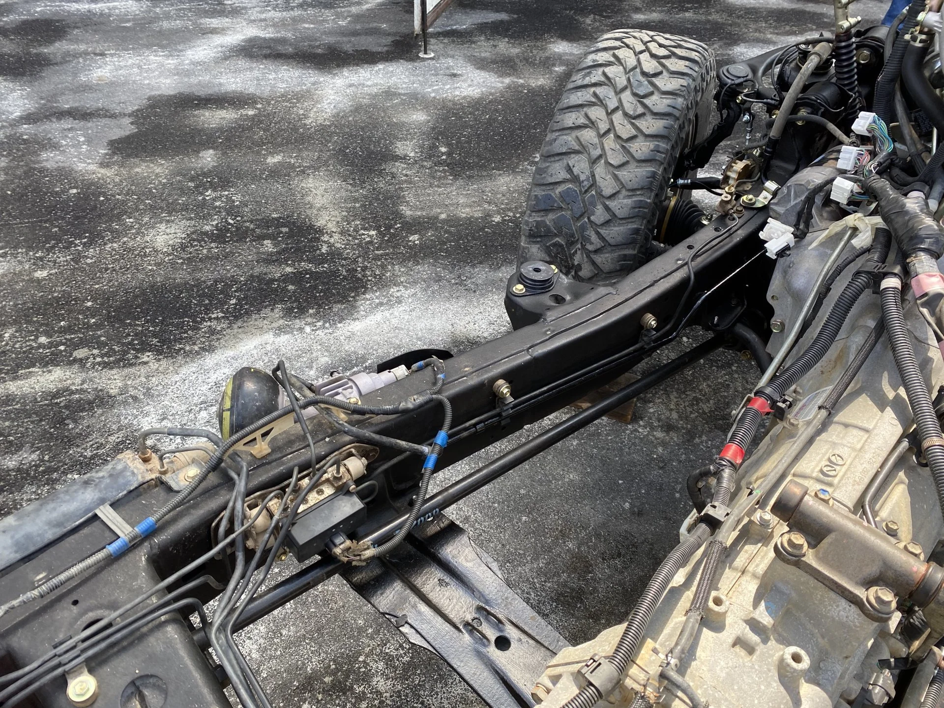

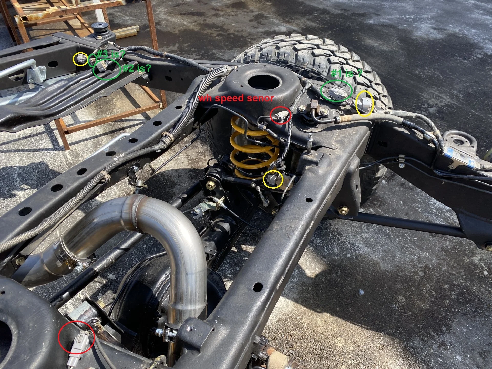

Wires go all the way to the back, because there is a grommet back there for the wires to come out of the cabin. There are very few grommets for wires to leave the cab in fact.
Here are a few photos of the AHC harness from my chassis galvanisation adventure. You can see the harness coming from the rear terminates at the FL globe and the solenoid block
And this is where the harness connects to the harness coming out of the cab, splitting to the right side and also connecting to the rear sensor. It goes forward to the RL globe and then the FL and solenoids
You can check for continuity between the AHC ECU and the plugs in the rear and at the solenoids.
Thanks @Moridinbg. I've followed you thread on your frame off restoration. Kudos to you my friend, it is some great work you've done!
Love the pictures. They are really helpful, for me to visualize. So I should be able to check continuity between CPU and the wire housing blocks (plug) at rear 1/4. Than rear 1/4 plug to H. senors rear, controller, globes and accumulator. BTW: I did do the FSM prescribed check/test at controller and accumulator wire housings. They tested to spec (Okay).
I'd not consider blockage in pipe(s), just pump. I'll see if I can raise by jumping pump w/12V. I may also pull a pipe flare at controller and see if it flow out, while pumping.
Another thought just came to me, because of another thread. Where it was just posted a new pump cured. Old pump not clogged, but he seem to think old was overheating fluid. Hummm! Not sure this would explain, why my front pressure keep going up. But I did suspect I was get fluid to hot to fast.

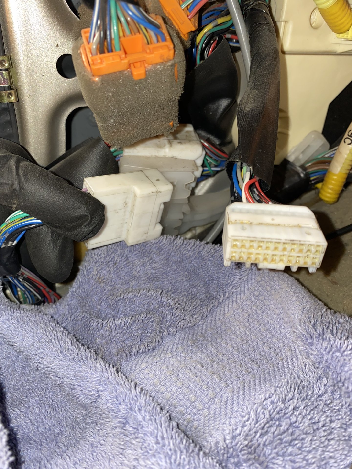

I should have also mention this 01LX, has had electrical issue in the distant pasted (1st few years after build date). Seems mirror CPU changed twice. By two different Lexus dealerships years and states apart. Mirrors and steering tele, not functioning again. No history or signs of water entry. That and failure just after new aftermarket wiring, has me concerned.
Can you confirm: I've circled all the AHC wire housing blocks in this picture?
I've circled in red what I think is LH & RH wheel speed sensor, can you confirm?
Also can you tell me what wire housing blocks (plugs) # 1, # 2 and #3 circled in green are for?

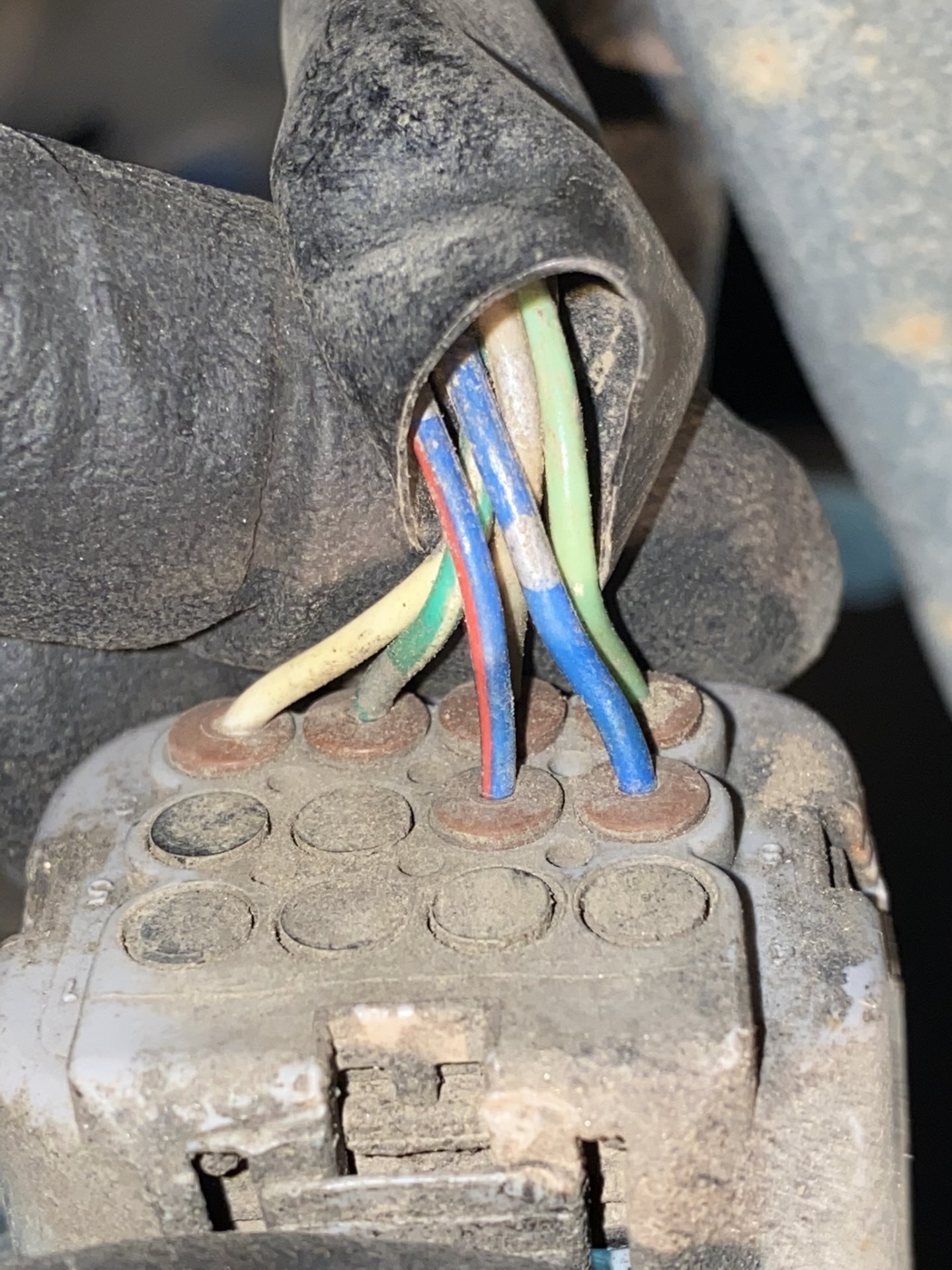

I'd put money on it that you've got a bad conductor (wire) in the AHC system. Given my experience, I'd double down on my bet that the problem is in that section of wire that runs to/from the rear 1/4 on the driver's side.
Have you checked resistance of the accum solenoid at the solenoid and then again at the terminals within the connector in the rear 1/4 (B1 I think)? And then again at the ECU (this plug is a huge pain so don't go this far unless all other resistances look good)? I bet the resistance checks will reveal a bad reading at one of the junctions. Then the task becomes simpler (not necessarily easy, but simple). I've got wiring diagrams for the early and late model years. Happy to post up some pics if that would help you chase after that bad conductor.
Your situation sounds very similar to the one I worked on last year. All it takes is one bad section of wire to give both the codes you're seeing. Once the system detects that solenoid is MIA, you're completely dead in the water. The system goes into safe mode and disallows most AHC functions and tests.
Keep it simple and chase the wire that's causing that C1736 code.

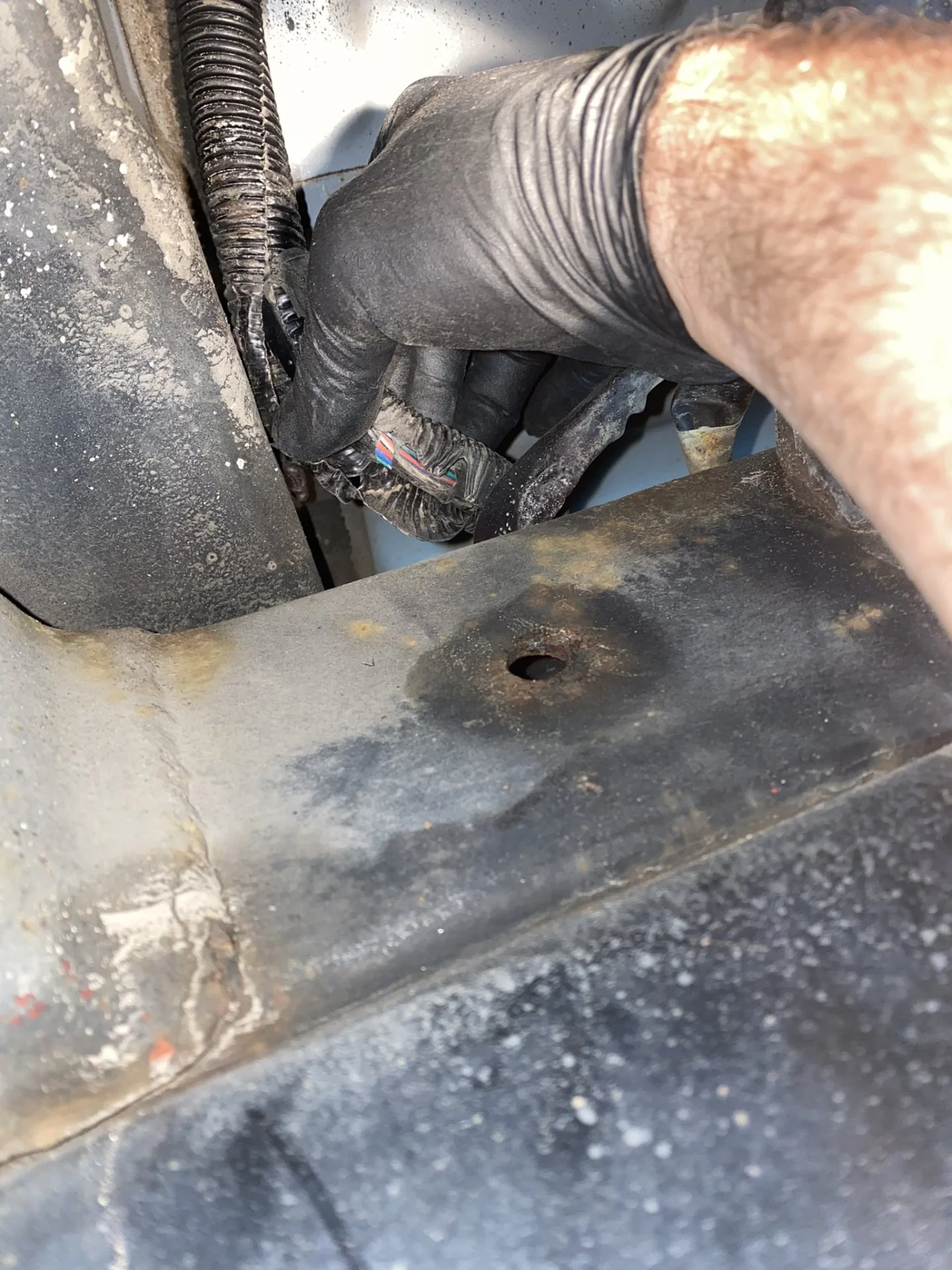

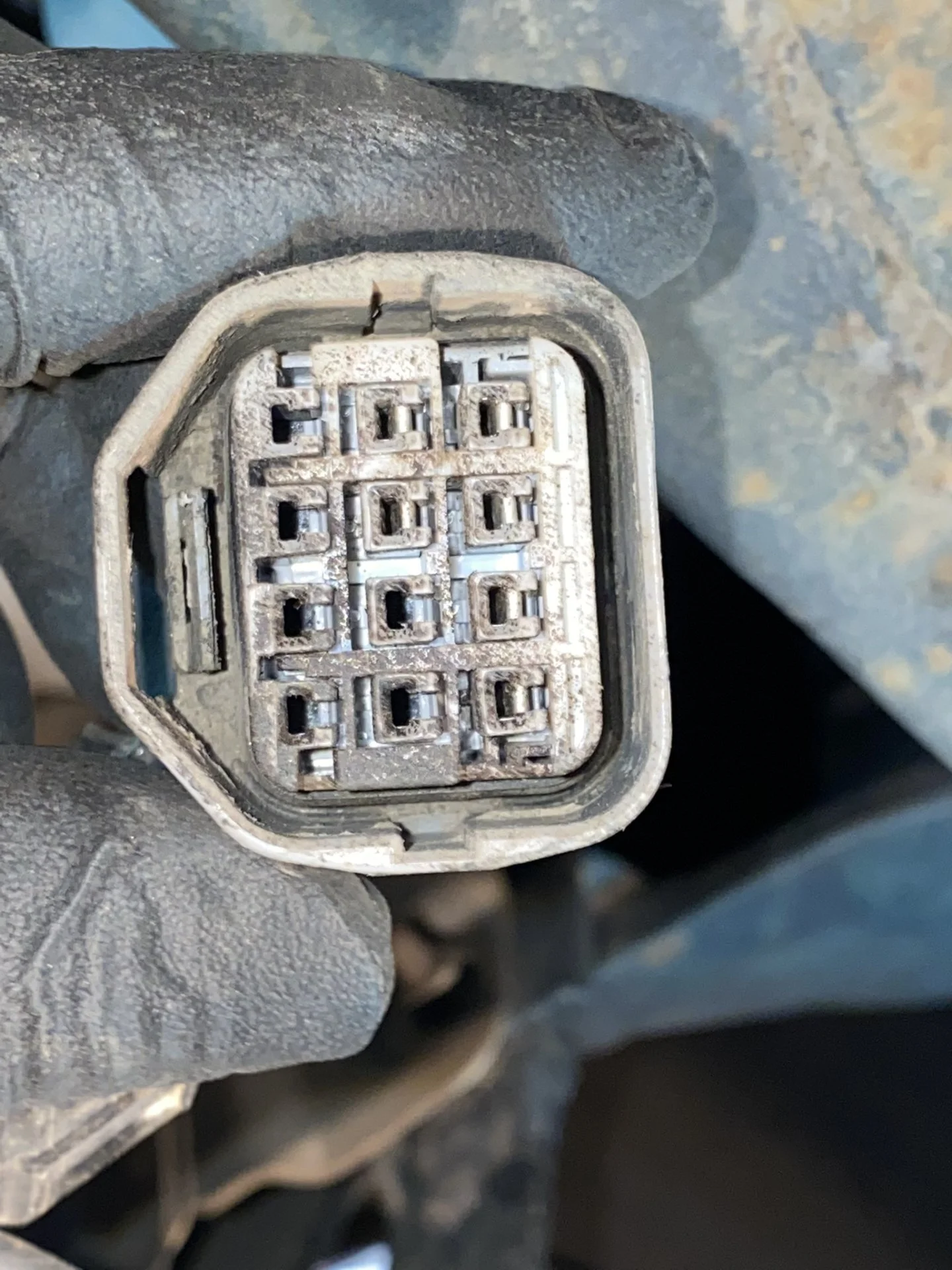

I've got it working again! :) :hmm:
To answer your question Andy. I did check the continuity of accumulator and it's wires. I also the controller and it's wires. I've now checked continuity from CPU (new/used AHC CPU, which test good) to rear 1/4, and on to rear height sensor, accumulator and controller. In addition to checking many other points of AHC system, while following diagnostic tree based on various DTC I've had and suggestion from the forum. To many list, much less remember. It has been the most extensive diagnostic work I've done on any single 100 series AHC. Yet I can't say for sure, why it now works "again"?
A little what did last few days:
To gain accesses to rear wires under vehicle. Which vehicle was sitting on the bump stop. Due to me draining AHC fluid from globe bleeders. So I could check for air and replacing front globes as a test. I did this due to declining front pressure, which had me cranking CW on torsion bars repeatedly. Repeatedly, to keep getting front pressure back in line (front keep going from ~6.9 to ~8.5MPa). I lifted the rear of vehicle and sat jack-stands under rear frame rails. Allowing rear wheels to hang freely. Consequently, fully extending rear height sensors (the used one I installed 2,500 miles ago). I then pulled all 3 wire housing blocks from under 1/4 tip, controller, accumulator and rear height sensors.
With all wire housing blocks disconnected. I studied wire color codes, tracing which went where. Checking continuity as I did. Interesting I found the wire block with longer wire housings, separably mounted from other two on the frame. The one I had though was the main AHC wire housing block. Because it was only one I disconnecting, giving me results 2,500 miles ago. Was not! It was the two wire housing blocks, one black one gray mounted on same bracket together on frame. The black block, housed all the wires to accumulator, controller & rear high sensor except one. That one, was the Blue/red to accumulator from the gray housing block.
This gray wire housing block female plug, plugs to gray male mounted with the black housing block on one bracket mounting it to the frame. Had the one Blue/red wire to accumulator.
Looked like water enter at some point and kind had a moldy appearance. Which is interesting since the C1736 DTC, does deal with accumulator.
The gray wire housing block plug
The gray & black female wire housing blocks on one bracket, coming out from rear 1/4 cargo area
Wire housing blocks just inside LH drivers foot well. Near floor board and door threshold.
I cleaned the wire housing blocks with HP air and plastic safe spray contact cleaner. Added some dielectric grease to help lube and seal out water. I went on checking continuity. I did not check from CPU to the accumulator, until after cleaning this gray wire housing block. Had I, it likely would have test okay. But a may have failed a resistance test, with high resistance. If I even knew what the resistance should be, which I don't.
Anyway it is working at the moment. I can't say for certain why. I think is was a combination of issues. Which has been the story with this 100 series, on other electrical issues also. It's had, other (non AHC) electrical issue going back 20 years in it's history.

Unplugging, cleaning and reconnecting the many wire housing blocks. Most notably the the gray moldy one.
A combination of the above.
I suspect the gray wire housing block increasing resistance. That perhaps that had some cause and affect on AHC CPU, damaging it. That the CPU was effecting the front pressure reading in tech stream. Which means the old globes are likely good. Which I'll be take on test drive than likely swap back in the old globes. I'm still concern the height sensors have seen better days. So sensor refresh is likely in the cards. But I liked to see how the system preforms over the summer. Before putting more money (time & parts into it).

Here's readings in tech stream, before test driving and settling suspension:
Note: +B power source 12.8 volts, is bit lower than IG. But much better than when it was in fail-safe. I'm really not sure of what I should see in volts. Should I match IC volts, be above or below with +B?
Temp seem good at 103F, after about 10 cycling L to H, over 20 minutes. I saw in another thread where supposed bad pump, temp hitting near 180F. So I'm hopeful, the bad pump and accumulator TSB, is not a part of this rig issues. But it is in the date range of TSB.
No Codes.
No Codes.

There was something else on harness I noticed. It was what looked like heat damage on wire harness outer wrapping (Wire Loom Tubing - Split).
Wire harness at rear 1/4. Looks like heat damage, but wires inside seemed okay. At least I couldn't see any wire damage.
Even the 2 (1 at duel block hanger and 1 at single block holder) plastic clips holding harness on frame, were brittle and falling apart. Not what I'd expect on a clean 150K 01LX mostly garaged and rust free. I did strap the harness to the frame. Since these clips weren't very securing well in current condition. Which should keep from bouncing around.
