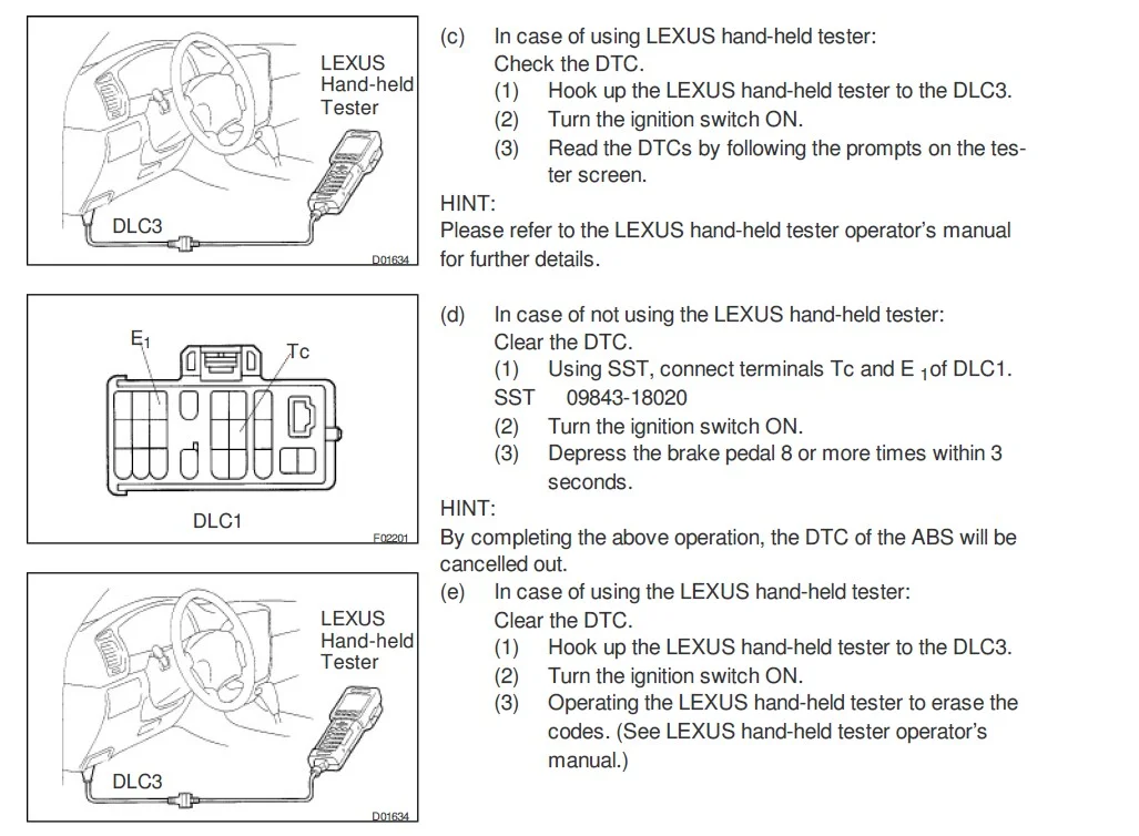

Suggest first clear the DTC’s so that you can be sure of which ones are current, not historical DTC’s from some previous condition, and then proceed from there. Your listing shows an unusual mix of DTC's and identities -- so suspect that clearing DTC's may resolve this confusion.
There are several methods to clear DTC’s:
  • Use Techstream,
  • Use the ‘manual’ DLC 1 method,
  • Use the ‘manual’ DLC3 method
(Toyota/Lexus Special Service Tool SST 09843-18020 is a simple connector, can be replaced with any suitable alternative, including an unbent paperclip).
Method using DLC1:
Method using DLC3:
After clearing, re-start system -- suggest engine OFF, then ON and maybe drive around the block to ensure that you are looking at current DTC's.
Thank you, I cleared the DTCs using DLC3, and then drove around, switched damping modes, and cycled the height. I then rechecked the codes, they have not recurred. If they happen again then I'd have to pay attention to them, but I really think it was related to running the car with BI1/2 disconnected.

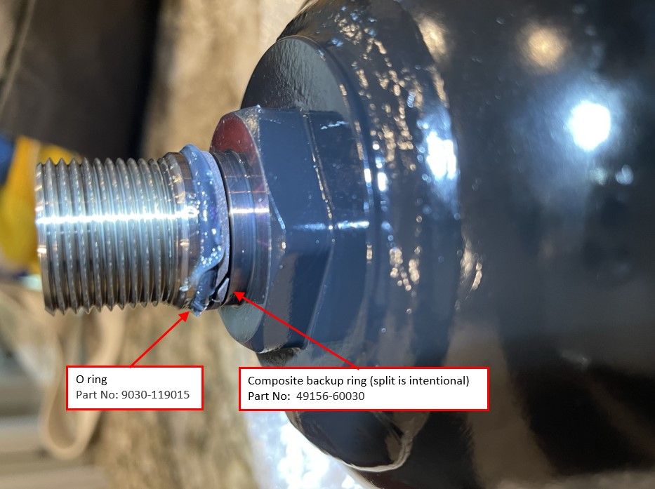

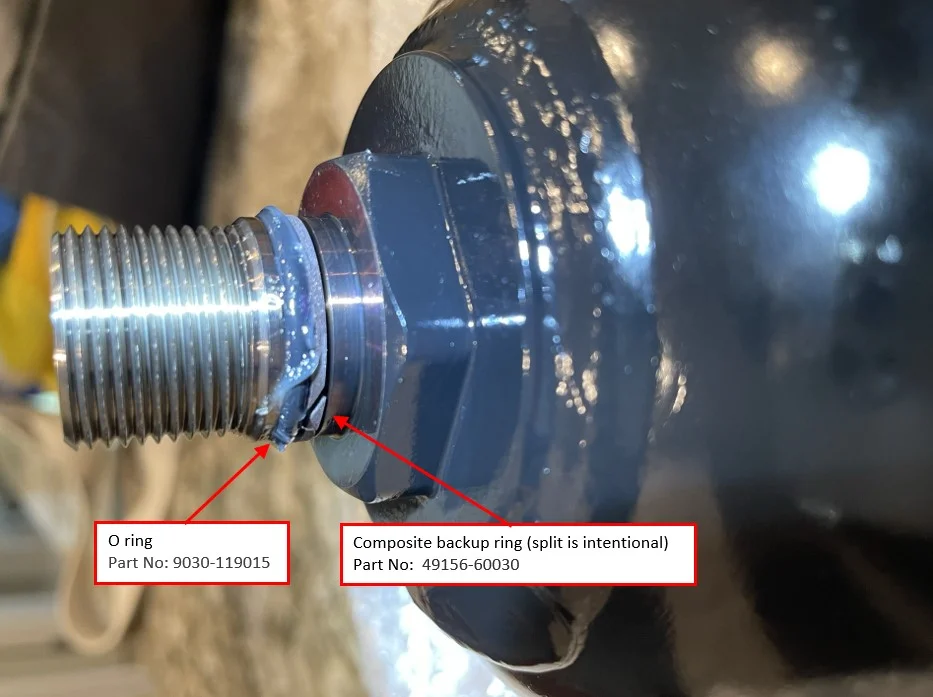

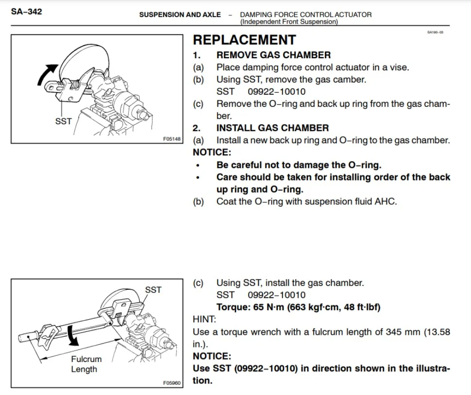

I finally got the 4th globe on today.

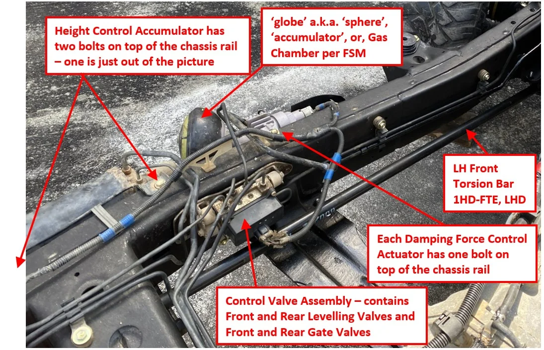

You gave me a clue when you said 2 bolts and 1 nut holding the whole assembly to the frame. I found the second bolt on top of the frame UNDER the exhaust shield.
Well I got the assembly off, put the globe in a bench vice and used a giant pipe wrench on it. Man it was on there!
Now it's all put back together and bled. I'm getting like 17 graduations. My heights are off but I'll work on it tomorrow.
You have nailed it @TreatSmash :cheers:
I just thought I would add a few pictures which may help anyone else who comes this way ....
Picture credit: @Moridinbg ; Labels: @IndroCruise
Picture credit: FSM; Labels: @IndroCruise
FSM Extract: 'Globe' a.k.a. Gas Chamber in FSM -- just as described by @TreatSmash , removal of 'globe' is only done this way if it is too difficult to remove 'globe' while it is in place on the vehicle!!
Picture credit: Unknown; Labels: @IndroCruise -- shows correct order of o-ring and hard back-up ring -- both usually factory-fitted to the 'globe' before delivery -- split is intended to ease fitting of back-up ring which is made of hard brittle material, not flexible -- the gap closes when 'globe' is fitted to Damping Force Control Actuator. (Late edit: More detail about back-up rings can be found at Backup Rings | Global O-Ring and Seal - https://www.globaloring.com/backup-rings// )

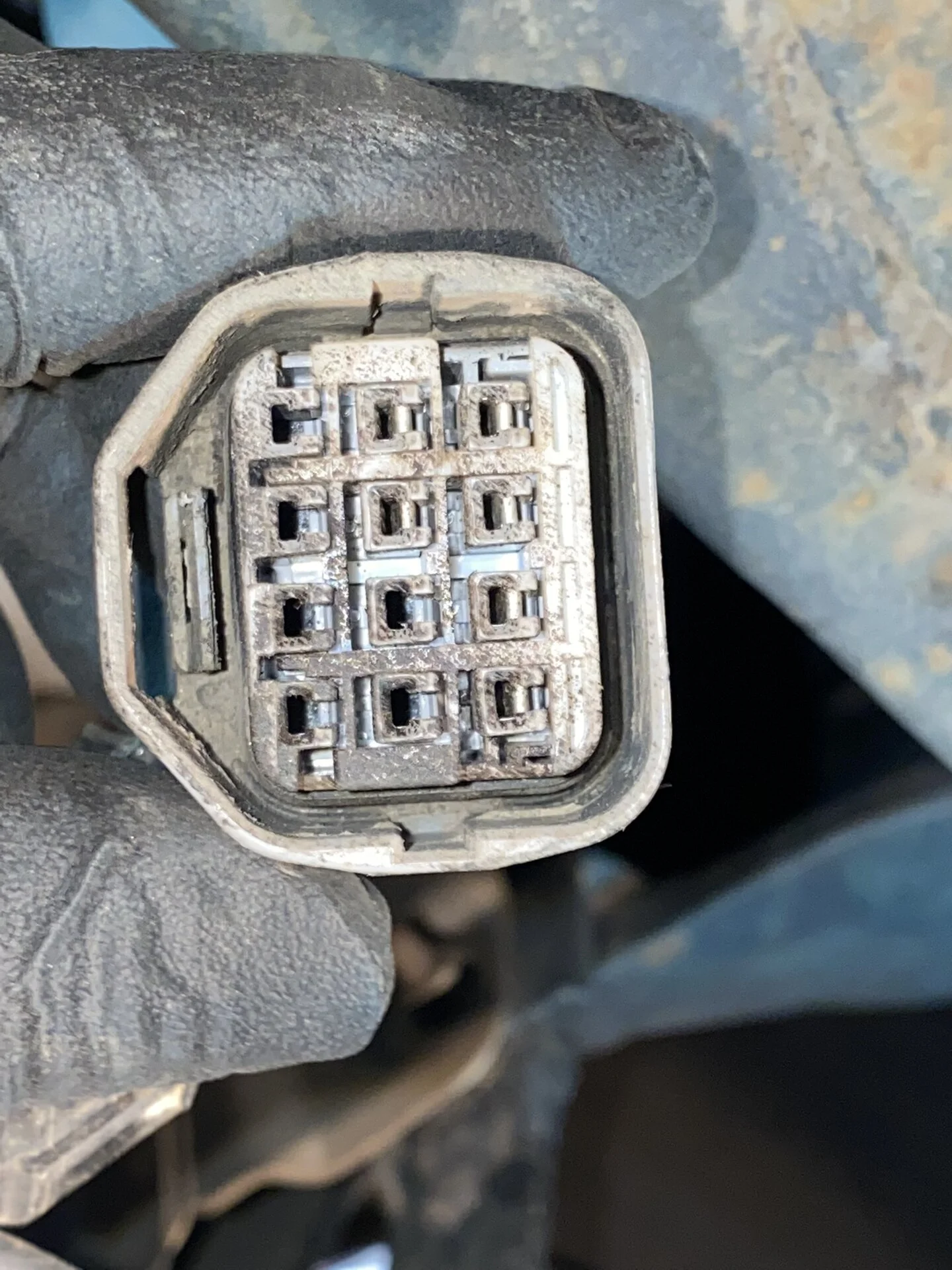

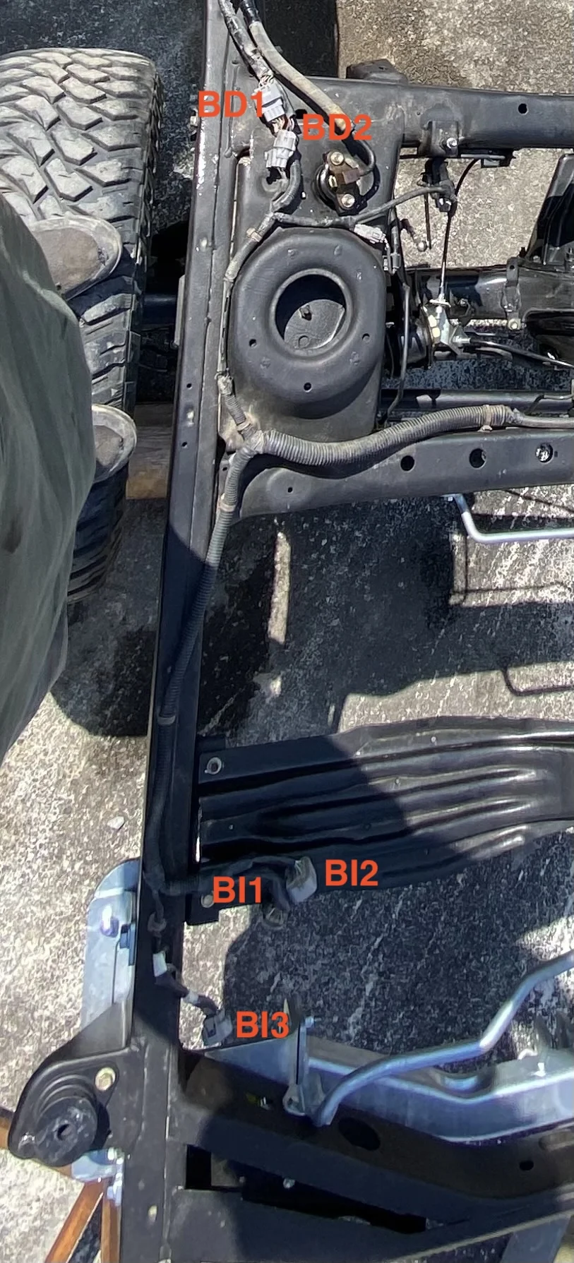

I have a massive **** up right between BD1 and BI1/BI2/BI3. No continuity on pins 11 & 12 (L-R & L-Y), which go to the accumulator solenoid and short circuit between all other 10 pins in BD1 and on the other end in the BIs.

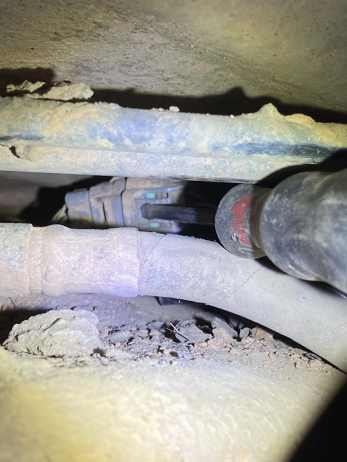

BD1 & BD2 are in a horrible spot, but are reachable without cutting the wheel arch - the fuel tank has to drop. In my case I had to remove the rear prop shaft too, otherwise the fuel tank would not clear. Might be a diesel thing.
Once the tank is out you can barely disconnect BD1 & 2. The hard line to the rear passenger ram (shock) and the attachment to it are in the way big time.
BD1 & 2 as viewed from the place of the fuel tank. If you disconnect the hose for the shock from the frame is a tad easier:
You can insert a screwdriver into the plastic lock and both push it down and pry the connectors apart. I absolutely could not put my hands in and have enough leverage to pry them manually. And all the connectors had already been reconnected 2 years ago, when I removed the body from the chassis.
So took my half a day to get there to find that the issue is between BD1 and all three BIs. I am glad I made a ton of photos when I had the body removed, this is how the harness goes.
So I am so out of luck. The harnesses split right around the spring bucket and are 100% unreachable without either lifting the body or cutting the wheel arch. I am not sure yet which one I prefer...

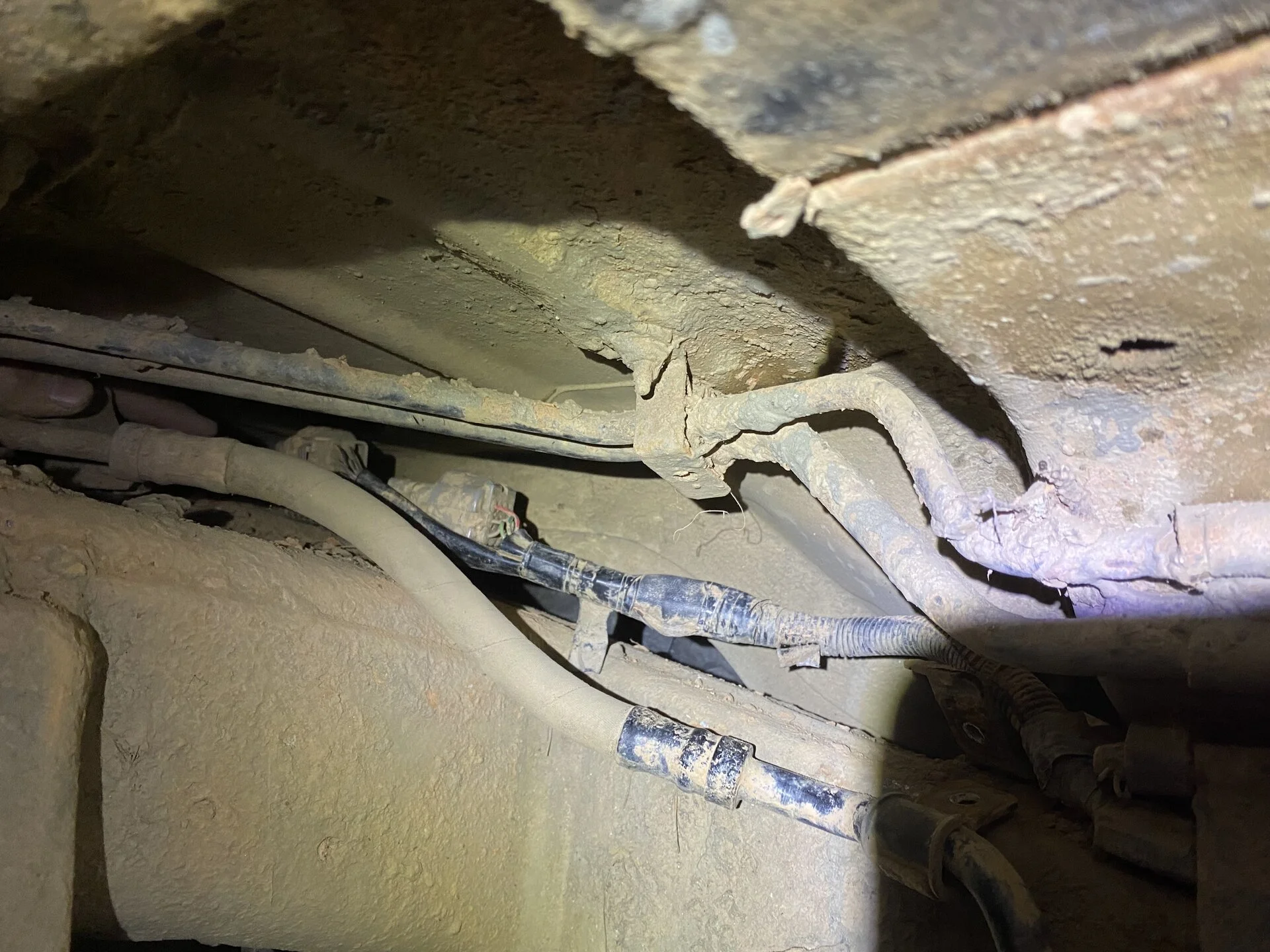

That is an amazing picture of the harness at that location and a great example of why it's so hard to diagnose wiring like that. My guess is that right at the section in green below, the harness rubs and breaks through the insulation.
If you find your wire issue I would love to see where it ends up.
And yes, I'm assuming the dude doing a full frame off restoration would have the skill, care and precision required to get those sensors apart and back together again. :)
....The harnesses split right around the spring bucket and are 100% unreachable without either lifting the body or cutting the wheel arch. I am not sure yet which one I prefer...
I would either lift the body or splice in a new cable bunch around the inside of the spring bucket. Anyhow, waiting to see your way out of the bog - it seems that all the solutions you end up with are good.

The short was not a short at all. All damping force control actuators - finned pieces that the globes screw on - have continuity between all terminals and it is by design, according to the FSM. On each actuator there should be between 12.0 and 13.5 ohm between terminal 2 and every other terminal.
So if any actuator is connected, a lot of "shorts" pop up on the harness. Lesson learned after I cut the unreachable BD1 😭 Always disconnect the actuators before diagnosing harness issues 🤷‍♂️
One very long day later the harness is whole again. The main issue was that the B+ cable (Blue Yellow) was broken before BD1. A few other on BI1 were eiter also broken or on their last legs. Now the AHC is working again and B+ in Techstream is back to normal. Kind of, sorta. Pump works beautifully. When the hydraulics failed 25k ago it started with the pump which was depressing, considering that the pump had less than 10k km. Probably the bad connection to the valve control assembly was a factor, now it is quick, smooth and silent again.

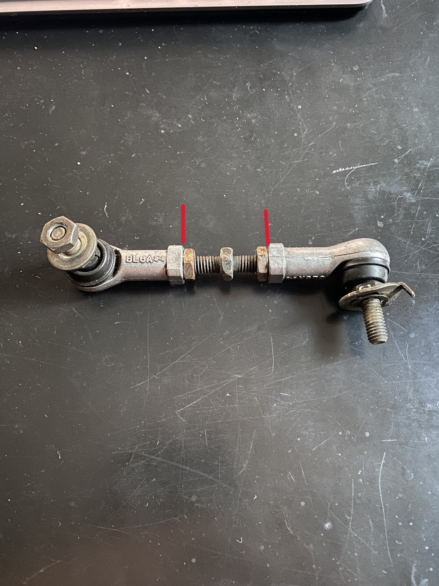

Front sensors spread/position adjust (spread and or position in slide) vary:
When front sensors spread, are not equal. The system uses, ones reading to set level. Your example suggest, it used the higher.
When I get these -+ readings in tech stream of height readings, to far off from 0.0- 0.2". I'll look to see if front sensors, set at different spreads from each other. Looking at where the turn buckle (TB) sit in slide, and spread of TB adjusting threaded rod. I'll adjust the slide to near bottom. With slide locking nut washer sitting square with bottom of turn buckle. I then loosen the turn buckle's threaded rod's locking nuts. So I can adjust spread, by turning turning TB fixed nut on threaded rod.
Measuring from between end of TB, where lock nuts seat. With spread of:
TB spread at 29.6mm, I get 19 9/19" fender to axle center.
TB spread at 38.5mm, I get 19 1/16", fender to axle center.
At ~35.5mm spread, I get ~19 3/16" fender to axle center.
~19 3/16" fender to axle center, is what I find all stock 100 series.

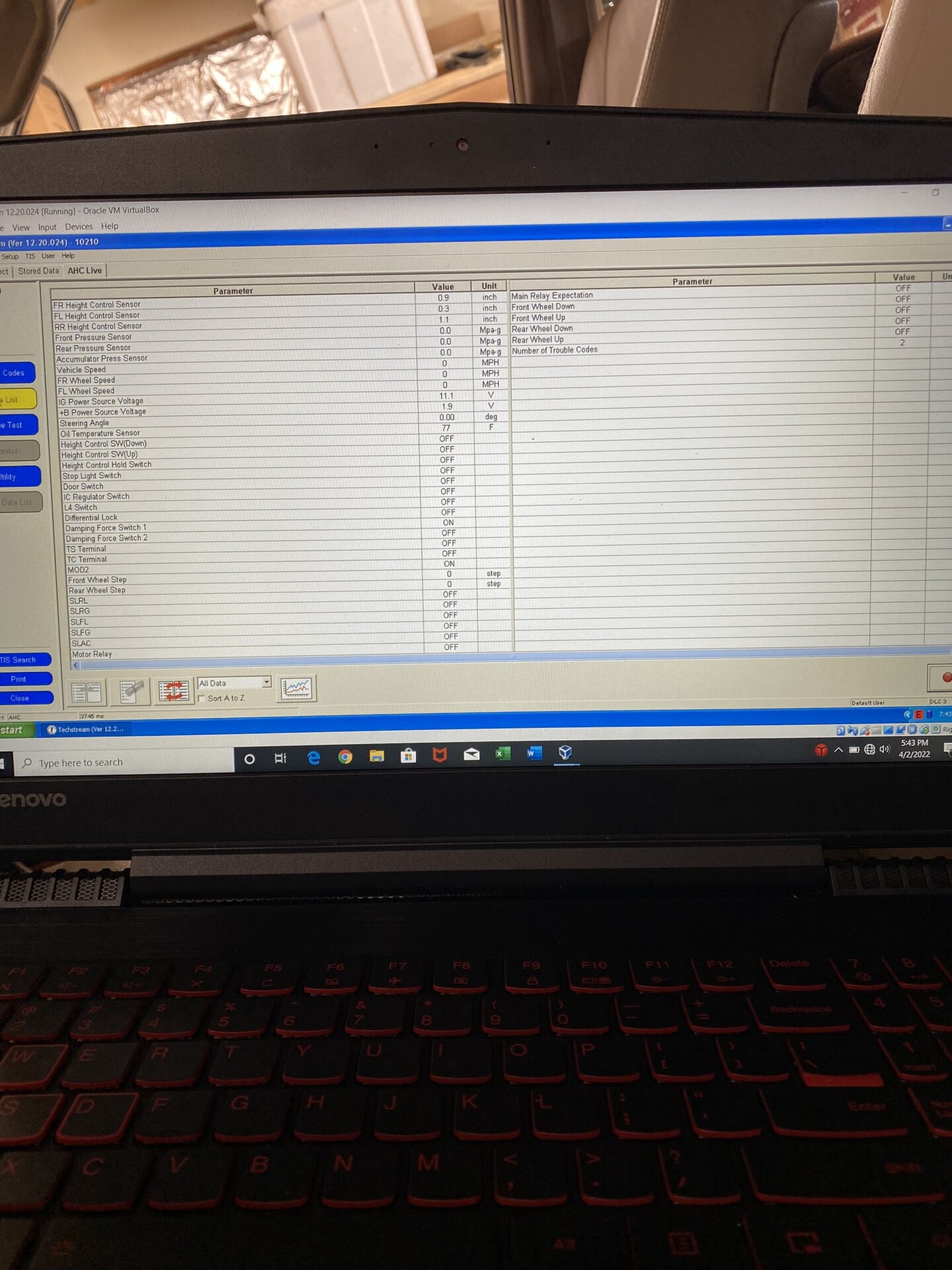

Electric fault:
Both @suprarx7nut and I have found some wiring issues. The one I had, issue with was a rear "water tight" wire harness block filled with crud. @Moridinbg you and @suprarx7nut, both help me with that one. @Moridinbg you, by posting picture of wiring on fame, body off. @suprarx7nut, by cluing me to rear 1/4 area wiring issue, wherein you found a dead wire. We both first looked a AHC CPU, as FSM tree took us down that rabbit hole.
In my case. It was a AHC shutting off, at times. I first found, sensors TB's ball frozen. Which bent and or broke TB's arms. Frozen ball joint of TB, is very common with age. I fixed the sensor, with new TB arms. All seem good. Although, after first test drive, pressure change in front. Readjust T-bars and all good. Until 3 months later, when system again would go into failsafe (OFF) at times.
Very long store short (thread around here somewhere on it). I found water tight wire housing block, was not water tight. As it turned out. Most (not always) times driven on wet HWY or undercarriage washed, system shut down (OFF). Cleaned and added dielectric grease to seal out water. No more issues.
AHC wire housing block near rear bumper, up under rear 1/4 area attach to frame.
A clue was; IG power source Voltages 11.1V & +B power source voltage 1.9V. They should at or close to same Voltage and same as battery
After wire block fix readings, note the Voltage 13.8 and 13.3 voltages (much better). Before finial tweaking of sensors for heights and T-bar for pressure
I measure spread of TB, between red lines. Adjust, by unlocking nuts at each end of threaded rod and turning center nut on threaded rod.
My left TB is extended all the way to the maximum, with only a couple of threads left inside and is at the bottom of the bracket on the UCA. The RH TB is screwed all the way in and is at the top of the bracket. This way I am getting "just" -20/20mm. Otherwise it was -90/40 or something like that.
