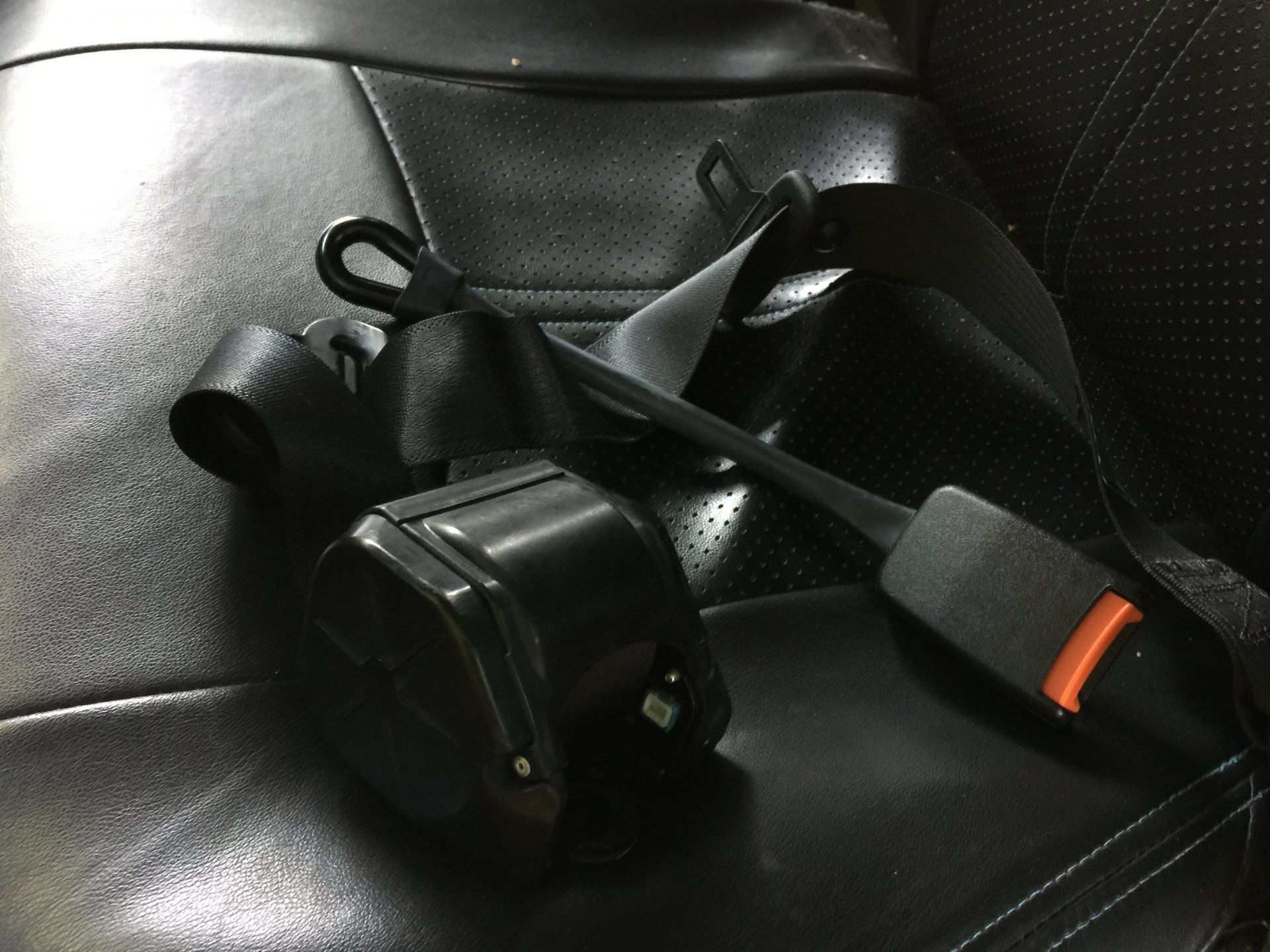

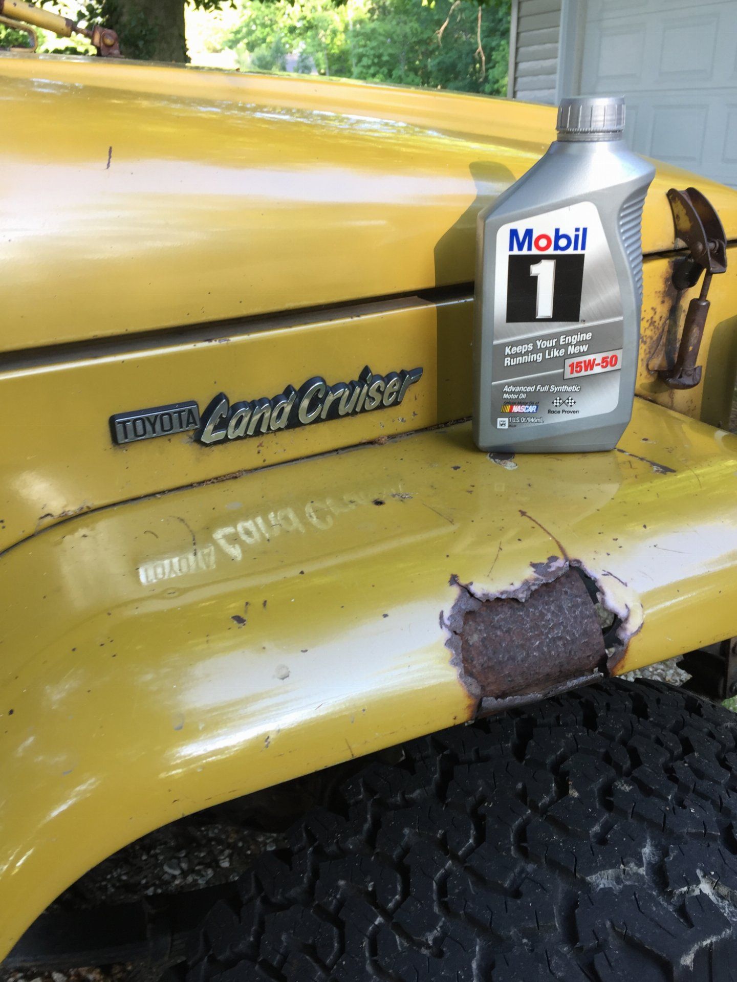

After some debating I decided it would be best to try and make it a driver for the summer. I have a pretty big list of stuff I need, and will buy stuff as I can afford it. For starters an oil change was in order and the three point seat belts arrived (military Hummer surplus).

I'm not knowledgeable on the subject and when I try to research it honestly goes in one ear and out the other so I have to go back when it's time for the next oil change every time but from what I've seen on here these old motors do better with a high in zinc zddp content oil and an additive with it as well for they type of tapit engine
I say keep it and drive it
Just cover underside with fluid film and enjoy it until the salt trucks come out
That Mobil 1 is not the typical stuff, it has all the good stuff for race or classic applications with extra zinc and phosphorus. The best part is the 2f sounds the best it ever has with it on board and it was on clearance for $3 bucks a quart.
@kbahus I run the same oil-lots of ZDDP in that stuff!

I also started the Humvee three point seat belt install today. Ended up using the entire hardware package on one side as I needed two 90-degree brackets, need to order another to do the other side.

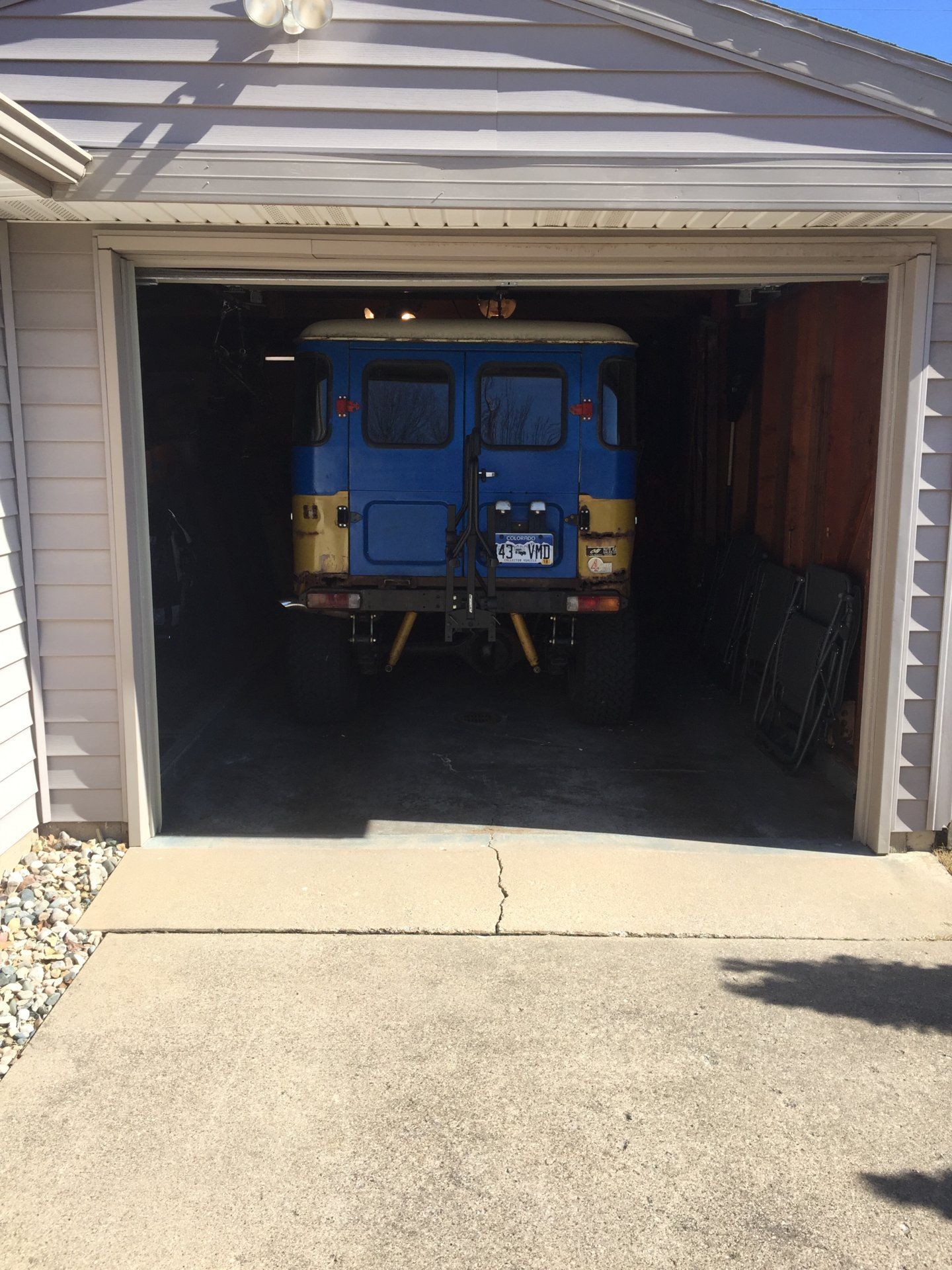

After a few years of living outside it finally has a home inside! Also got it registered in Indiana, sad to see the Colorado plates leave. Hopefully I can get some work done on it now!
