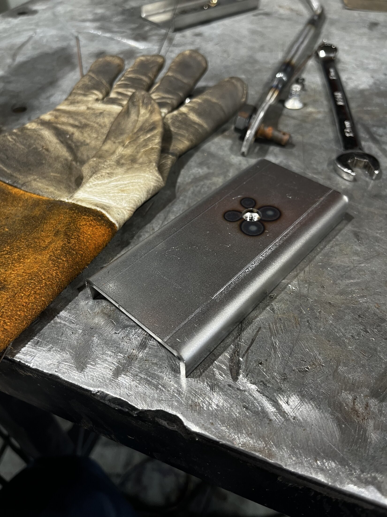

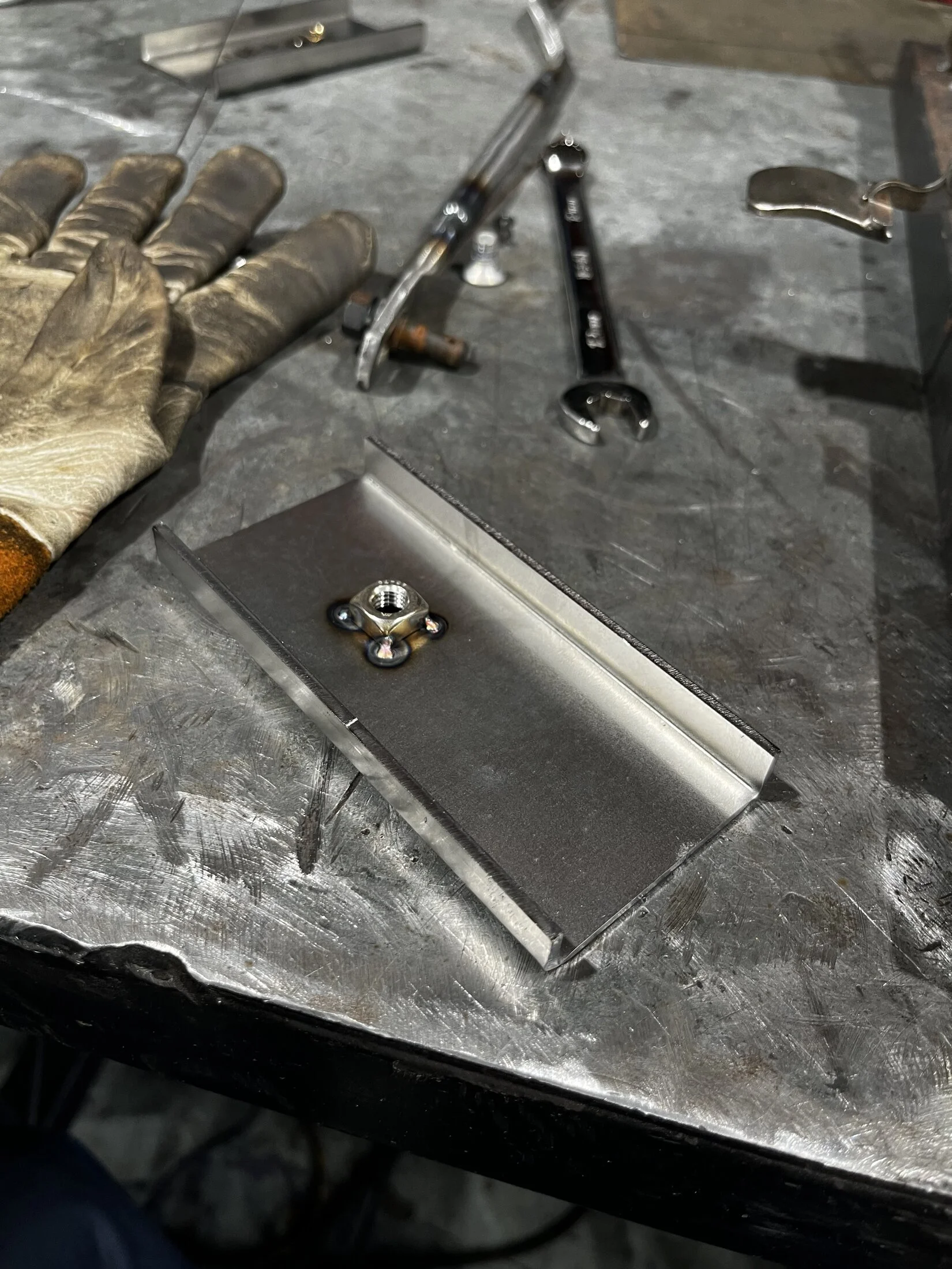

New jump seat reinforcements… these go under wheelwell. going to add these to the site as it doesn’t look like anyone else makes these and CCOT doesn’t show them on their replacement wheelwells
Interesting. I was just thinking in the last 48 hours I might need something like this or brackets to move the jumpseat mounting points if they don’t fit with a aftermarket metal tech cage. My seats are in a box in storage so I can’t try fitment until I get time. My kid is finally old enough to be back there for short low speed drives and I want to use that cool feature of the 40 even if it’s just a mile down the road and back.
That is a nice looking item you’ve made:
