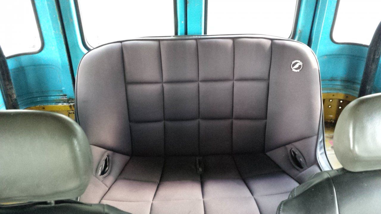

Mocked up the rear seat today. It is amazing how quickly the real estate disappears back there!

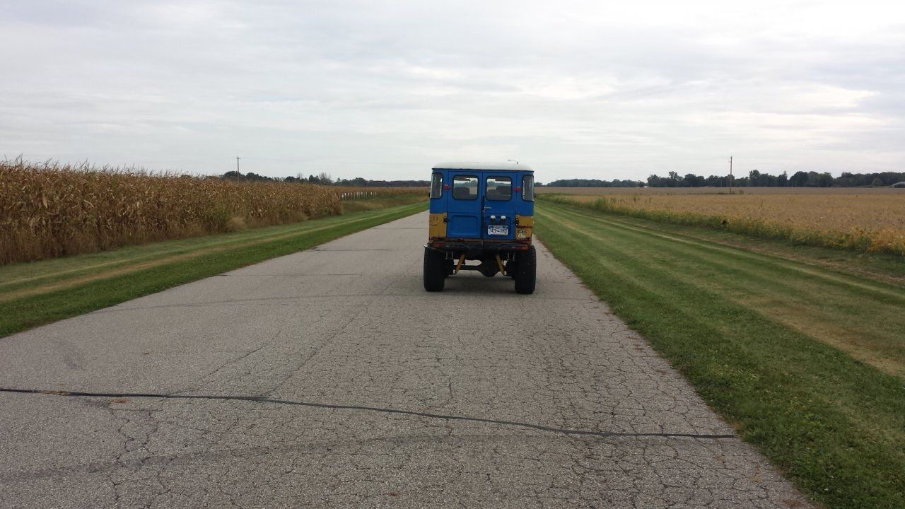

Also went for a short drive to burn some gas.
