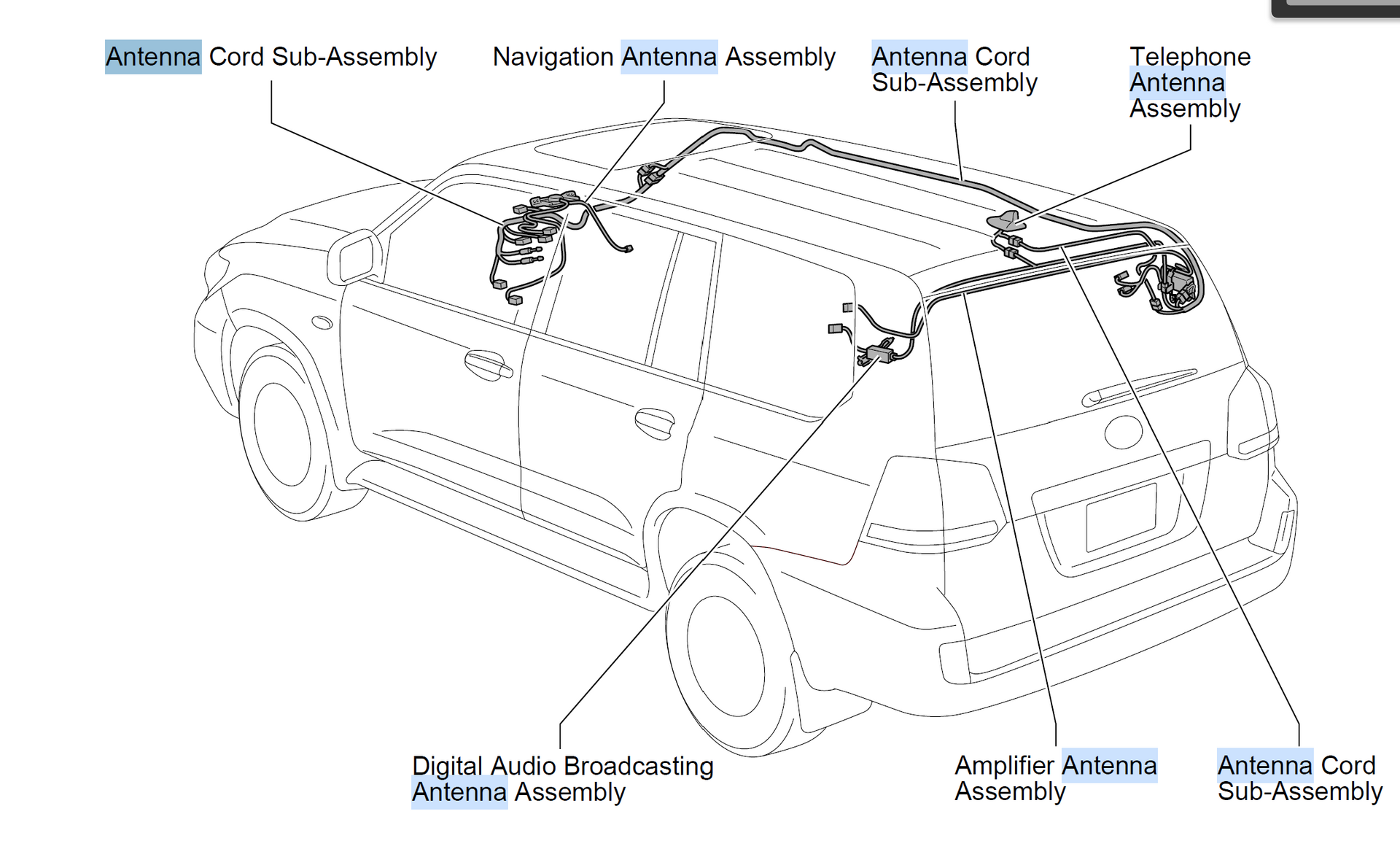

Where is the Antenna Located? I think it is in the fin on the top with the satellite radio antenna?

it isn't in the fin on the top. It is inside the dash.
pity as that would have provided much better reception. I am going to go with a puck that I can mount on the Mesh Head Unit Grill on top of thee dash

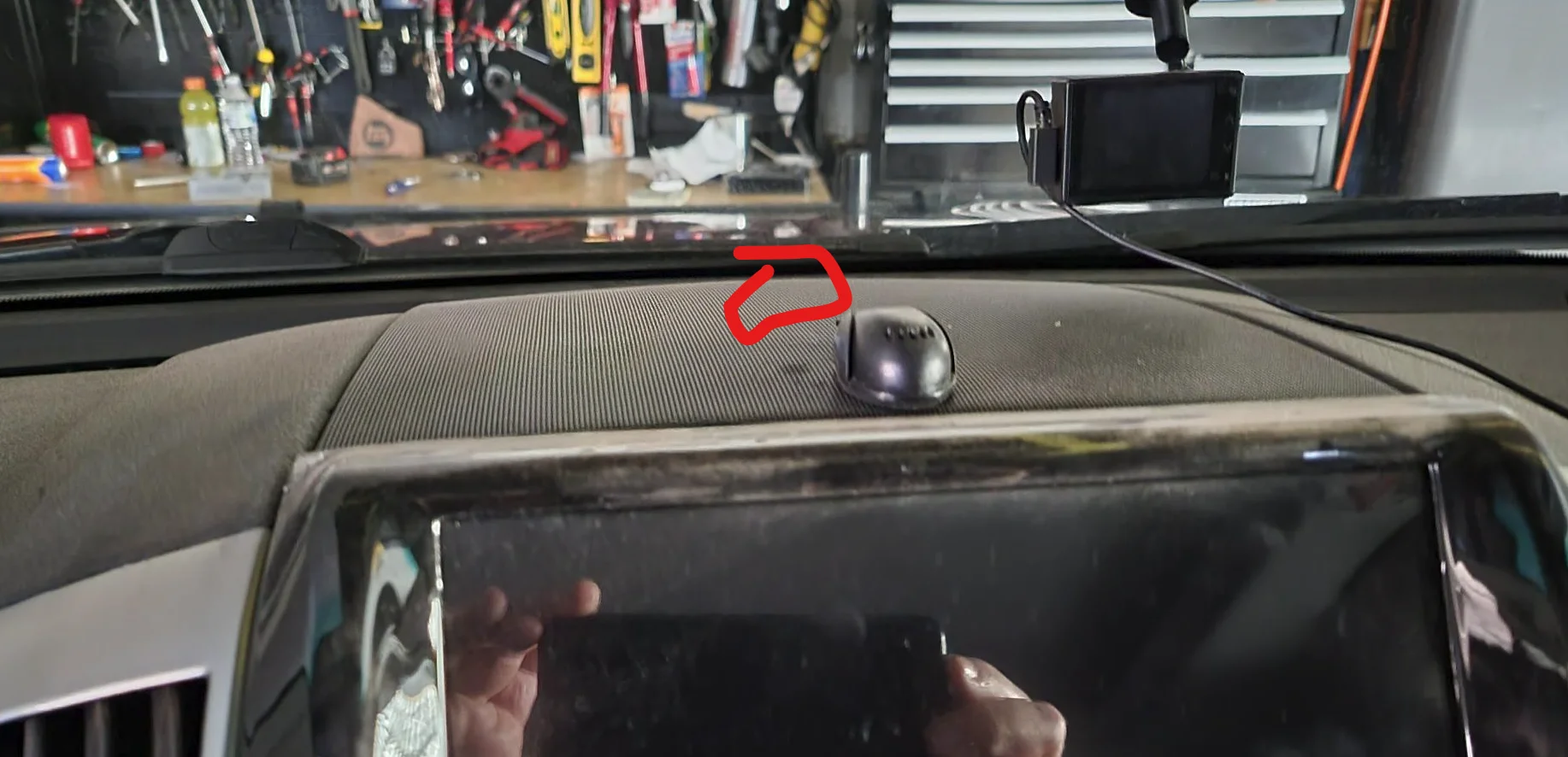

I plan on mounting it right behind the phone microphone I mounted when I had issues with that
I mounted the gps puck that came with my EC Offroad unit on my Gamivti plate on the dash. Seems to work pretty well though occasional Google Maps wigs out like it doesn’t know where I’m at. This only seems to happen in large city freeway situations. I don’t know if it’s the gps signal or the app.

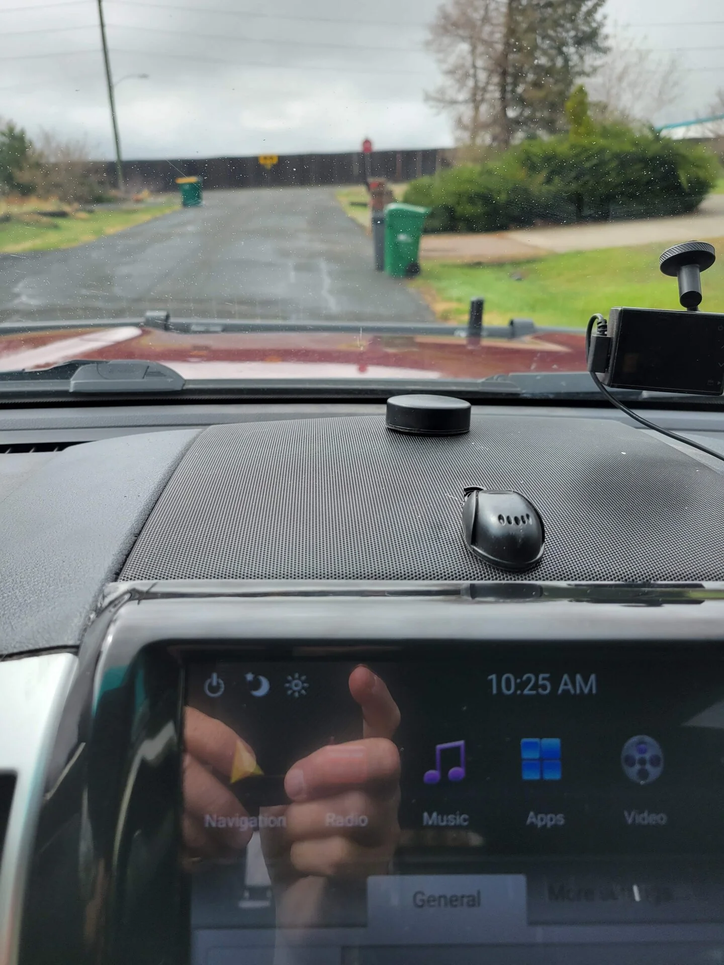

When I took the radio out, the GPS connector was loose, not real loose though. Rather than tightening it, I went with what looks like a better antenna to me. The one with the radio had a real long cable whereas the new one was only 20". Long cable lengths add impedance to RF signals
Amazon product ASIN B08RW7R8KH

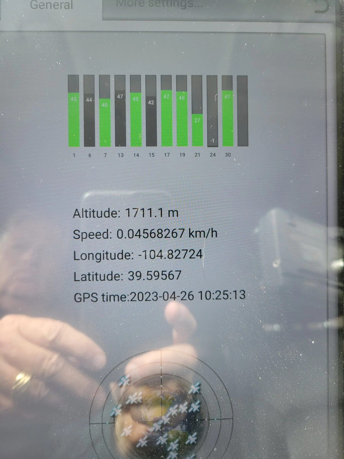

Now I should have taken a GPS Monitor reading before I started and then tightening thee existing antenna before then replacing the antenna. I had forgotten about this feature until after I replaced it

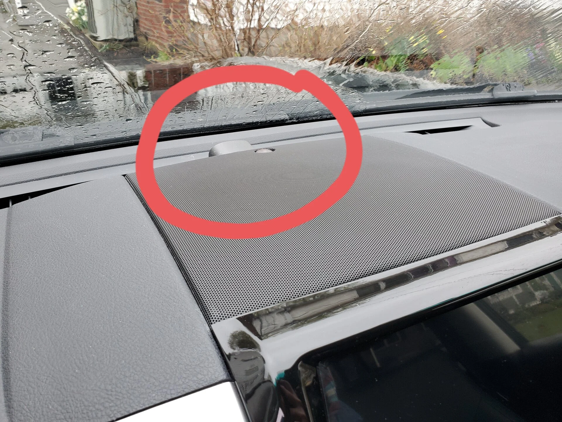

The old antenna was under the screen near the top and the new antenna is on the top of the screen. I Drilled a hole, used the adhesive backing and also glued the outside of the threads to the plastic under the screen to better secure the antenna. I also used Loctite on the GPS SMA connector to the back of the radio.
Even powering it up in my garage it instantly found my location and detected 6 satellites to do so
Here is a picture of signal strength in my driveway on a cloudy day and where I installed it
